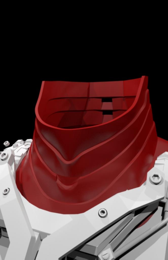

Started on the neck the other day. It's going pretty good! Here's a quick render.
The idea is to make it tiered like it's imagined to be in the movie. I want to be able to cast this in resin and still have mobility, so each of the neck tiers will be a separate piece attached to each other by elastic. The goal is also to be able to retract the neck into itself for when the helmet is off, just like the practical suit in the movies look when the actor is not wearing the helmet.
In these pictures you can see the different tiers. I've got an idea in mind for how to make the neck tiers go up and down, but we will see how that plays out someday when I actually get my 3d printer running.
As always, the neck will be fully 3D printable!!
Let me know what you guys think!

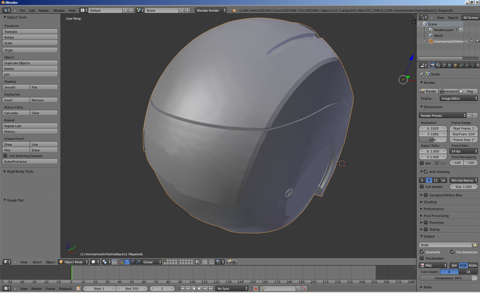

Your files are great, but if you let me, I would like to give a little of "constructive criticism" :D
Your files have A LOT of vertex, a lot! and still they feel that in some places the model isn't smooth enough, I found some areas in the "IRONMANMARKIIIHELMETBACKV1" that show this problem.
I think this is due to the topology you are using, I haven't used 3D Max in a very long time and I don't know exactly how are you modeling the files, I suppose you are "sculpting" them, but it seems that the mesh it's producing is not very efficient.
Here you can read a bit more about topology and why it matters:
Why Topology Matters in Modeling | Blender Cookie
As an example, here it's an screenshot of your files:
You can see some bumbs in your mesh, and believe me, that will show in the printed object. Your mesh is composed of triangles, which don't behave good when you try to modify the mesh and it's not easy to work with.

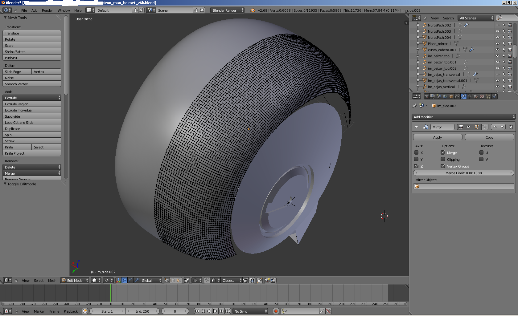

Here it's the model I was doing before you released your files:
My model of course isn't finished, it's only a draft of the general shape of the helmet, but I tried to use an uniform mesh of quads (which are better when you apply posterior operations to the mesh), also you can achieve a smoother surface with less points. Of course, you will need a more detailed mesh in some places, but in this large areas you can save a lot of vertex and still have better results.
I'm probably much less experienced than you in 3d modeling, but I think you could improve your future models just by making the mesh follow the shape of the pieces and always using quads.
I hope this doesn't upset you, I think your models are great but I think you could improve this for future models.

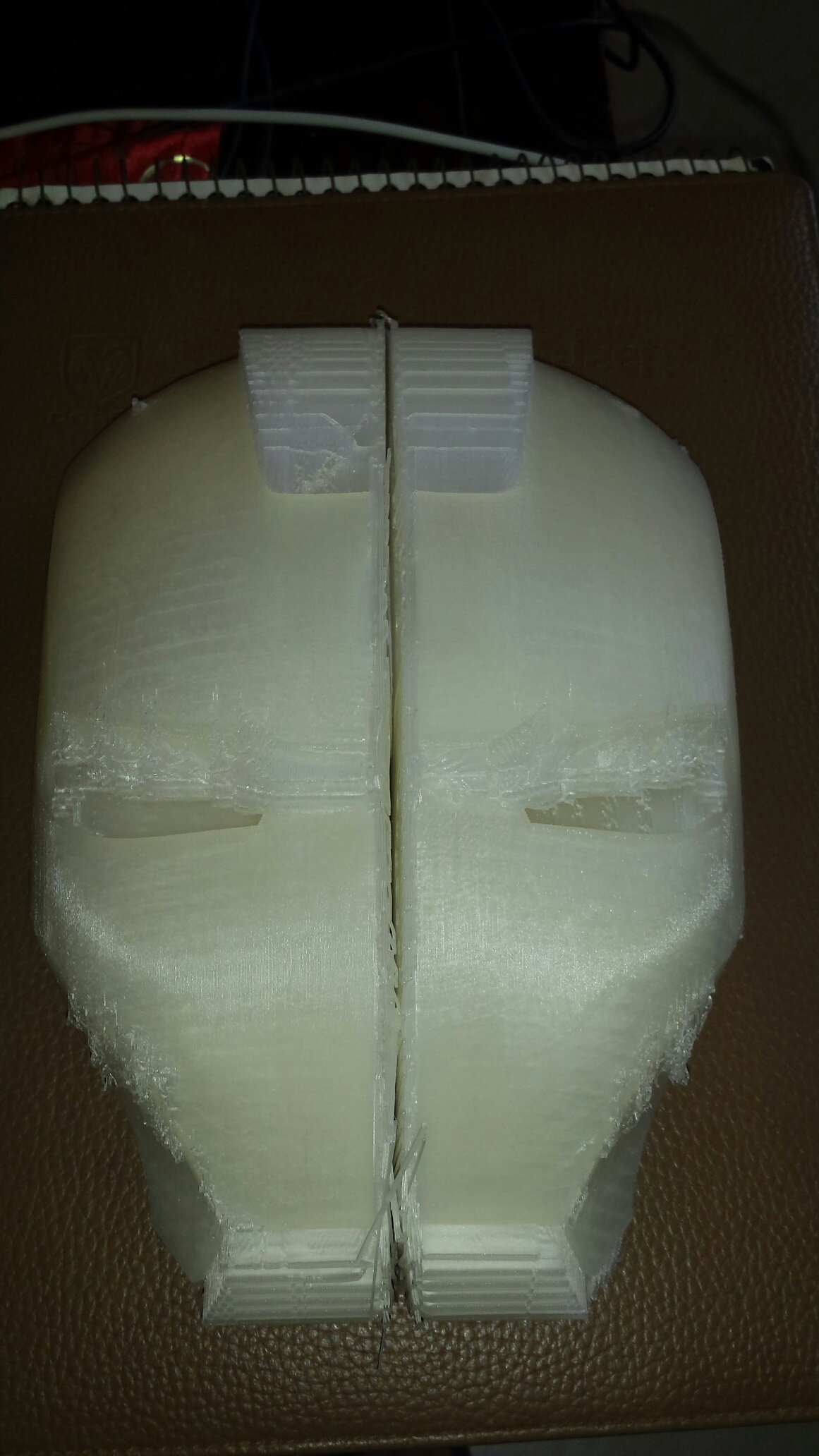

Greetings to all,
I am new at 3d printing and graphics manipulation. I use a flashforge 3d printer with a 6x6x6 printing platform, so I had to slice the mask in half for printing. It took a few tries before I was able to completely print half of the mask. I mirrored one side to print the other half and this is what I have so far. i used rasp support and have not cleaned it yet. I'll be printing more when i have time
Thanks to drumguy560 for the files, it may not be perfect but nothing that "bondo and sandpaper cant fix".

Here are some shots of the neck I'm currently working on. The proof of concept of a collapsible, flexible neck seems to work. I tested the theory with a low poly version in SolidWorks, but goodness there is a lot to learn in that program!
Anyway, here are some renders of the collapsible mark III neck, STLs will be up soon!
in this picture you can see the concept behind the neck. It is tiered, as to allow movement in all directions. The top tier is meant to fit neatly into my helmet file in order to stay up. Later i may figure out some kind of system to allow it to stay up without the helmet on, but until then, when the helmet is on the neck stays up, when it is off, it collapses into itself under it's own weight.
This should work. As my 3d modeling skills are growing I am finding it easier to make clean meshes. I will probably re-do the helmet file someday as well
Thanks for staying interested!

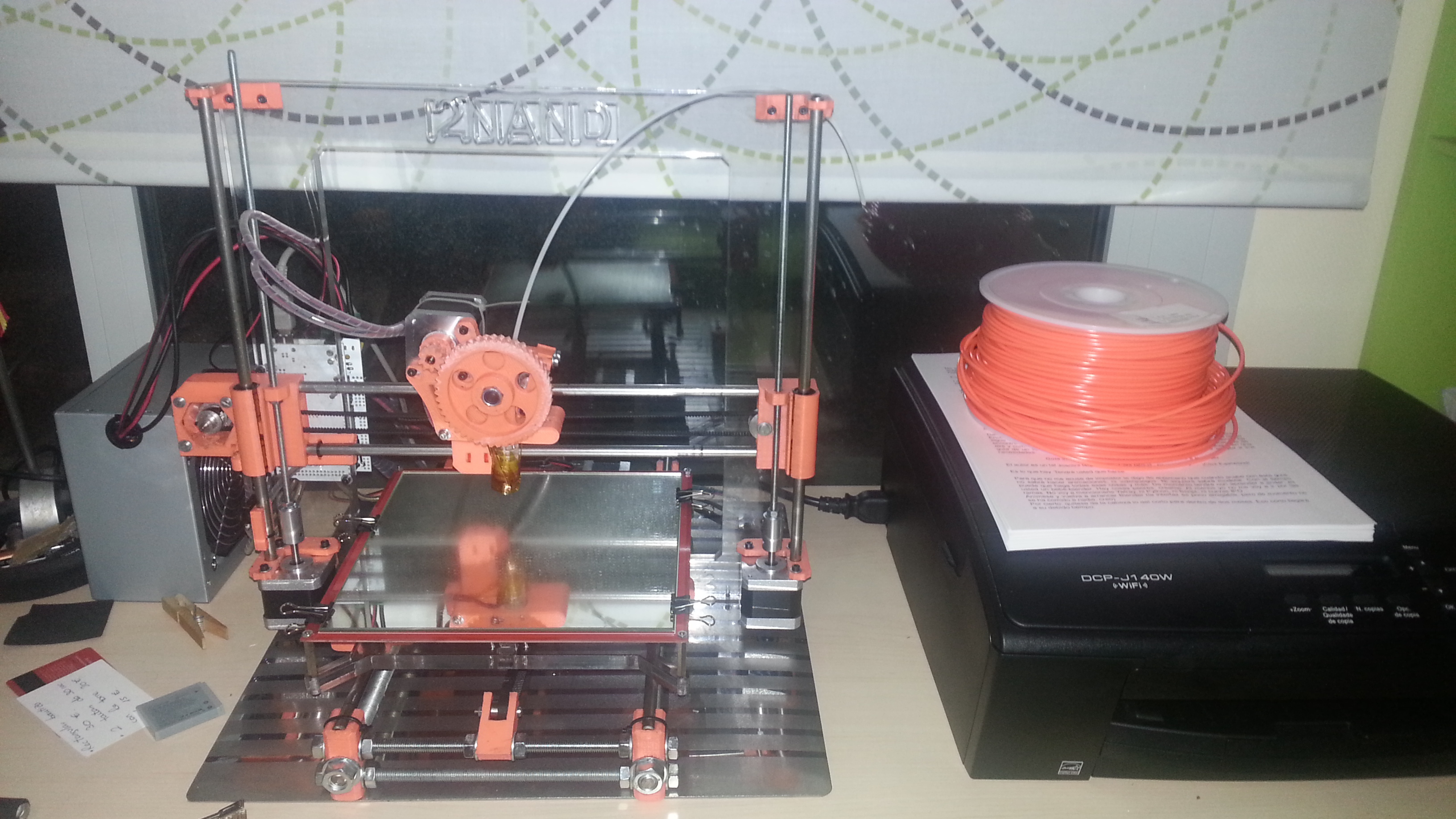

my 3d printer PRUSA I3 has arrived, go go go, I NEED PRINT!!!!!! jajaja
