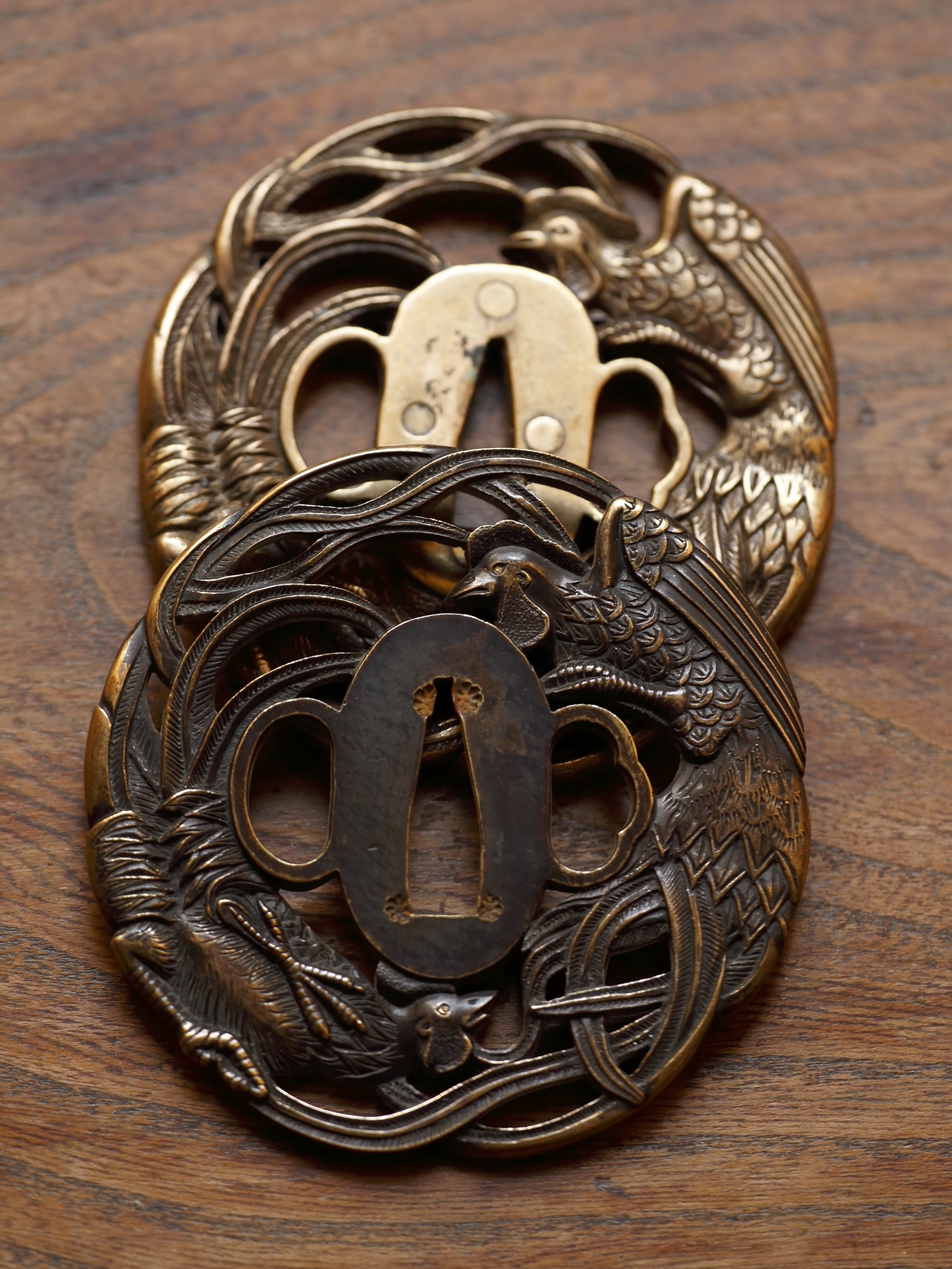

finally, after hours and hours, the other side is finished, the ring is also finished, patinated, I made a very slight patina on the ivory too.and yes, Mammoth is polite name for "ruined ugly existing item, pre 1947" the handle was a awful african carving remain.
Here you can see design improvement from bottom to top.
Bottom is just cast and polished, most of engravings are just lines, no relief carving.
Middle is cast and all has been cleaned by carving, relief and rounded edges instead of just lines, and design improved.
Top has full relief carving.
