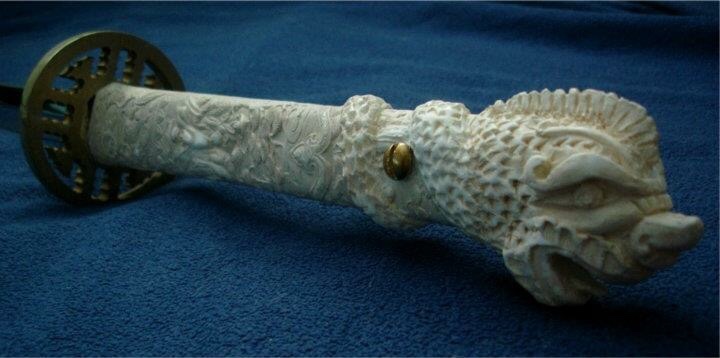

But now, it makes about 7 years since I get interest in movie props, and started to make japanese stuff again, especially my kill bill sword replica, between movie prop and real japanese stuff, but also non-movie japanese stuff too.
I would make a real duncan sword, I mean, between the prop, and a real japanese stuff, meaning real blade habaki, real tsuba, with real hand engraving, and of course, in that specific case, real carved material for handle.

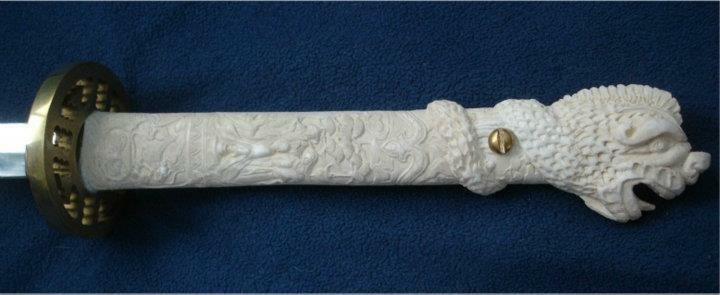

I was thinking about the Ramirez sword, but I really don't like the dragon look, loos like shaped from putty directly on a marto "ivory" handle, so I am more thinking about the Duncan sword.
I would try to get pictures of original stuff, to get sure about it, probably not the earlier version, but more the collared one, or colarless one but with a kind of ring on the back part.
it could help to make the rear head on a separate piece, more logical construction, compared to real bone made japanese swords.
Was the original later version just a marto sword?

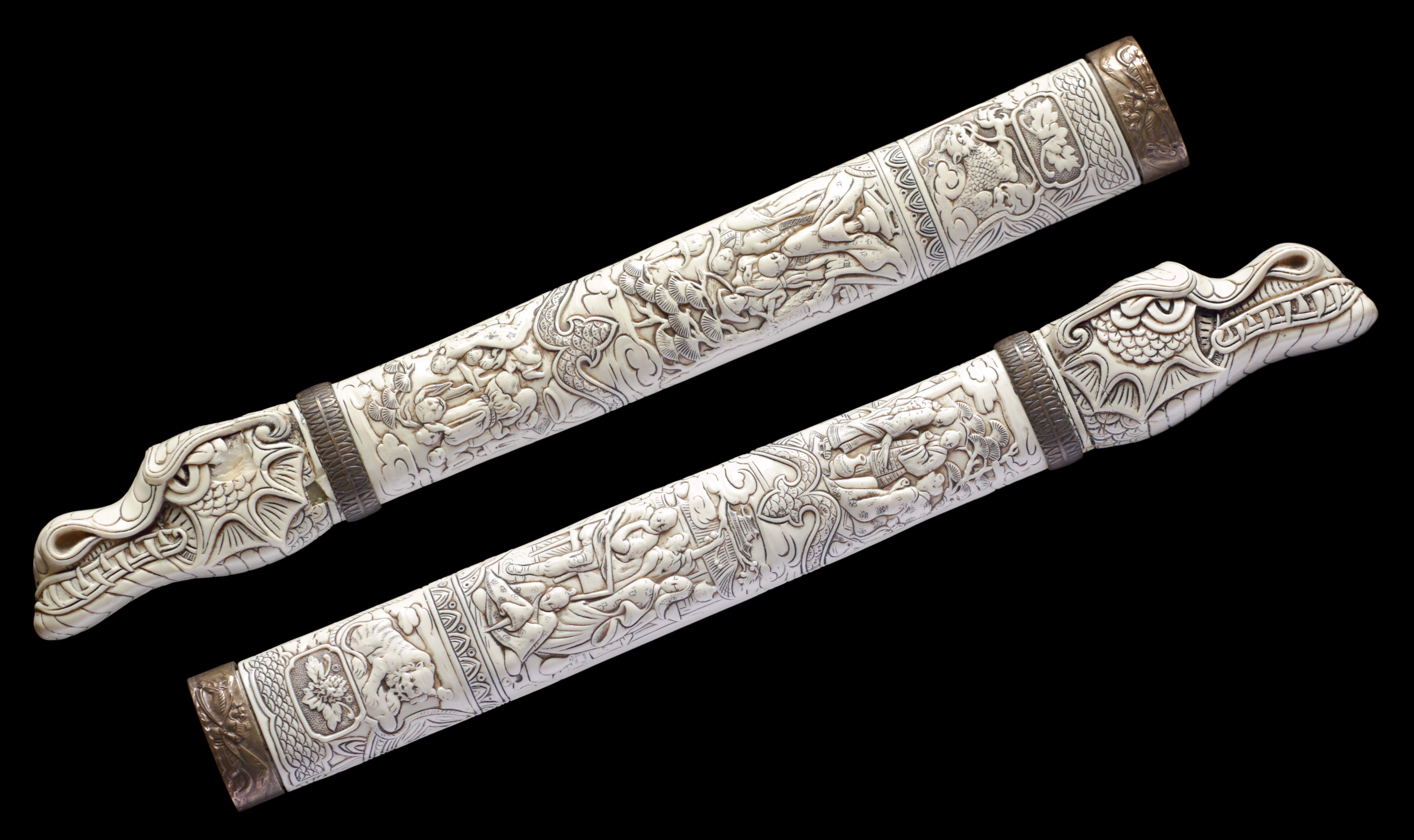

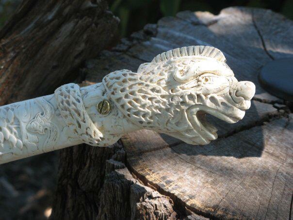

Yes we discussed about a way I should carve bone or ivory handle for you, I told you, find the material, I can carve it, it was last year or so, and yes, I'm still in, in fact I was hoping you to come back one day.
I suggested you to use mmmoth ivory, as there are no legislation issues like actual ivory, but bones like camel or other not protected species could also work, even it would bring some issues on the dragon heads (hollow area)
I saw you also worked on a kurgan sword, and it's also interesting.
If you are interested in some carving from me, we can do some trade, not a problem, I have lots of time and good abilities, but a few money only.
It could be possible to carve some handles for you, if you provide the material and model, and I carve one for me.

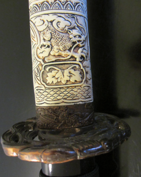

I found a marto sword, the seller owned it for 22 years now, I don't understand why he sold it, especially for a ridiculous price, after 22 years of good service?!
After speaking with Irishamericanlad, I was able to get lots of interesting informations about original handles, I really hope to carve some from bone!

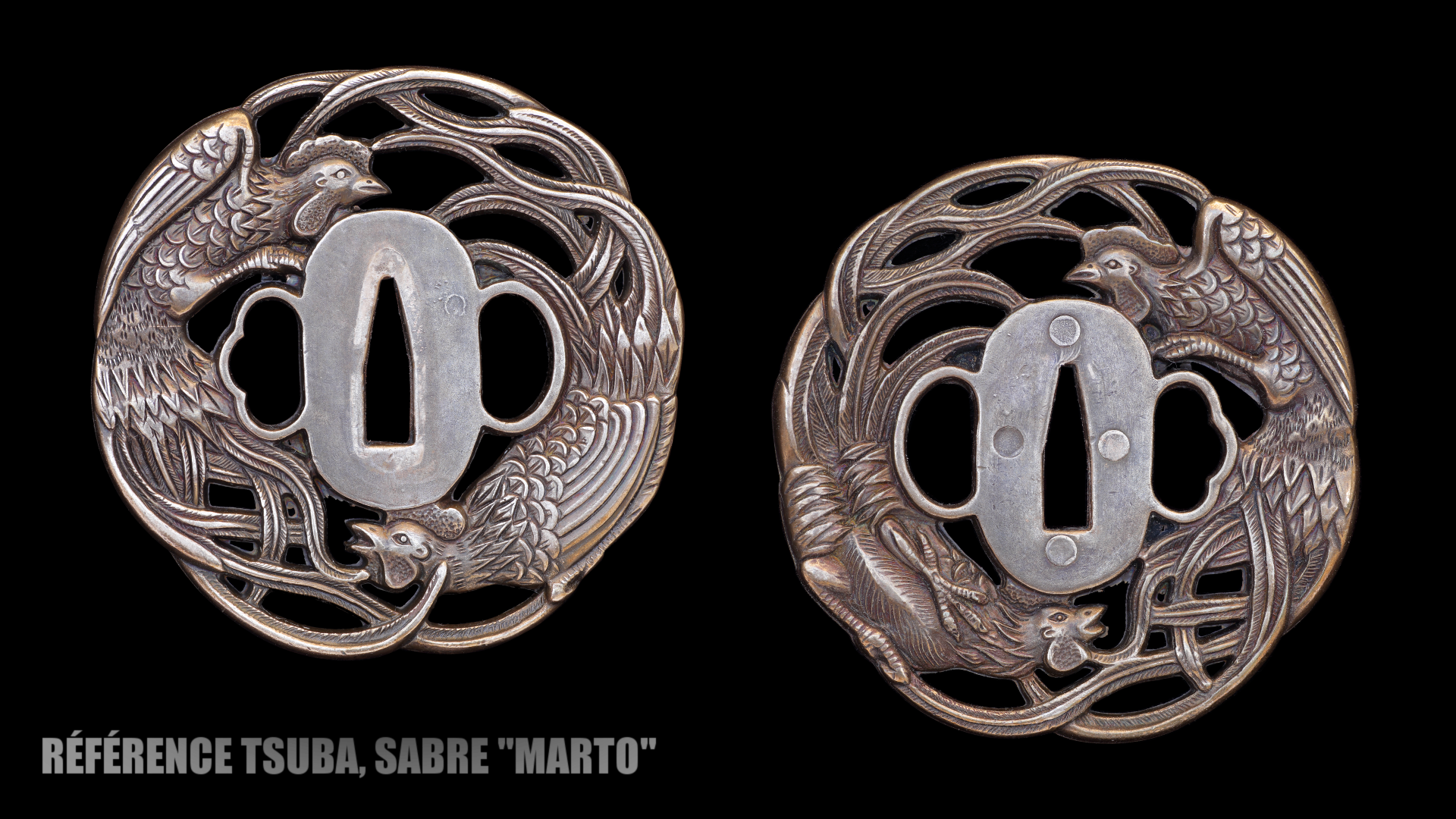

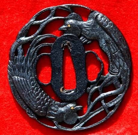

Also found this tsuba pictures, sadly it's sold, but it's a original edo period kinai school tsuba.

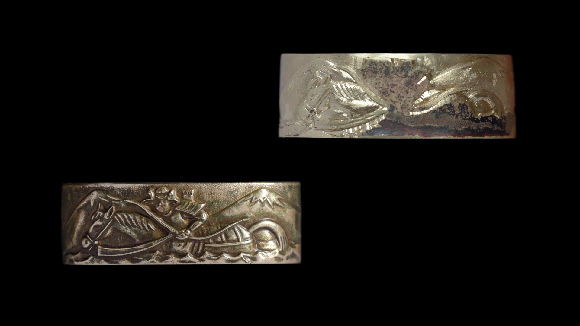

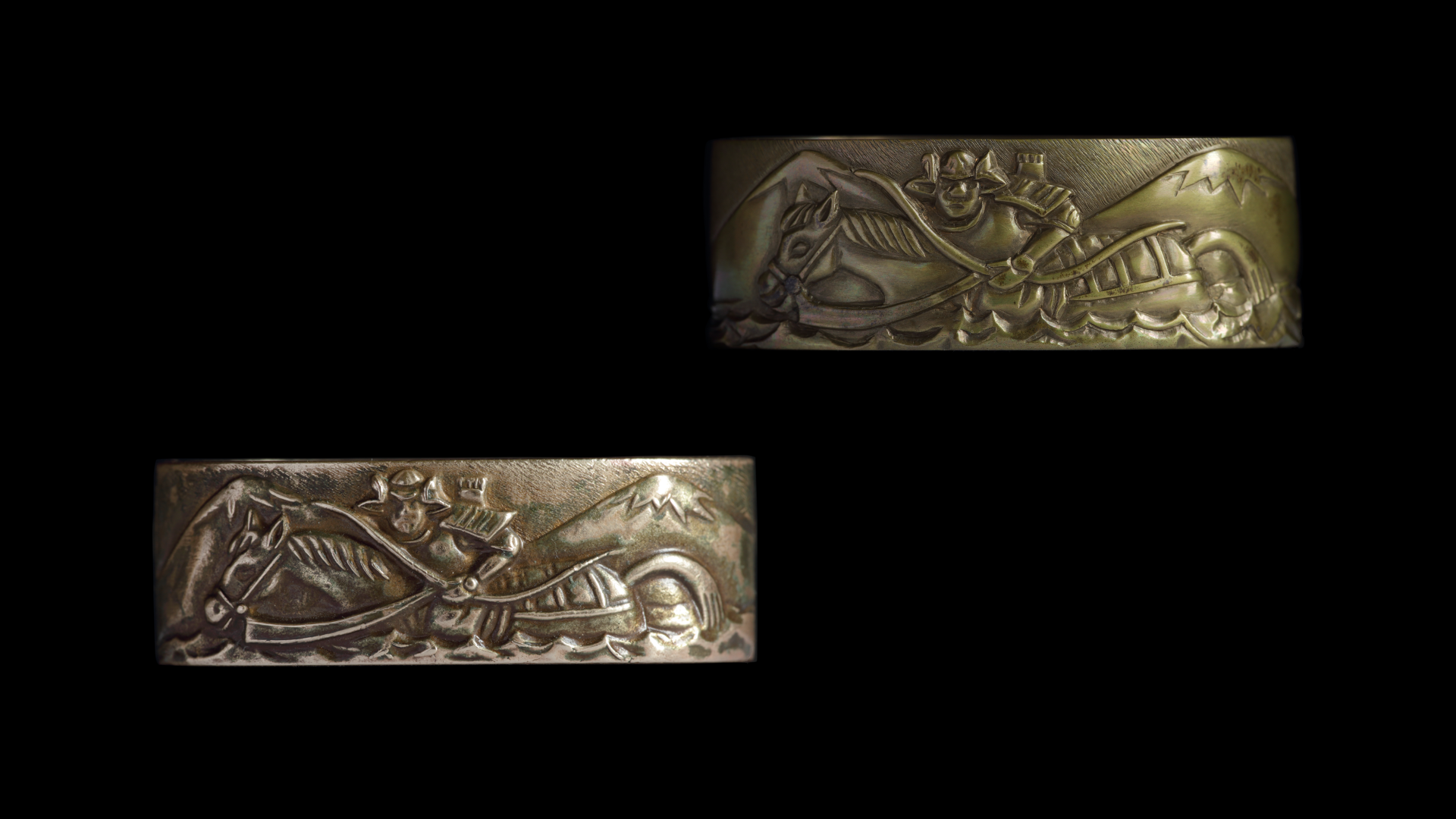

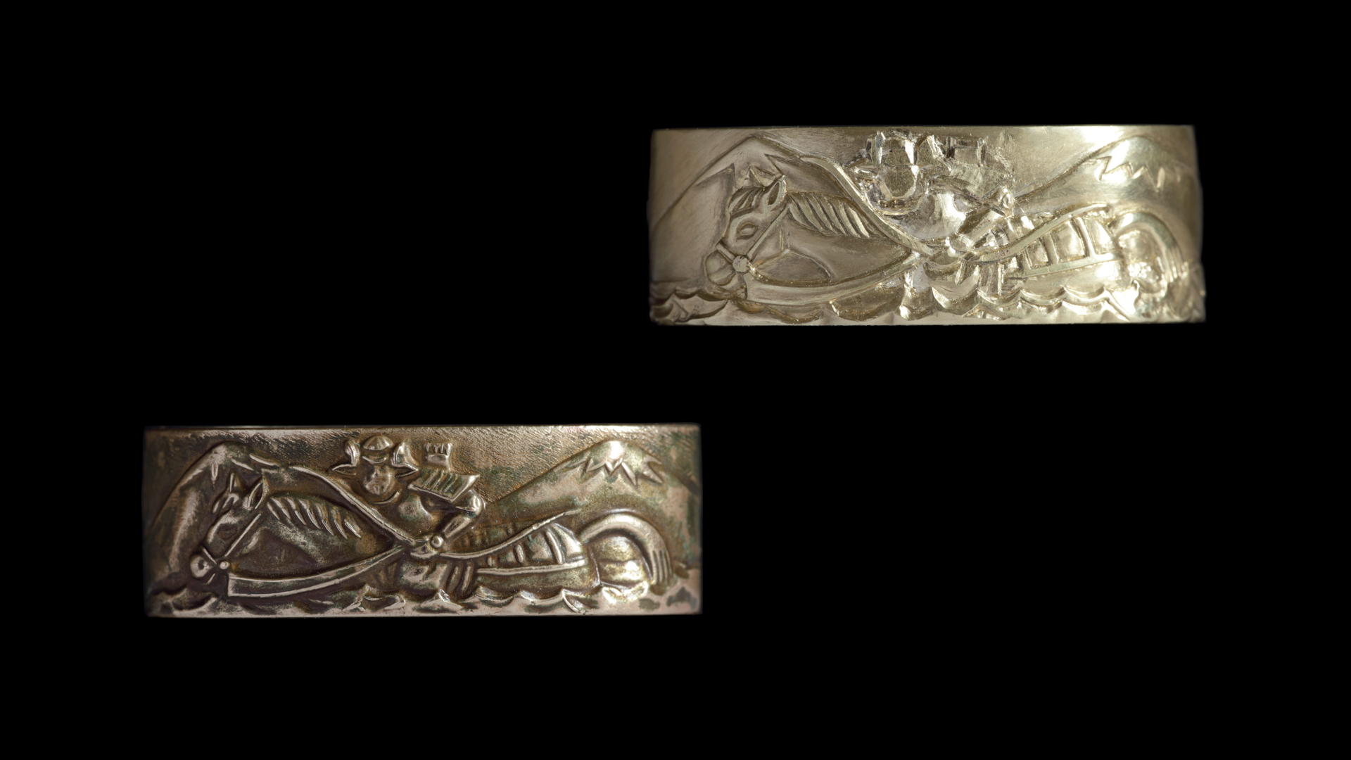

It seems the Marto company made 2 fuchi versions for same duncan katana, with same design on both sides, but I think the original cast piece probably had one design on one side and other design on other side, I have the first variation, and I found pictures of the second variation.
So I am looking for high resolution picture, or even better, a genuine part like the fuchi on this hilt.
Bottom is original marto stuff, probably cast from a real fuchi, like they did for the tsuba, but the same design is on both sides (samurai on horse) with ugly mold lines on ends, so I will change the design, keeping samurai on one side of course but doing a smaller design on other side (mountain and water only)
I made it from brass, by shaping and soldering.

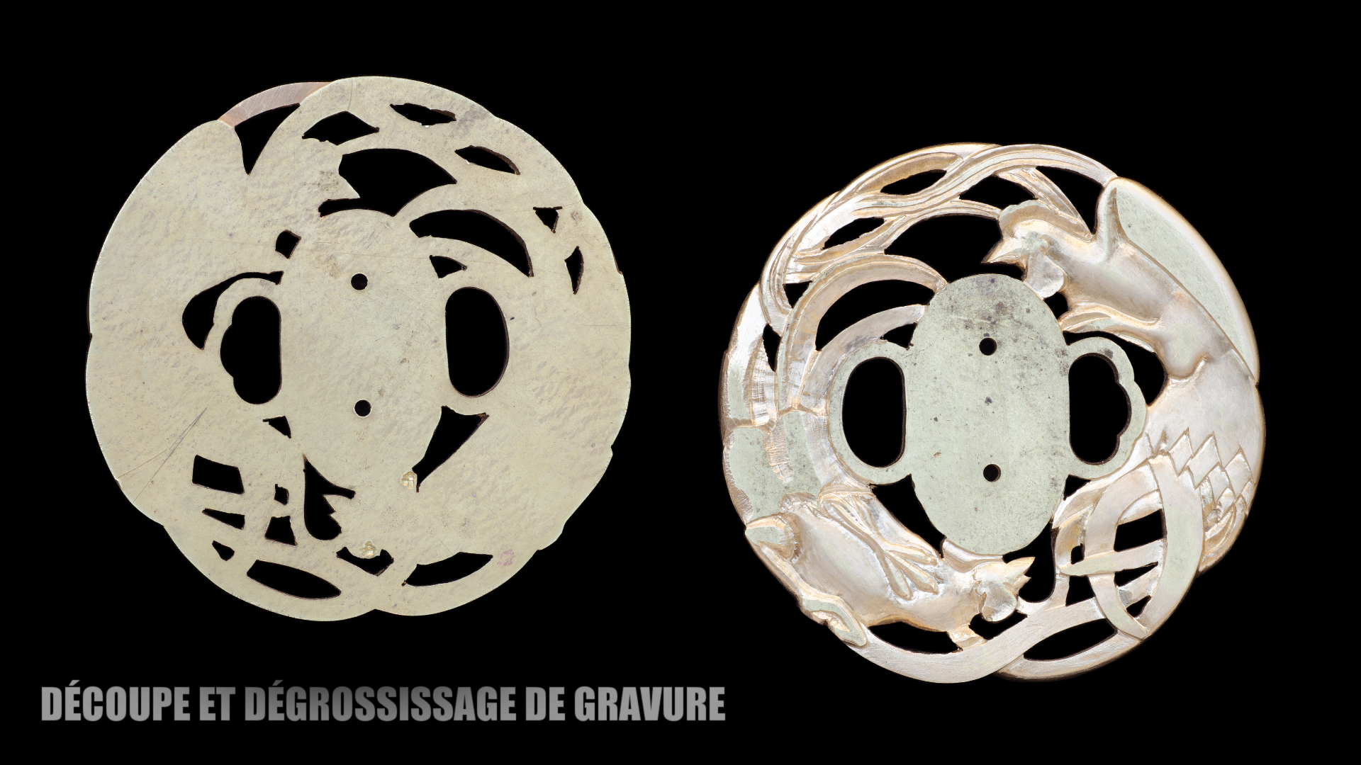

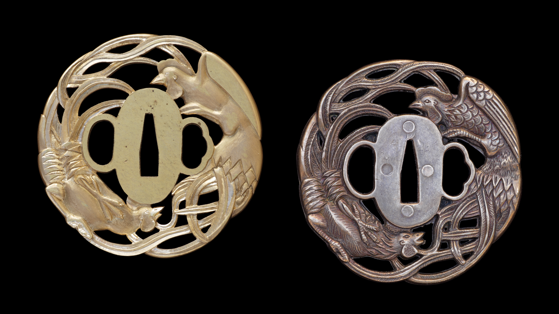

Not really a big accuracy issue, but I added gold in the rooster eyes, to make the tsuba a bit nicer, and closer to original japanese antique stuff.
