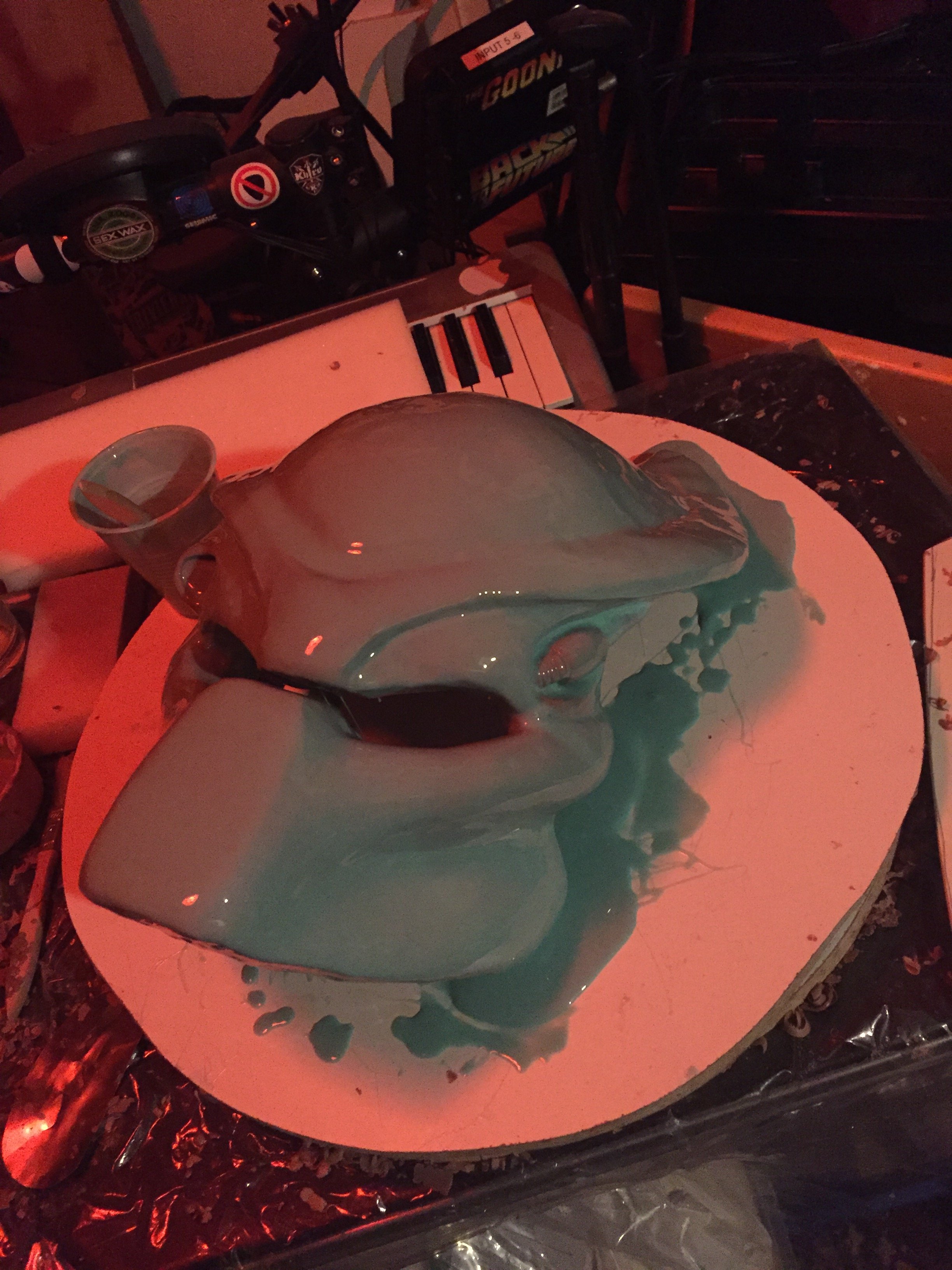

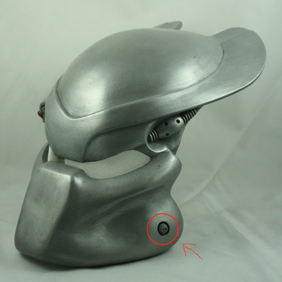

So, I am pretty confident that I have gone as far as I can with the basic shape. Im pretty psyched with it compared to my previous bio, and I spent waaaaay more time with this one. So now, i plan to refine the "wings", as well as continue to smooth the surface. I am going to cut out the laser sighting area so I can sculpt , mold and cast the insert to properly sight the lasers I have. Then the little head tube connections and finally the little button/port in the corner of the lower left jaw. So in otherwords, the details of the bio. After casting, I have a pretty awesome sheet if perforated aluminum for the lens. Should I paint it black?....or leave it metal? Who knows.

Thanks jmen! I think I am going to finish it off for casting. Its not exact like I intended, but I think its at the limit of my abilities. Im pretty happy witb how it looks. Thinking of doing a black cast with aluminum lens. - that would be a killer look! Im happy with mine not being exact now. It my own version, and is unique in that way. Someday I will do the exact P1 bio.;)

And so it begins. Going to be experimenting with metal casting powders on this bio when the mold is finished. I have on order, aluminum, copper, iron oxide and iron/steel. Going to start with black resin with the layer of metal on top, which can then be polished like real metal.
For new folks like me- when you sculpt your bio, and you have spent countless hours put in to get it just right, although you may be excited to get right to casting, spend time on your mold. Take the time to make it thick enough, so that it is rounded out and wont get stuck in the plaster mold. Make sure the edges of your bio are molded a bit underneath also, to avoid spilling resin when slush casting. Spend a couple days at least, to make that mold perfect. No matter how good your sculpt is, it wont matter without a great mold.
