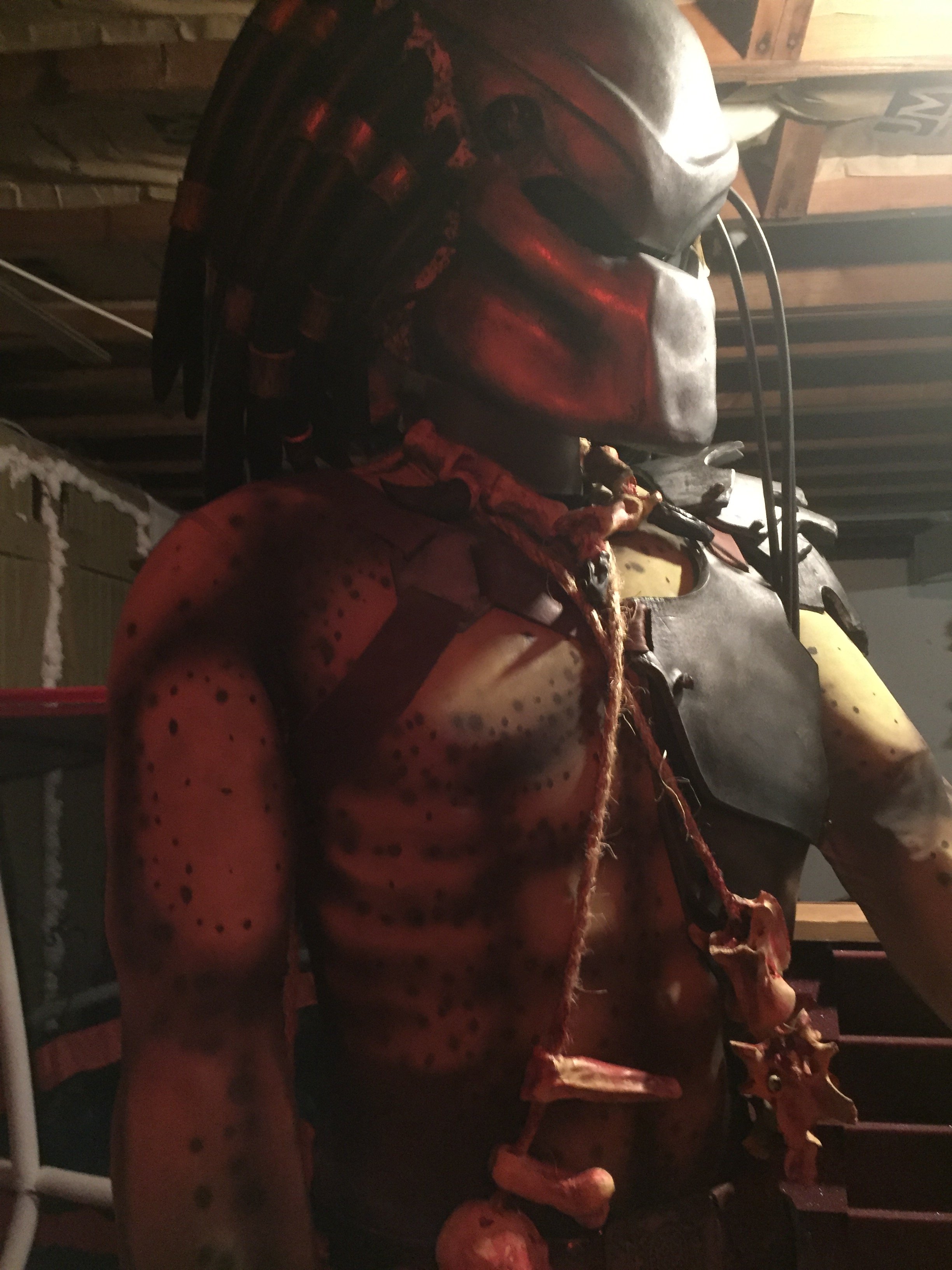

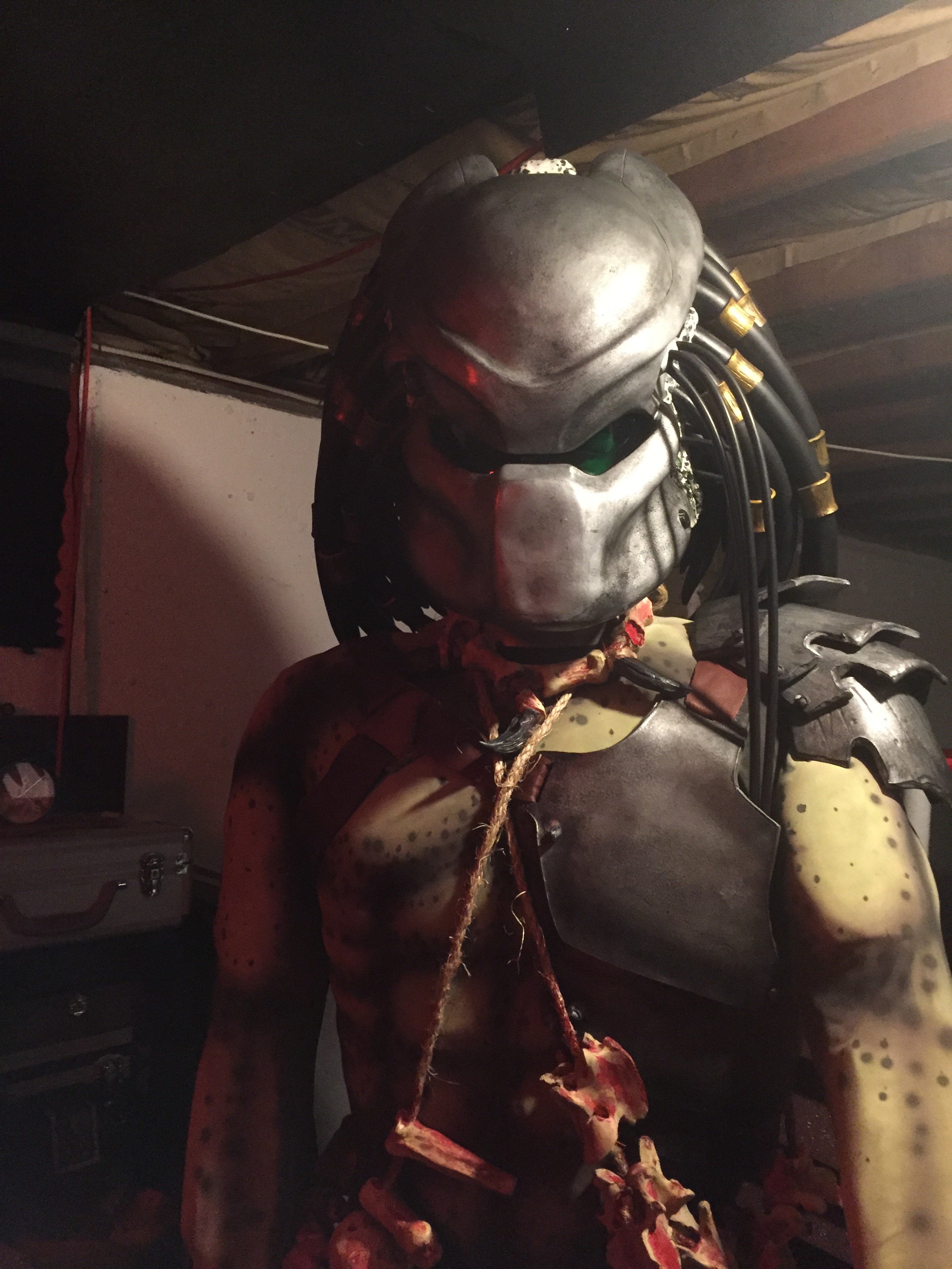

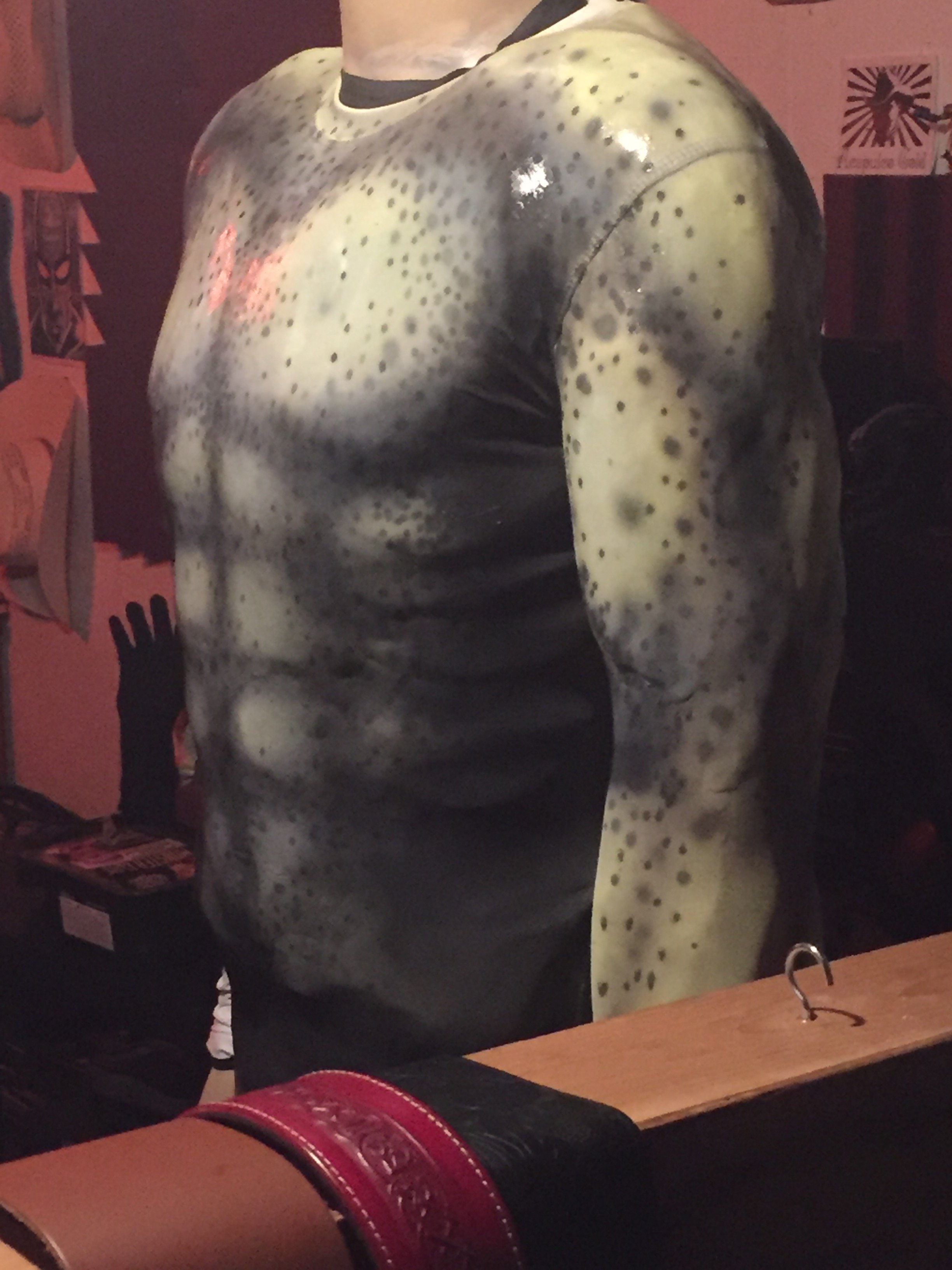

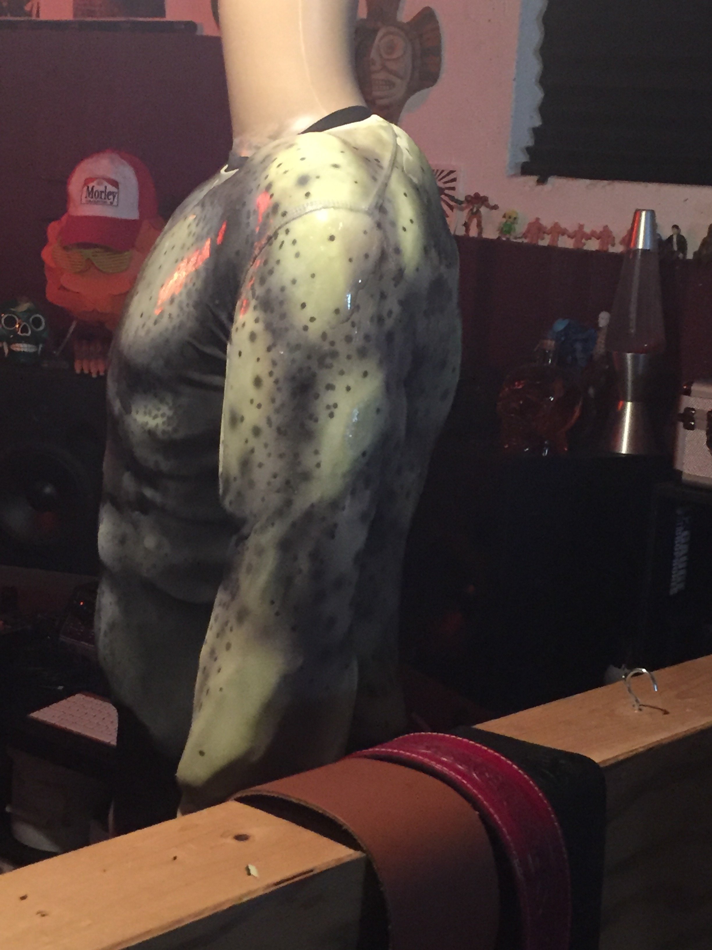

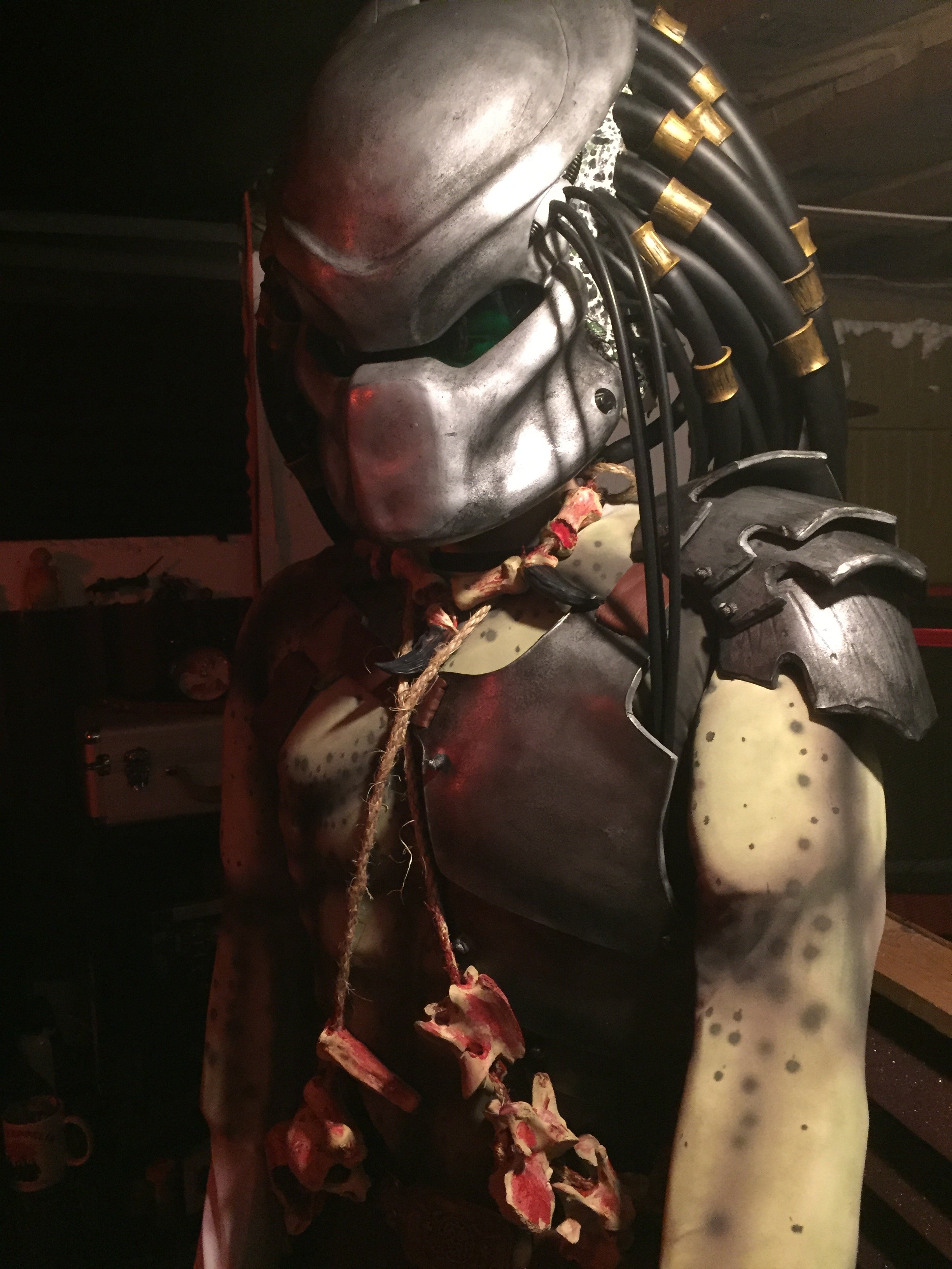

So I managed to snag a decent bio finally, and it led me down the rabbit hole of costume fabrication. Most of the techniques I used were brand new to me, and sourced from home depot, walmart, amazon ebay etc. learned to use sintra, and started learning the airbrush. Also used caulking as an alternative to theatrical silicone. Anyhow, here are some pics. A long way to go, but just about halfway there. My lift boots bring my Pred up to about 7 feet, from top back of bio to floor. Very fun learning experience. Also, props to Vinmac? For some of his templates. (Shoulder guard from avp)

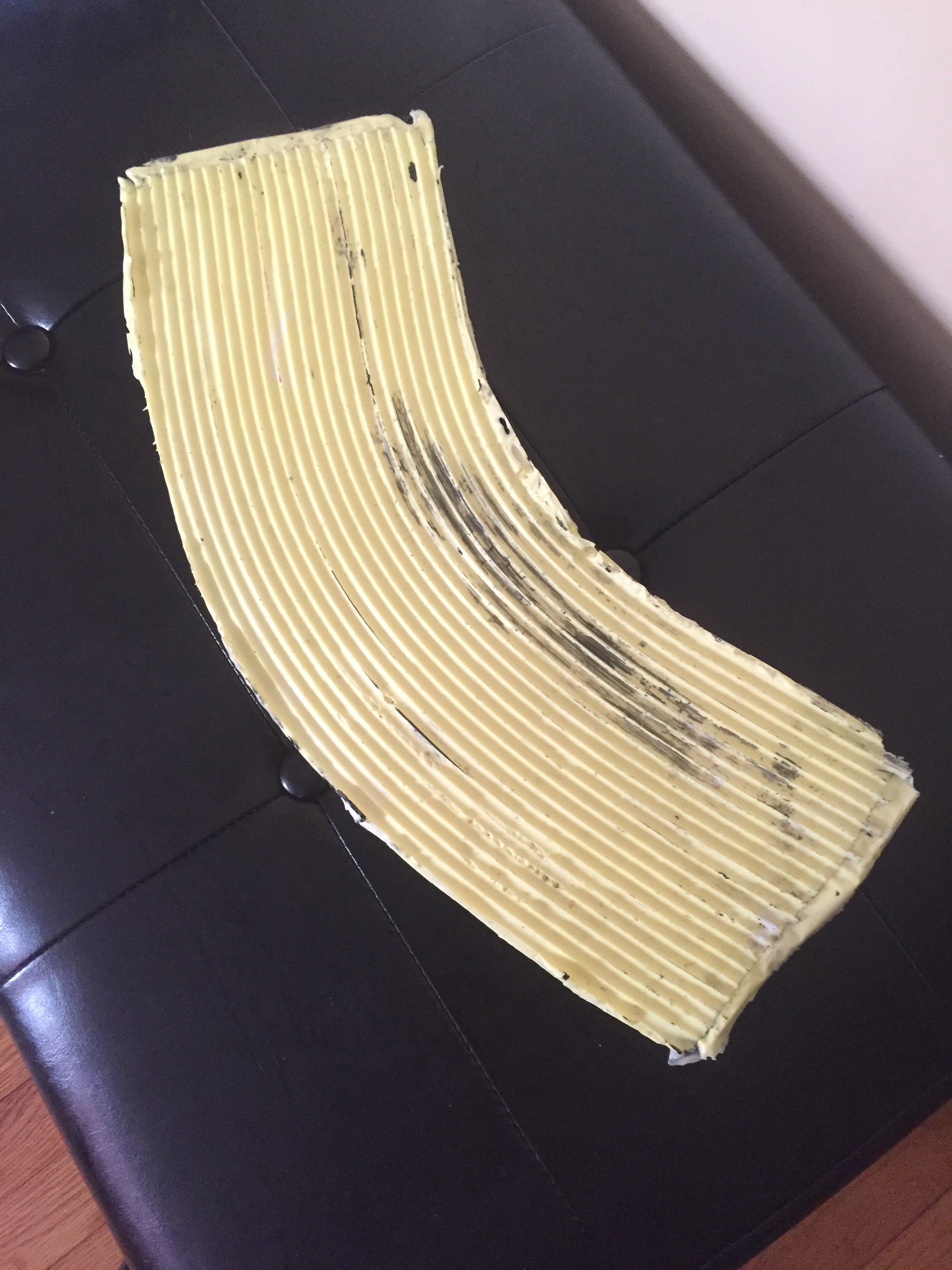

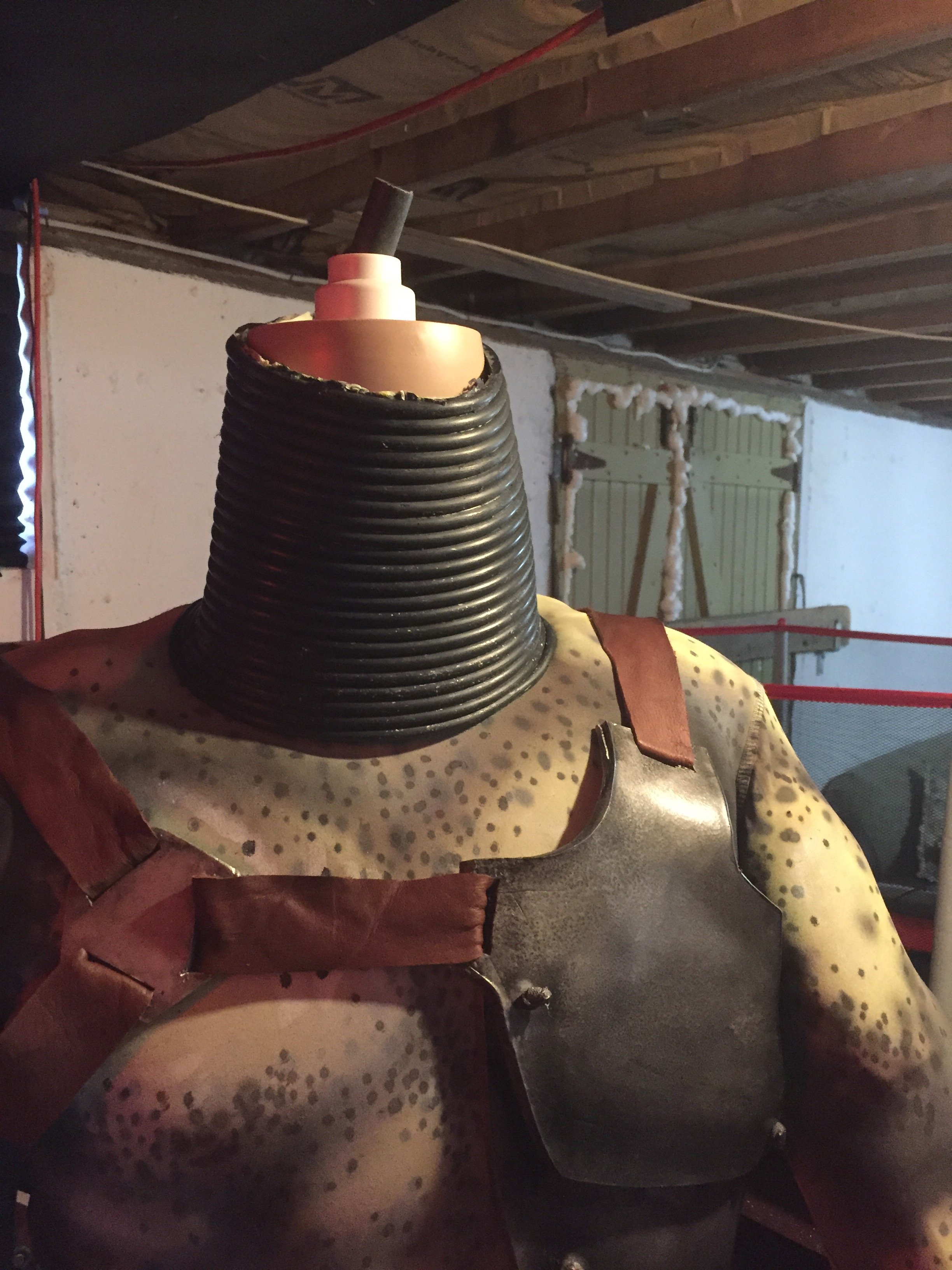

Also, a question for folks. What did you end up doing for the pred neck rings? I had a build with silicone tubing which failed, and I am planning on sculpting a monster clay flat neck ring peice then casting in black silicone. Anyone use any easier/cheaper or simpler solutions? This is one of those parts of the puzzle that I found to be a pain. More than the other things so far anyway haha. Suggestions are greatly appreciated!! Thanks!
I've seen some people use backer rod, but you are certainly going with the best choice making it yourself (through sculpting/ molding/ casting).

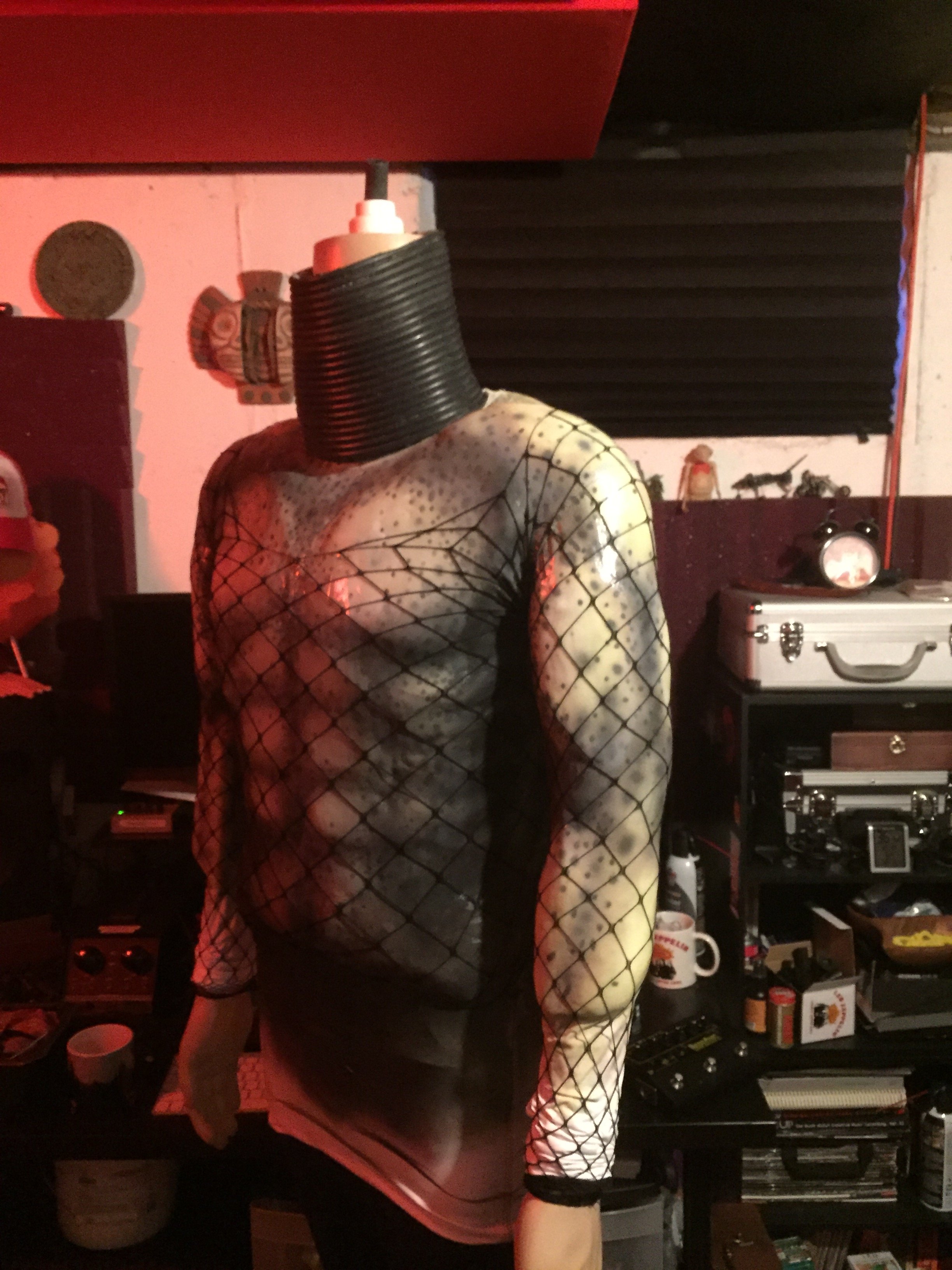

Sorry, just read the community rules, and although relevant, my pic was "overtly sexual in nature" my bad. Anyway, it was a lady in a net body stocking that i am going to put on my pred. Stretchy, so it should work ok.

For the new folks like me, this was silicone tubing glued to a flat surface, arranged in a slight semicircle. Then molded with silicone, painted with vaseline as release agent, then pigmented silicone for the cast. I ended up casting because the tubing would not stay glued no mayter what I used
