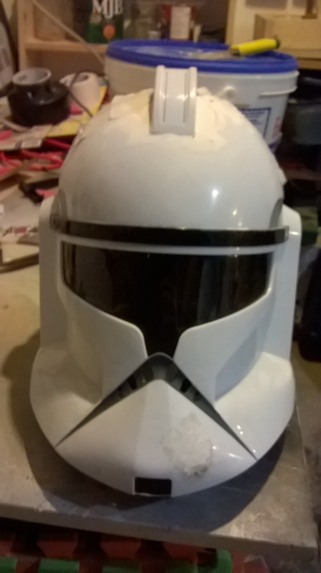

My Early Disasters pt 2 - A Biker Scout Helmet - How hard can it be?

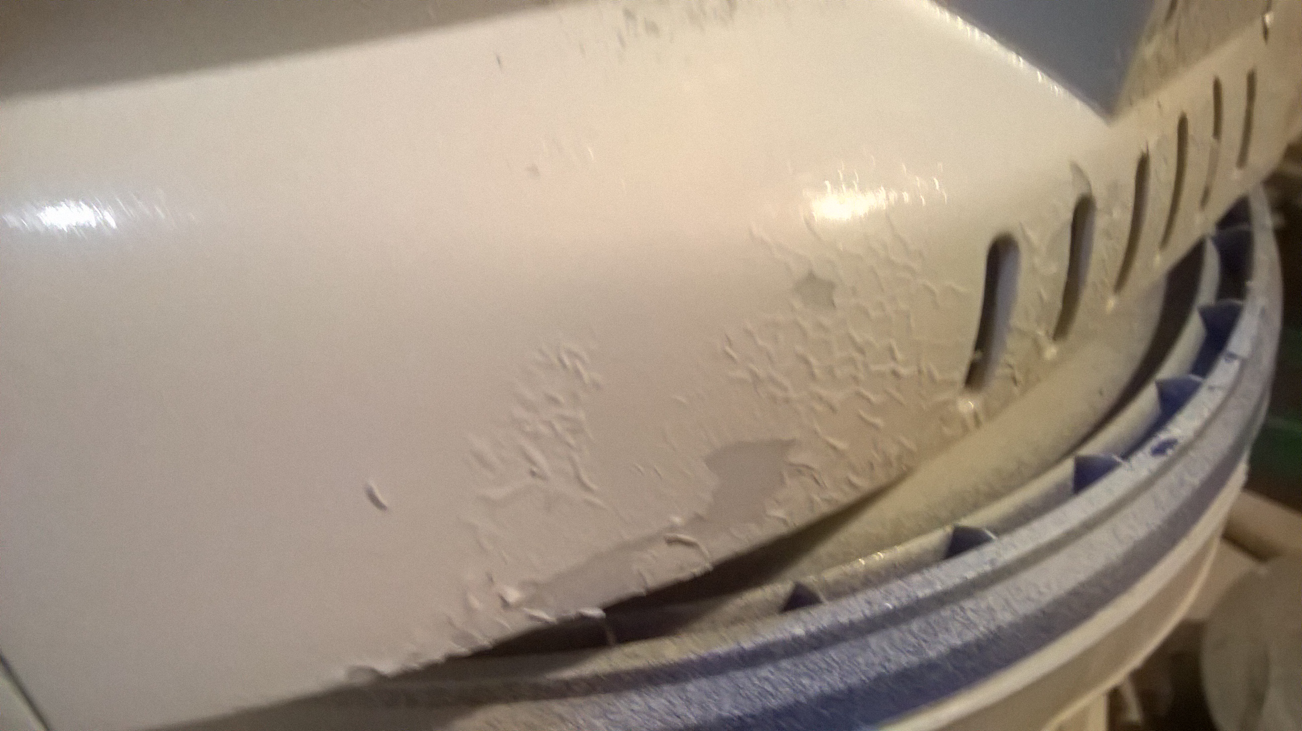

Heh. Who would have thought I could add in a new screw up this late in the game? I found a spare can of white spray paint kicking about, so I gave the whole helm another coat while waiting on the next phase and.... It crinkled. I believe this happens because of science.
Sanding and respraying might help... Hasn't so far. Really annoyed that this might ruin the project and add more time to the completion date. I have a hankering for a First Order helmet, and that's going to be very tricky (Planning another Atlanthia-style bargain basement build, rather than buying the base and modding. Because, you know, money....) Also, I'm supposed to be knocking out a Halo Helm because I bought that visor months ago. That's a long list of things to screw up and I still haven't finished wrecking this one yet.

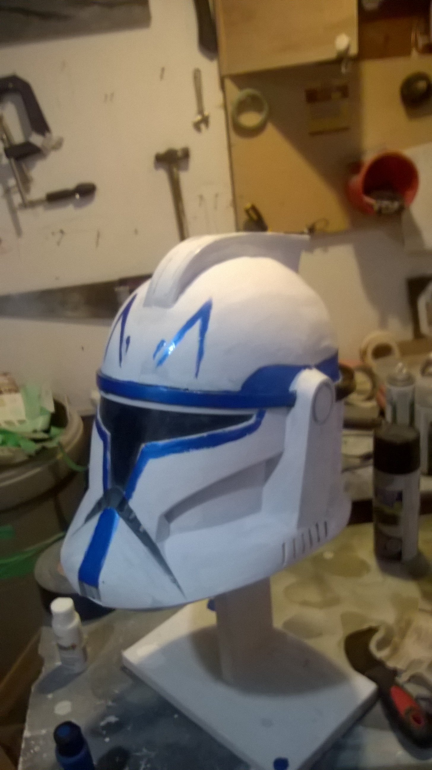

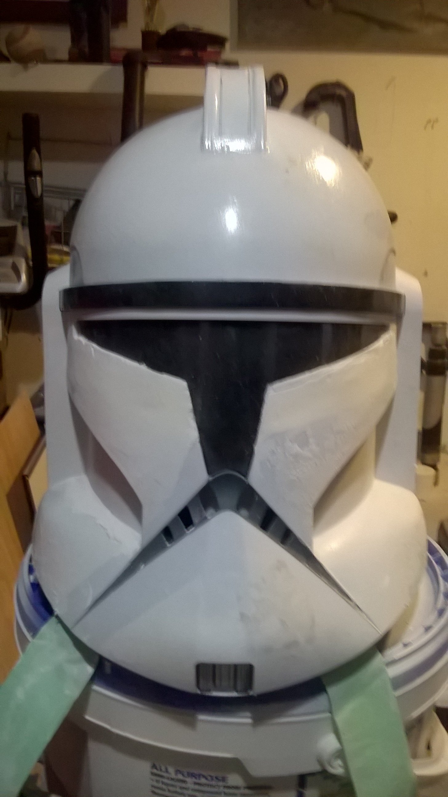

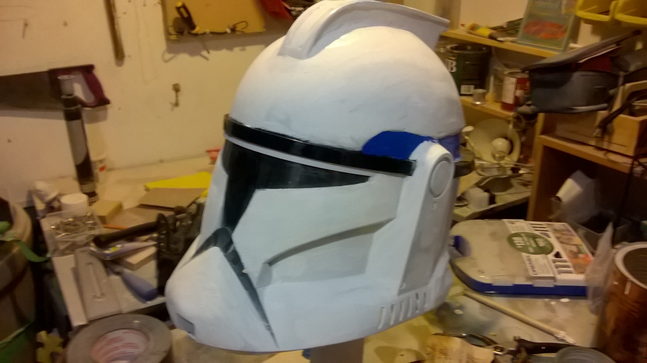

To combat the crinkly glooms, I took off the masking tape to see how the visor-alteration has worked out. Not bad, is the answer. First, the helmet as was:
Now, the helmet as is:

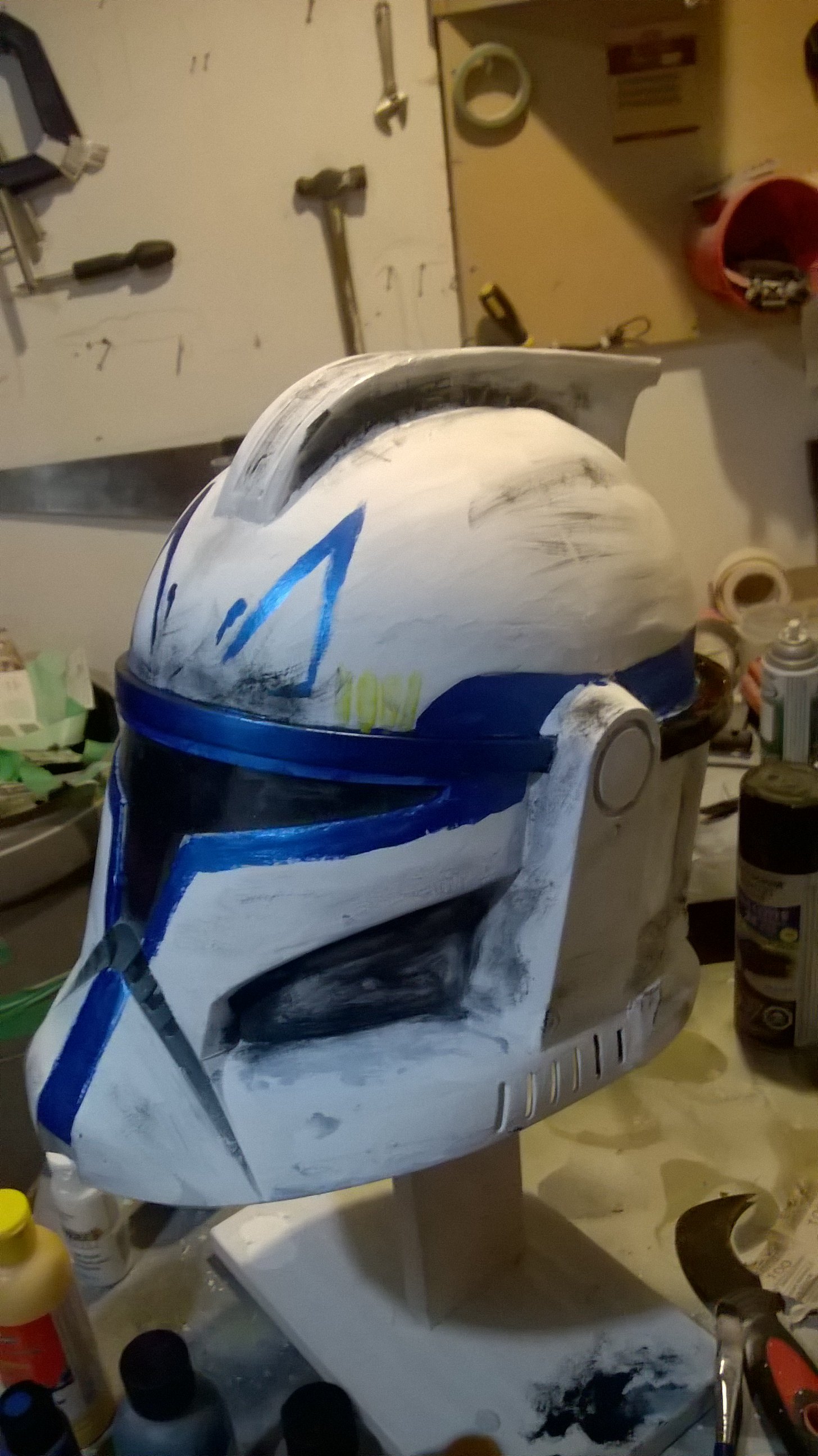

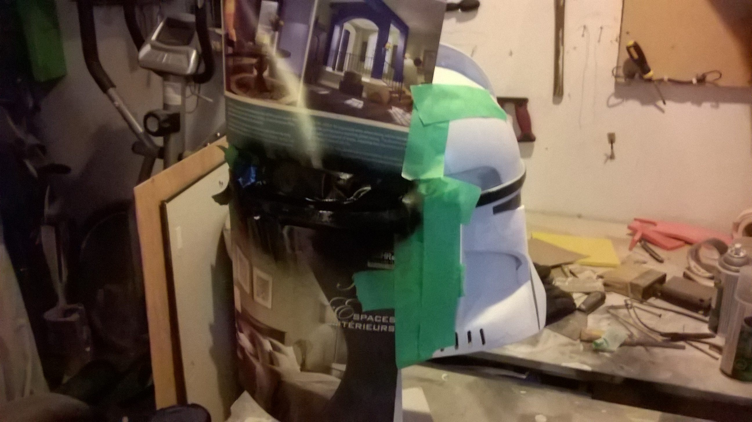

And that's what I'm going with. Stage One, get the black bits back to black.... Mask and spray!
And then start painting in the blue...
More painting with better brushes after next week - they actually want me in work almost EVERY DAY... Have they no compassion?

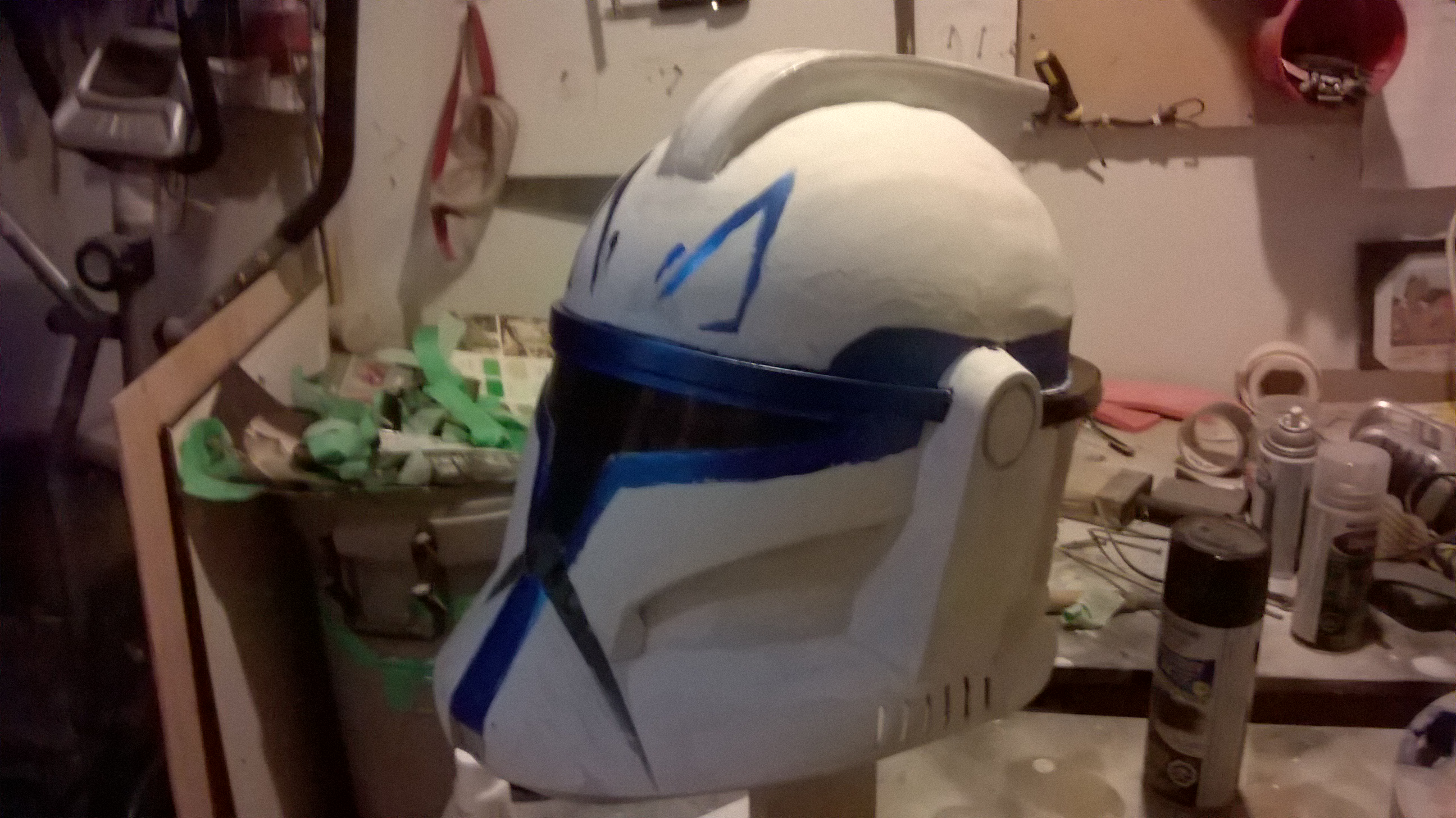

I remembered this evening about grabbing five minutes here and there, and got some more painting in. The fact that the art style of The Clone Wars Cartoons is heavy on the brush strokes means I don't have to be too precise with my own brush work.
Damn that sideways upload! Will I never learn?
The irony is that the bits I just sprayed in black are actually blue, according to my reference pic:

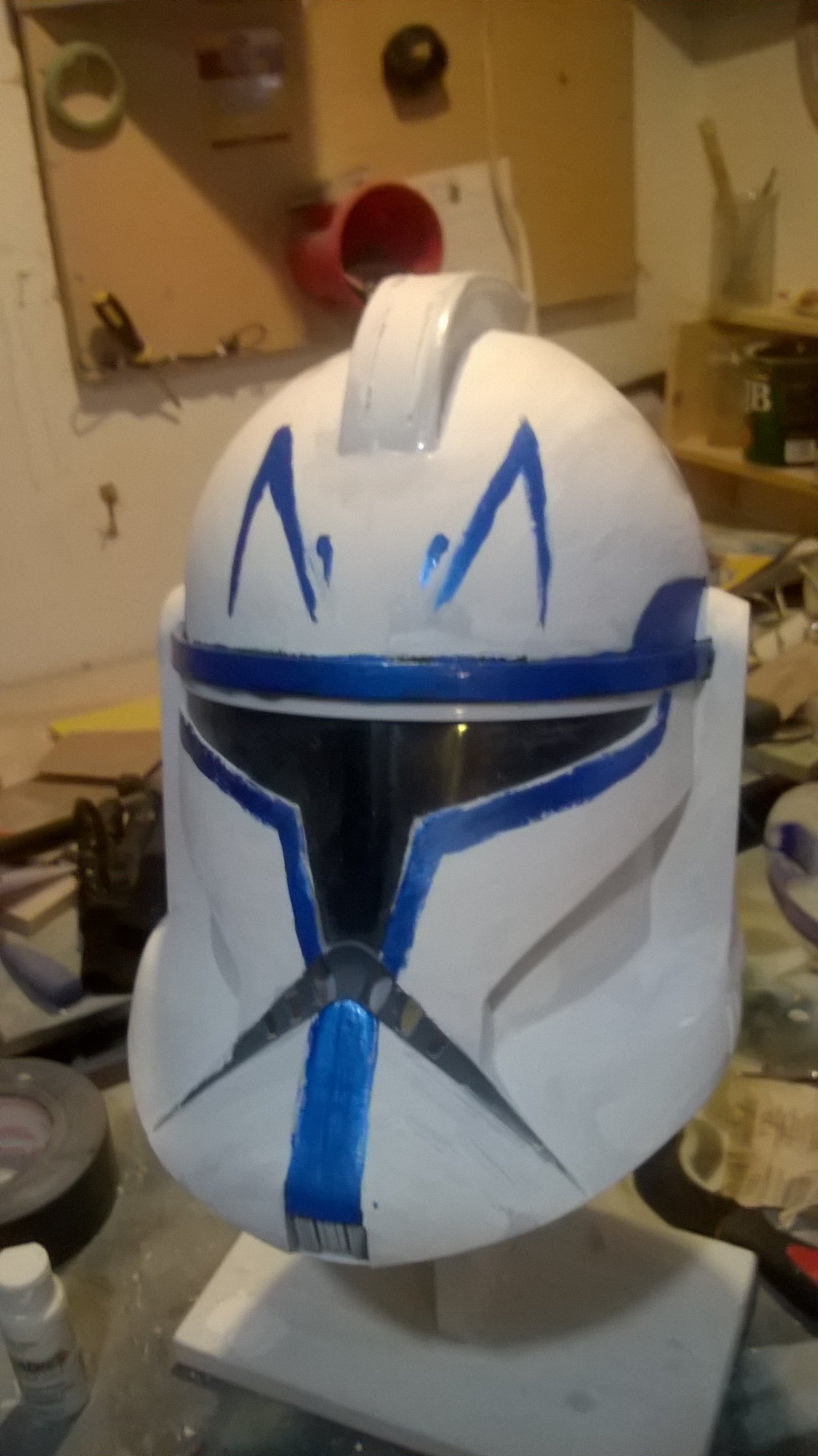

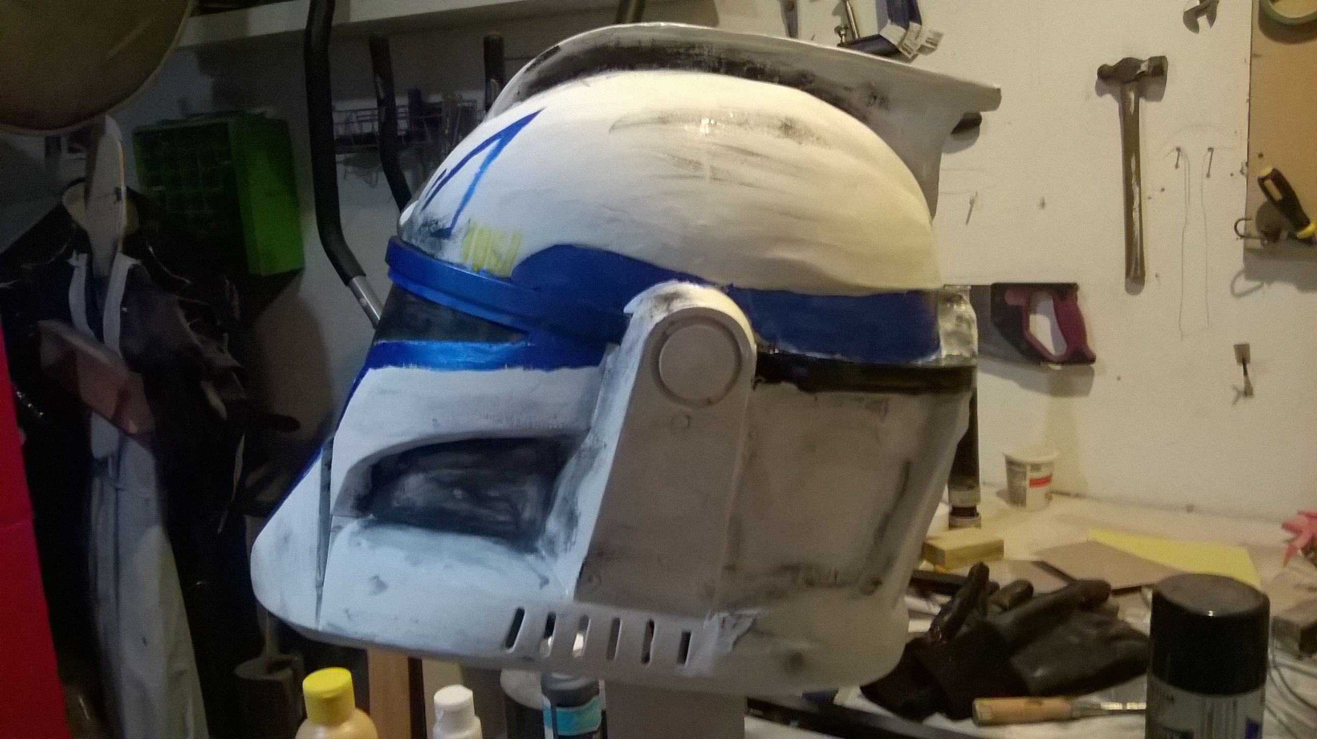

So a couple more brush strokes, and some careful sideways photography, and things are looking up. Next step is to dirty up the recessed areas a little, and add the yellow stripes. Then give some serious cogitation to the matter of the viewfinder.
Certainly not going to just bash together any old rubbish and hot glue it on, no....
Duplicate post removed!

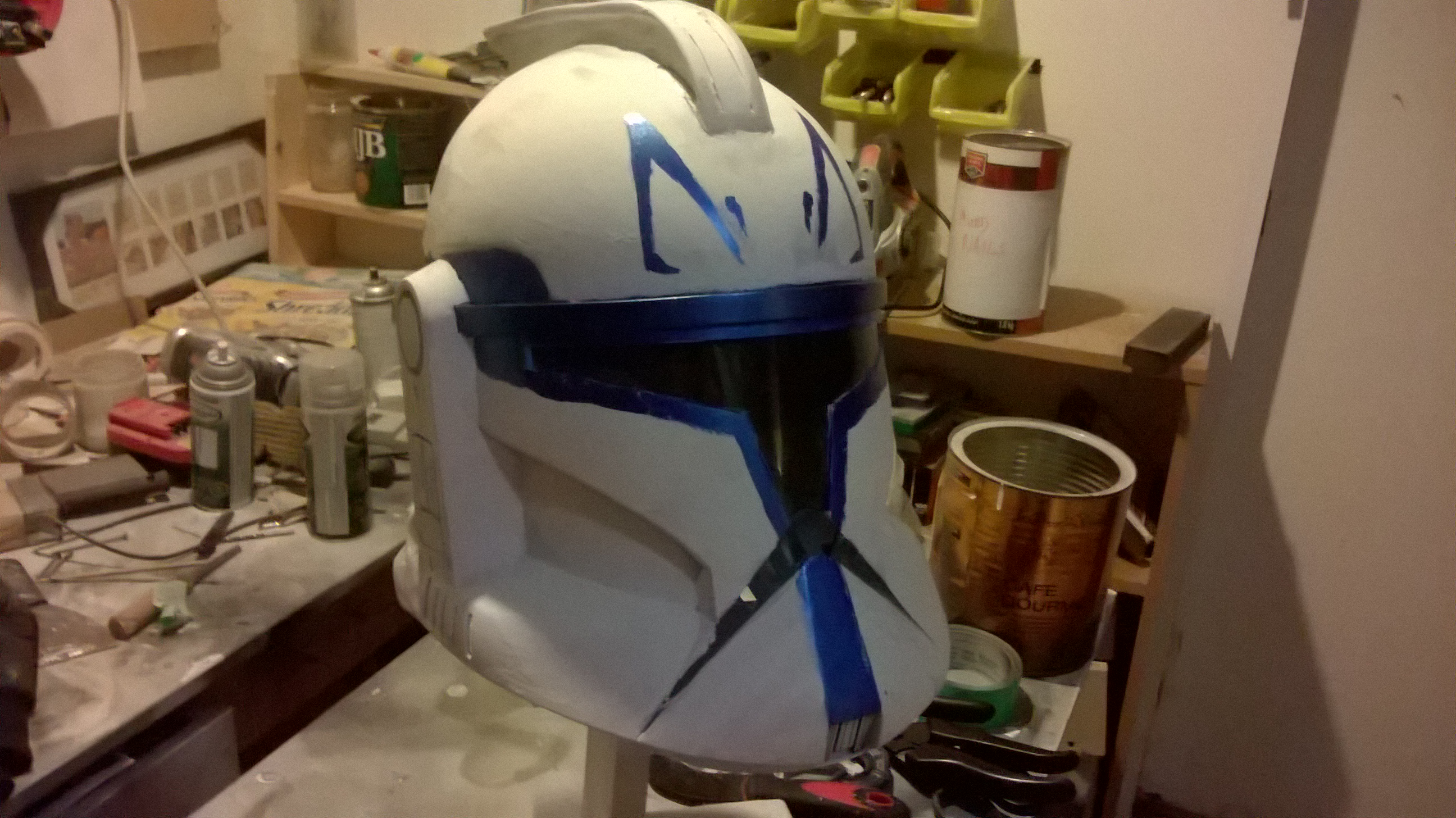

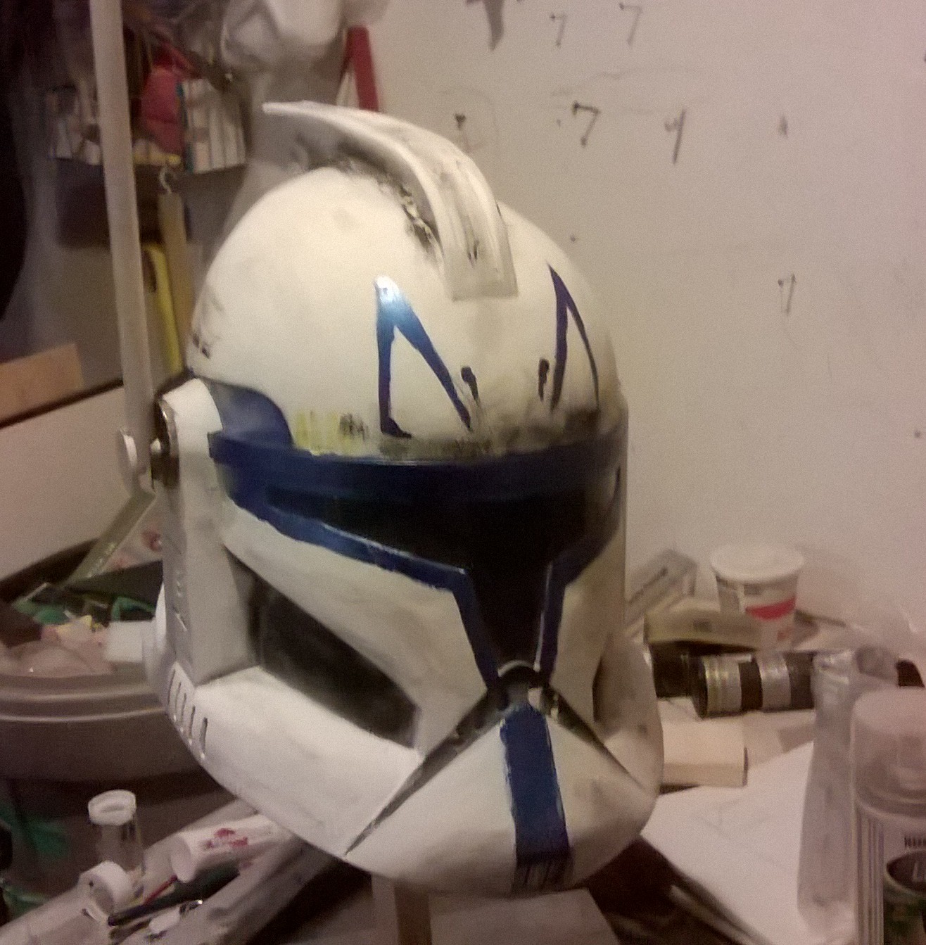

Following that, I added the yellow and the dirtying, but haven't finished the blue paint around back. Or had any sensible thoughts about the rangefinder.

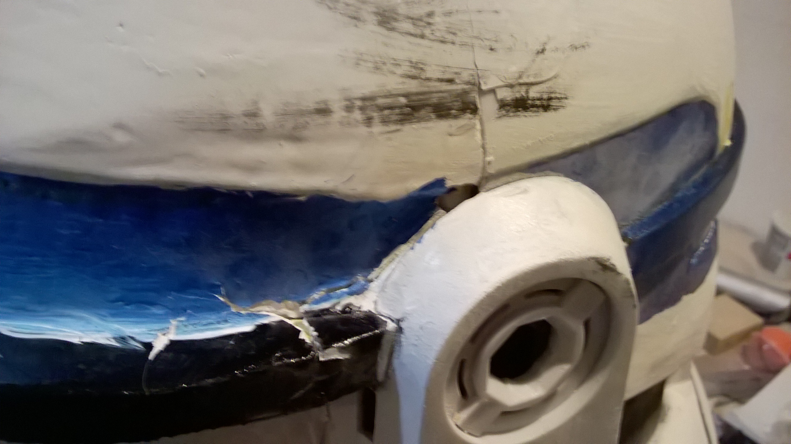

Turns out, drilling into the side of the helmet has cracked some of the oh-so-careful surfacing work I did. Bugger.

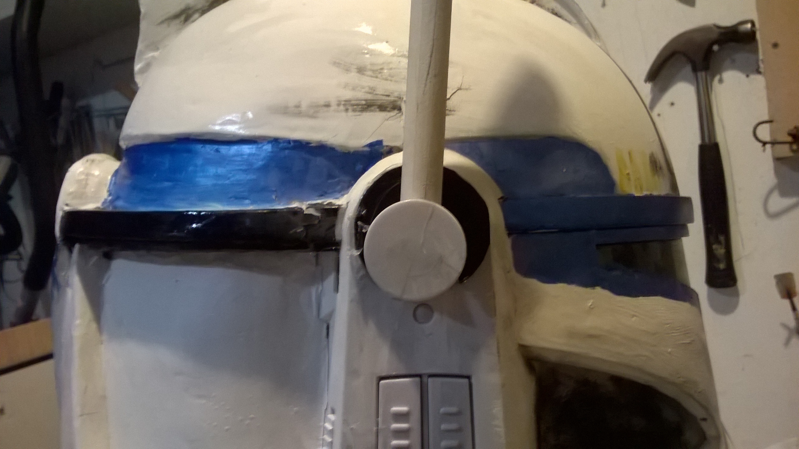

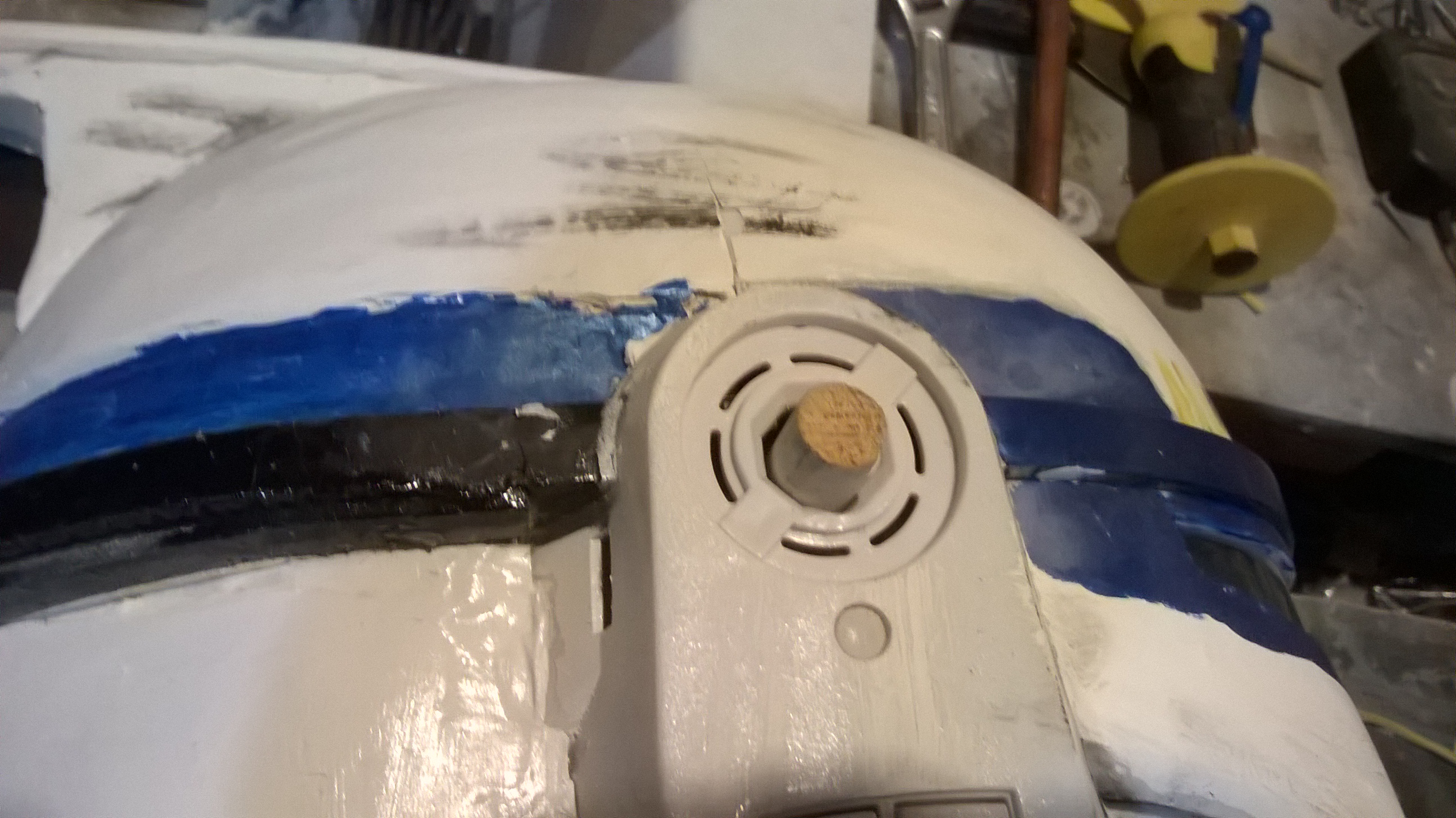

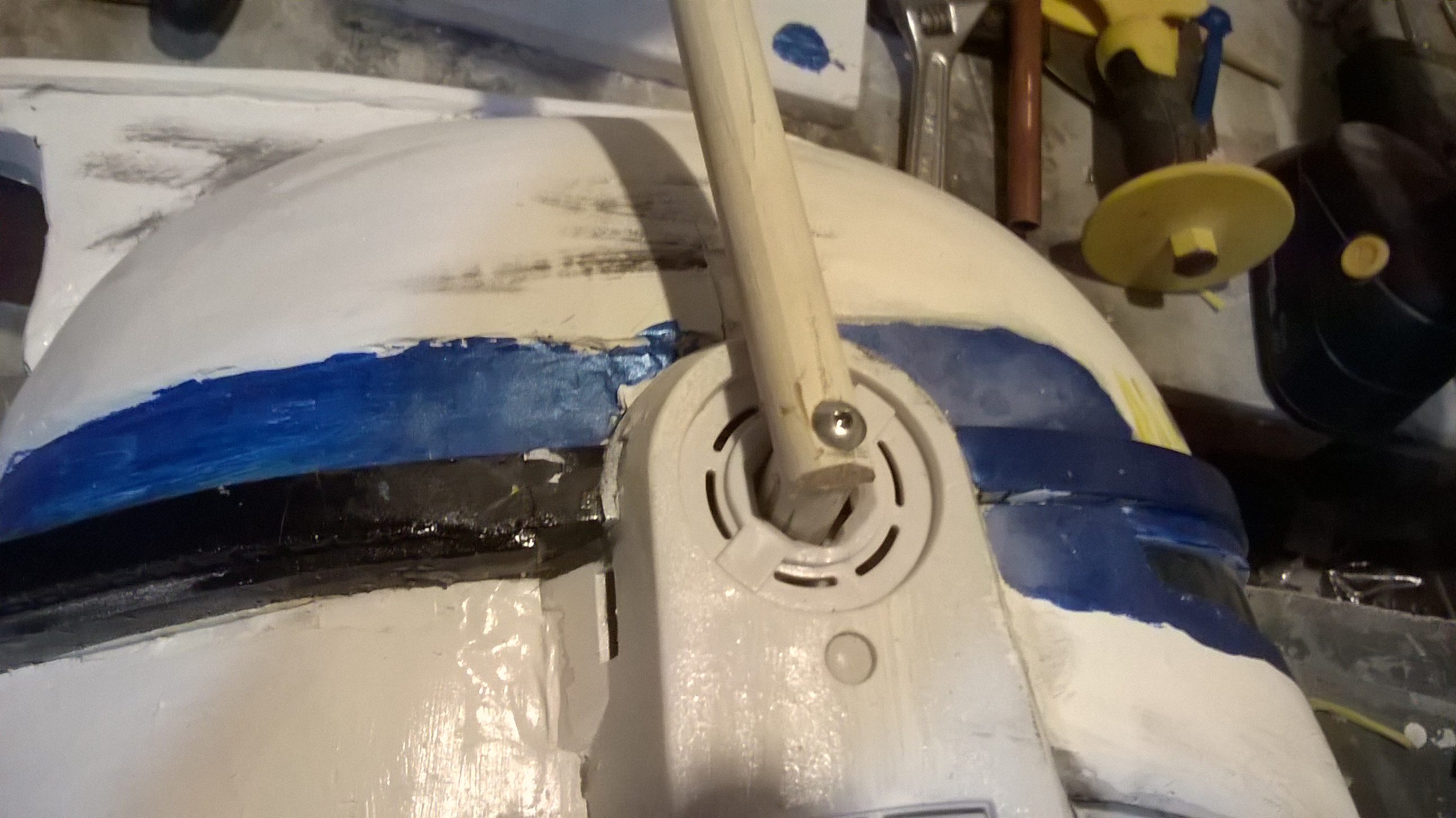

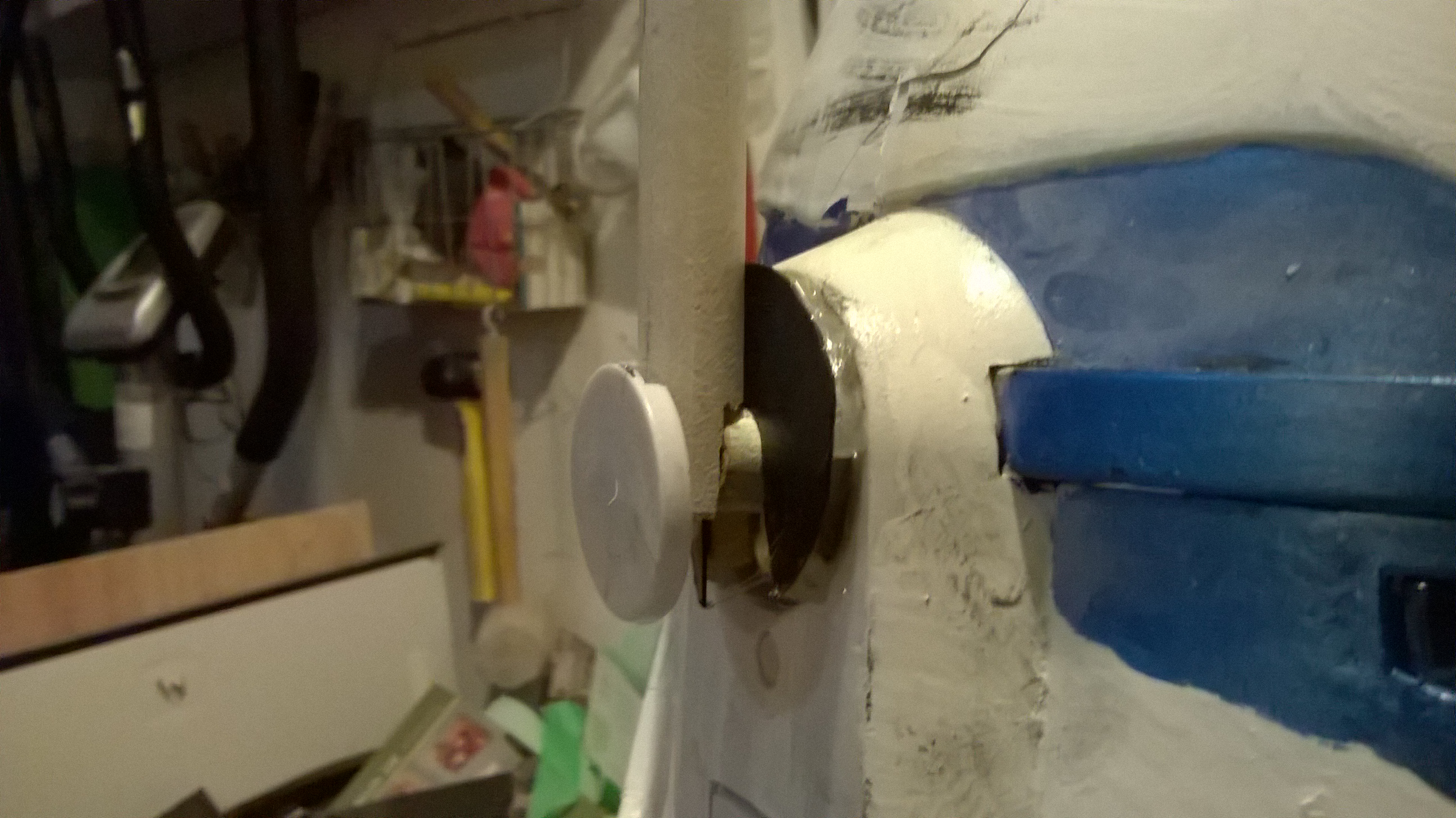

The last time I checked in, I'd cut a small piece of dowel that would work as an axle for the rangefinder arm to swivel on. I had a longer piece of dowel to make the arm. Today I drilled into one end of the axle and fitted a small screw that would work as a stopper, allowing the axle to rotate only 90 degrees - either up, or forward.
You can't see the screw in this photo because it's on the other end of the dowel, obviously. I cut a notch in the end of the rangefinder arm, and then screwed it to the visible end of the axle.
Then I cut a circle of flooring foam and glued that around the axle. Then I cut out a disc of hard plastic from a coffee can lid and faced the foam with that. That worked as a shock absorber that stopped the arm wobbling (mostly) as it rotates. Then I glued the original disc I removed from the side of the helmet back onto the rangefinder arm.
And that's where I stop for now. Hope to get back to it before February.
