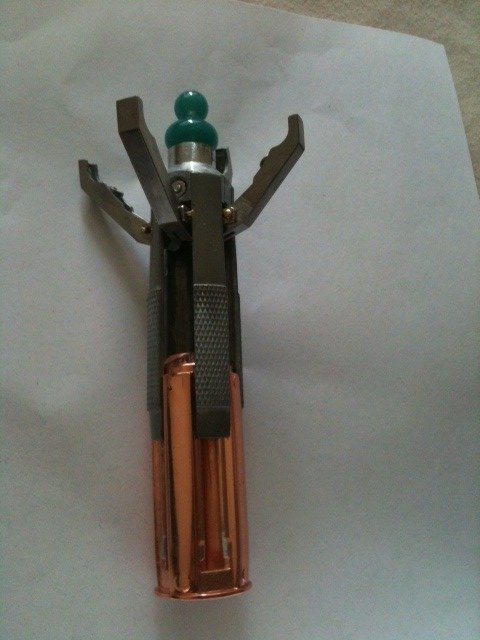

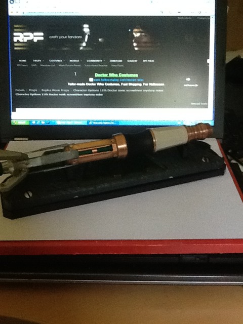

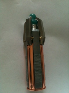

Here are a couple of photos

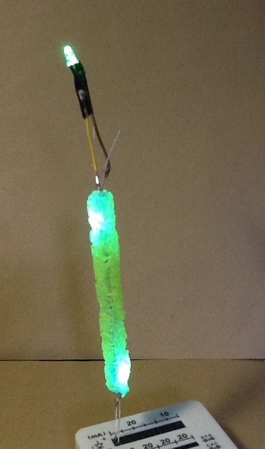

And a photo of my emitter ' core'
