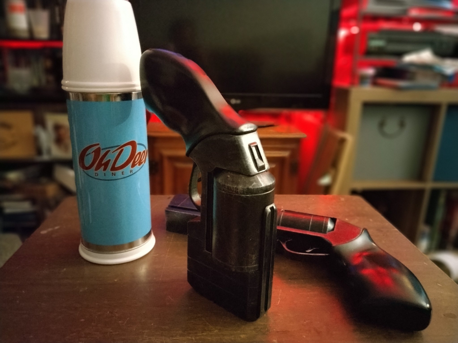

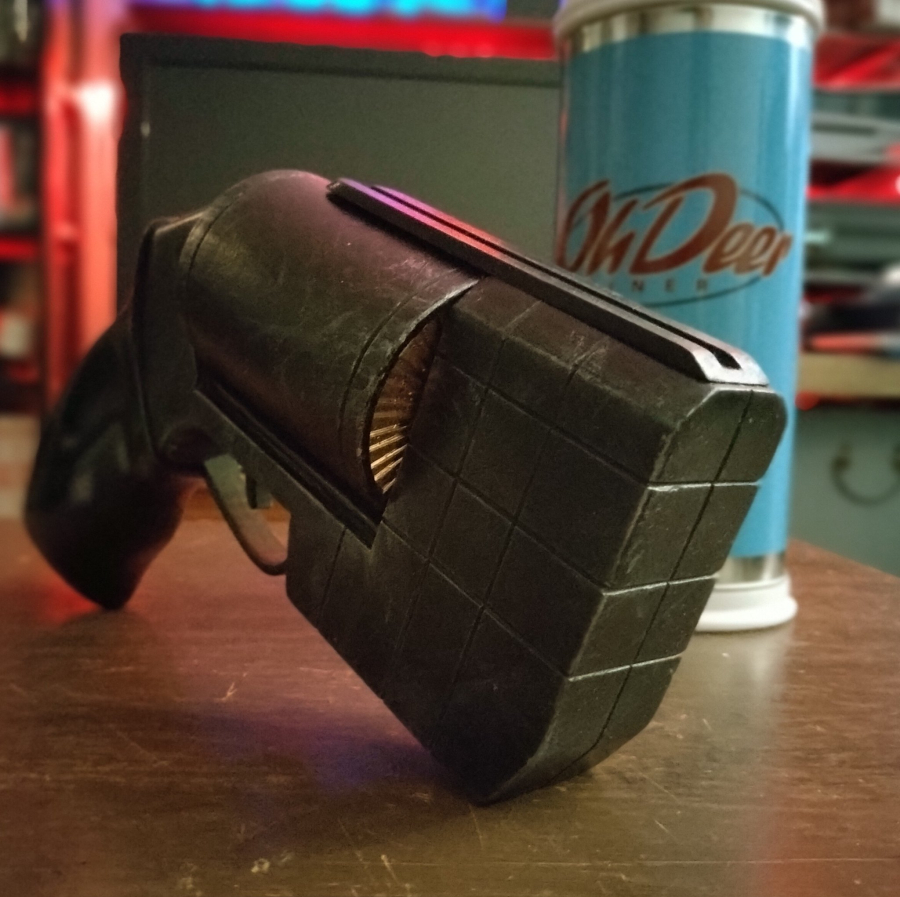

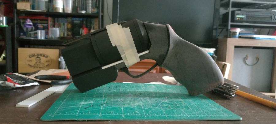

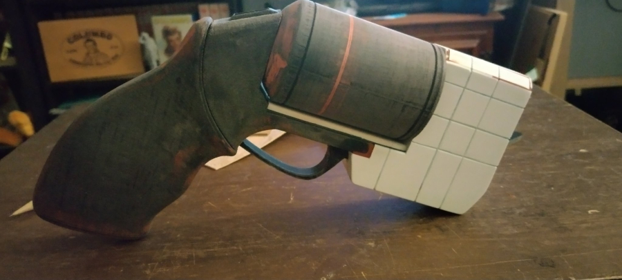

Modified a Thingiverse file I found into the Shatter version of the Service Weapon from Control. I cut off the top that normally holds the cylinder and made the cylinder bigger, just judging it by eye. I elongated the sight and only printed the first bit of the barrel. That's really it for the 3d printed, I did print everything else at 110% with the exception of the trigger.
Then I built up the barrel with styrene, I had to make sure to cut the barrel part I printed by 1.5mm on both sides so it would sit flush with the rest of the housing. Scribed the panel lines (one side is a little off so it's not the hero side), filled and sanded a few rounds, and then painted. All in all, about a 2 and a half day project.
