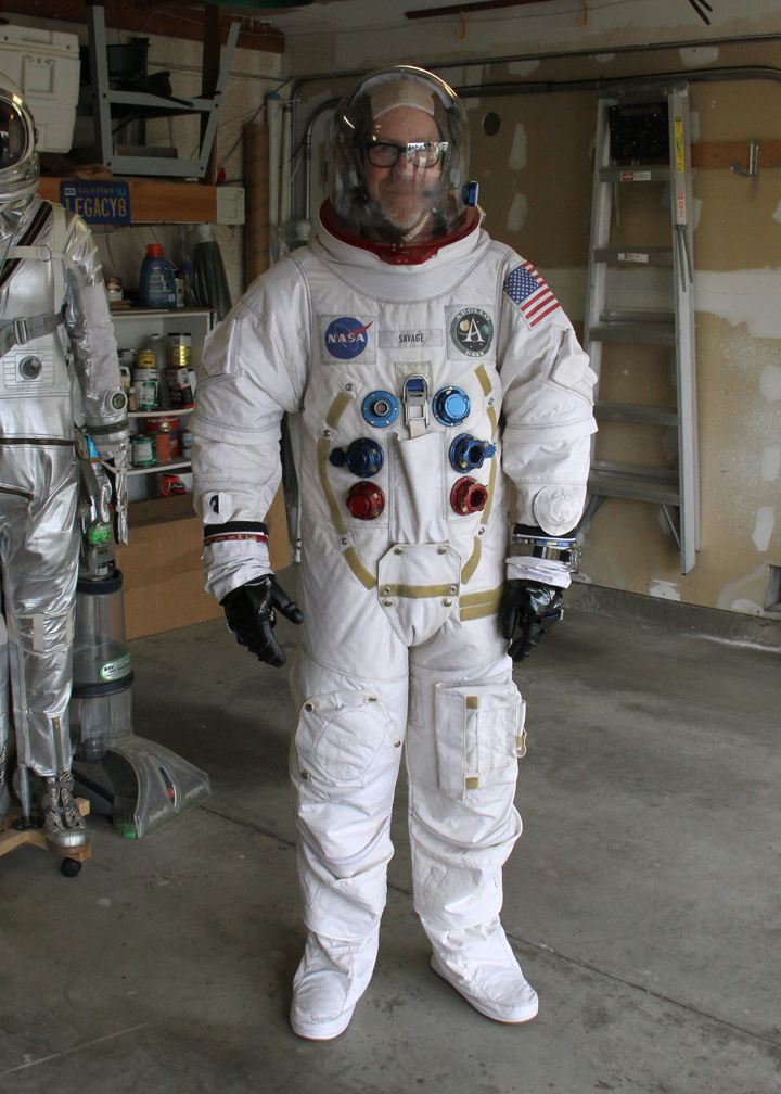

Just a quick post about how I weathered the suit. I was going for just a light weathering--something to make the suit look like a real piece of hardware, but not super dirty. Here are the clean boots I finished:
I used to coffee dye things, but unless you really wash it out it afterwards, it tends to get splotchy water marks if the garment gets wet (i.e. you sweat in the costume). So I made a mixture of diluted airbrush paint that pretty much has the same effect of browning the fabric a little, but it's permanent. I spray it on thoroughly, blot it up with a towel, then let it dry. The result is a pretty subtle yellowed look. It doesn't even really show up on camera, but if you hold it next to a clean piece of fabric, you can definitely tell the difference.
After the paint dried, I dusted on my own mixture of simulated lunar dust. It's a mixture of talc, charcoal, silver mica powder, and portland cement. After I dusted it on, I throughly cleaned it off. I was kind of going for the look of the suits you see in the Smithsonian. They have remnants of lunar dust build-up in the seams, but they've been cleaned:

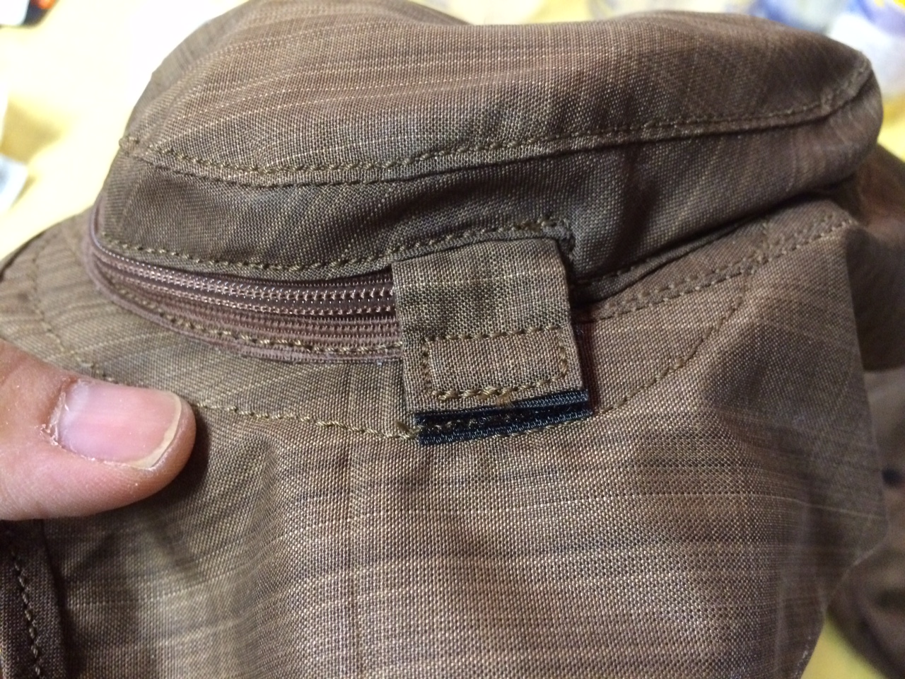

Now that Adam's suit is done, I'm going to make my own suit as well as tackle a few commission builds. The first is the MOST accurate Snoopy cap I could possibly make thanks to @Seatra, who provided me with some plaster casts of the kidney-shaped headset of a real Apollo-era communications carrier. There was some warpage with the castings and the front ends were damaged/missing, but I recast them in resin, cleaned them up, and rebuilt the front ends. Can't get more accurate than this!
The goods news is, I was pretty close with my original sculpts so the pattern I created does not need to be altered. The profile is nearly dead on, though the real headset cups are a little deeper and there is an ear-shaped cavity on the inside that I did not duplicate on my first version. You can see the real castings next to the ones I originally made in blue foam:
@Seatra also provided me with a very small amount of the actual teflon fabric that the real caps were made of. As you can see, it's a very unique looking fabric. I custom-printed the crosshatch pattern on my first replicas and it looks pretty good, but nothing beats the real thing. Unfortunately, this fabric is no longer made, so these are the only two caps I can make like this:

I finished the communications carrier (snoopy cap). This one is a commission for a member here, but mine is nearly identical. I made castings of real Apollo-era snoopy cap ear kidneys in flexible urethane foam, so they're spot-on. I also used the 100% correct vintage PTFE fabric for the brown parts. This fabric is no-longer made like this, so this is the most accurate snoopy cap I could ever make.

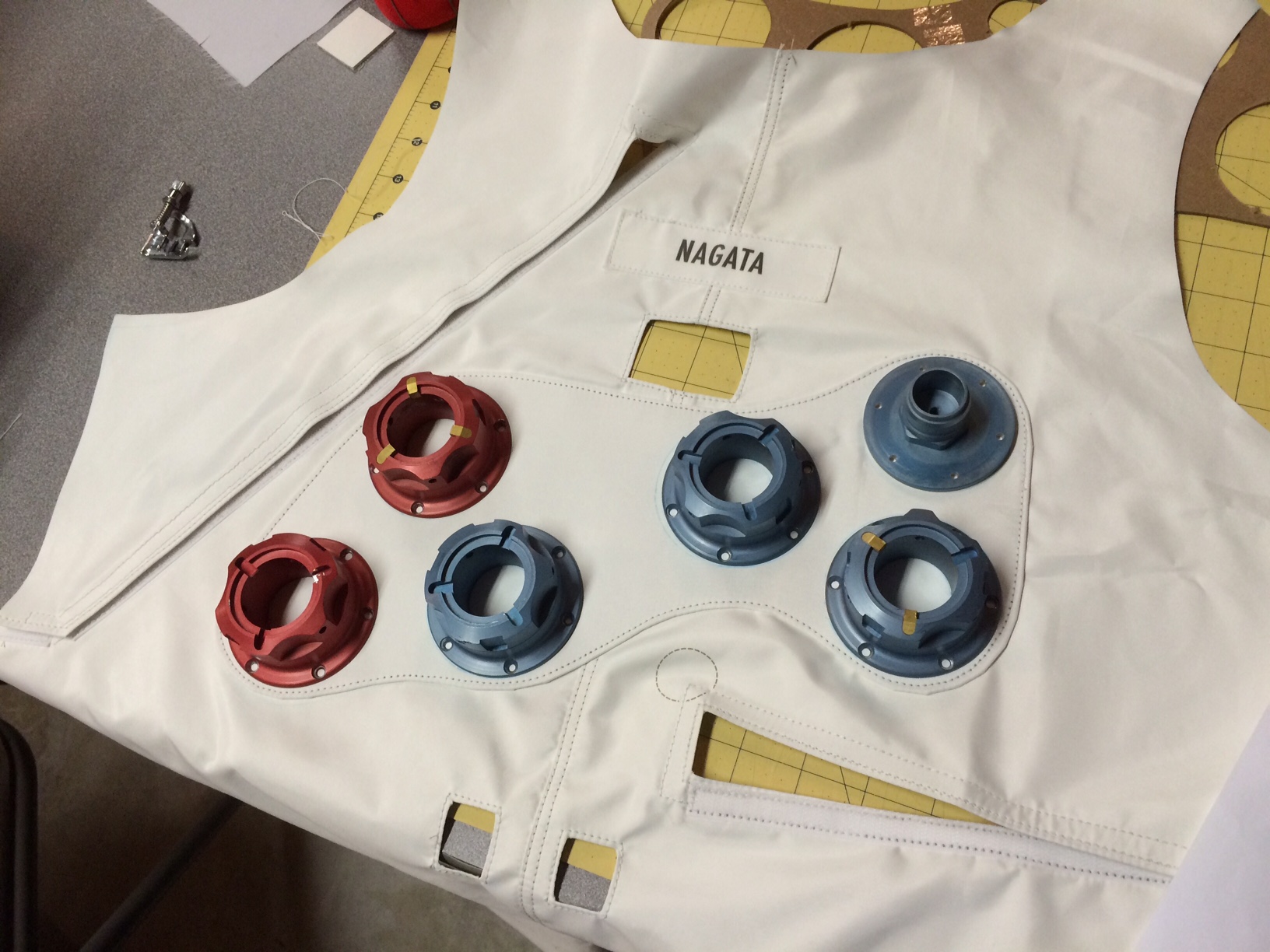

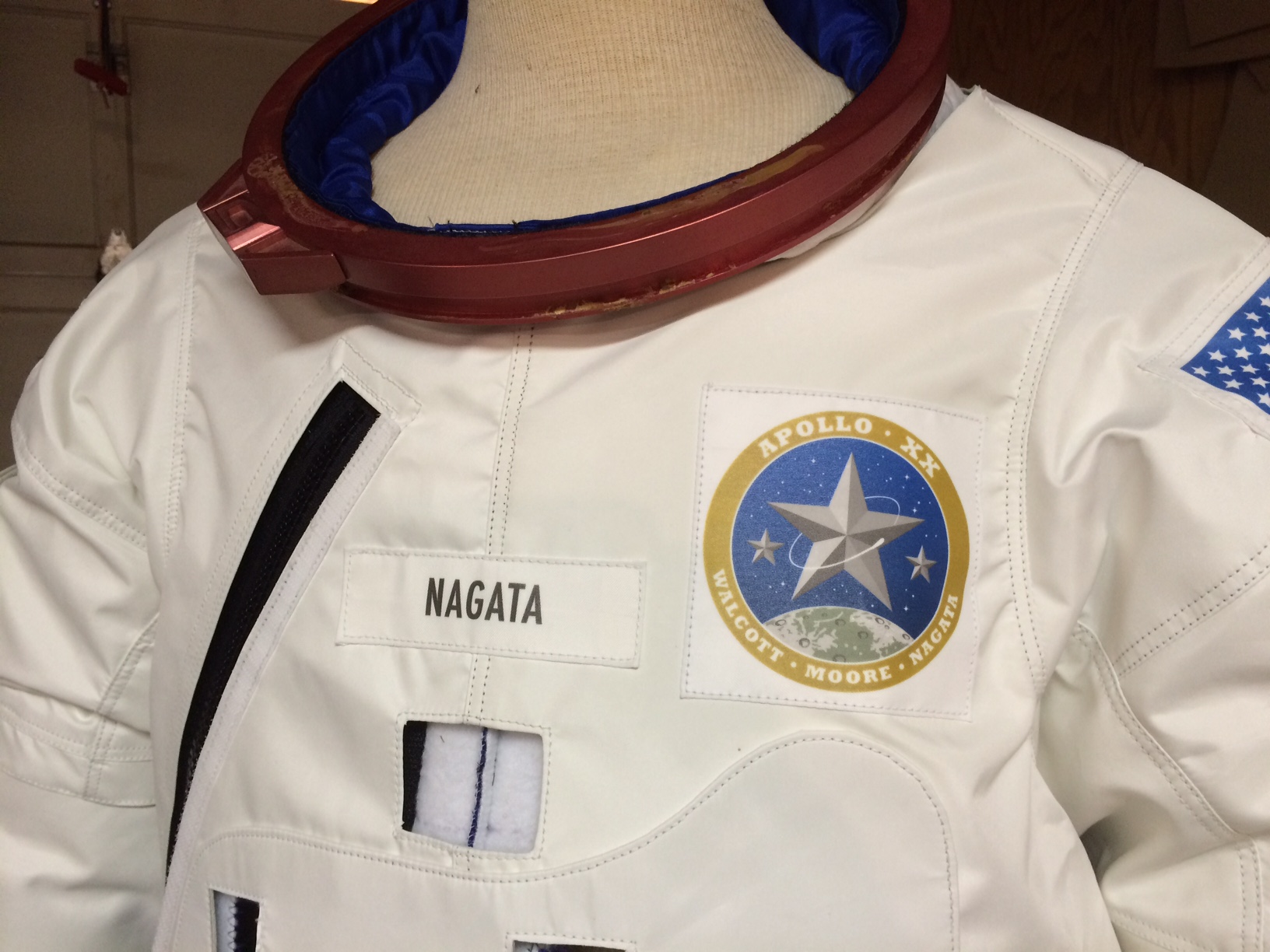

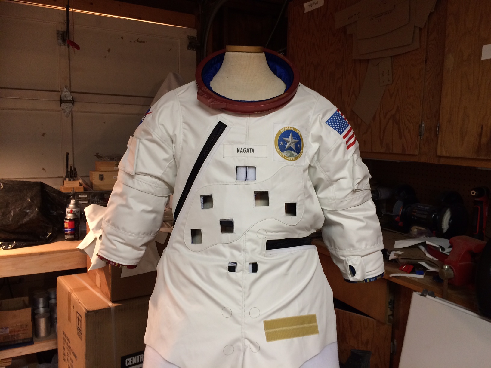

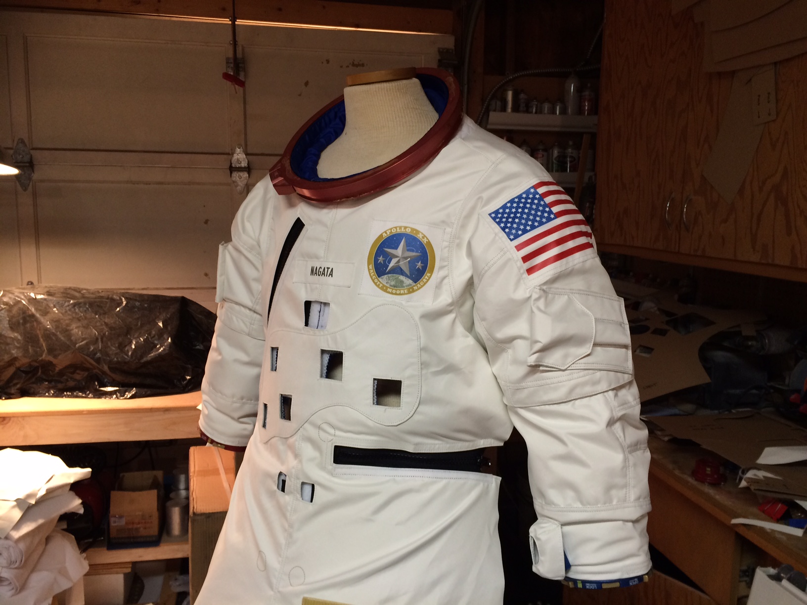

My A7LB is coming along. I adapted my pattern and once again made a few adjustments. Each suit gets progressively more accurate. The connectors on this suit are aluminum, but I'm going to strip and re-anodize them to get the colors more accurate. I've really fallen in love with the design of this version. It's actually much easier to don than the A7L, something I only discovered after patterning out and trying on both models. I can climb into and zip this suit up myself whereas I need someone to assist me with the A7L. I also love the blue liner of the A7LB as opposed to the white liner of the A7L. It just looks prettier from an aesthetic standpoint, which is probably why the suits in Apollo 13 had inaccurate blue liners, even though they weren't introduced until Apollo 15.
Awesome work as always. What's the material you are using now? I saw the A7L on display at the Franklin Institute and it has a sheen that I never noticed before in photos.
Sent from my SM-G900V using Tapatalk
I'm not sure what the origin of that suit is, but it is not a flight suit (the pattern is different, mainly that there is no separation in the arms to accommodate the bearing and several other subtle differences) and it doesn't look like Beta cloth. It looks more like nylon because it's slightly yellowed (at least it looks that way in the picture). Beta cloth doesn't really yellow. I don't exactly know why, but I've seen some training suits that were mostly Beta cloth, but had sections that were made of nylon and were yellowed. Most of the Gemini suits are yellow now because they were nylon. Maybe the suit at the Franklin Institutes is a prototype of some kind.
I used a nylon pack cloth for my A7L replicas, but I switched to a finer weave, rubber-backed nylon cloth for my A7LB. The A7L and A7LB were actually made of different materials. The A7L was several weaves of Beta cloth with teflon fabric abrasion patches in certain areas. The A7LB was 100% teflon fabric and all the extra abrasion patches were eliminated. I could actually get the same teflon fabric that was used on the A7LB, but it's $300 a yard. I have a small sample of it and the fabric I used feels, looks, and drapes in a similar manner so I'm pretty happy with it. Beta cloth has a sheen to it. PTFE teflon fabric is much flatter.
View attachment 572289View attachment 572288View attachment 572287View attachment 572286View attachment 572285
Nice Apollo 20 patch!
