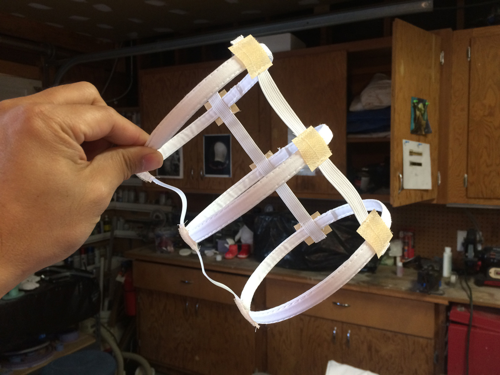

Batting will only give the suit so much structure. In order to get the look of the "constant volume" convoluted arms, I created rigid structures for the inside of the suit made from garment boning strung together with elastic and velcro sewn to it. Here is the joint for the elbow:
The reason for the craft velour lining is so I can secure the rigid structures to the inside of the suit. Craft or "puppet" velour sticks to velcro quite well. I wanted to make the rigid structures adjustable depending on the wearer, so being able to tear them out and reposition them was essential:
The finished sleeve is lightweight and comfortable, but also stiff enough to hold it's shape and give the appearance of being a many-latered pressure suit. Also, thanks to the structures, I can bend my elbow without the entire sleeve collapsing. So it looks more like a pressure garment and not just an empty fabric sleeve.

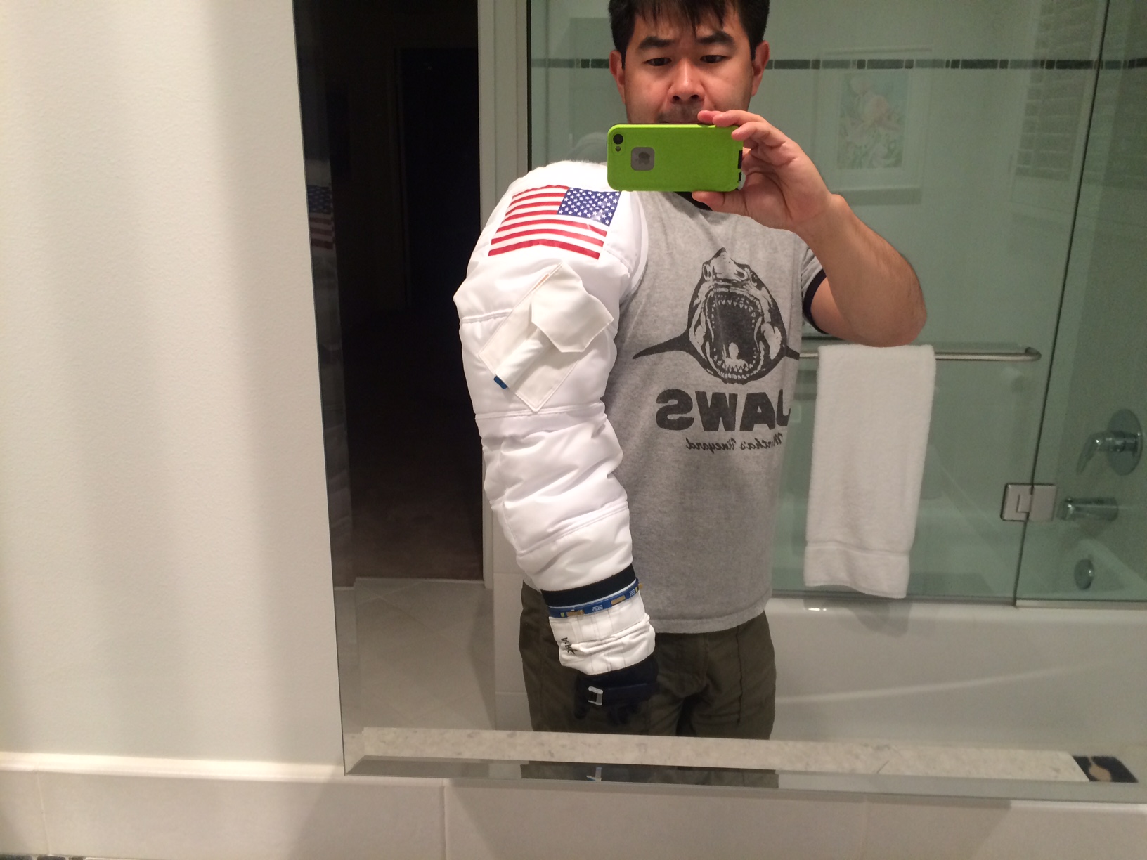

A couple updates. It wouldn't be a true cosplay without a little EVA foam. I made the arm bearings out of foam so they'd be lightweight. The center strip of velcro is free-spinning, so when the arm is velcroed into the shoulder, it spins freely, just like the arm on the real A7L extravehicular suits:

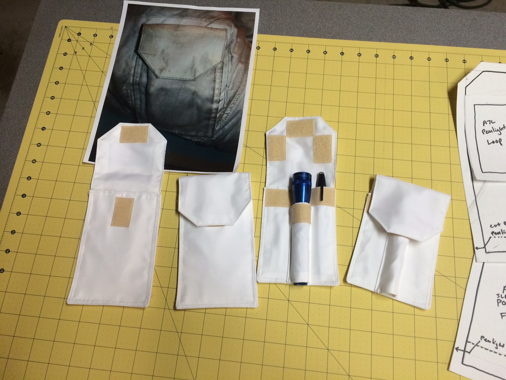

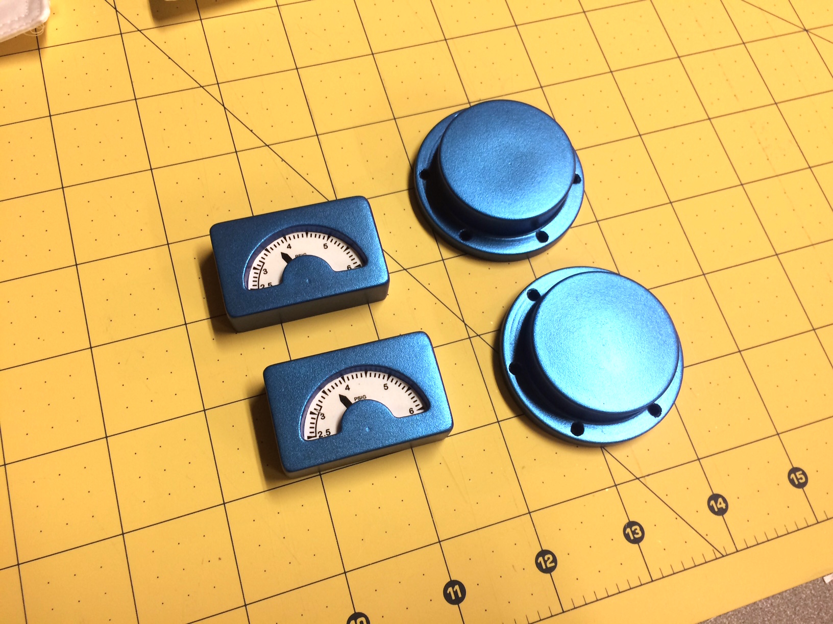

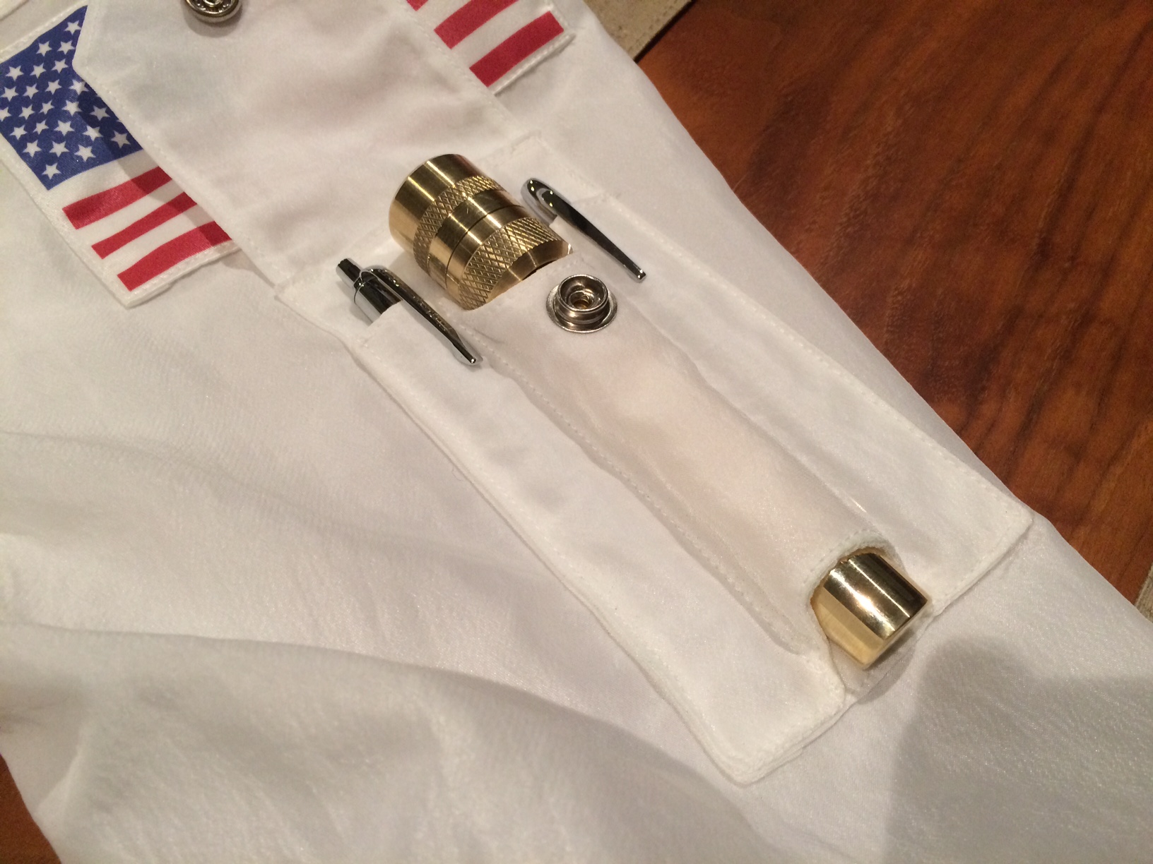

I created a pattern for the shoulder. Also made the sleeve pockets for sunglasses, pens, and penlight and made the pressure gauge and release valve:
Here is the arm. It's just pinned together and hasn't been adjusted to my body yet. The suit will be somewhat modular and adjustable so I can custom make these for different people:

I made the dust covers for the pressure gauge and release valve:

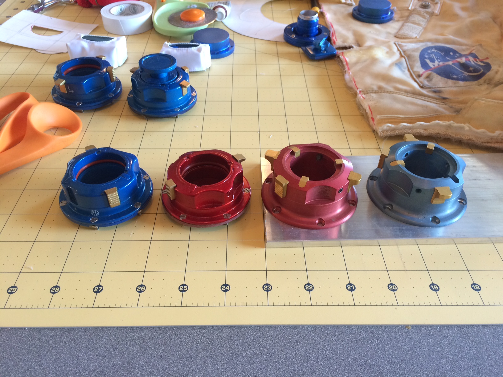

I also discovered that after all that work I did on the suit connectors, they are too small! I obtained a very old display suit for Omega watches that was made by Spaceworks (the same company that made the suits for Apollo 13). While the suit itself is horribly sun-damaged and the nylon is melting, it is a great pattern reference. The connectors on it are nice machined aluminum and are accurately sized. When compared to the ones I had 3D printed, they are significantly larger:
I eventually plan to get these connectors refinished (they are faded) and use them on my next suit, but they are too heavy for the lightweight costuming suit I am making now. So I cast them in lightweight resin. You can see how much larger they are than my first version. I was also aware that my first connectors were too small because when I laid them out on my pattern, they just looked a little undersized:

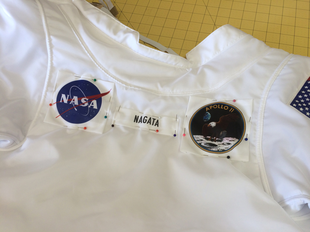

Sewed on the patches. Decided to use the most iconic patch (Apollo 11). My name is obviously inaccurate :lol

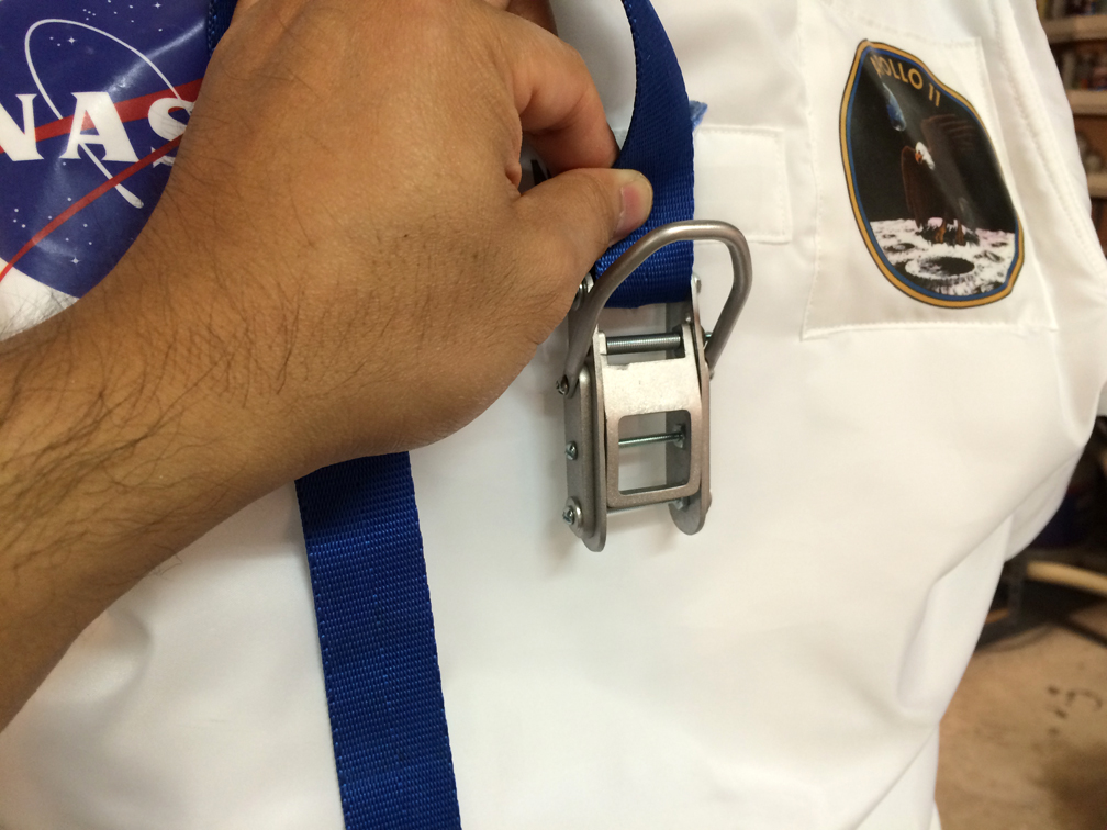

I finally fabricated this annoying little part. The buckle that goes in the center of the chest. The PLSS attaches to the loop:
