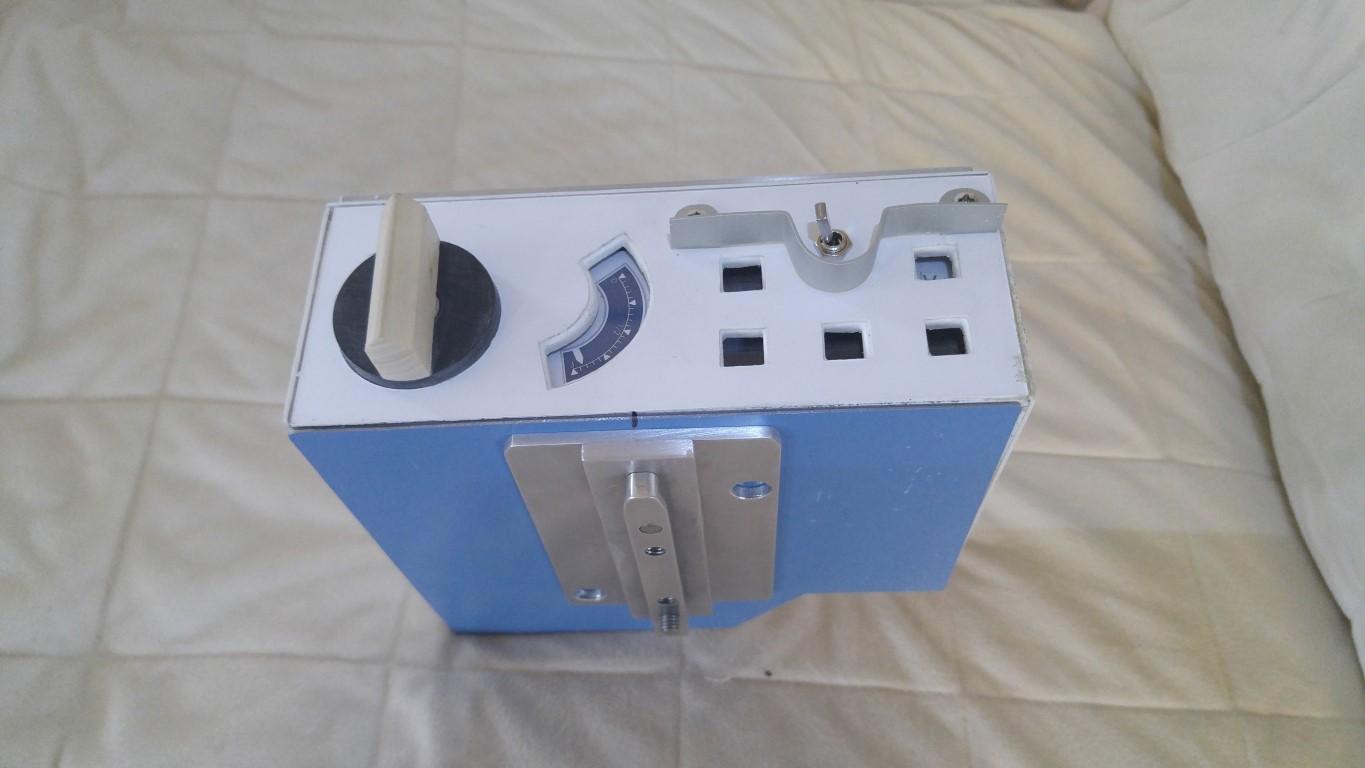

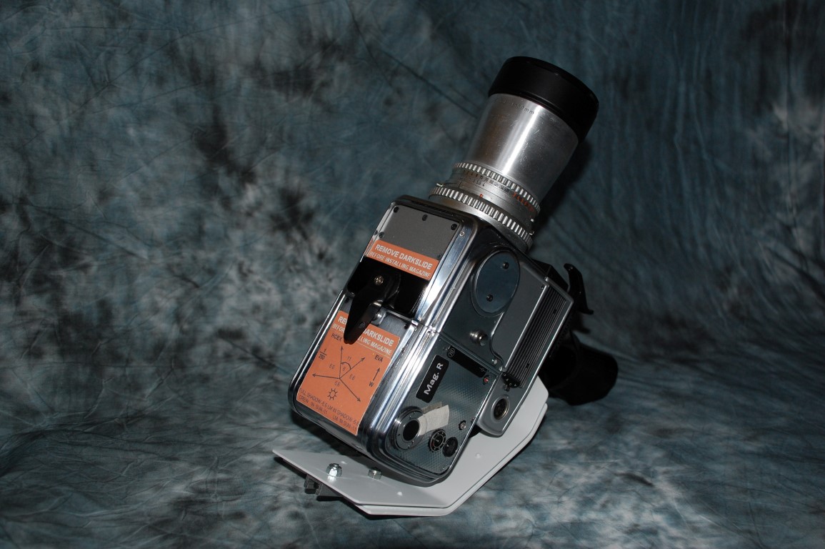

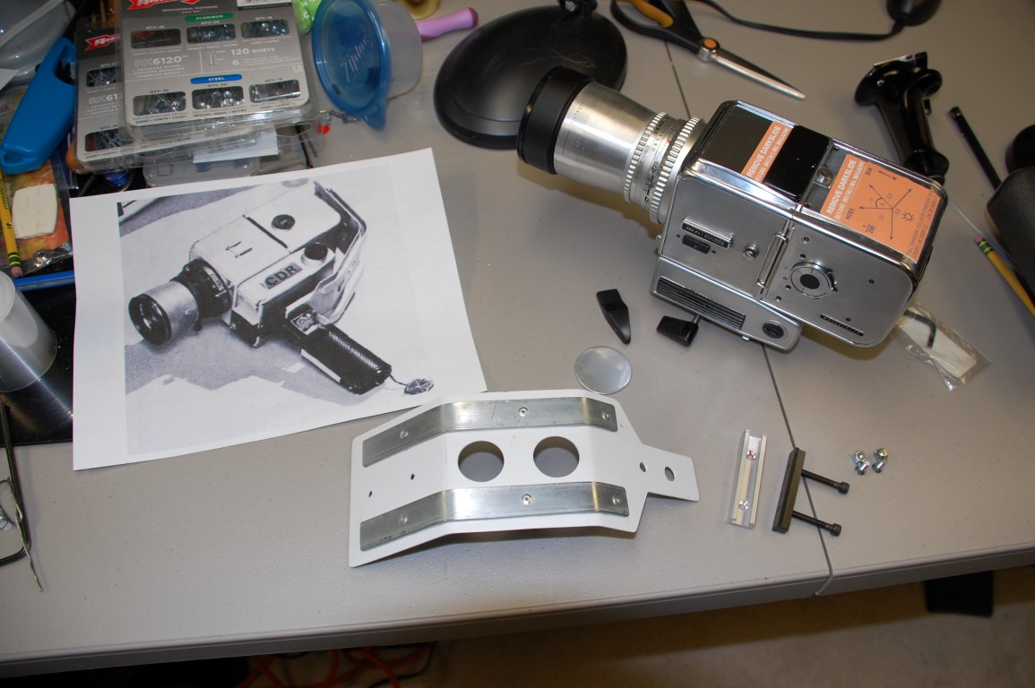

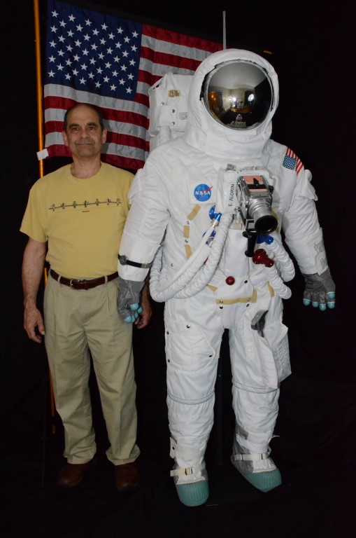

I love the camera work. I love all your work. Absolutely amazing. I definitely need to get a lathe and mill. I tried making the camera using all original Hasseblad components, however it weighs a ton. I was able to attach it to my suit but it sags quite a bit. I was wondering if you had sourced the gold visor for the EVA helmet or do you plan on making your own. I wasn't able to find a source so ended up using a silvered mirror acrylic dome. It isn't bad looking on my Buzz Aldrin suit. Hopefully I can source a gold one for my Neil Armstrong suit.
Very nice! I'm making my own gold visors for the LEVA. I'll post pictures when I'm done. Great work on the camera. Yeah, I have that same Hasselblad 500 and Distagon lens and they're pretty heavy to mount on a costume. For a display it's probably fine though. What did you make the camera bracket out of?
View attachment 626140View attachment 626141

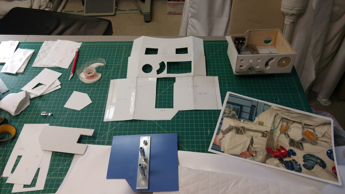

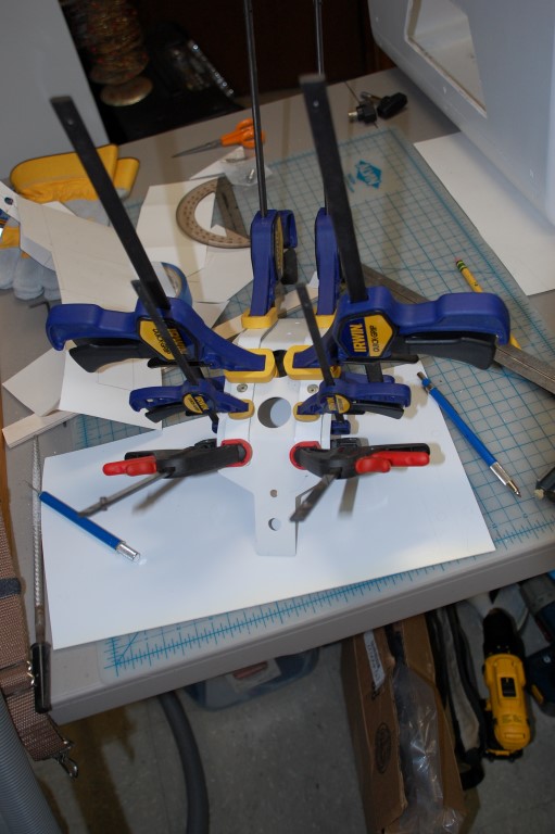

I basically used what I had in my scrap pile. Some sheet metal for the main plate with aluminum bar for strength and a styrene piece to simulate the t bar look. The camera attachment to the RCU is actually done with a t-bar and rail assembly that is used by rifle shooters for sling attachments. I had one laying around and made use of it. I remember one of your videos you spoke how you have to make compromises to make these props. I am finding that out all the time. I try my best to make a "replica". It's not exact but is a good representation. I am redesigning my suit now. This particular one has a pressure garment assembly to give it bulk but it is hot. My next suit which will be Neil Armstrongs EVA suit will probably be made similar to your suit, utilizing battens and velcro. It should be quite a bit lighter and cooler to wear.

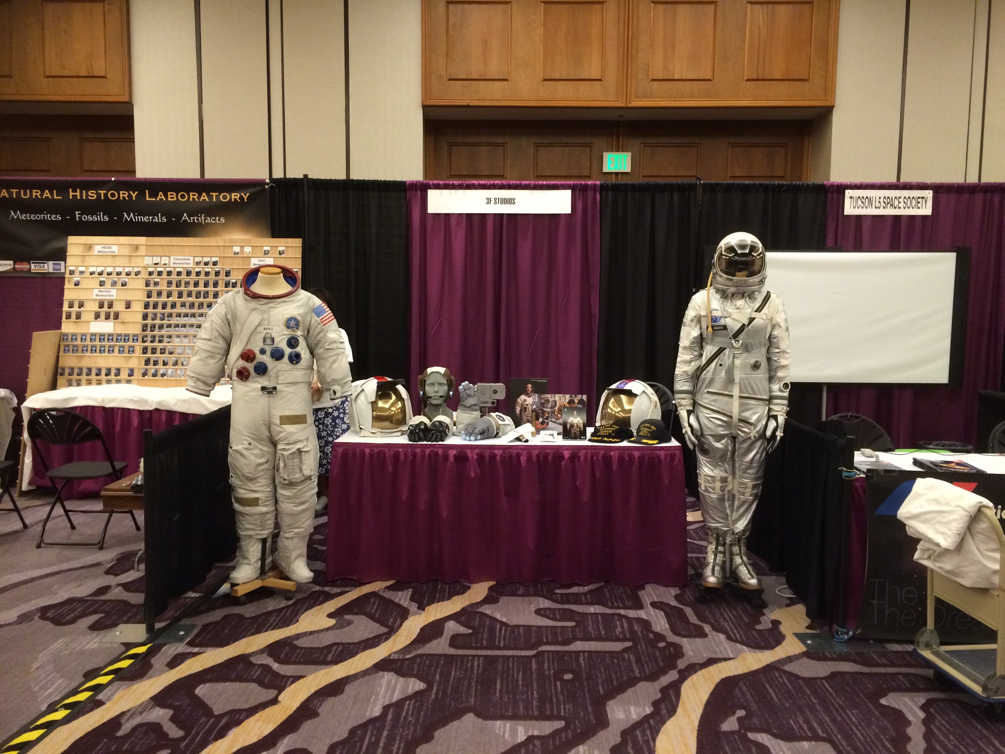

Yes, I rented a booth at Spacefest in Tucson this past weekend to display some of my stuff. I really didn't think it would be a big deal, but it ended up being one of the best weekends of my life. I met SO many amazing people, not just the astronauts.

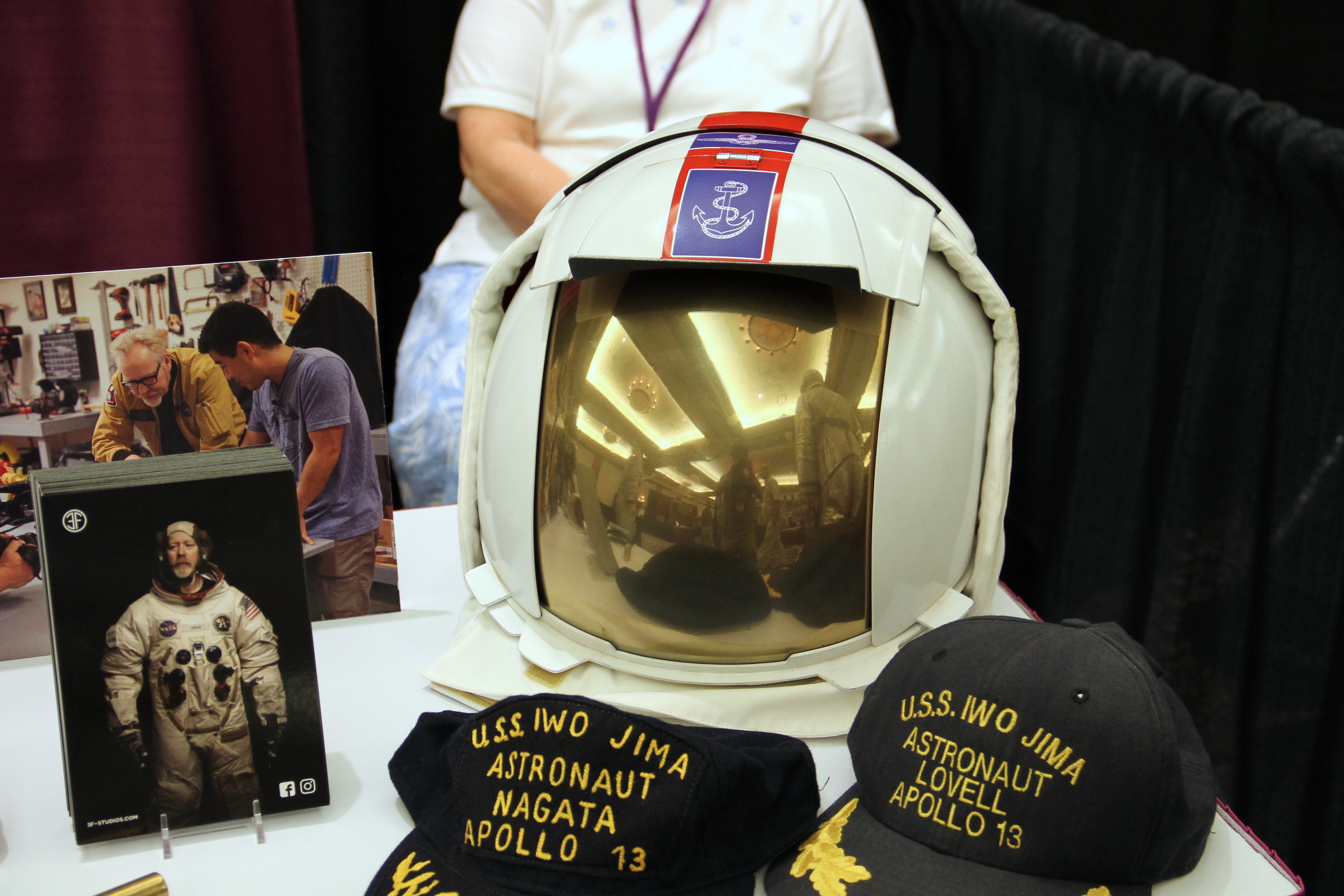

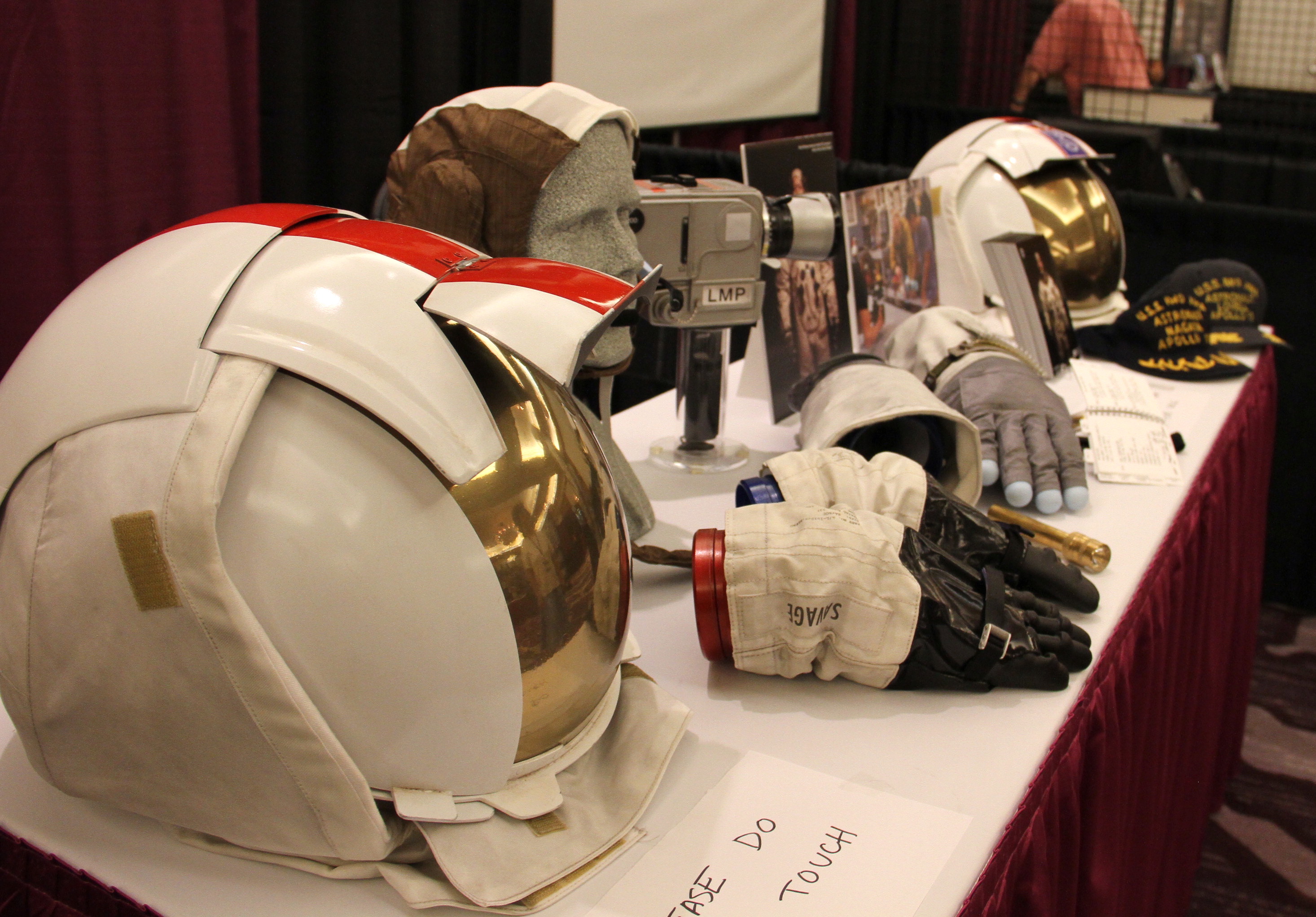

I recently finished my LEVA replicas, which I was going to post a few in-progress pictures of here when I got the chance. One of them I decked out with Navy emblems to look like Jim Lovell's unused moon helmet from Apollo 13. I got him to sign it. He loved it and said he'd never seen anyone replicate his helmet before. Freddo signed it too:

It's Alclad II mirror gold for Lexan, sprayed light enough to be see-thru. It's sandwiched between two layers of vac-formed 0.040 PETG. The instructions say to back the paint with black or silver, but that dulls the finish significantly. So I sandwiched it between layers of plastic to protect it. Works perfectly and the finish is really quite nice.
Awesome. What are you using for the gold visor tint?
