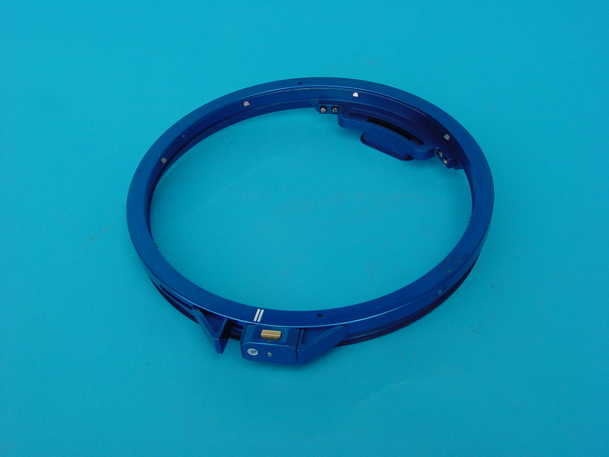

They are very similar if not exactly the same. I've seen some pictures of modern EMU's used for training and the white paint has chipped off the necking revealing red underneath, which makes me think they were red anodized originally. I doubt you could purchase the actual aerospace hardware from ILC, and if you could, it would cost a small fortune.
Would the modern suit rings be correct? I wonder if you could source them from the current mfg.

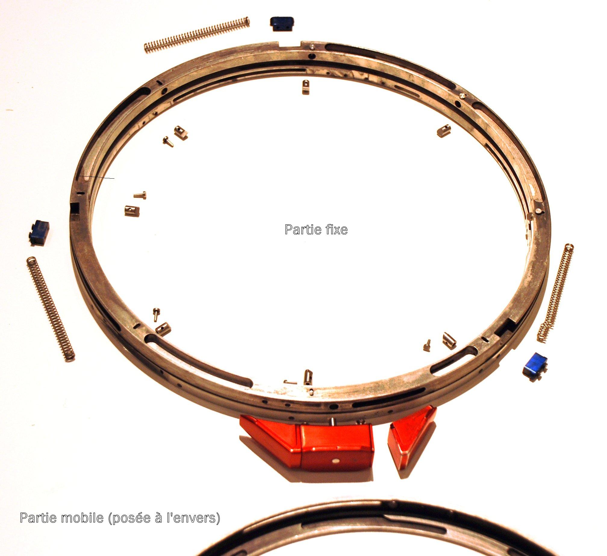

I think those connectors are sourced through Air-Lock, Inc. Good luck getting prints, even though they supply to a prime contractor (ILC), and the technology is ancient, they may still consider that stuff proprietary information It's a pretty simple design but you would need the helmet and the neck ring
They are basically the same neck ring and wrist wring disconnects. The A7L ring mounts via a clamp around the neck disconnect, and the A7Lb and EMU rings mount from the bottom of the ring (A7Lb via a clamping ring, EMU bolts to the HUT) The EMU and A7Lb also have off set lock release. They are made by Air-Lock industries and you would faint at the cost. We replicate the neck ring exactly to the original, less the seal and just the machining cost on these is around $4500 each. (Which I think is about 15% the cost of a real one, and no, they don't have used ones or bad ones to sell) (nor do we) The tolerances need to be spot on, or the rings locking mechanism binds up. Then there is polishing and anodizing. Each suit side neck disconnect has about 31 pieces to machine, not including screws so they are very complex.
Here is a picture of ours and a real one taken apart. (A7Lb I believe) Side note: The early Apollo were anodized blue and then when Frank Borman was hired by NASA he couldn't fit his head through the ring. Edit: The Borman story is incorrect. The reason for the change was insufficient O2 flow in the earlier Apollo rings. So a larger inlet plenum was designed. To keep the helmet side and neck side plenums correctly matched, they changed the color to red and added the words "Use with red helmet ring only" to the top of the neck disconnect.

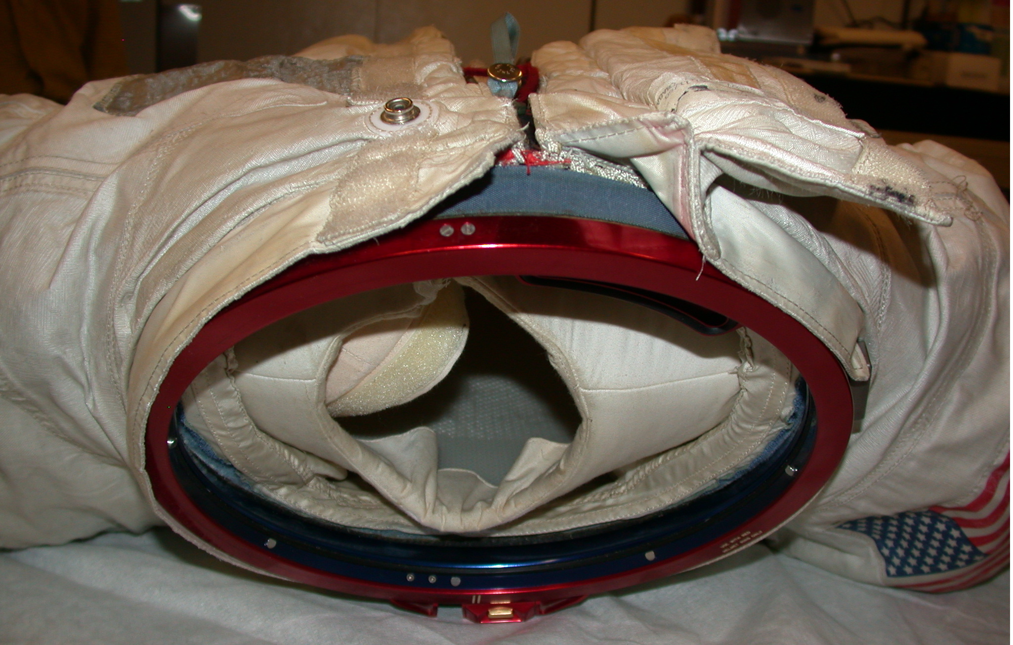

Armstrong's used mission suit has a blue inner ring and red outer ring.

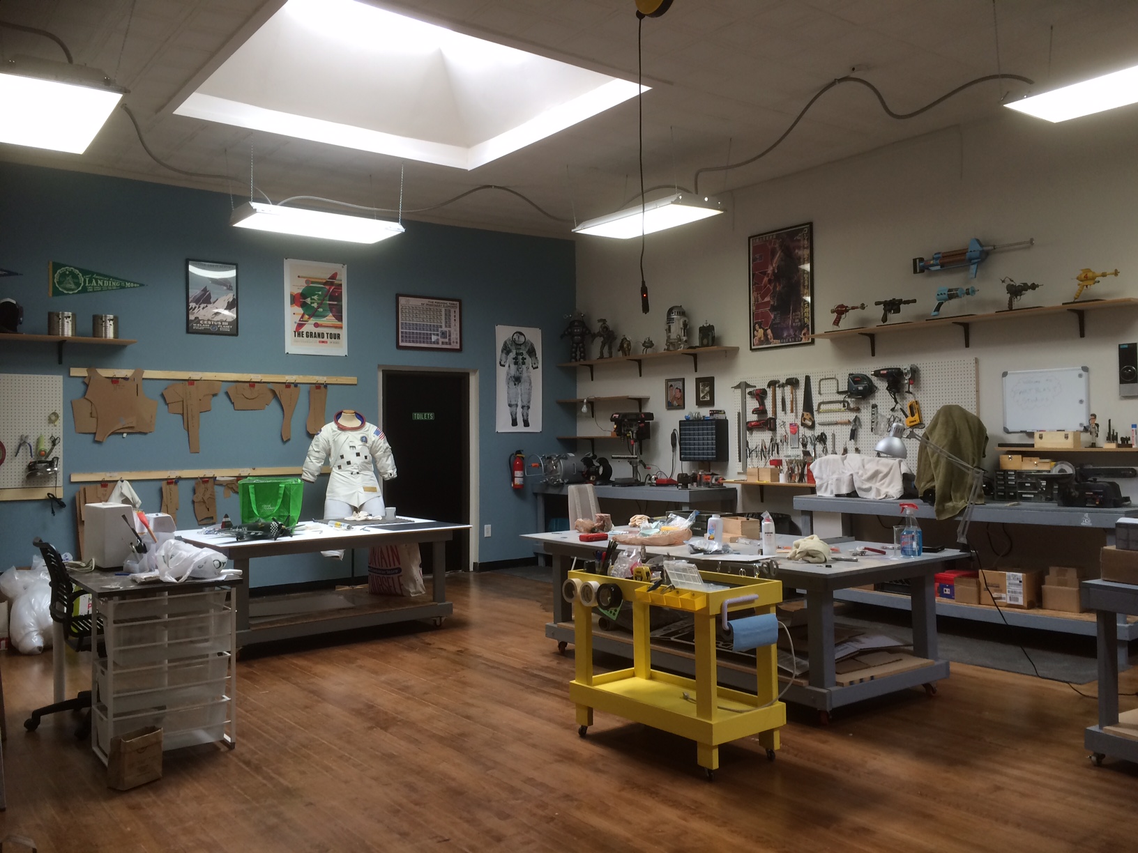

I spent the last few months moving to a new studio space, so I wasn't able to make anything. But now that I'm set up, I'll be doing a lot more:

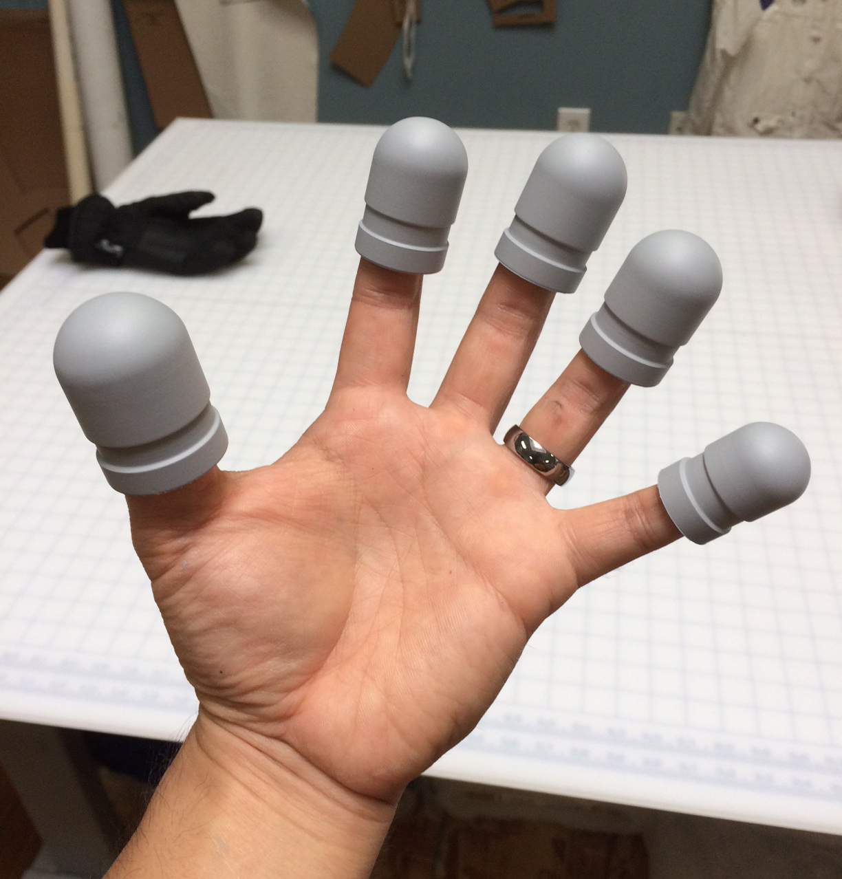

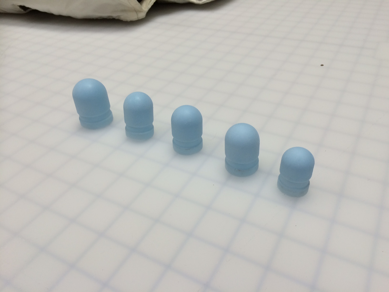

I knocked out a few things this week. I turned these fingertip cups for the EVA gloves in acrylic. I cast them in urethane rubber dyed light blue (simpact 60A):

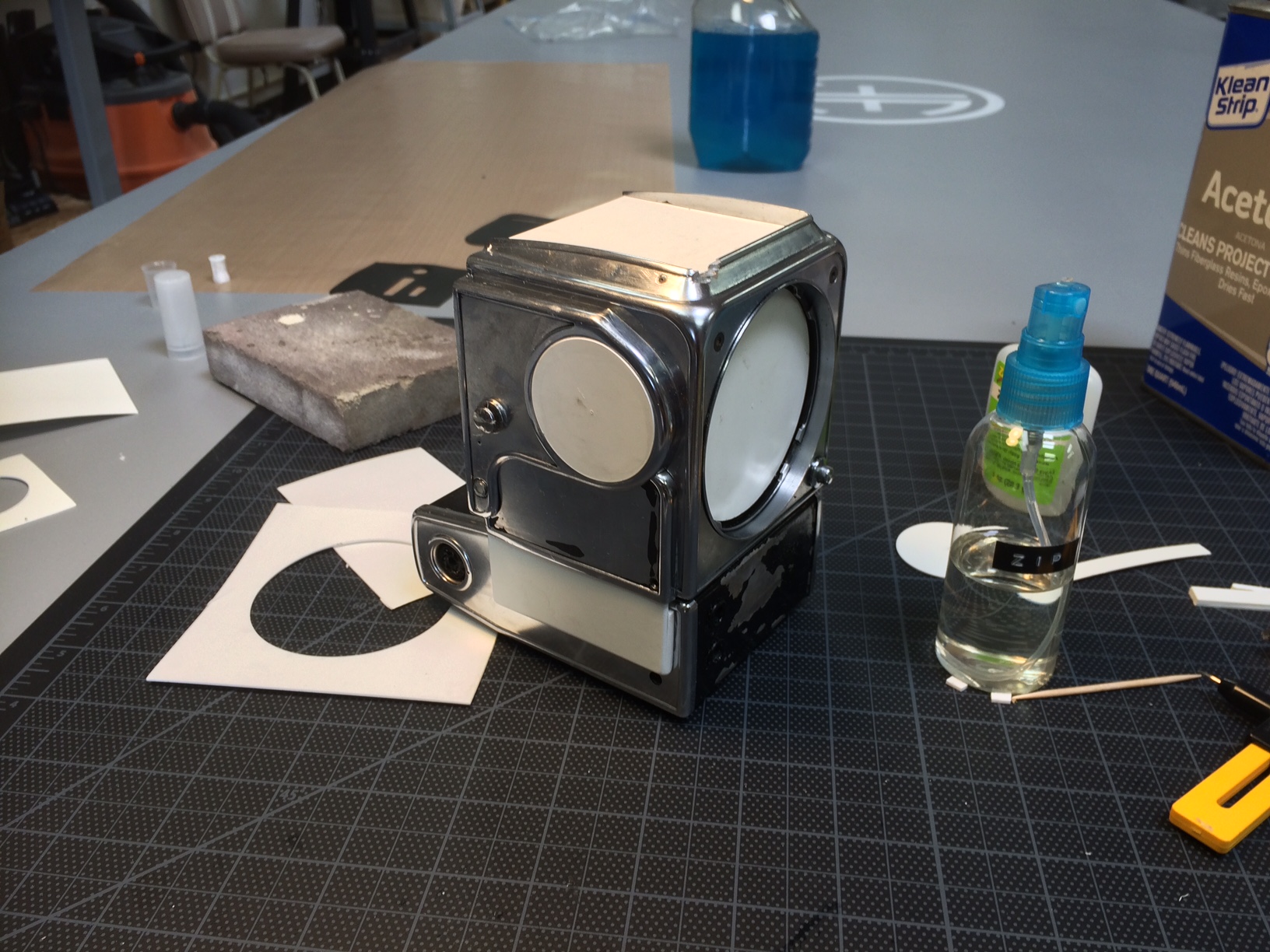

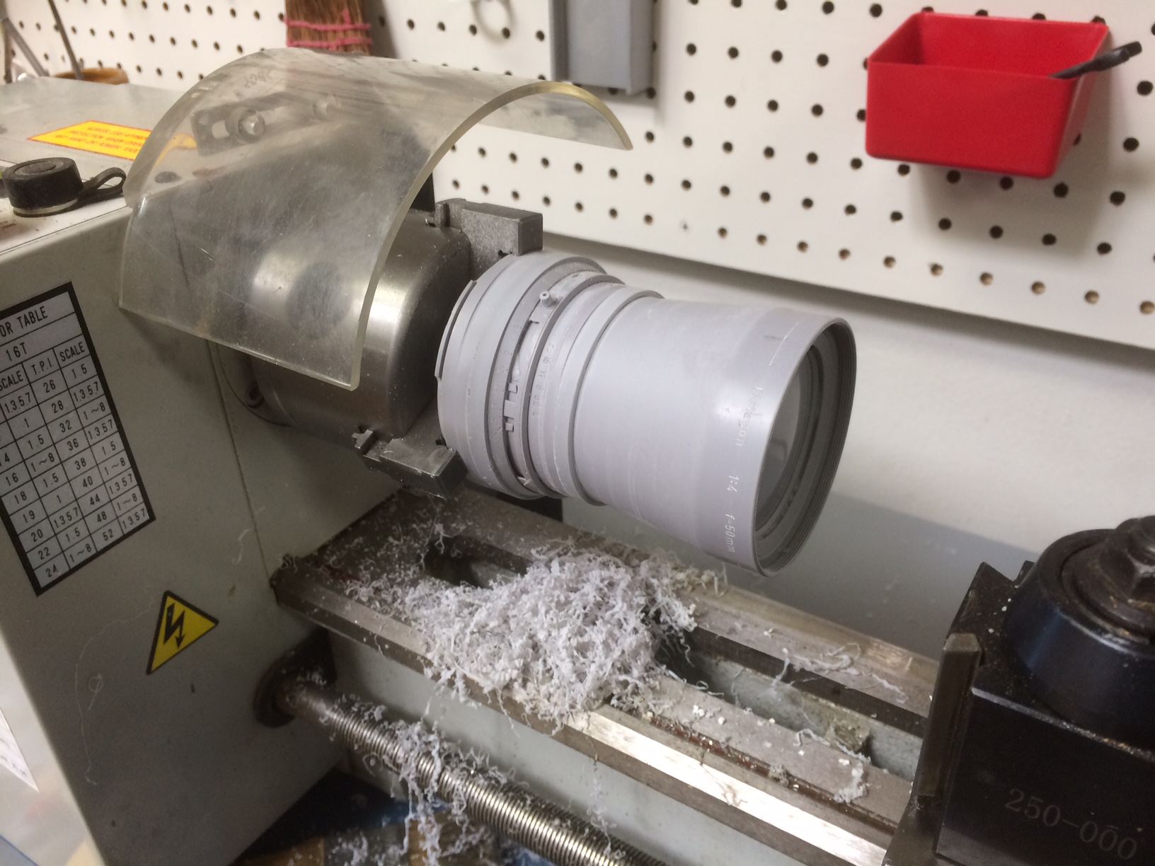

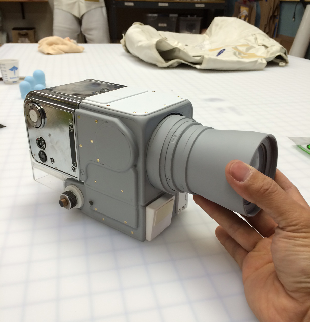

I started making an accurate lunar mission Hasselblad. It's different than the commercial version that was sold to the public. But I was lucky to find a broken 500 EL being sold for parts, so it was cheap and also there's no guilt about taking it apart and converting it to the Apollo version. I stripped off all the leatherette and cast it in resin, then milled off all the incorrect parts and replaced them with the moon parts. I also cast a Zeiss Distagon lens and turned it on my lathe to look more like the Biogon lens designed for Apollo.

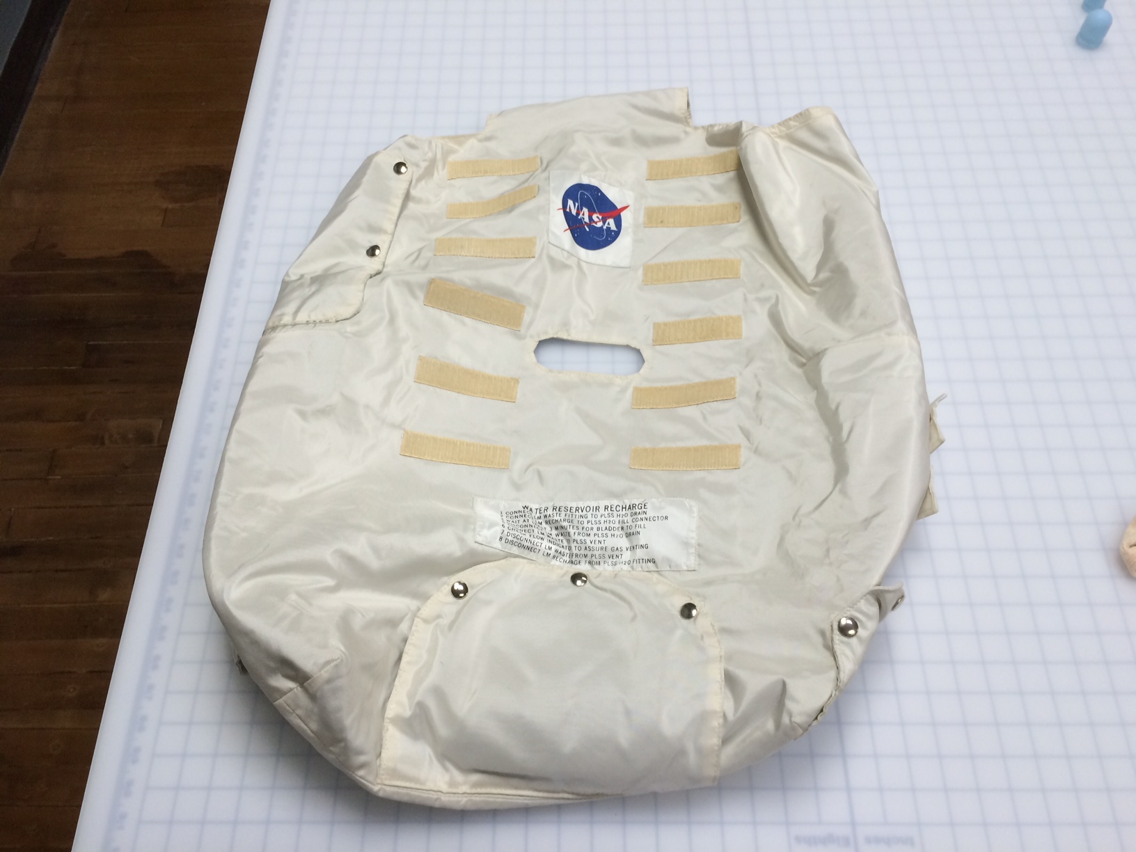

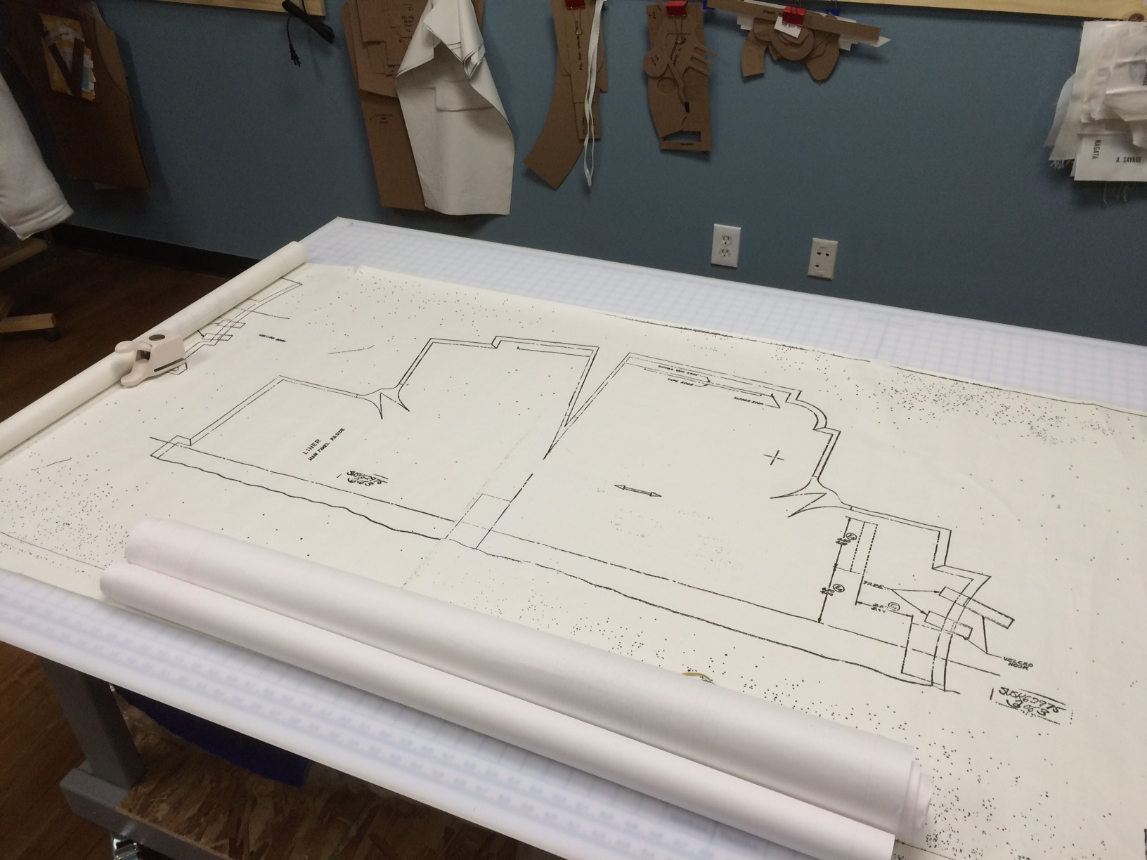

Last but not least, I received some excellent resources to duplicate the PLSS, OPS, and RCU. I have some actual patterns and blueprints from Hamilton Standard, loaned to me by RPF member Seatra. I was also loaned an actual Apollo-era PLSS thermal cover from the 1960's. This cover was not flown (it was used for training), but it is identical in every way to the cover worn on the PLSS backpacks of Apollo 11-14:
Ryan,
Congrats on getting the studio set up. It looks like a nice place to work! Fitting out the suit for a full EMU is going to really take it to another level of excellence!
