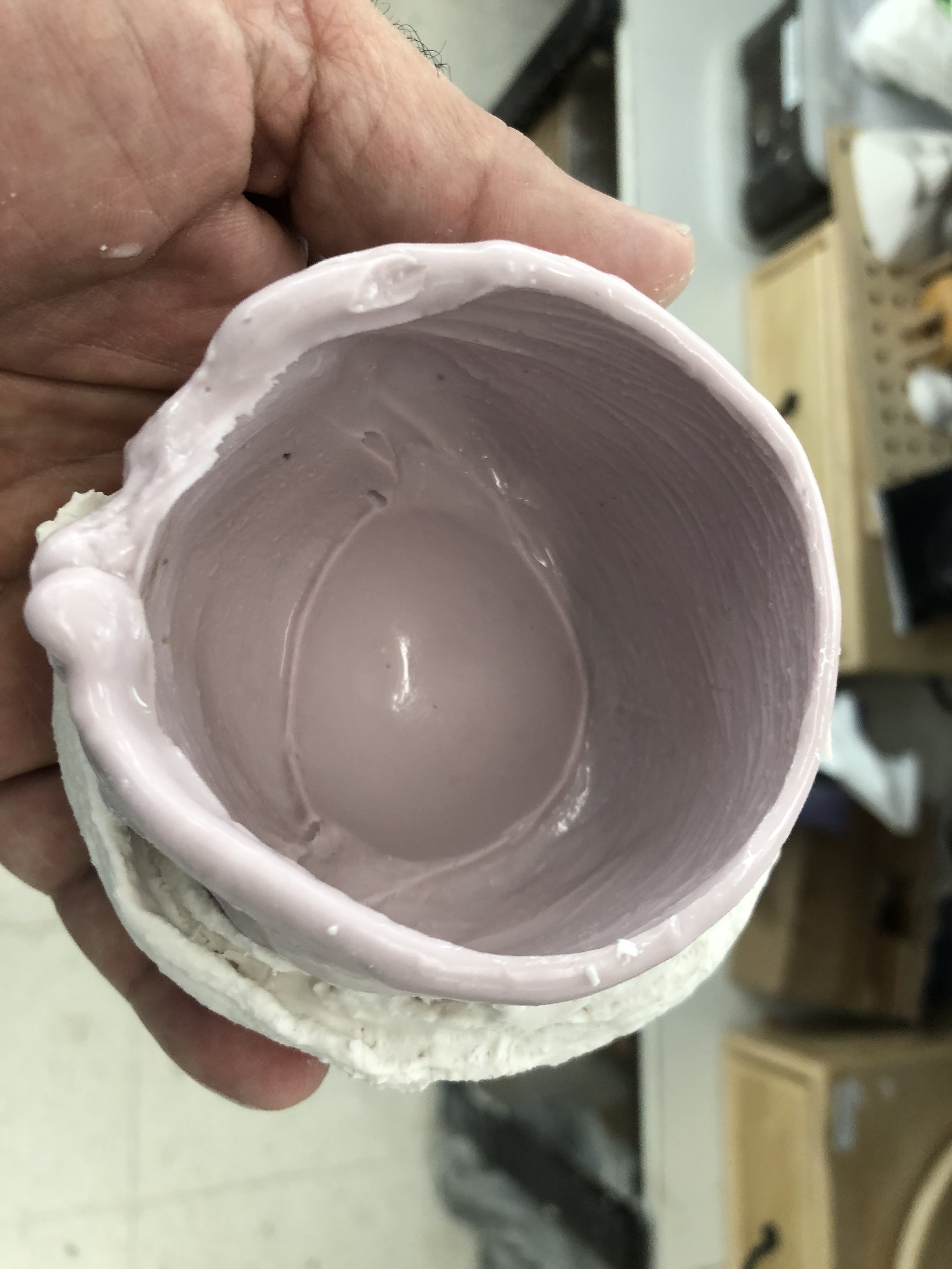

To make the eye, I started with the wooden hemisphere I used in the sculpture.
Vacuformed a piece of plastic over it and got this:
Cut it out and paint the inside to look like an eyeball. In this case I copied the special edition dragon-like eye scheme.
