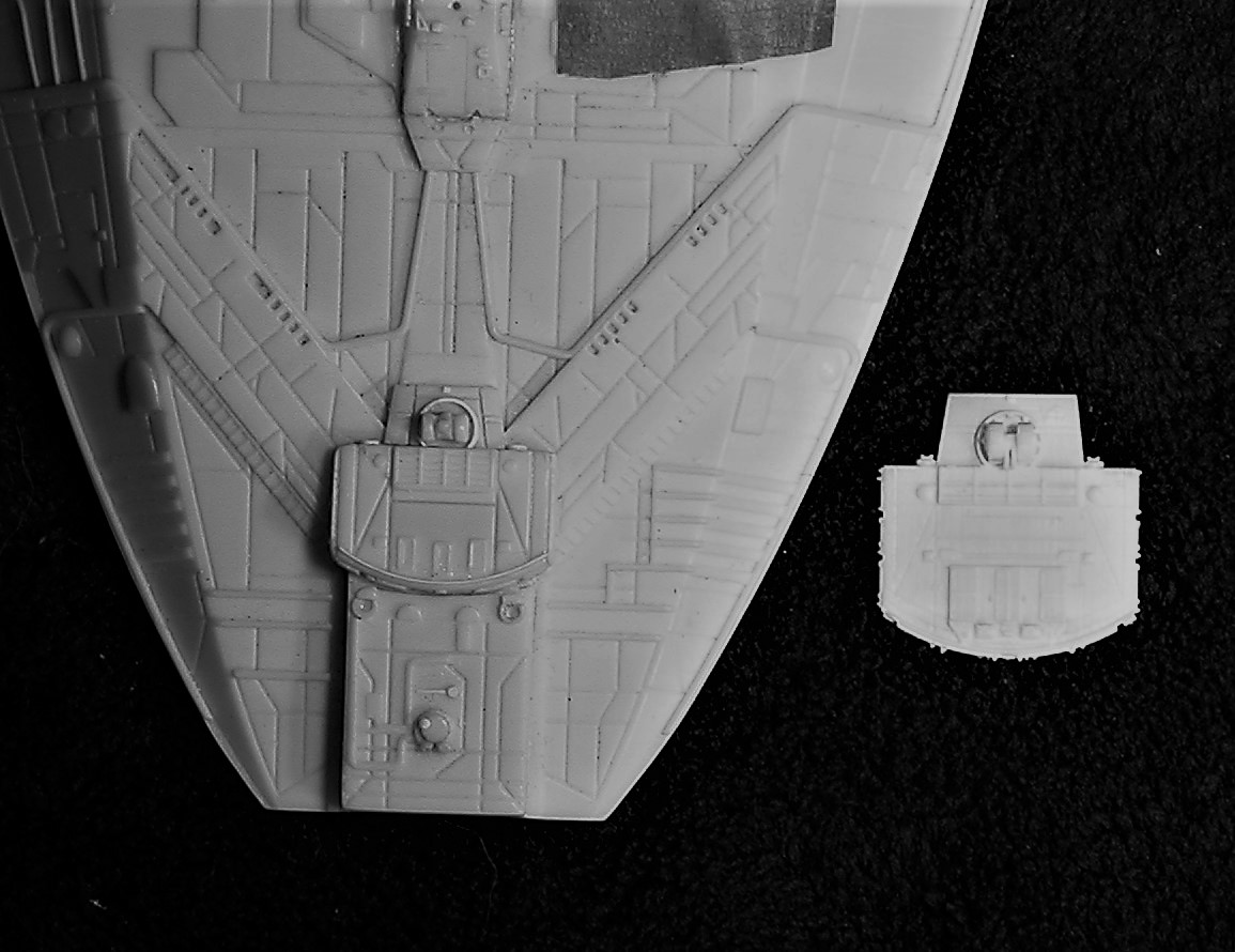

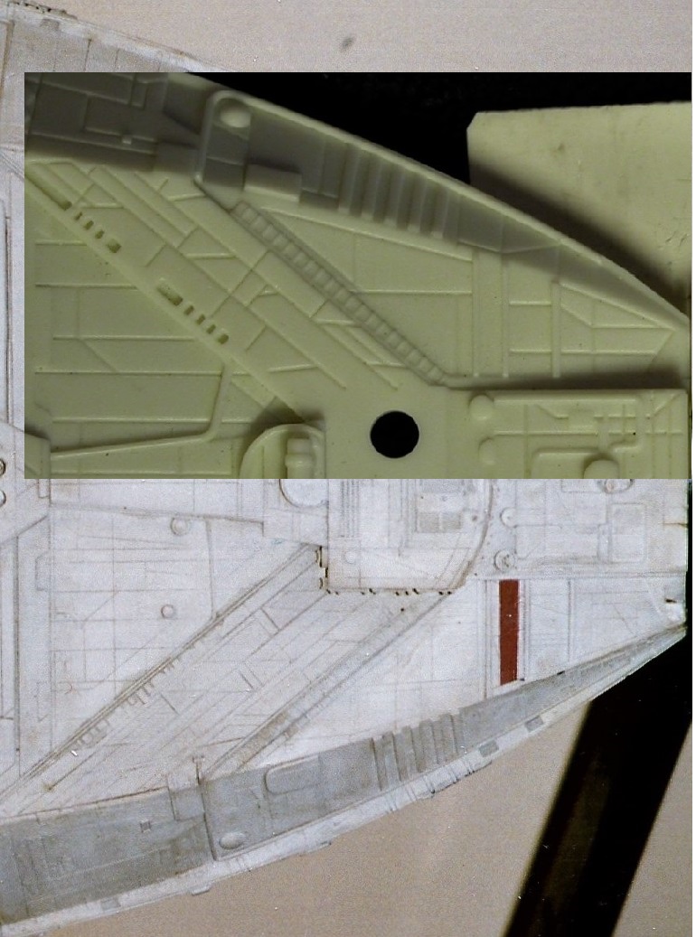

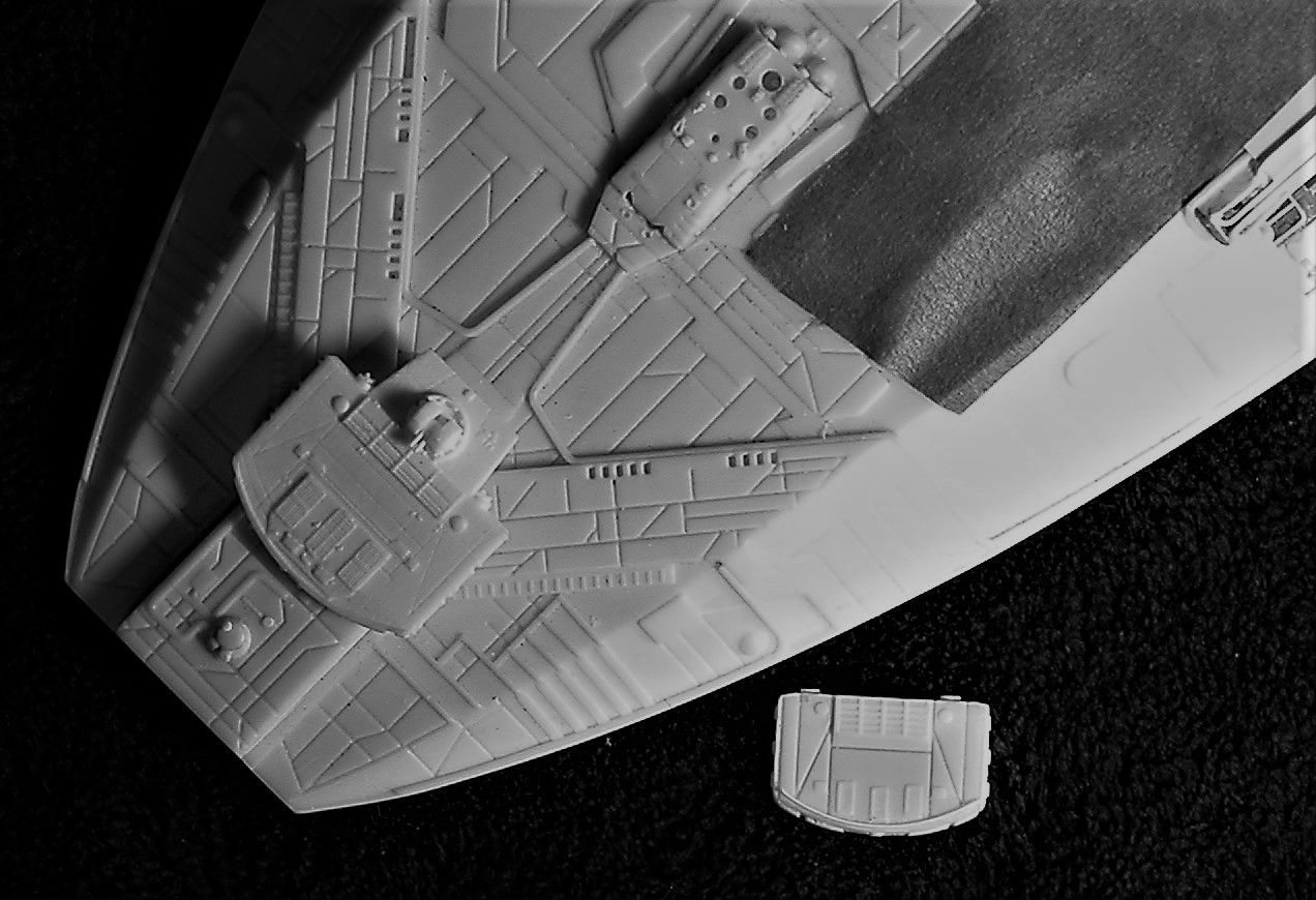

Folks... Has anyone used the Shapeways bridge on their Galactica build? If y'all have, can you chime in here with some thoughts? I've been foolin' around with the one Mr. Analyzer sent me and I seem to have a problem. I watched "stevethefish.net's youtube video where he is using it and it appears that I'm not the only one to notice this, but it's too big? When it's placed where it goes on the model, it extends either far too forward or far too rearward, depending on which way you wanna go? Can some of y'all that have used this tell me what y'all found out with it?
Here's what I'm talking about.
Here's my modified bridge placed where it goes. Now, although nowhere near as detailed as the shapeways part, it IS in scale with the studio model.
Here, we have the shapeways bridge in place. As close as I can anyway, because that lump behind the bridge would need to be removed to mount this piece properly, but I can show what I mean with this. In this picture, I have it placed where it will have to go along the forward edge. As you can see, it goes well beyond the detail piping.
Here, I have it placed forward and lined up with the rear where it would have to go and as can be seen here, it extends much too far forward.
Here, as I sorta posted during the review earlier, is my modified bridge directly on top of the shapeways part. That shapeways part would have to be almost the exact same size to look proper on this model?

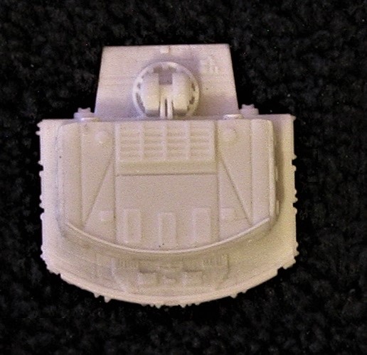

This is the part

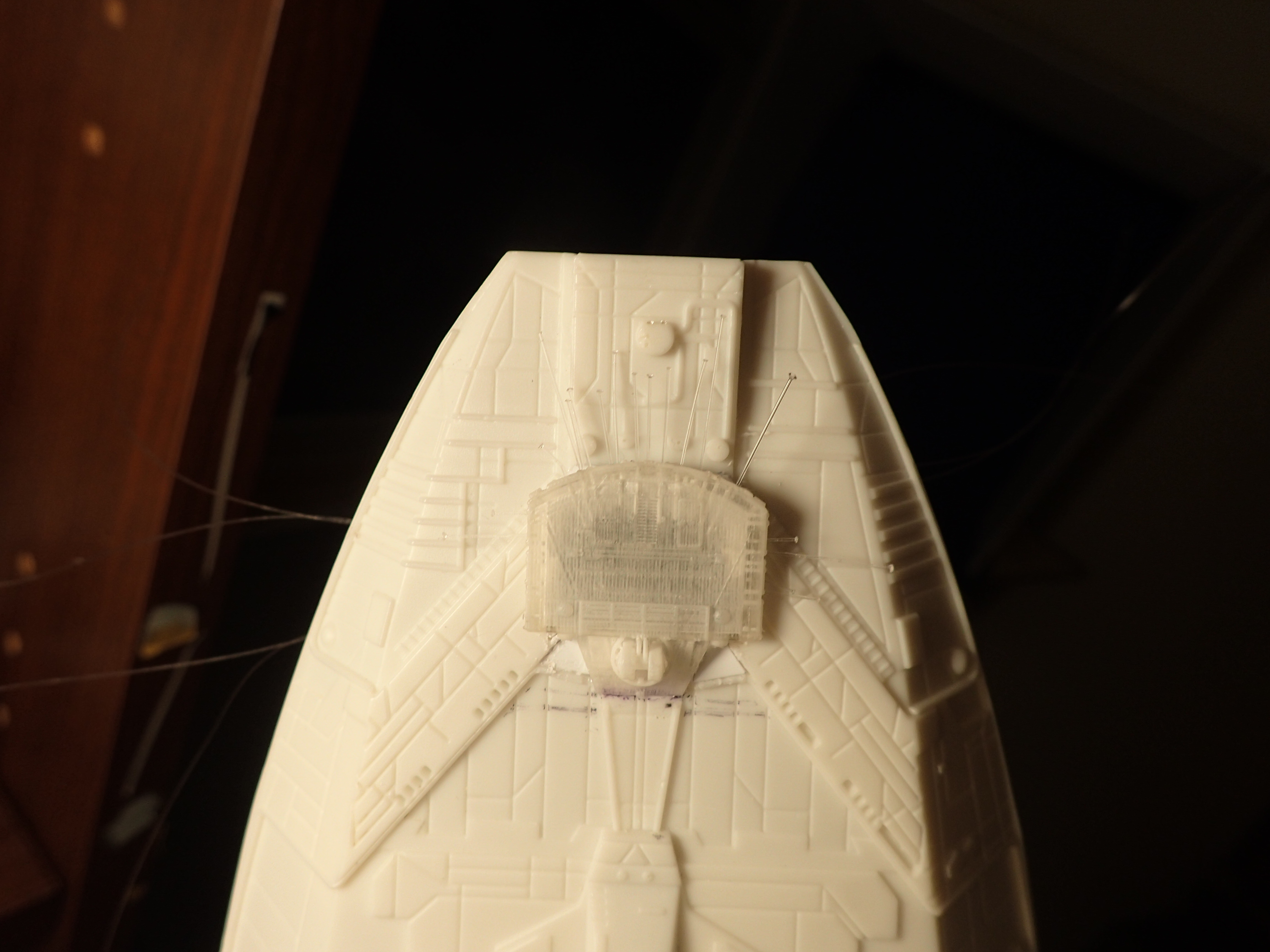

As far as it's size, I am not sure if the Moebius model is that far off or if the bridge is really oversized
For mine, I went to the Moebius kit being off and wound up placing it like this
Maybe that is wrong though and the Shapeways bridge needs to be resized
I will say that the front piece he made fits perfectly so I find it odd that he would make a bridge so far off?

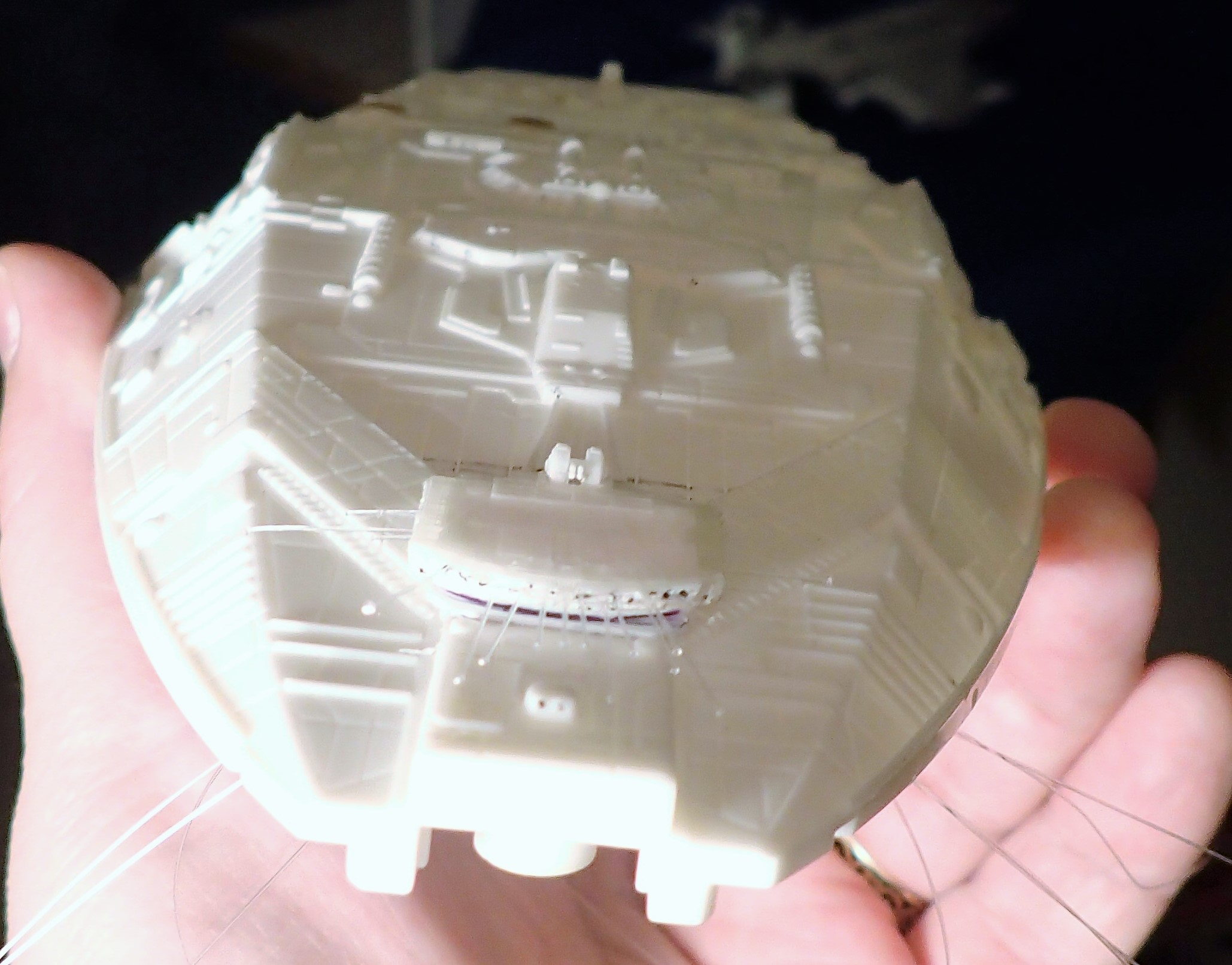

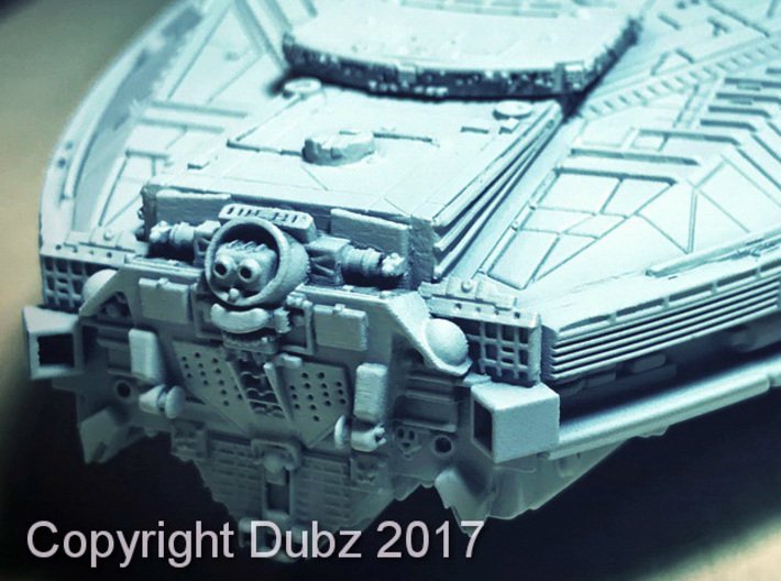

IN this build someone did, you can see they used the bridge and front, but they also added those side details and looks like the rebuilt the raised part going from the Bridge to the nose
I think the Moebius kit is too narrow and flat in that area without the side pieces
Although there is a difference I notice now between the one I have and the one I sent you. The piece that sticks out the back is more angled in mine and less in yours. The main bridge part is the same size, but the back is more squared and less of an angle

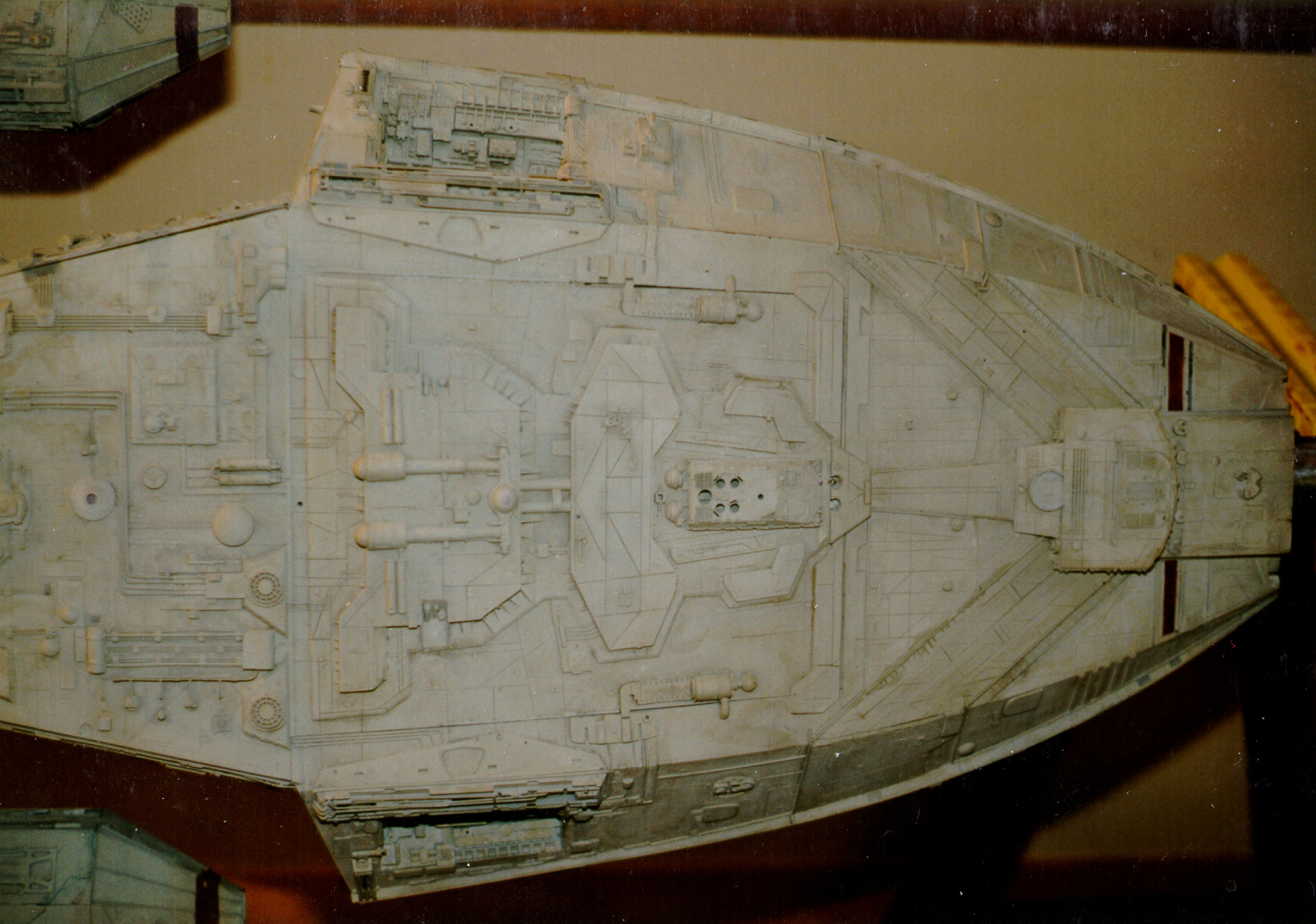

Comparing mine, to shots of the real deal, I would say Tony nailed the size, as usual. I think the platform in front of the bridge is a little too narrow, which makes the bridge look oversized.

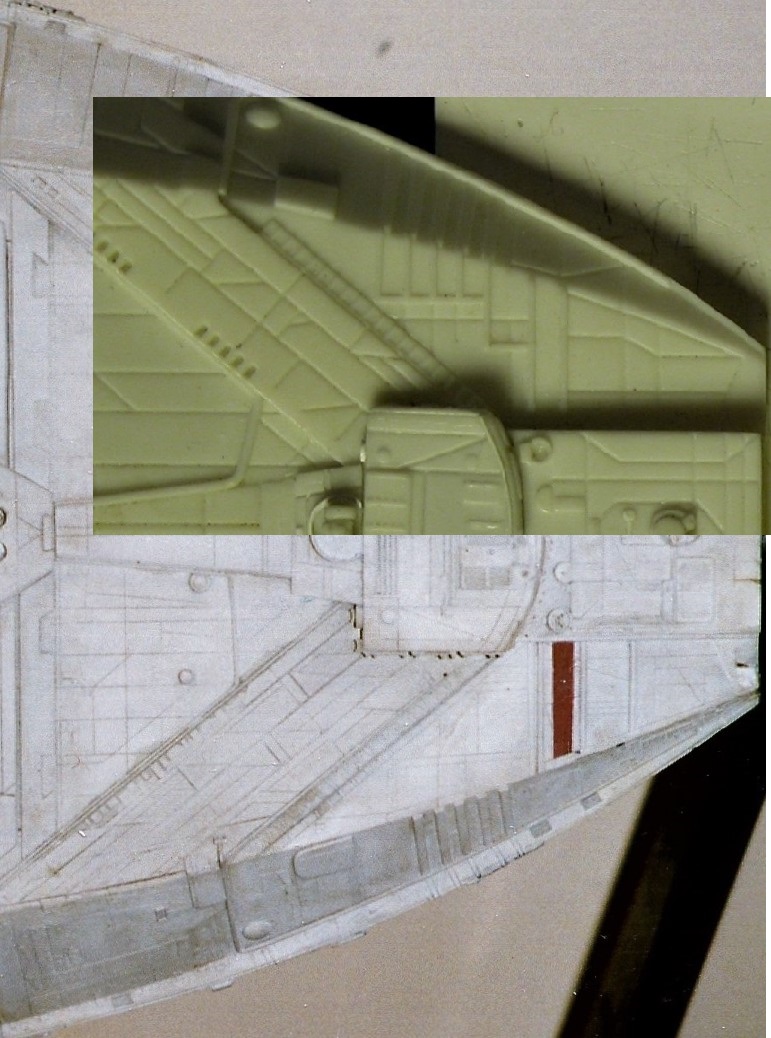

Ok, as y'all have figured out already, we gots numerationous siddyations here.
Take a gander at here. Now, although the sizing hack I applied may not be perfect, it certainly tells us what we need to know.
Here's my modded bridge.

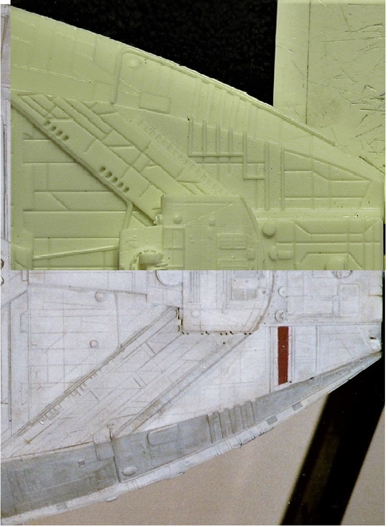

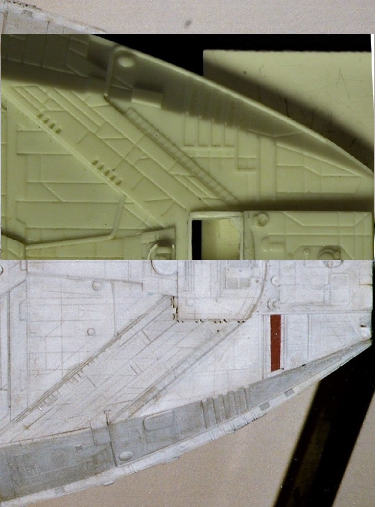

And here's the shapeways bridge with the same treatment, aligned on the model to the rear position so that we can see the nose details.
I got more to spout off on this, but y'all ponder till I get back!

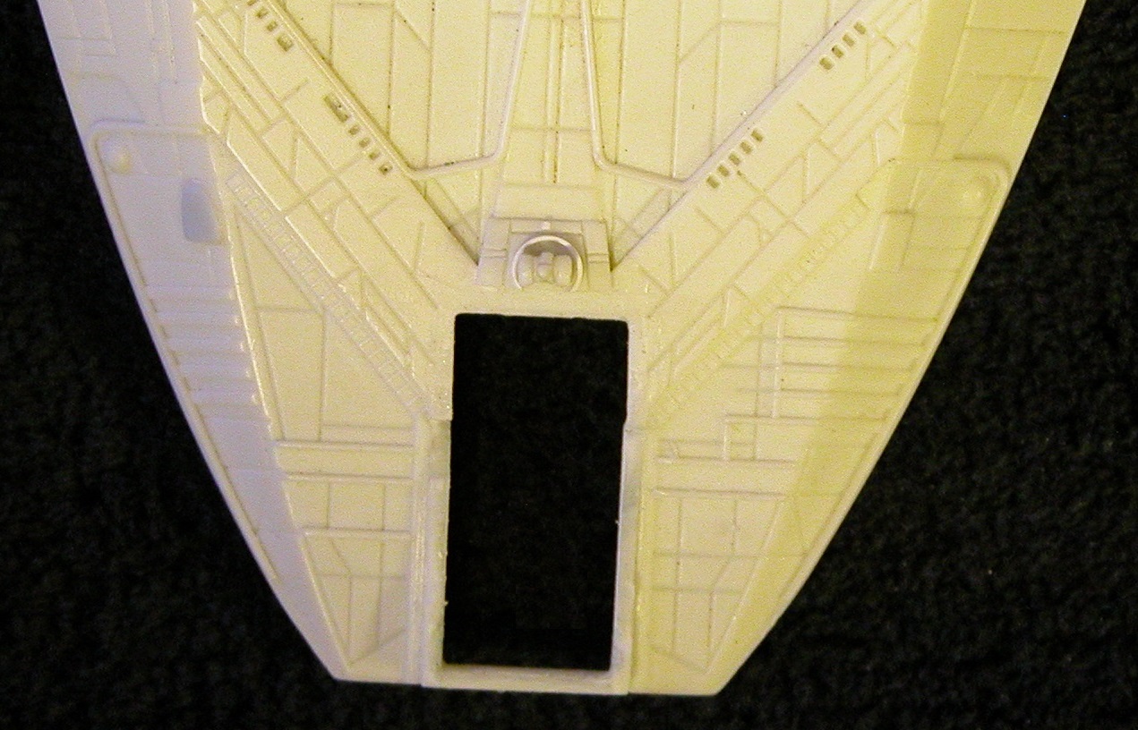

Here, is the model without any bridges in place.
Here it is in the "out-of-the-box" original head:
Here it is with my modded head. As I mentioned at the start, I, like "DUBS" have modified that ramp:

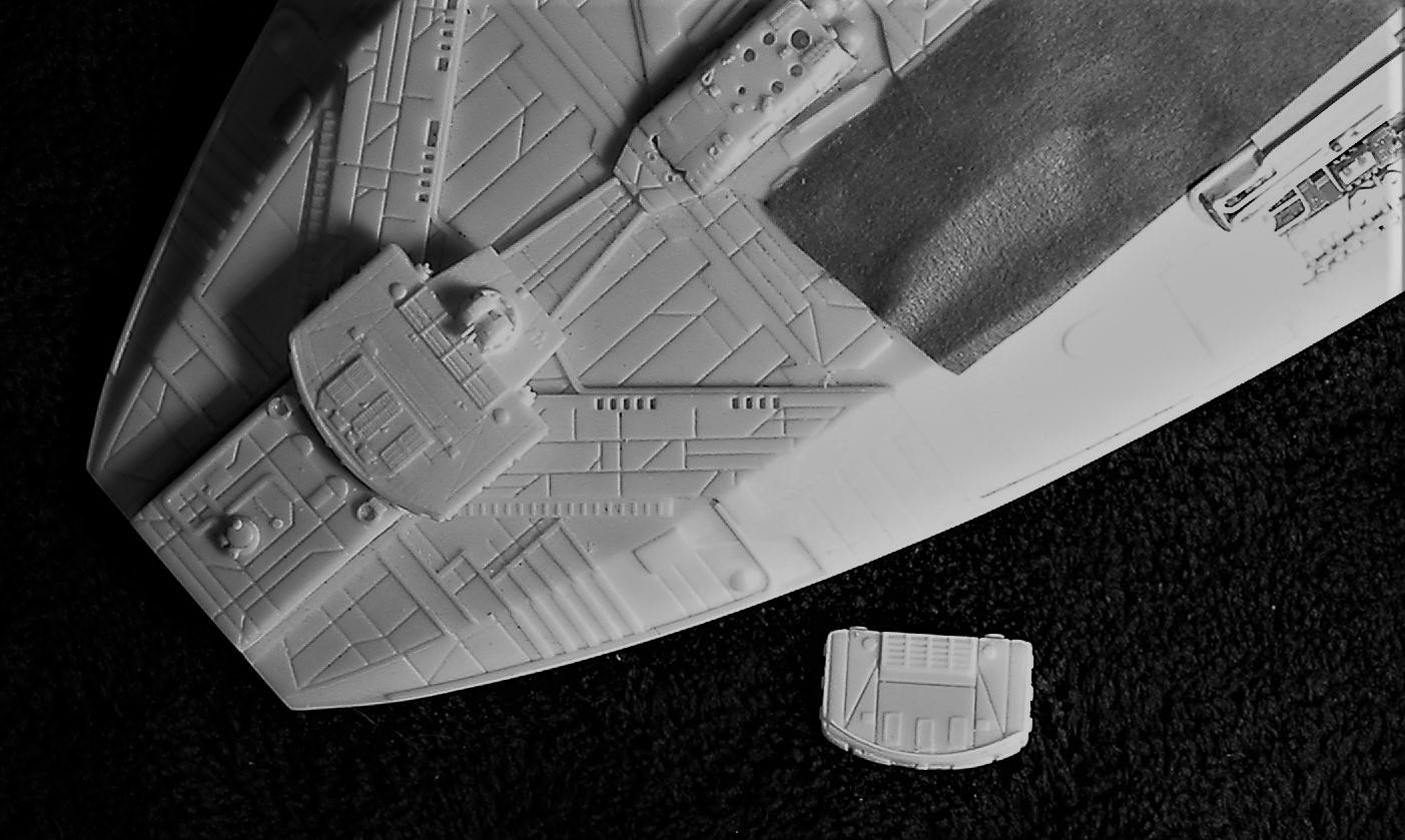

Now, looking at all these comparisons, neither the original bridge supplied with the kit OR the shapeways bridge are exactly right when compared to the studio model. One thing, and this may be a saving point here, that nose ramp appears to be a bit too long. If I take a little out of that and straighten up those two pipes behind the bridge (the ones Mr. Analyzer had to trim), I should be able to gain some ground here?
Y'all see what I'm figuring with this?

With much love an respect, none of your port starboard comparisons line up correctly, or perhaps it is just a less than accurate model (we should really just relax).
The trench for the red stripe is further aft on the Mobeius kit as are the vertical stripes on the side of the gator head.

Yes sir, that's what I'm trying to show. There's several problems here, but correcting that nose ramp just a little and fixing those pipes more studio will give me around 3-ish MM's. That nose ramp is far enough off that correcting that should do the trick alone. Starting from the first details up that ramp, the details start getting off. With mine, it will be an easy fix because I've already removed it from the model to raise it and have added the extra styrene sheet under it.
Just by trimming that front ramp (simulated in this picture) everything lines up much better.

I agree, I think the main issue with the Moebius kit as you mentioned is the nose part is too long
It looks like the Studio model has a stubbier one and the round raised parts and other greeblies in front of the bridge are too far back.
You almost have to rebuild that ramp section if using the Shapeways bridge or make some kind of compromise
that's what was done here
I did warn that once you start looking at the details on how to fit the bridge it opens a whole can of worms and you start seeing how off some of the details/shapes really are

It appears to me to be a combo of both Mr. Analyzer. That bridge is too large AND that model is wrong in that area. We'll, as you've said, do what can be done for a compromise.
I just said watch the thumb yet I'm still gonna type this and cut that at the same time. Multitasking at it's finest.
In the immortal words of Mr. Ray Stevens, "Hey Cyclone, remember me? I'm the guy you put ta sleep, only THIS time you can SEE I'm, not alone!"
Ok, maybe the wrong quote, but we are now "noseless". Feels like starting over! Next, I'm removing the ramp behind the bridge.
