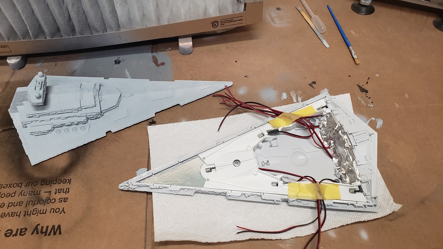

First up is one of the Star Destroyers, this is the only one I plan to light up.
I purchased the kits without a wiring kit so I just made my own and to be honest, in the end, it ends up looking much better than the one from Bandai I did a while back.
First up is a coat of Alcald Grey Primer along with getting the initial set of LED's run:
This is followed by a coat of SP Lettering Grey and getting all the wiring put into place. I was pleased to see that even though this was not the light-up version it still comes with all the parts except the electronics which made this much easier.

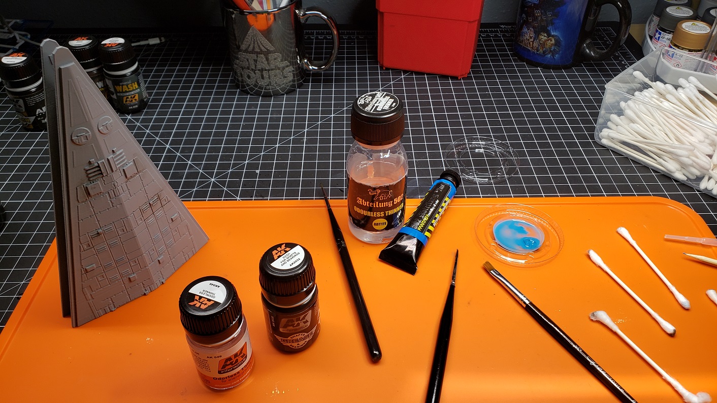

Same on seeing what I can do with the paints. My biggest challenge right now is the weathering. Normally once I get the base coat down and maybe a few passes with the airbrush for initial weathering I will gloss cote everything and then hit it with various washes (enamels and oils) and then flat coat it. The problem with that is after you gloss and flat coat these they seem to lose a bit of that 'special quality' so I am doing some experiments on that front.

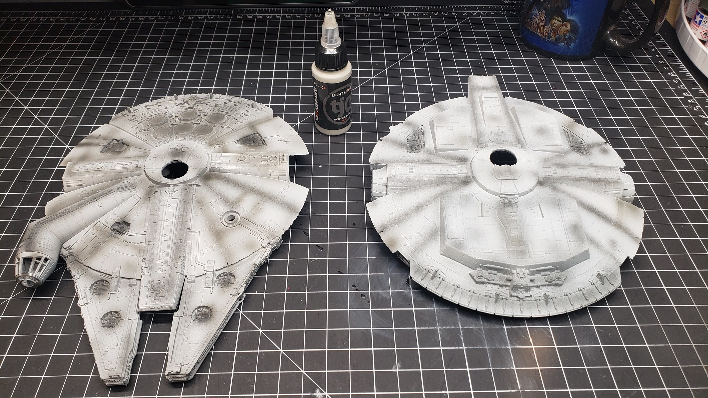

Well, here goes nothing! I am always intimidated by painting the Falcon, it's why I have had my PFG for 3 years now and I still have not built it.
Step 1 > Primer coat with Alcald Grey.
Step 2 > Pre-shading with Tamiya Nato Black (yeah, not Archive X but this color is just so good):
Step 3 > Basecoat with Light Grime, AX-004. As I am going for a more ESB version (although I make no claims of any kind as to my ability to actually replicate anything with any fidelity or accuracy) I went with this color. For an ESB, according to the Archive X website, this is the best base coat to start with. I wish you could see it in person, this color is just amazing.

Thanks for the inspiration, I decided to grab one of my test prints to use for a test bed also as I have not done that yet for these paints. I tried both plain Archive X and with a few coats of Tamiya Clear. The Archive X is surprisingly strong. I have been hitting it with oil paints and enamel washes all morning and it seems to be holding up very, very well (including taking the wash back off). Do you typically flat/gloss coat the Archive X paints? If so, what do you use?
