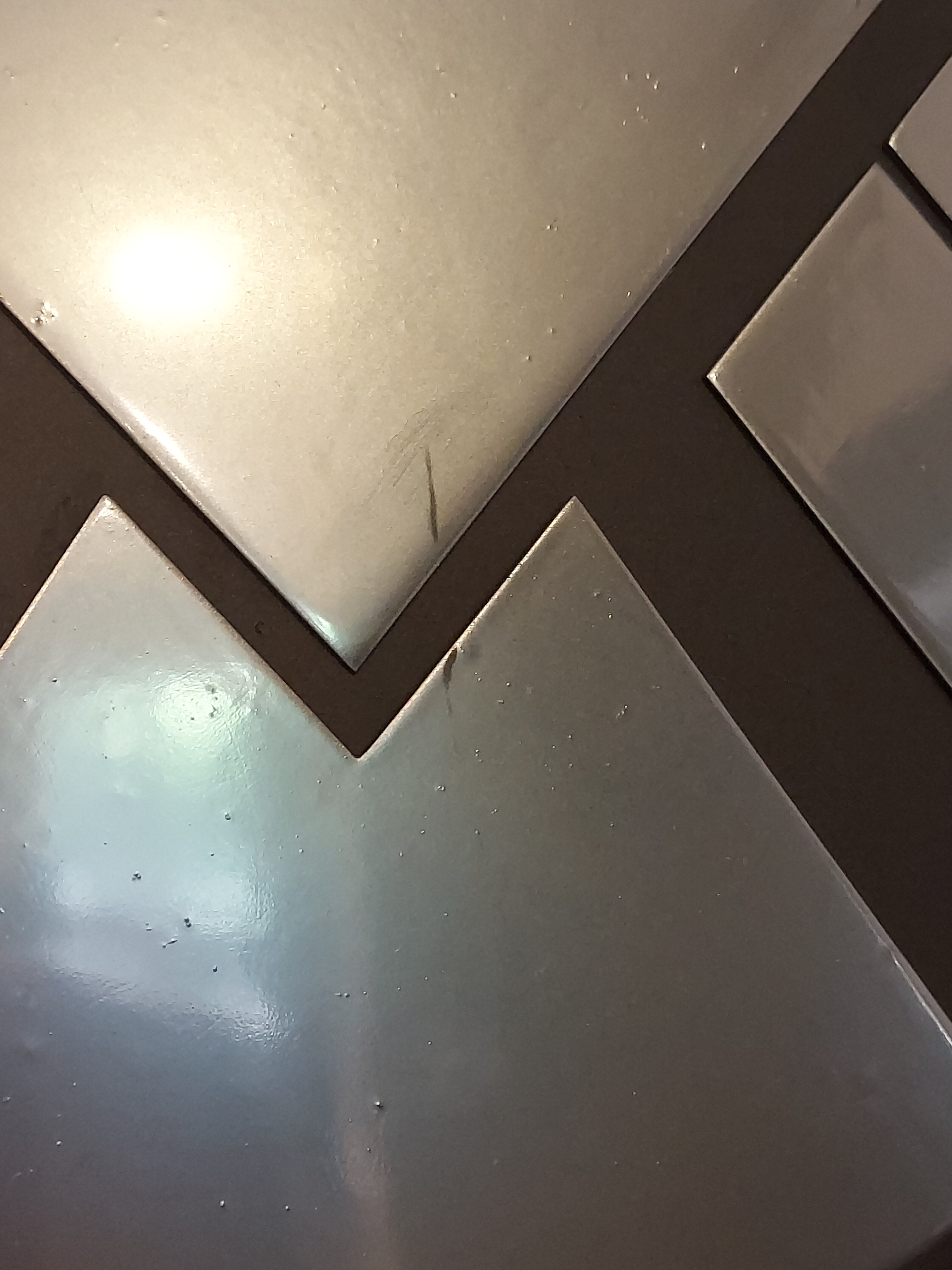

My Agents of Shield emblem I made last is so extremely scuffleable.
I actually had to take it off the wall like 2 months ago, just for a little bit. Only handled the non chrome edges, carefully set it down, and then re hung it later. It somehow ended up with this mark.
