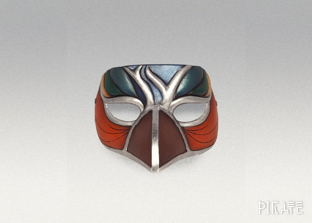

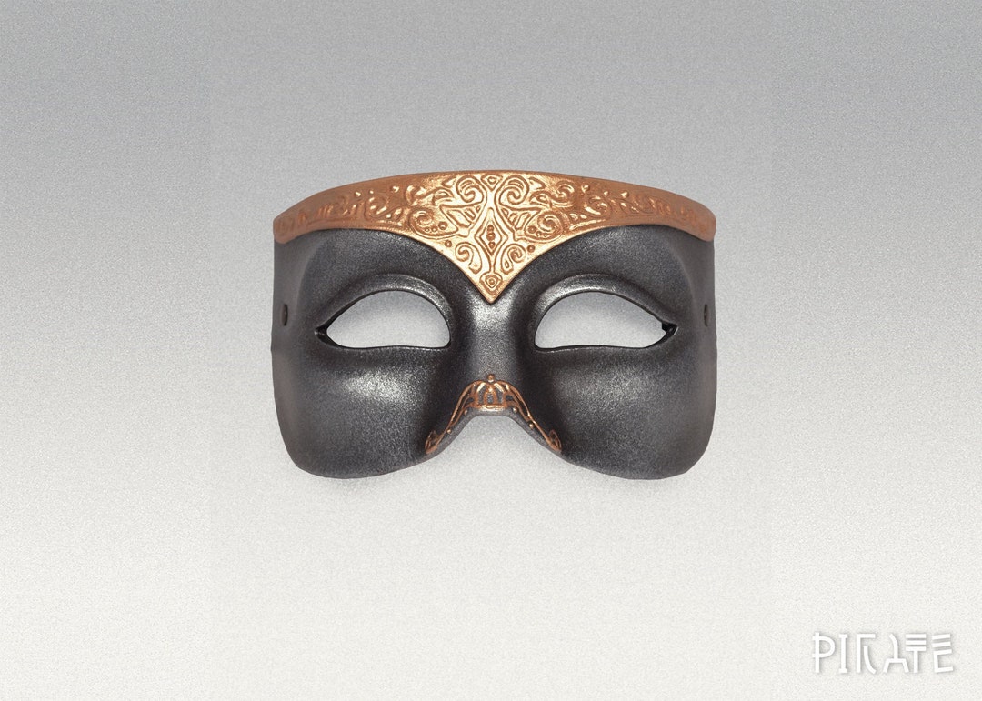

For sure I know it's possible to achieve a metallic like coloration as there's a maker who has done a number of beautiful theater style masks:
Atelier Pirate
Ref
