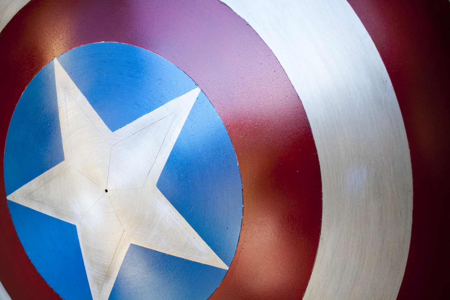

Love your build Valor. Absolutely stunning work. But how did you draw and cut out such perfect circles? Did you use the same kind of clock hand method you used to give the metal the spun effect?
Edit: Nvm should have read pg 15 first.

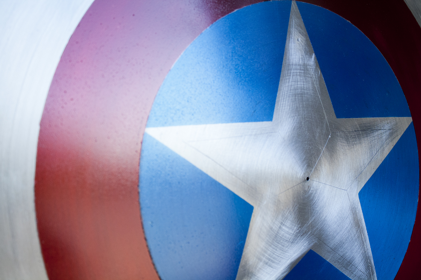

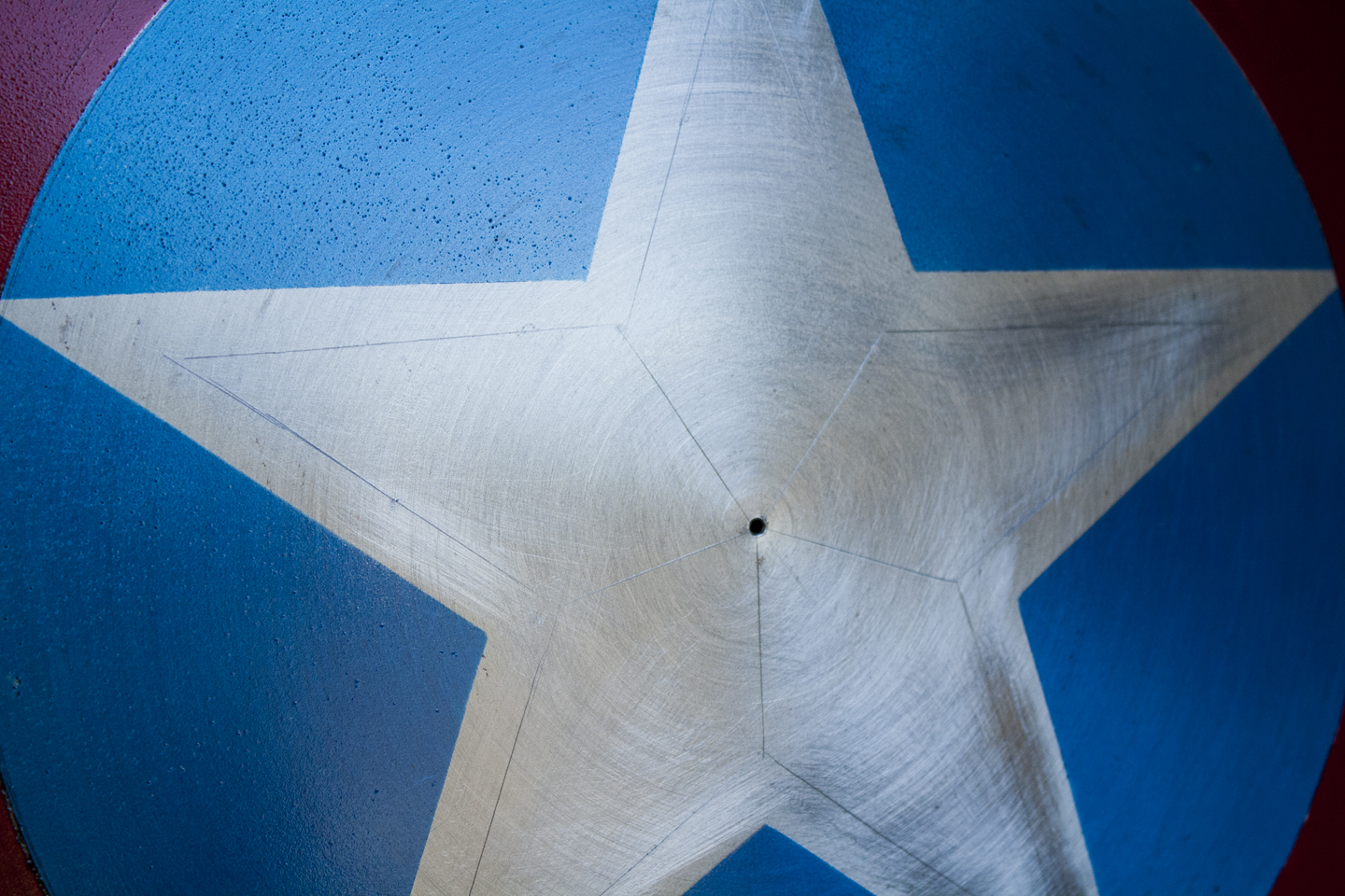

1st Off let me just say, "THANK YOU!" I just completed my shield and can't thank you enough for this thread. I went the comic book route for my Cosplay attempt at the ECC this year. I wanted something Iconic for Stan Lee to sign and couldn't think of anything better than this. Building this myself and seeing the finished product makes me GEEK OUT! Again thank you so very much.

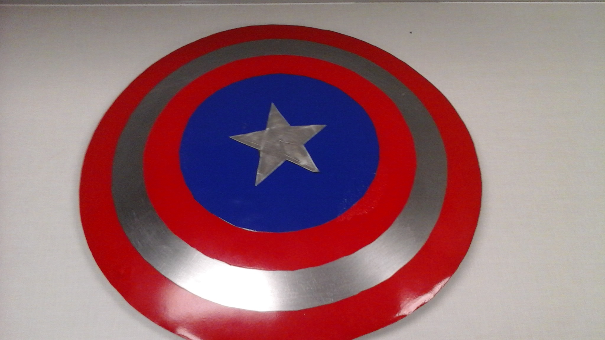

Here's the pictures of my completed shield front. The martha stewart blades made cutting the circles easy, but I had some problems with the tape itself and so there's a few rough edges.
I decided to simply mask out the star for budget reasons, it turned out surprisingly well. I printed out Valor's template over two sheets of computer paper to get the scale right. Then I took some painters tape and covered a sheet of wax paper with it. I used the template to cut the shape out of the sheet of tape, then simply peeled off the wax paper and applied it like a sticker.
To get the pattern on the star, I simply used a straight-edge and my x-acto knife. It turned out a little more rough that I had hoped but not too bad overall. I'm in the process of finishing up my leather cutting/punching then I'll have one awesome shield!
Thanks once again to Valor for this amazing thread

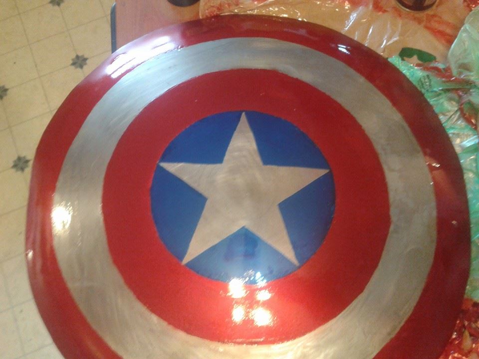

Thank you so much for putting all this together valor, my clear coat is drying right now and I see what you mean about the orange peel-ish look. When you put the last coat of buffing wax on did you just do it by hand? And in a circular motion or just rubbing to your hearts content? Thanks
Yup. All by hand and soft cotton t shirts.

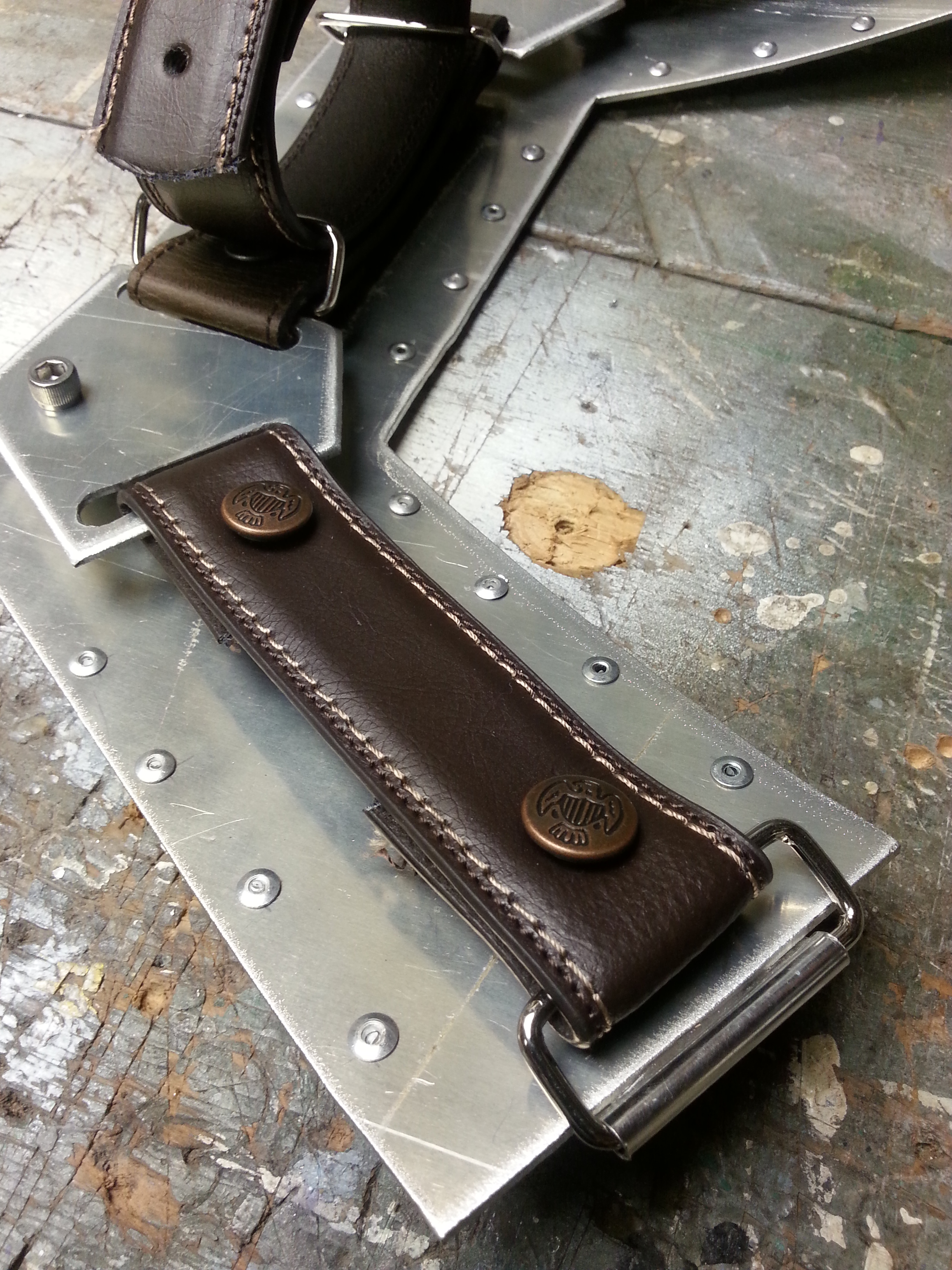

Valor, I personally wanted to thank you for sharing all of your tips for this awesome build! I know I'm a little late to the party but I stumbled upon a video on Youtube just a few weeks back of this project and couldn't NOT give it a go. So I rushed on to Amazon and bought myself a sled. I have it cut and stripped and applied the spun look and it looks awesome so far! Can't wait to paint but I've decided to do that last. So I've used your blueprints and started fabricating my handle brackets. I have one fully completed and I must say I'm pretty impressed with what I've done. Just waiting for my JB Weld on my tee nuts to dry and get the second one assembled. I'm not going for movie accurate, more of a custom job to make it more personal. I had a few questions however. Has the tape held up for you with holding the brackets on? I prefer not using JB Weld for that if I don't have to. Should I paint blue first? How did you go about masking the circles? Should I use the center point technique with a pencil and mask around my line with pinstripe tape? Did you clearcoat the back? And if so, have you had any issues with yellowing of the metal. My brackets are made from aluminum. Any suggestions would be greatly appreciated! Thanks! And thank you to everyone who has posted something regarding this project. You have all been a great help and an inspiration!
That looks great, what aluminum do you use for your brackets and where did your source it?
Looks awesome. Live the eagle rivets. The 3m tape is still holding on all my shields. If you have a center hole using a spinner from that hole will get you perfect circles. And be sure to clear coat the back. It's steel and will rust.
