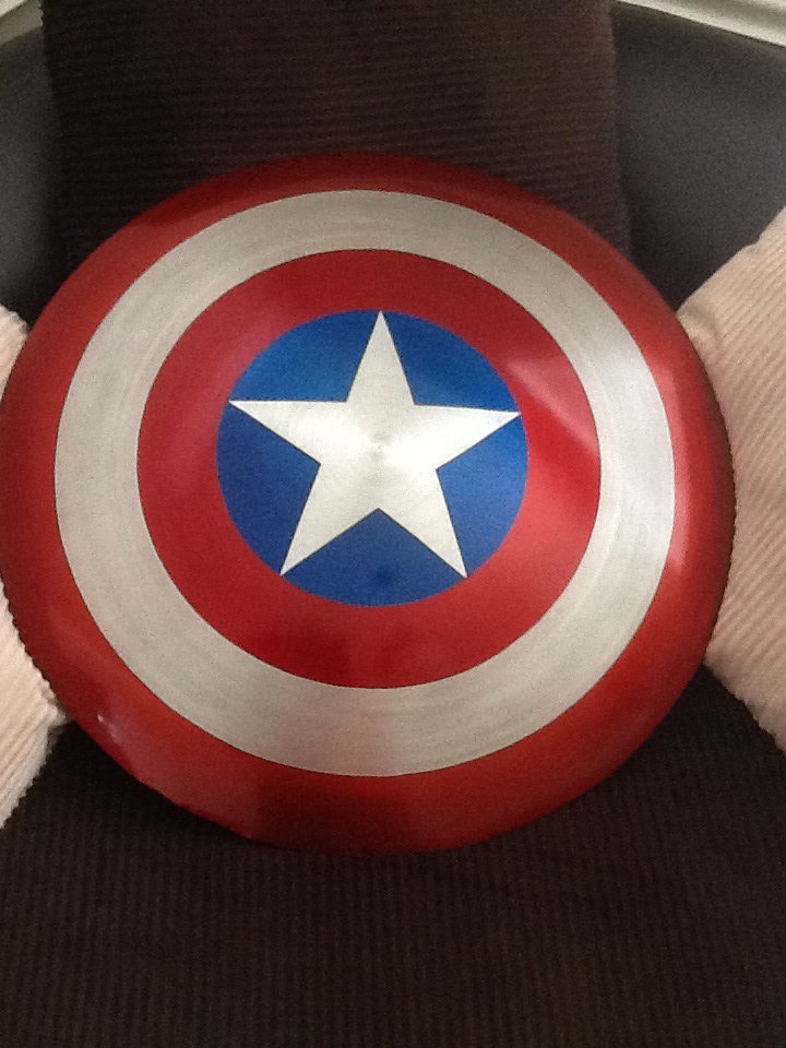

Metal Movie Cap Shield on a budget **DONE!! FINAL PICS ON PAGE 4

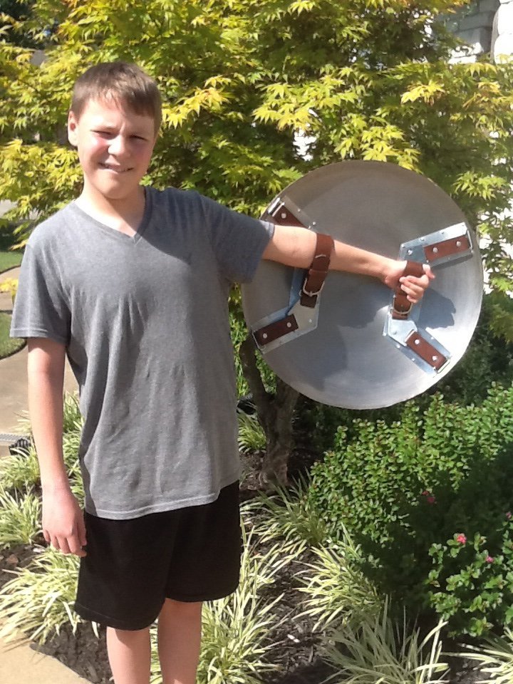

Whew, think I'm on the home stretch now. What are you ppl using to attach the leather strap (aka belt) to itself? Thinking t-nuts, since I'm not seeing anything here and check stores and can't find much. Thanks in advance.
Home stretch also. I have the same question for the leather straps. I am building a shield for my son out of the disk sled. This thread has been such a huge help! Thank You!
The smaller fasteners that connect the belt to itself are called Chicago Screws.
Four T-Nuts mount from the back of the bracket and hold the whole leather harness to the brackets.
Two different fasteners.

Finally Finished! Not perfect, but I'm very pleased. Appreciate Valor and all the helpful tips and pics.image.jpgimage.jpgimage.jpg
