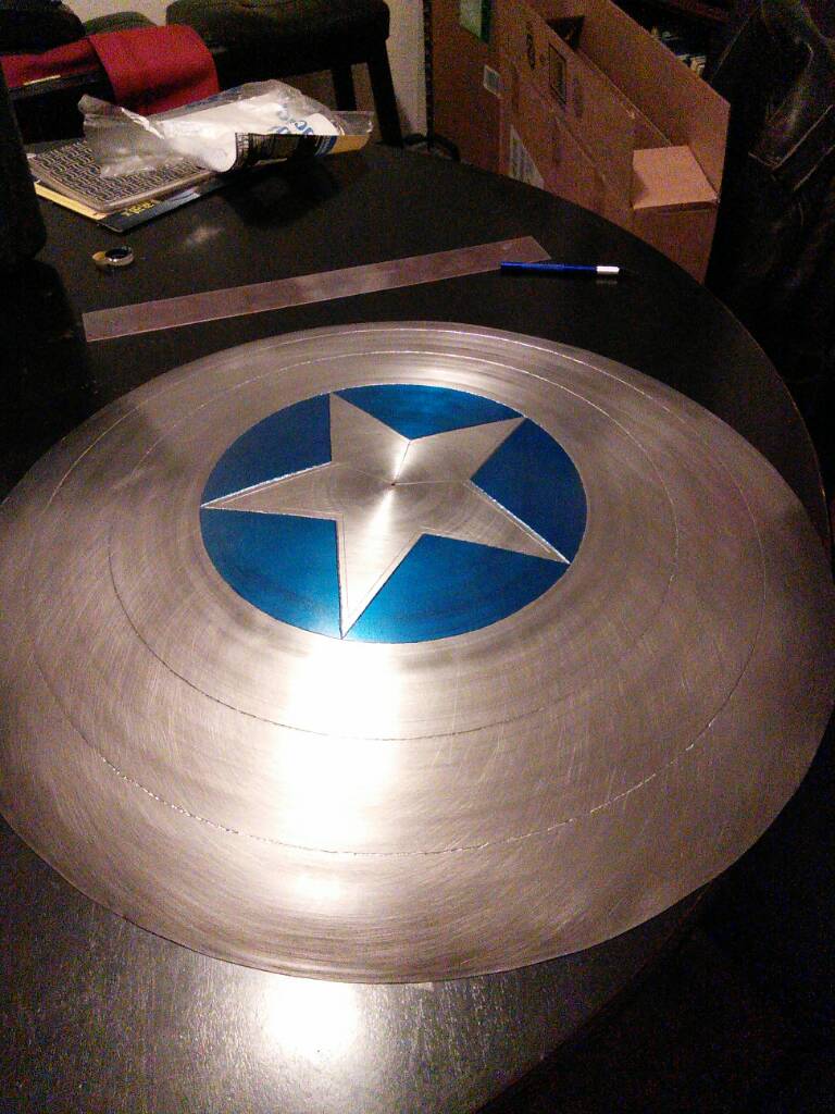

Yeah,that it does.I'm thinking about maybe trying to heat them first. I also wanted to share a shot of the shield I'm working on.I actually(carefully) engraved both the star and the grooves into the sled.it took a long time but I'm liking the effect. uploadfromtaptalk1412055307897.jpg

Yeah,that it does.I'm thinking about maybe trying to heat them first. I also wanted to share a shot of the shield I'm working on.I actually(carefully) engraved both the star and the grooves into the sled.it took a long time but I'm liking the effect.View attachment 382804
Looks great! I was scared to carve grooves into the sled, which is why I went with the spun shield, but you nailed it! How'd you go about carving them without going too feel into the metal?
I had the rim from a previous shield that I'd made. I went through a bunch of different attachments for my dremel but ultimately landed on this one
http://www.dremel.com/en-us/Accessories/Pages/ProductDetail.aspx?pid=9901
I basically practiced on the discarded rim,holding the dremel like a pencil and figuring out how deep I could go and still maintain the integrity of the metal.
It turns out the trick is to do a single cut for depth then go over it on each side of the cut with a shallower angle to make it look larger and deeper than it actually is.

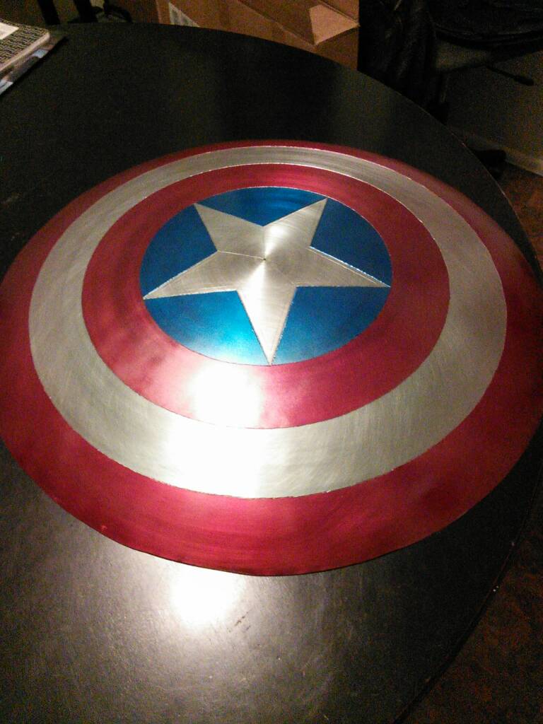

Once you put down paint it makes it pop even more.
Here's after I added the red today, I still need to polish and clear coat it.

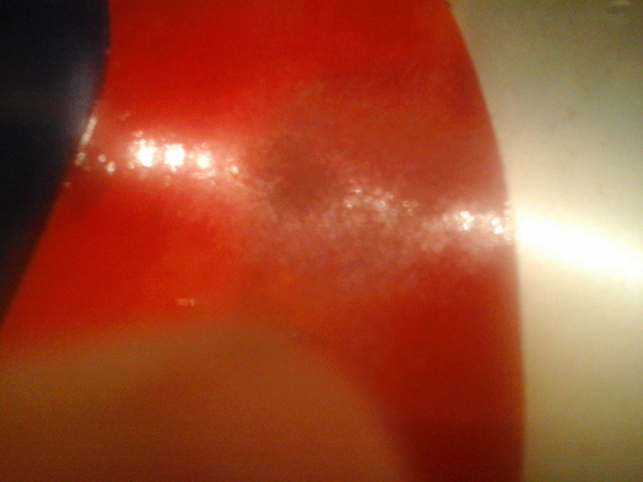

dang it i decided to give my clear coat an even finer wet sand but after i did that the clear coat got all cloudy like normal and then after the turtle wax it would go away but that didn't want to happen this time it just stayed cloudy aaaaarrrrrrrrgggghhhhh. the last grit i used was a 2000 grit. it just looks like crap now:facepalm:cry:thumbsdown

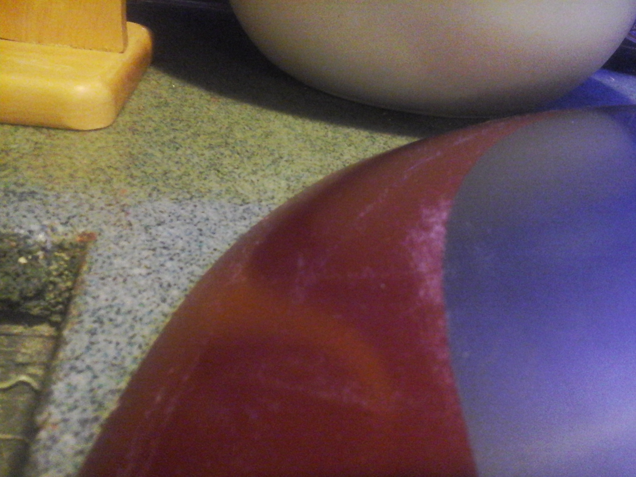

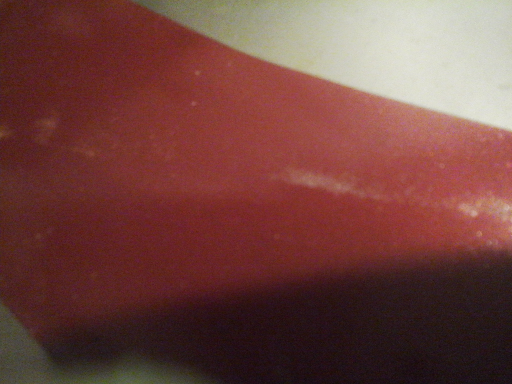

The worst thing happened this weekend. I took my new
shield to a local con , in a canvas bag I'd made specifically for it. The last time I had done any work on it was over a week ago. I took it out of the bag, and tnere are dents in the finish caused by the weave of the fabric! What 20141005_202155.jpg20141005_202210.jpg20141005_202229.jpgcould've happened?
You could try a courser polish than turtle wax. You need to actually polish and not just wax it. I usually use a rubbing compound then finish with something like Turtle wax.
shield to a local con , in a canvas bag I'd made specifically for it. The last time I had done any work on it was over a week ago. I took it out of the bag, and tnere are dents in the finish caused by the weave of the fabric! What View attachment 385622View attachment 385623View attachment 385624could've happened?
Was it clear coated or just the paint?
It looks like the bag has rubbed through the paint.
I must've hit it with 8 coats of clearcote. And, they were done over a week ago.
