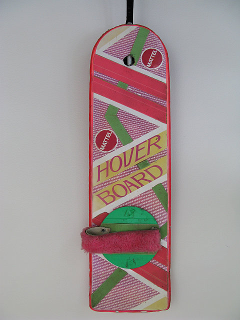

Yeah, we can blame Roland for that ;). I'm using his upgrade kit he sold a while back for the Matty boards.
Come to think of it, there is no way to put the strap under the foot pad because the foot pad is a solid cylinder that extends down into the board's innards.
I think you had to peel off all the original stickers to access the screws, right? And the strap was just kinda tucked in?
I have not pulled mine apart yet. How is the strap attached?
The foot strap is hold by its 4 holes under the pad, really easy to remove but yes, you have to entirely disassemble the board to do that...
Cool. Did you keep the original velcro under the new strap?

You can keep the old one and shorten it by the middle (cause it's way too long) then sew the pink fur over it and insert the excess into the slot.
You should be able to do it without removing everything.
I actually sew my fur on a piece of white banner then replace like the original one but had to disassemble all the board to do it.

I agree with you. ;) But as 121Gigabytes said: There's no way to put the strap under the pad on the Matty board.
Oh but there is...:devil. It just involves taking the board apart, gluing in a 3D-printed piece of plastic to completely fill the large hole to make it level with the top board surface, and then attaching a 3.5" lazy susan with 6" aluminum footpad disc to the new plastic piece.
Which I will eventually show when I finish my HC board...
