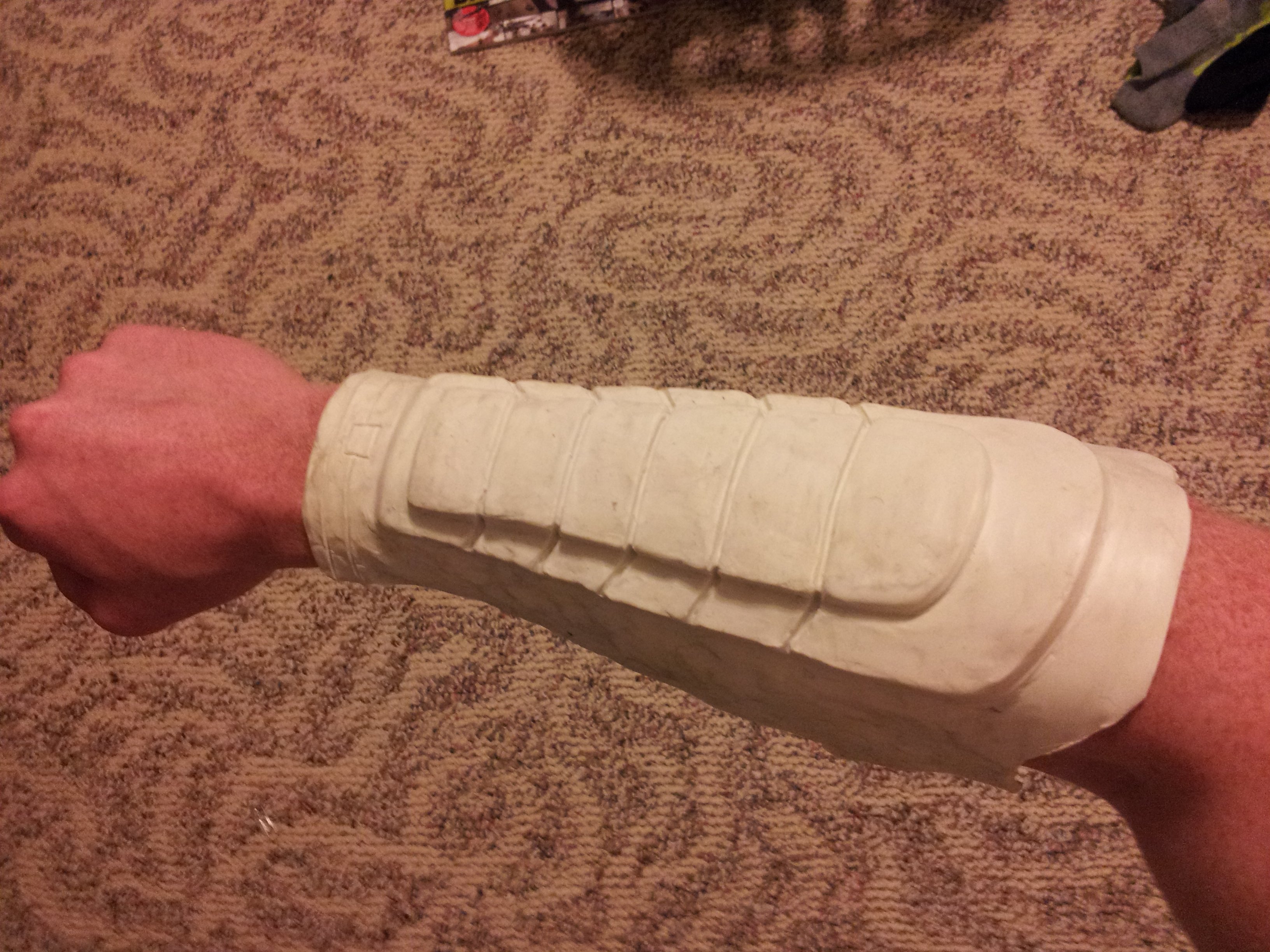

Thanks for the tip. That's actually really simple and makes a lot of sense. I'm not going to do it with the forearms unless they don't look right just because I don't want to redo the right one if I don't have to but I'll definitely try it with some of the other pieces. I'm still working on smoothing out the forearm but I thought I'd add a few more pics since it looks closer to the final product. I still have to do the under arm but that's almost just a smooth piece.

Thanks for the support guys! Means more than you know. Didn't do a ton tonight but started the mold of my left arm. Decided to pull the clay off the right cast to just check the fitting. It actually didn't stick to the arm casting at all and came off really smooth. I had to trim a little from the inside of the elbow so I could bend my arm so it's a good thing I gave it a fit. It's back on the cast now just waiting for it's twin to be crafted before I make the mold of both. Also ignore if I mix mold and cast. I have no idea what I'm talking about let alone what I'm doing!

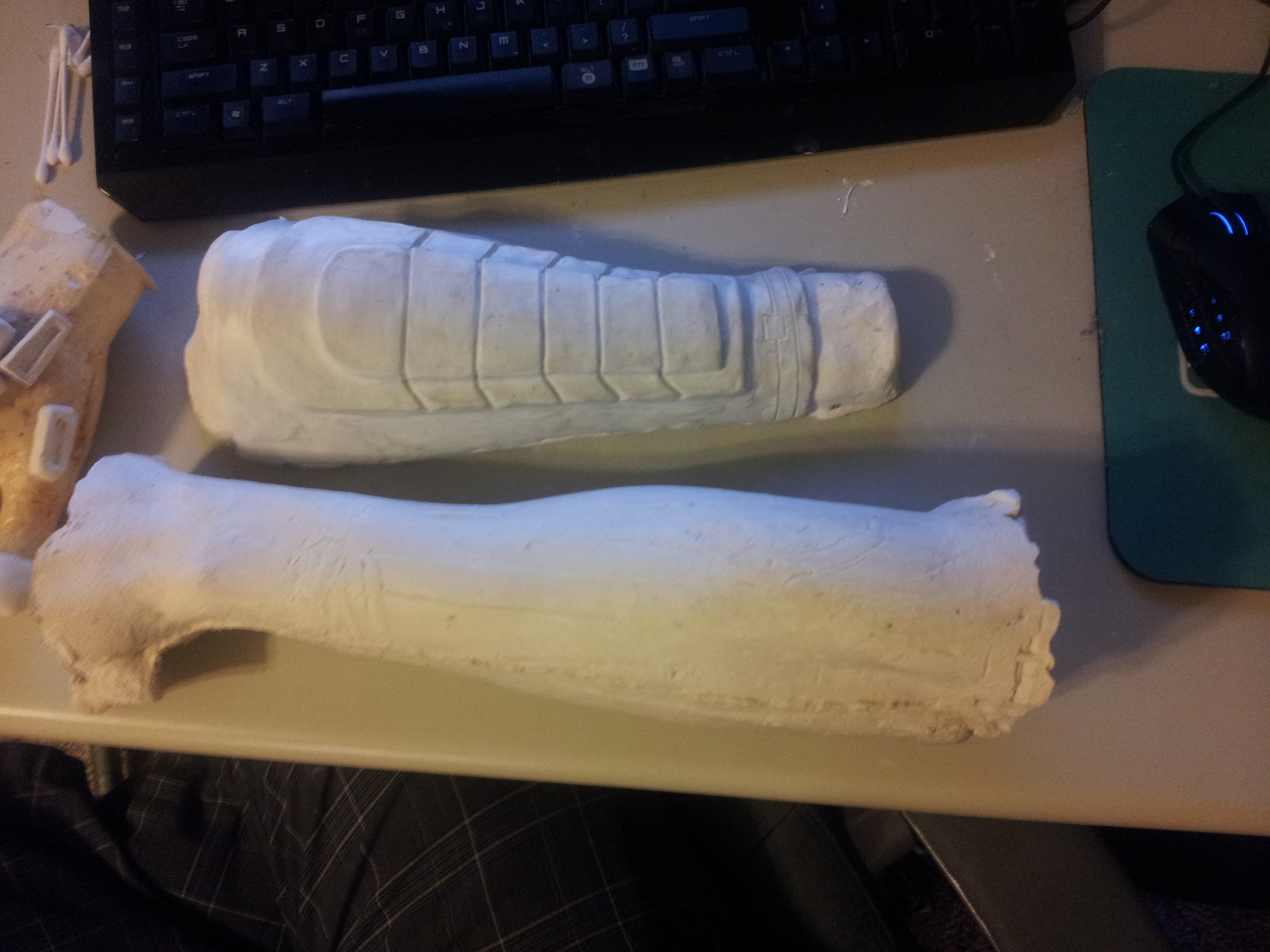

Away from the humble brag and back to the interesting stuff. Since I had to fill the whole mold rather than a half I had to take the pieces together and pour the plaster in from the top. I used some natural clay at the bottom to both hold the cast upright and to plug the end. The nice thing with the natural is it dries but just add a little water and it's good as new. It also seems to repel the Vaseline so it stays reusable until plaster shards start really working their way into it.
After it dried I pulled it out (had to break the hard shell) and got the arm! Needs a little sanding on the seam but I may leave it just for a reference as to where half way is. Since it's the whole arm I can also create the under area and get a feel for how the whole thing will fit! Don't have much going on the next few days so I'm hoping I can blitz my way through this part and move on to the upper arms (after the under part of the right arm).
