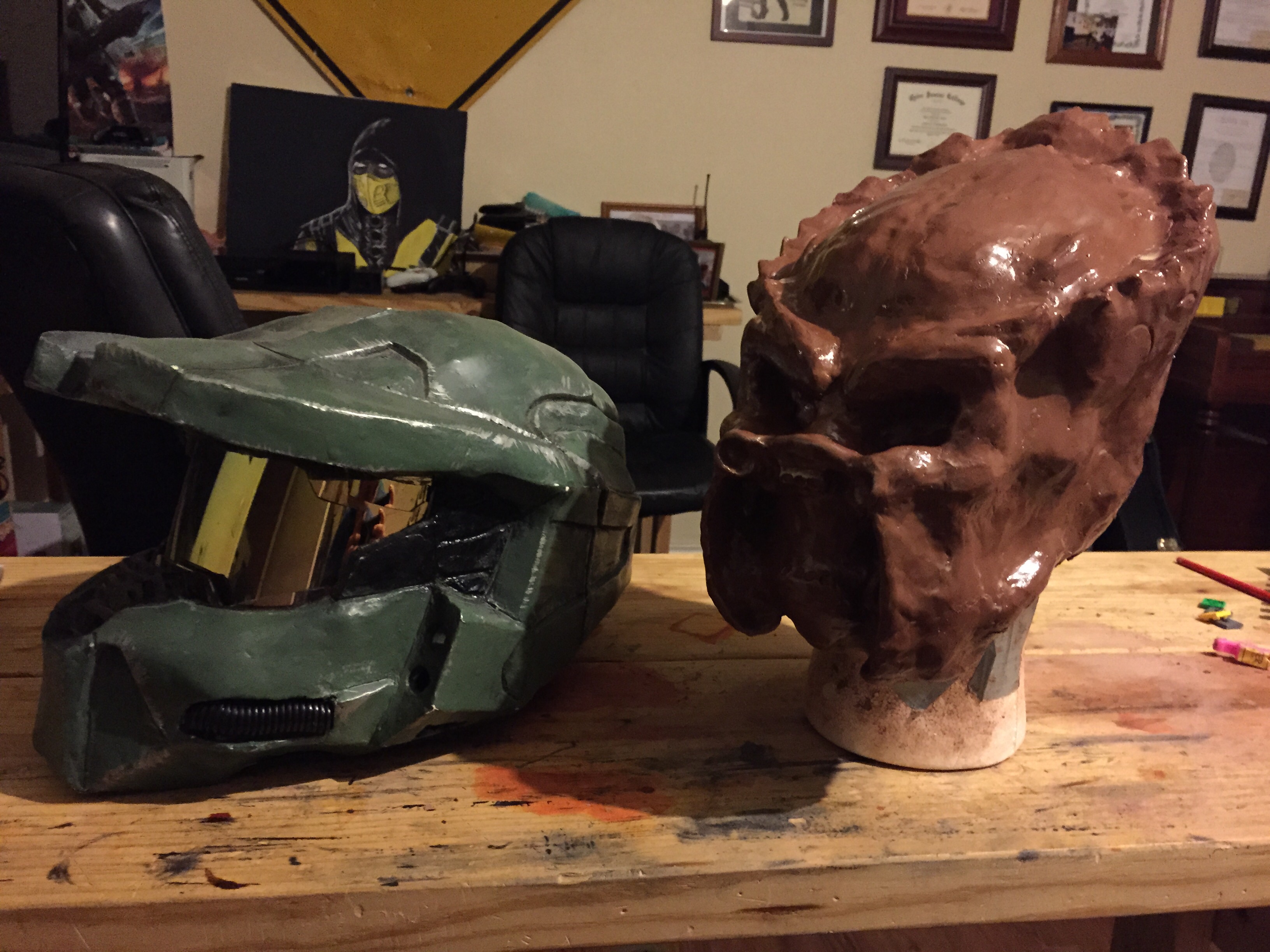

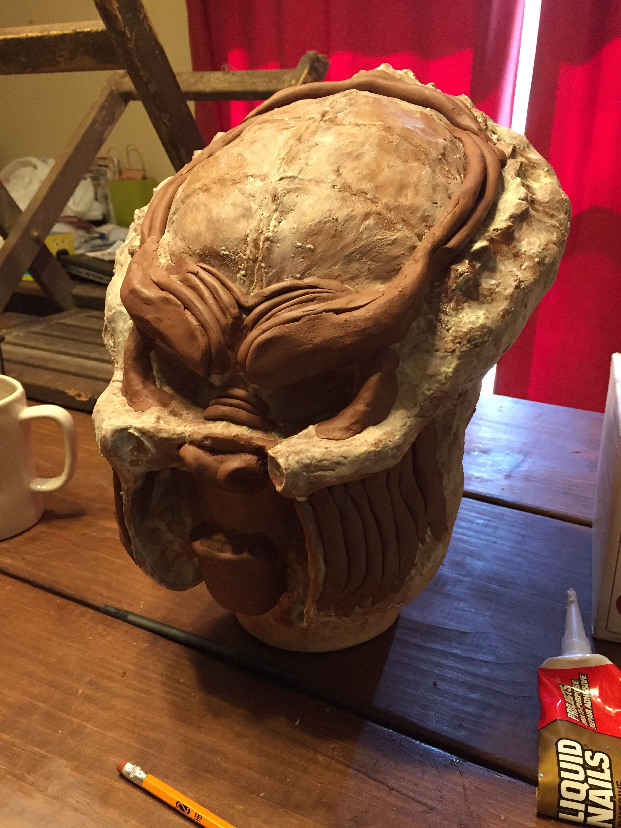

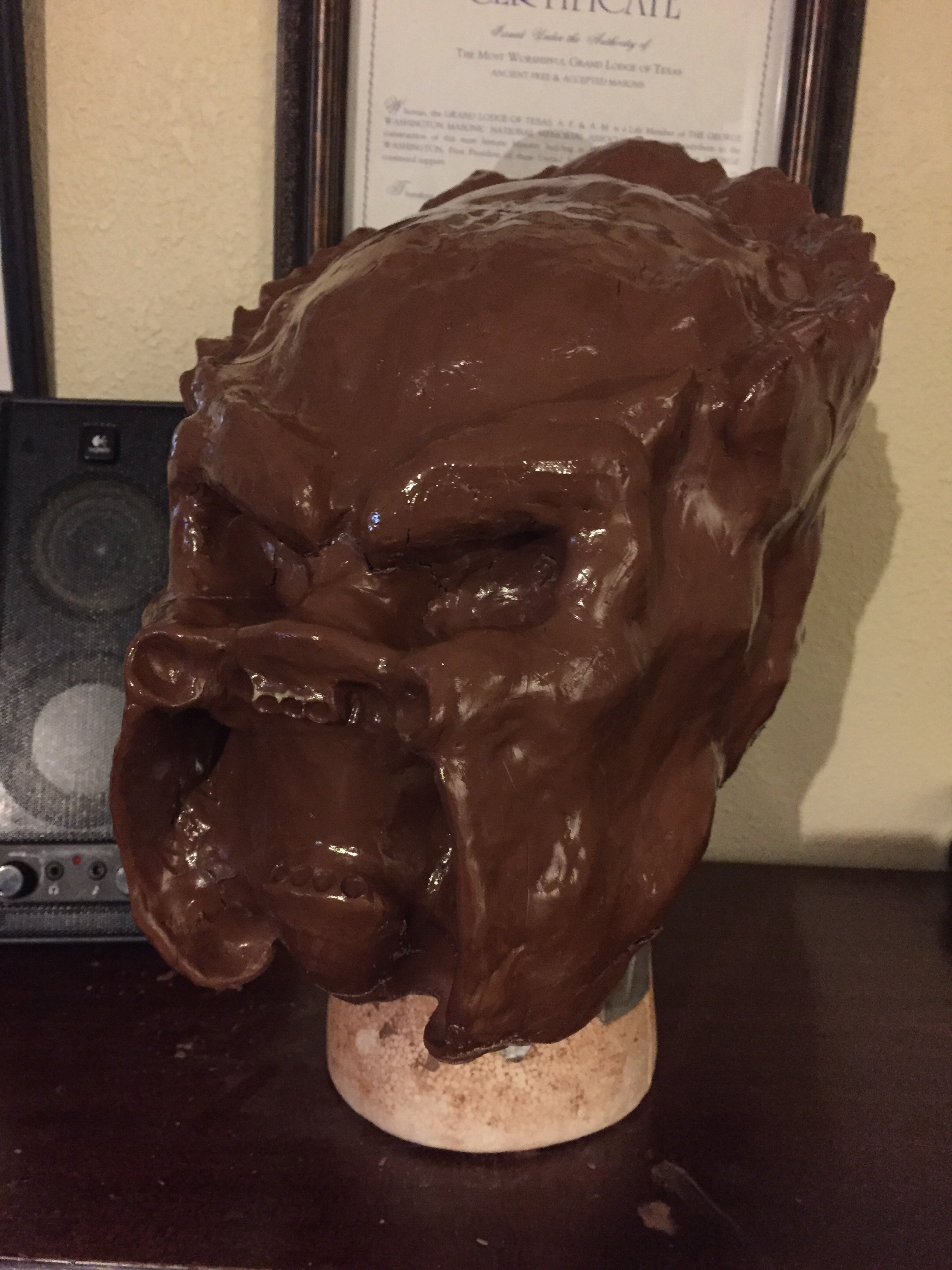

First of all I want to say thanks to the community again for all your help getting started with this! I am happy to report that the clay I used, after a bit of sealer, seems to be holding together good! I have a few more layers to put on this head specifically as I learned that I should have expanded the actual foam head underneath the clay more than I did, mask is a bit small.
Second, as I am new to working with clay, applying details to my clay has been a bit challenging. Anyone have any tips on tools and methods for applying things like skin wrinkles, textures etc. for a good Predator look?

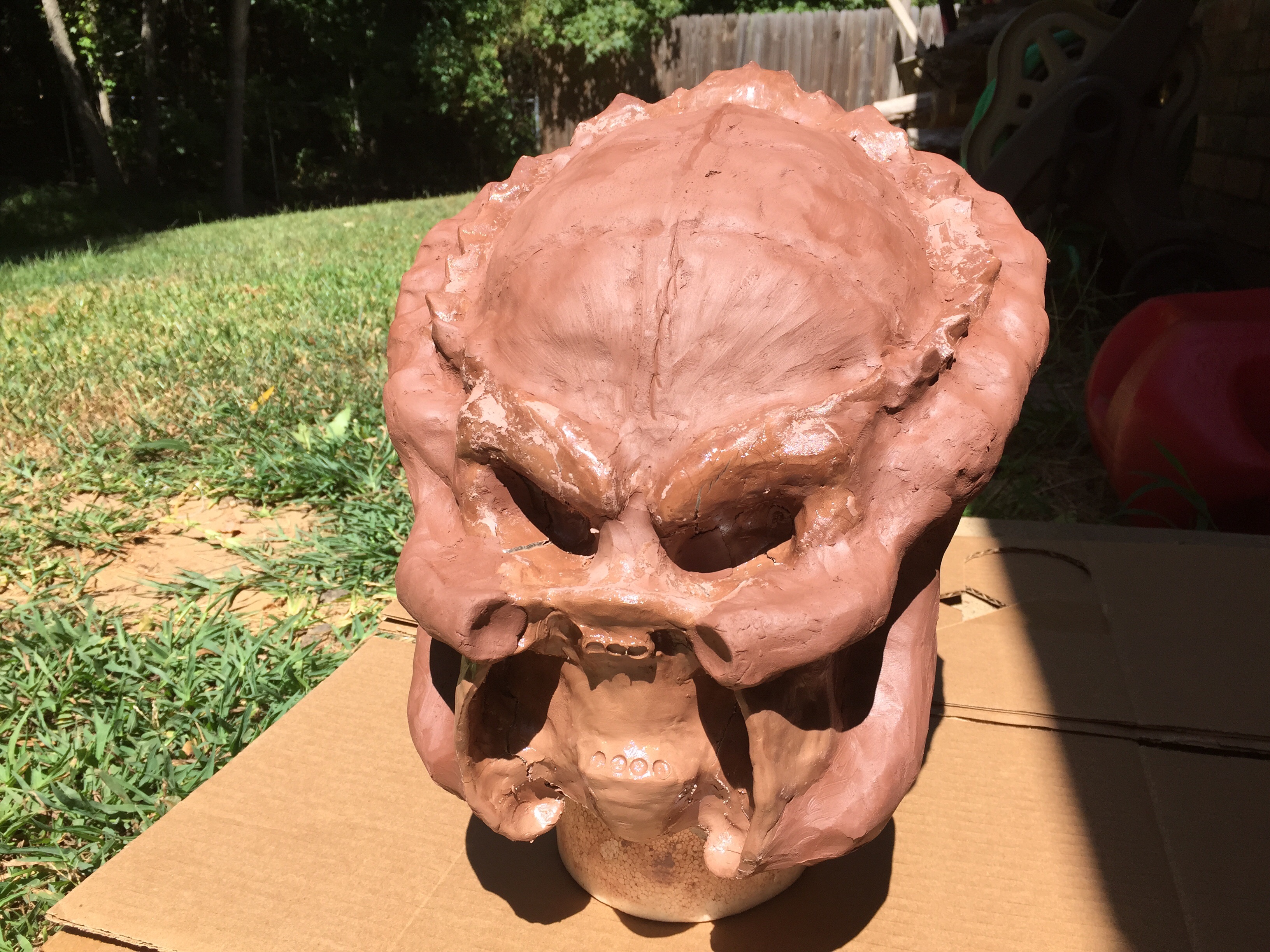

So, since I have already began this project with the wrong type of clay, and since I don't fancy myself a quitter, I am still working to see if I can get a decent cast out this head. As and experiment with the terra cotta (mostly because it is super cheap) I am continuing to add layers, and allowed the clay to dry in the sun after adding another layer of clay over a sealer layer! Takin into account my shrinkage rules, this head is almost the right size to yield a good size mask.
If it is a bust in the end, as a beginner, I will have taken away some great learning experiences for round two: First of all I feel much more comfortable working with clay, I am starting to tray and add detail and using a lot of the suggestions from the community which have made me more comfortable.
Second, I know have a real feel for the size of mask I need, a knowledge of the materials I'll need and the costs, as well as a MUCH better understanding of how the process is accomplished from start to finish. I did want to explain this as most of you have offered invaluable advice on materials (such as clay type), and as I continue to work on this particular experiment as I am calling it, I don't want you all to think I have not listened thoroughly to your advice! So with all that said, so far I have only spent 20 dollars on clay and this starter styrofoam head which has turned out to have been a beneficial learning experience!
As for the clay in question, with a dealer and using te sun to dry the clay quicker, it seems to be holding together surprisingly better than it initially had for me!
Well, first of all there is no 'wrong clay' (unless it's play dough or some other things, but that's not the point) water based/oil have their upsides and downs. Terracotta correct me if i'm wrong is water based like WED Clay, Wed Clay was used in the production of Predator 2 their whole suits etc was made from water based clay that could break at any time so they basically did what you are doing. 'Sealing and so on' there is a video about it on the SWS, (Which I might add is free on youtube, it's like 5 minutes but you understand the idea).
The more expensive route, that I have personally been told to go through by some of my Pred friends is to purchase Chavant Nsp Medium or Monster Clay, 'expensive here in the UK' with all the added tax. If you're good with water based clay basically you just saved your self $400+ when constructing a full suit. Waterbased clay is good for quick workers.
One thing, always remember once you make a cast, your sculpt will be destroyed the survival rate is extremely low (it sound's like i'm talking about Ebola... never mind about that) once you decide to make a cast there is no going back ;) it's a great adventure..
Terracotta is not like WED clay. Terracotta is traditionally for making Bowls and ornaments, it’s mud straight from out of the ground. WED clay was formulated by the industry specifically for FX work, it contains glycerine to prolong it’s life. The industry formulate clays for FX work Chavant and WED being among them. Terracotta is not the correct clay for what we do and is why he's fighting a losing battle with it. It’s not just about drying out and cracking it’s about the texture of clay, WED will hold detail much better,Terracotta is too soft. I used it to make my mold wall and I even found that a struggle, so I don't even rate it as a utility clay. The best sculptors would achieve poor results with clays not intended for the FX industry.
