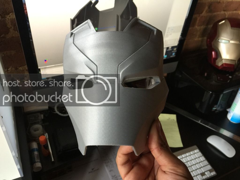

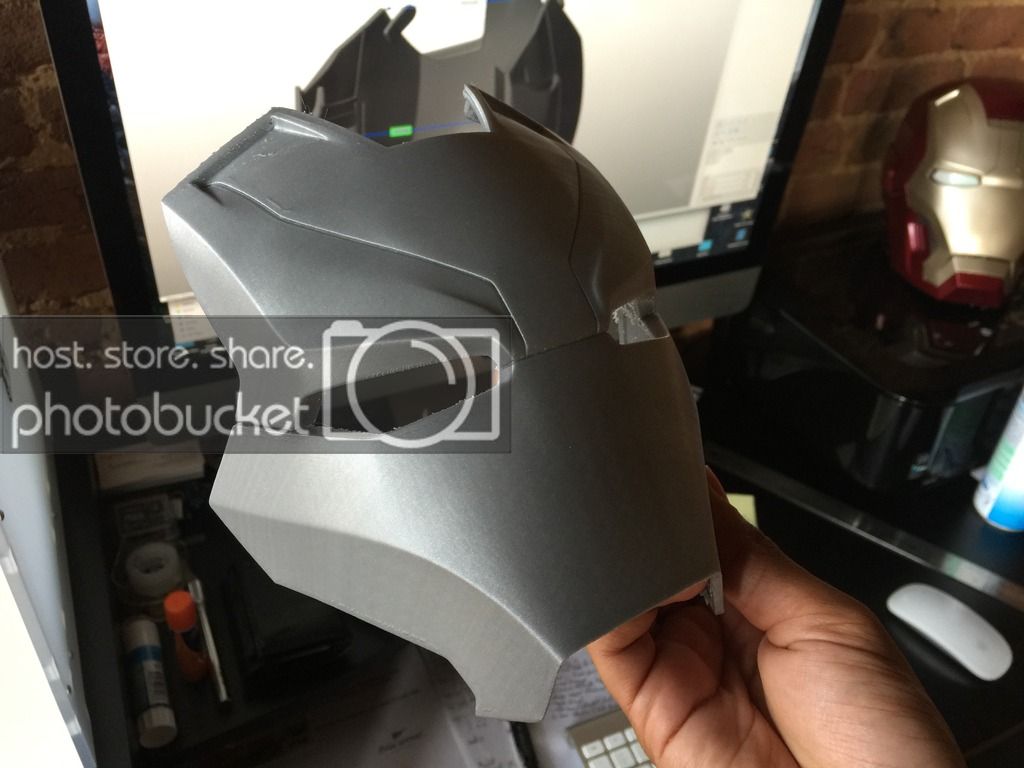

So just started printing the Mark 46 using Do3D's files. Loving it so far! Here are a couple pictures of the faceplate I printed out in one piece. This was printed with the ultimaker 2+ using Simplify3d to print it on a medium quality setting.
