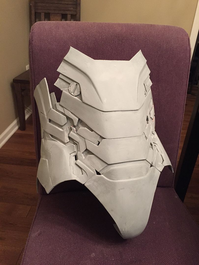

Started printing the ABS and COD. Do3D is currently updating the lower body to be a little more water tight. Looking forward to seeing the results. Anyways here's what I have so far. Chest is a little small, might end up making it again in the future if I cant get it to line up right with the back. Will have to see when its all finished.
Looks realy nice :)
