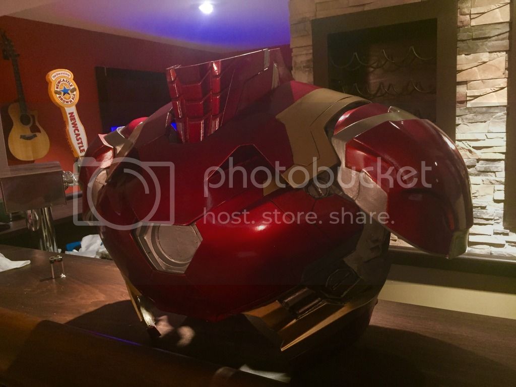

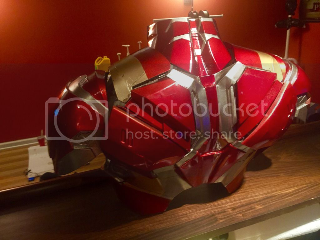

Finally finished the new shoulder bells. Neck is printing now and planning on molding my thigh and calves with the prints sometime next week Just want a little extra strength. Was thinking of creating some sort of garter belt to help keep the thighs up.
LEDs are coming in next week. The new arch reactor is in the mold waiting to be filled.

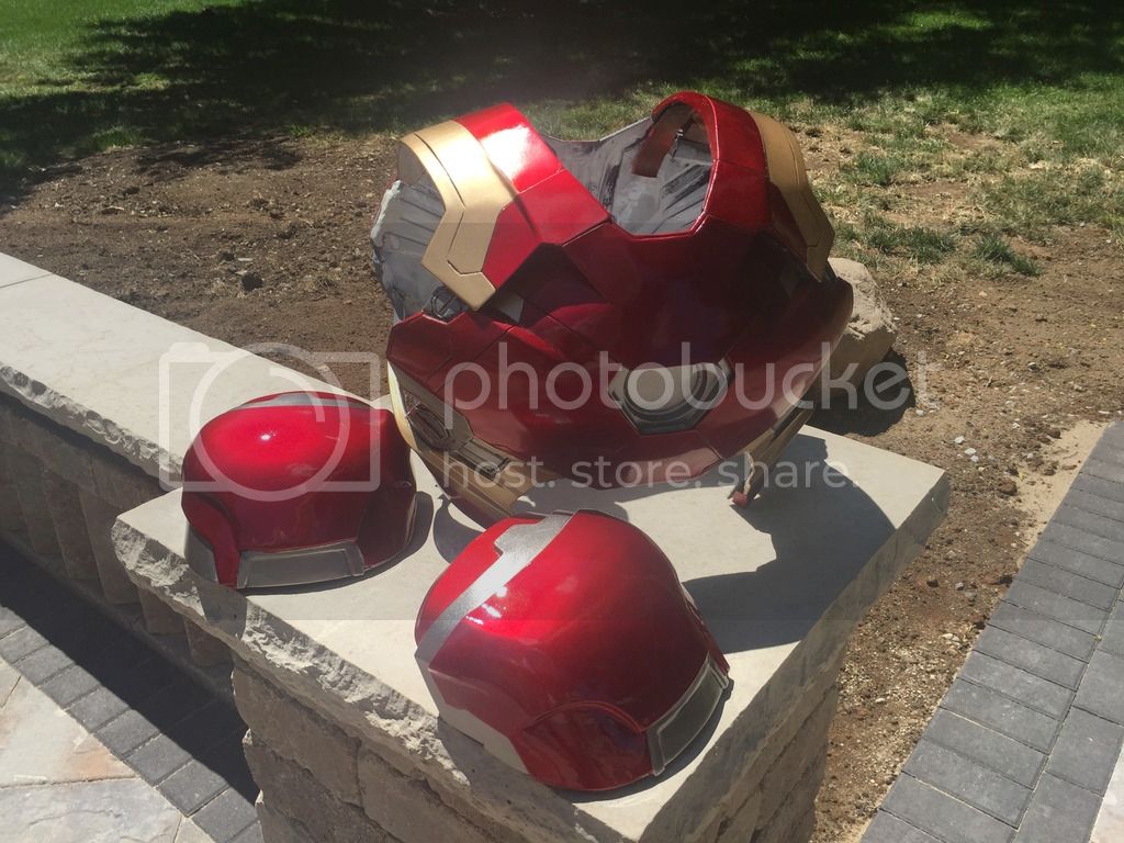

More progress yesterday. Shoulder bells connected and neck is finished and painted. Also decided to fiberglass the inside of the chest and shoulder straps. Biceps are almost done printing as well.
Unfortunately the arch reactor didnt come out as clear as I expected. Forgot to torch the epoxy to remove the bubbles. Another one is in the mold and curing.

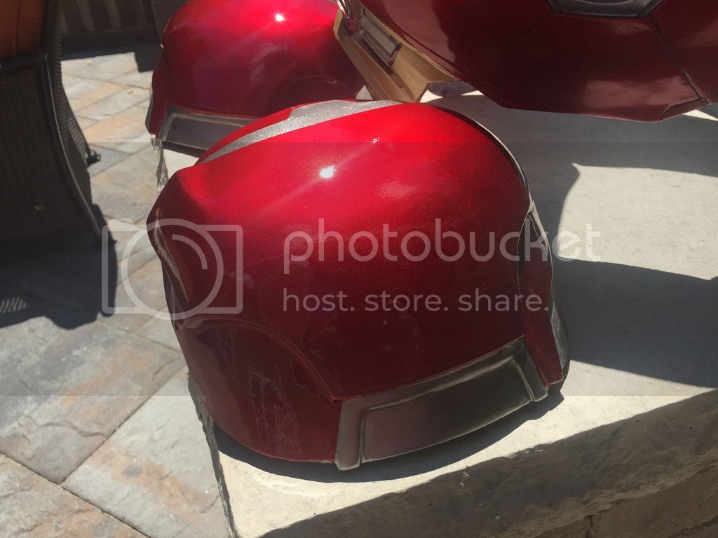

Also, going to have to make a new helmet as my previous one didn't survive he drop test down the basement stairs . :( hopefully will have one complete this week and working on a printable helmet hinge system. (Trying to replicate pictures mikesnead post).

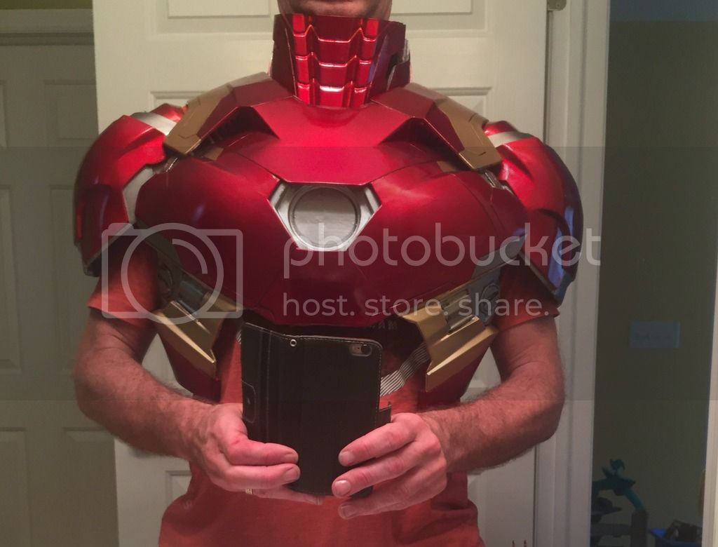

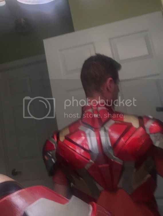

Impressive. The neck looks vicious though. Have you worn it?
Fits really good. I lined the inside with industrial Velcro felt. Makes it nice and soft on the inside.

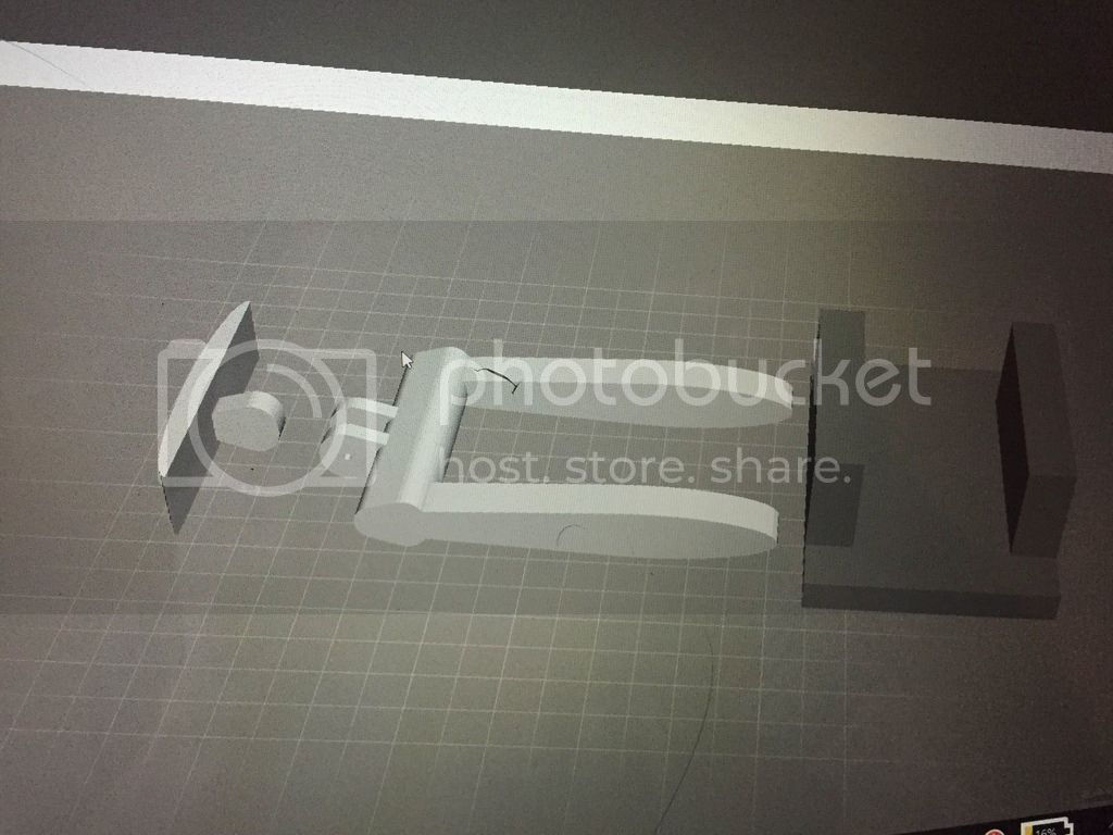

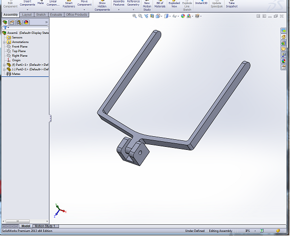

Just wanted to chime in on the hinge quickly: I have the top part done, but I don't have the servo mount done up yet. Once I get the servo mount figured out I'll post files. I have to resize the through holes in the bottom section (currently using press-fit piece of filament as a makeshift pin). I made the base so that for fit up, it can be press fit into the groove of the faceplate in the forehead (using devildog12's helmet file scaled to 95%). This allows it to roughly stay put while positioning, and should be easy to melt into place. Hopefully will have something to contribute later tonight!
TKCC71, let me know if you'd rather have me make my own post on this so I dont hijack/muck up your build post!

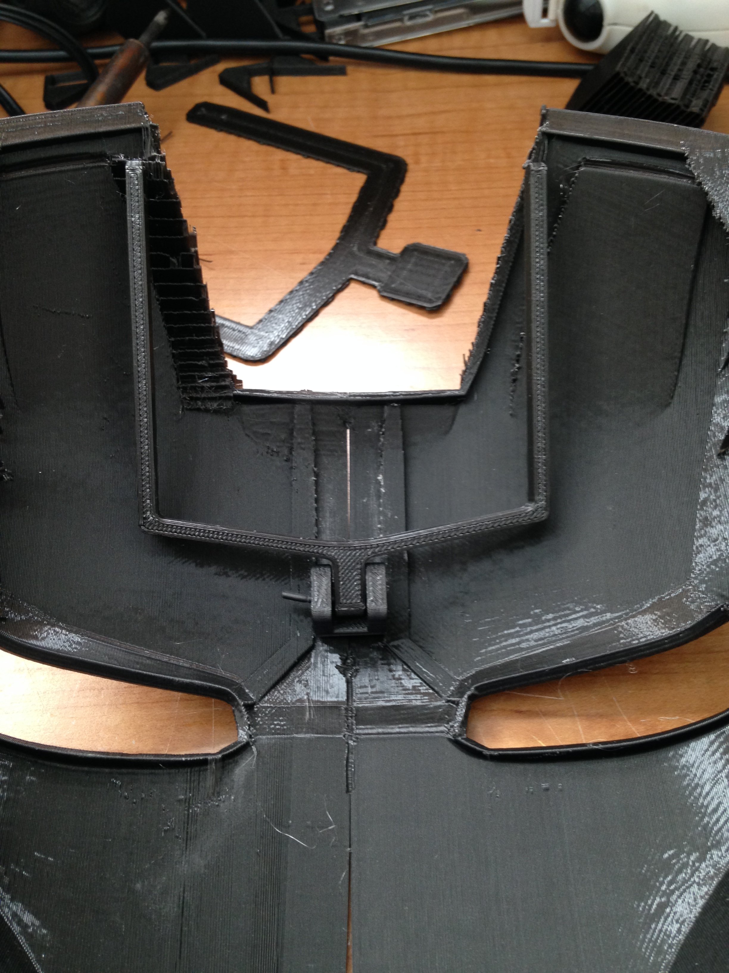

I had a mis-print face shell that I'm using as the test dummy (actual is in paint at the moment). Model of the assembly and actual photo. I'm printing a generic dual servo mount that I found on thingiverse that I will test the fit. So far it's looking a tad wide, but we will see.

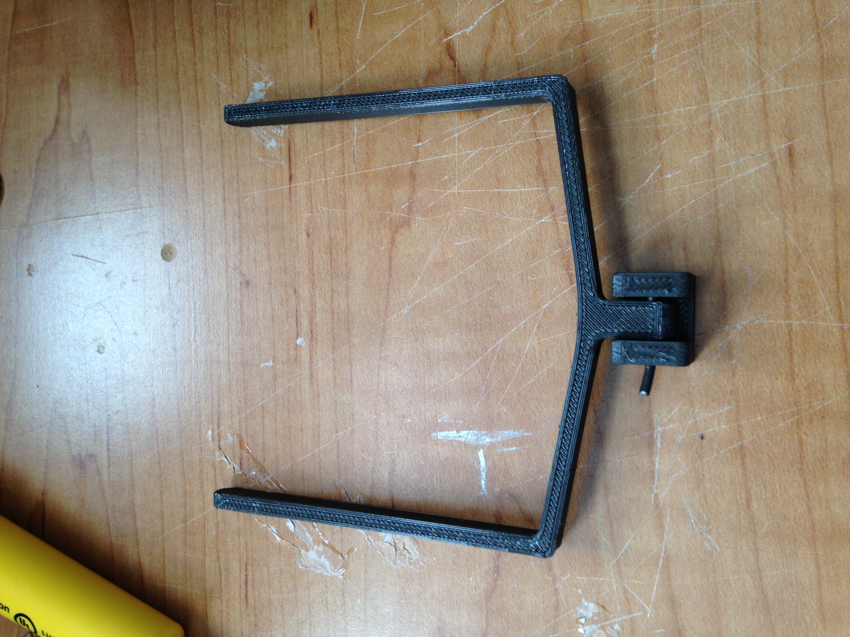

I don't mind at all. That looks really nice and I like that thin profile. I made the following but wont be able to test it out until the new helmet is done printing. I would like to print a couple options and see what works best. The servo bracket and hinge I made in the attached photo was done with a micrometer so hopefully it should be spot on. The duo helmet servos I'm using are Tower Pro SG92R's.
