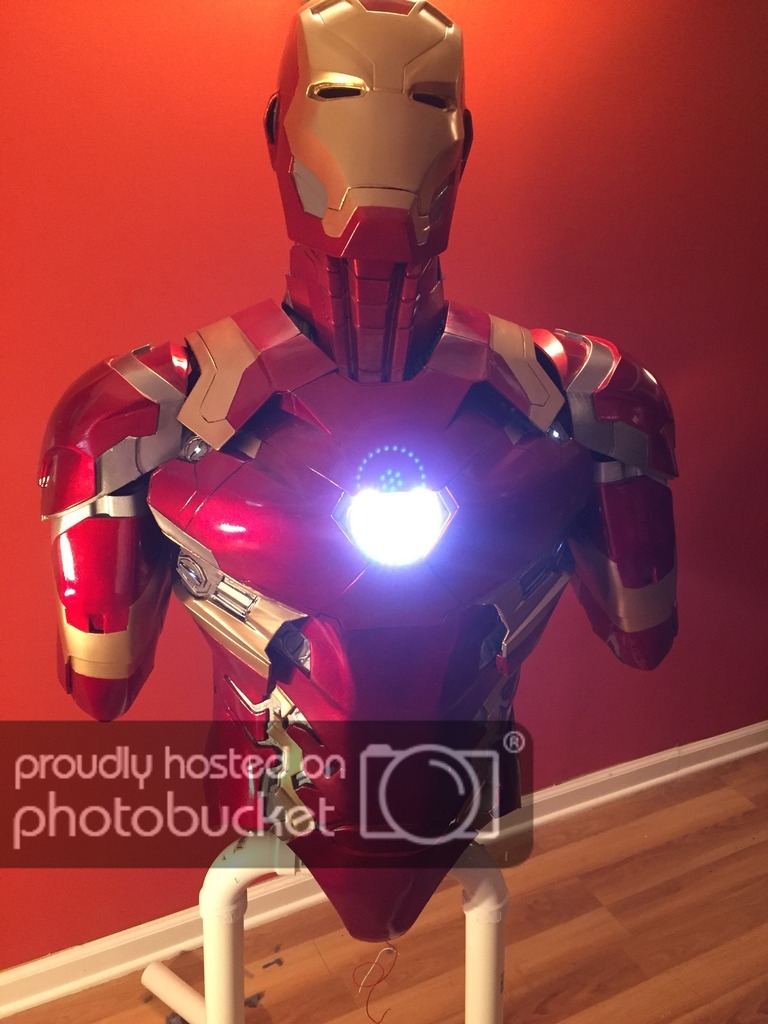

At the moment I have a few parts on the que to get painted. Unfortunately the weather has been a little too humid to paint. I also starting re-printing a few parts in PETG. No more PLA for me. This stuff is amazing. Solid as a rock.
Also my repulsor finally came in. Love it!
Here's a few photos and video for now.

Looks amazing. Your parts looks so smooth. I'm struggling somewhat to achieve the same level of finish on my own mk45 build.
I was also considering changing material after encountering softening of PLA under direct sunlight. Is there anything special you're doing to print with PETG?

I am printing the PETG at 230 and have my bed around 100. What's nice is that it seems that it prints better at fast speeds. It also sands really well. It almost has the same properties as ABS but doesn't warp.
