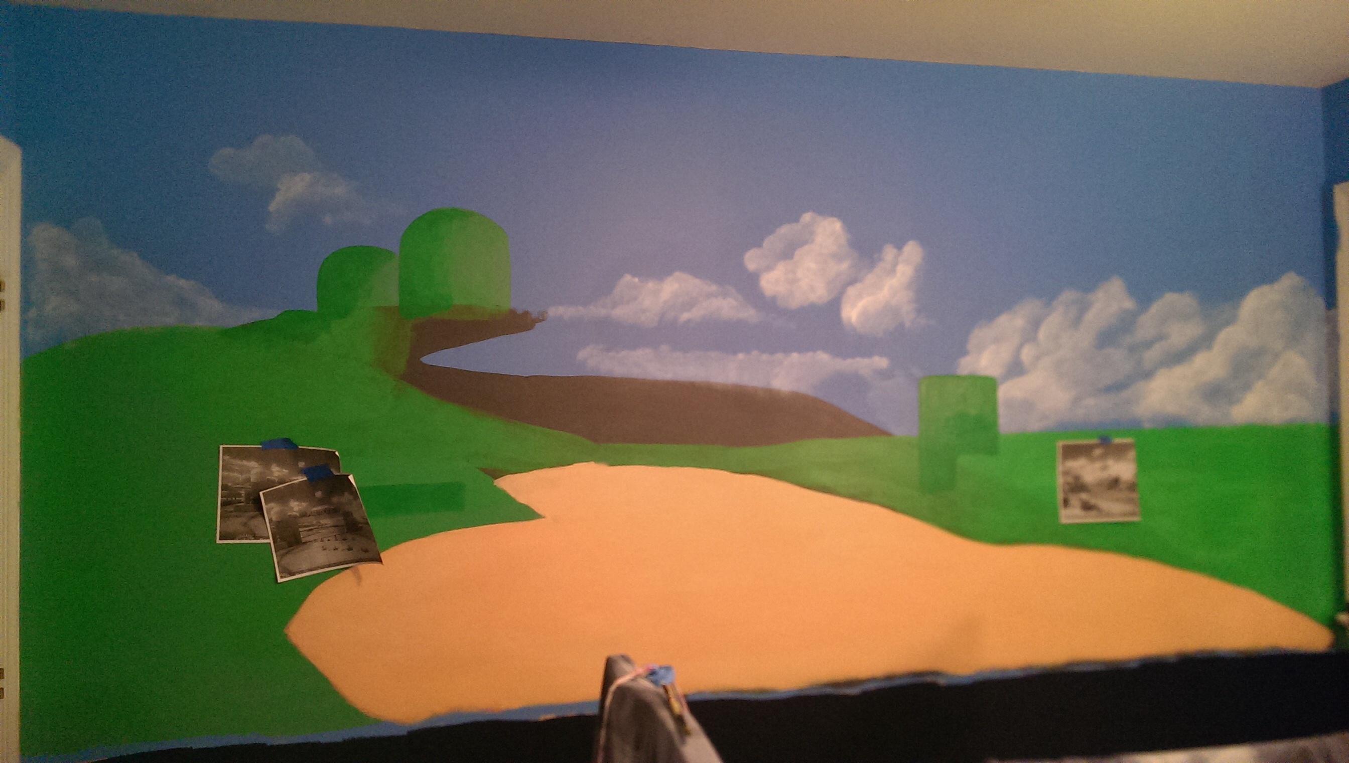

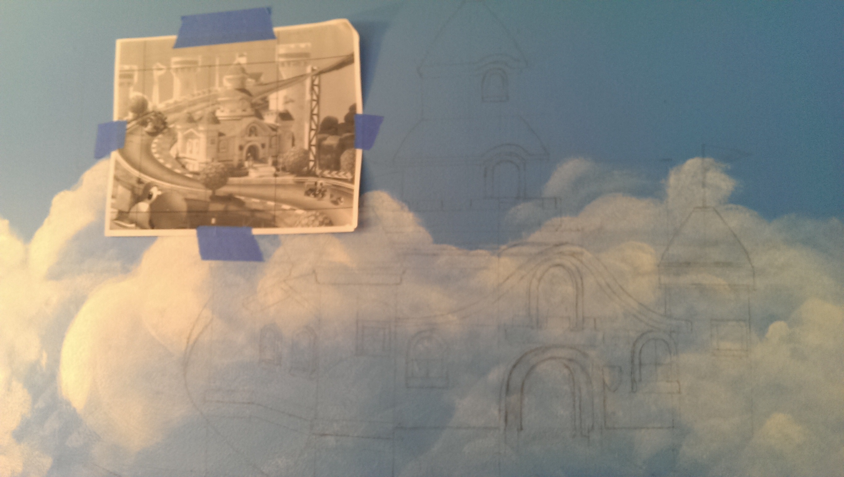

I recently began work on a baby nursery in the theme of a Mario Kart 8 for our soon to be new addition. Not only am I painting the walls as environments from the game, I plan on building a scale model of Mario and his standard Kart with hover wheels as found in the latest game. He will be attached to the ceiling, inverted, as if he is popping out of the environment into the real world.

Hey guys! Long time, no update! I am just about finished with the painting and am currently working on the Kart itself!
Here is an updated image from the mural:

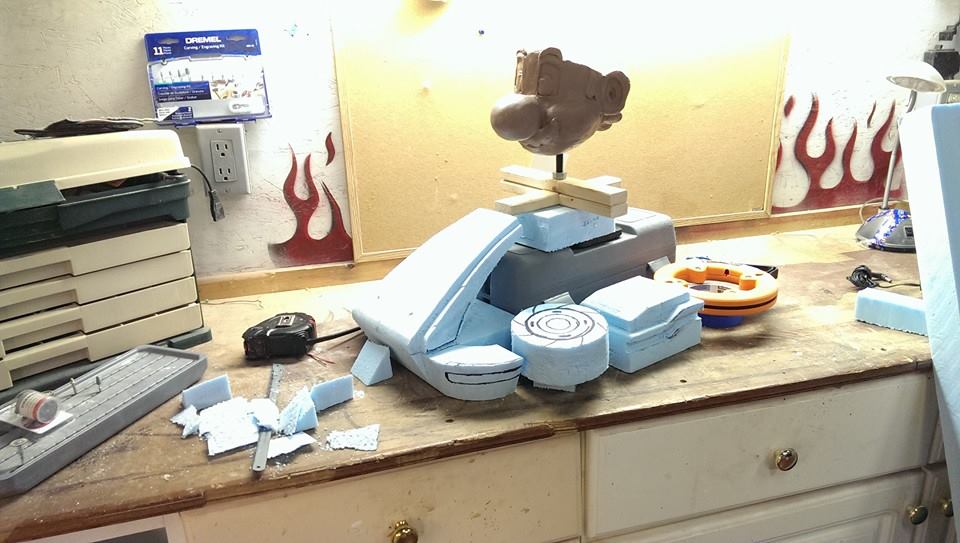

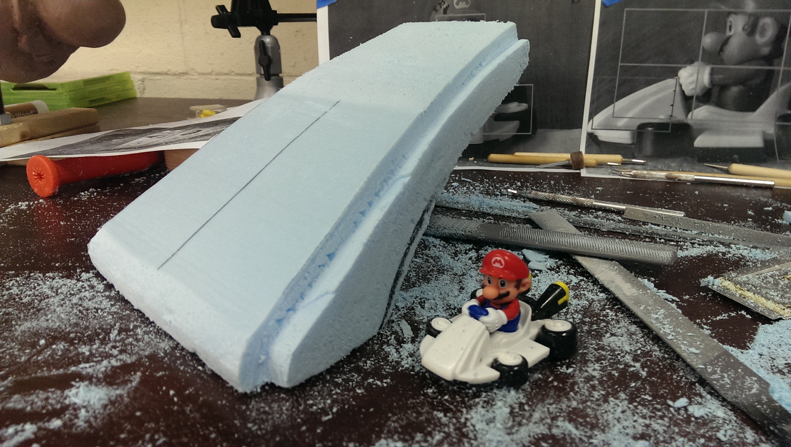

And here is the hood of the kart in it's roughed out form: (sculpted in DOW blue insulation foam)

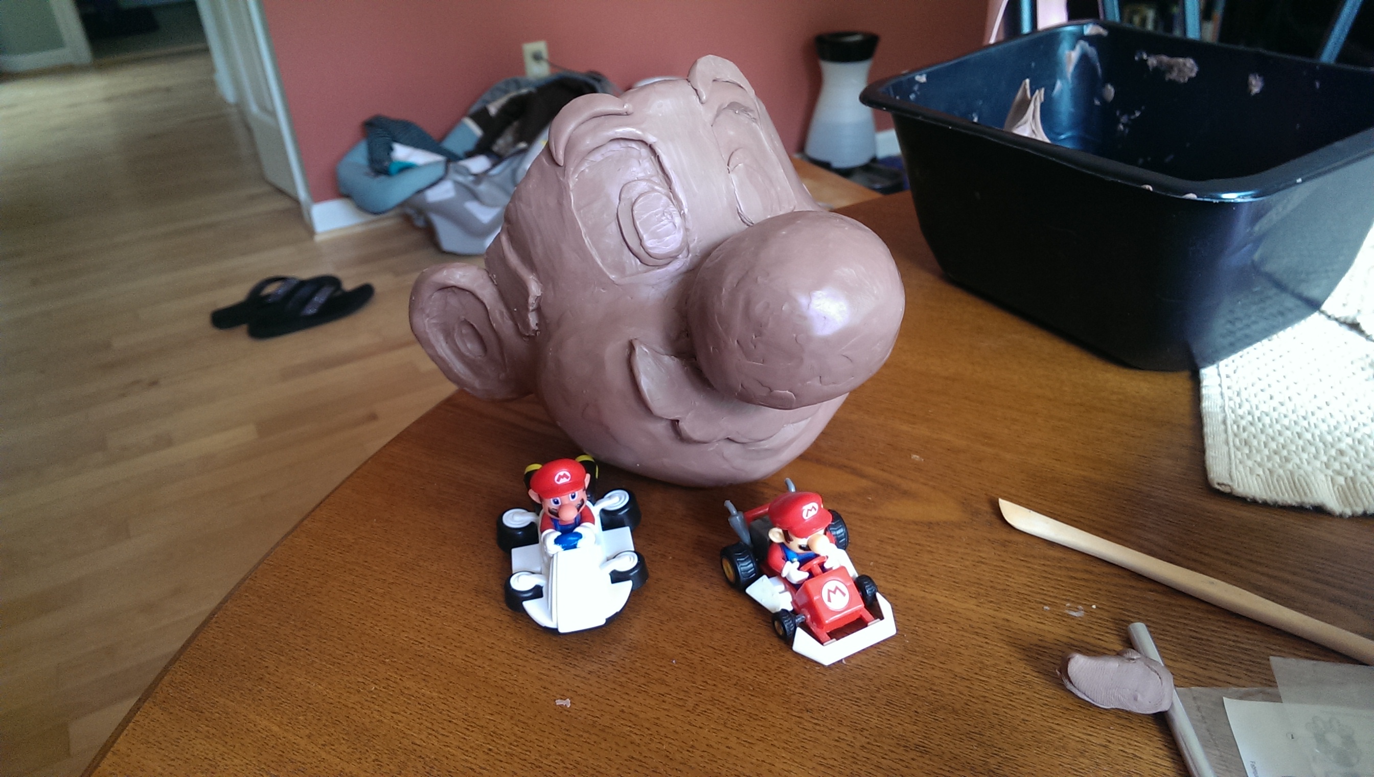

And a quick shot of a work in progress Mario ( using Monster Clay)

Anyone have any tips on modeling with this foam material? Thanks!
This nursery is amazing! I've used blue insulation foam before and there's not many tips I can share, other than use various medium-high grits of sandpaper (like 100-300 grit) for finer shaping. I would recommend coating the shaped foam with epoxy resin when the shape is finished; it's one of the few chemicals you can use to harden it without it melting. (You may have to use a thickener for the resin so it doesn't drip everywhere.)
drjag, thanks for the response! I was on the fence about using epoxy resin (such as EpoxAcoat Red from Smoothon http://www.smooth-on.com/Laminating-Epoxies/c1335_1366/index.html) or using Magic Sculpt on the surface.
I did end up buying some magic sculpt, but I would not be heartbroken if I don't end up using it if you guys think I am over-thinking things.

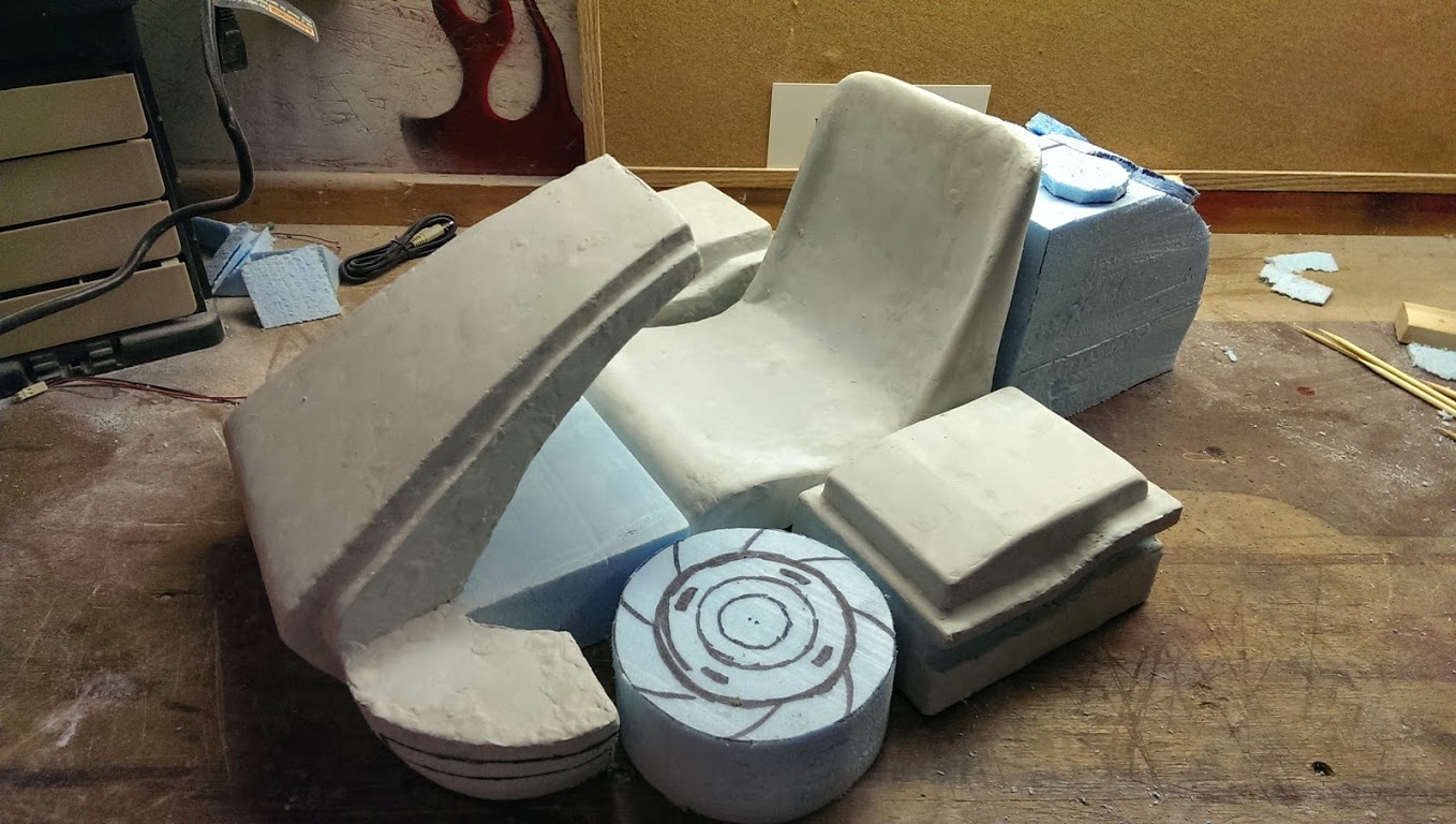

Here are another few pictures of progress:
1604971_10152722175599458_7307526720295708879_n.jpg10675715_10152722175674458_8275016981212371872_n.jpg10676295_10152722175509458_513148789113336365_n.jpg
Thanks again for your help!
looks like it's coming together well! I use Milliput (the UK equivalent of Magic Sculpt) on blue foam quite frequently, so if there are areas which you think needs sculpting on the foam, that's pretty much the best stuff you can use; it takes shape well, it sands beautifully and it's incredibly strong. I would recommend sealing the foam beforeand so the Magic Sculpt will stick better to the foam.
P.s. A simple good trick for Magic Sculpt is to manipulate it with water; sculpting is MUCH easier if water is used so have a pot of water on hand, and occasionally wet your finger and tools (if you are using sculpting tools.)

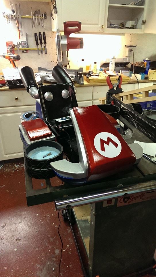

So I have gotten the hang of Apoxy Putty and have begun coating the major foam forms with it. I have quite a bit of sanding left to go, but it is getting quite smooth after a few passes.

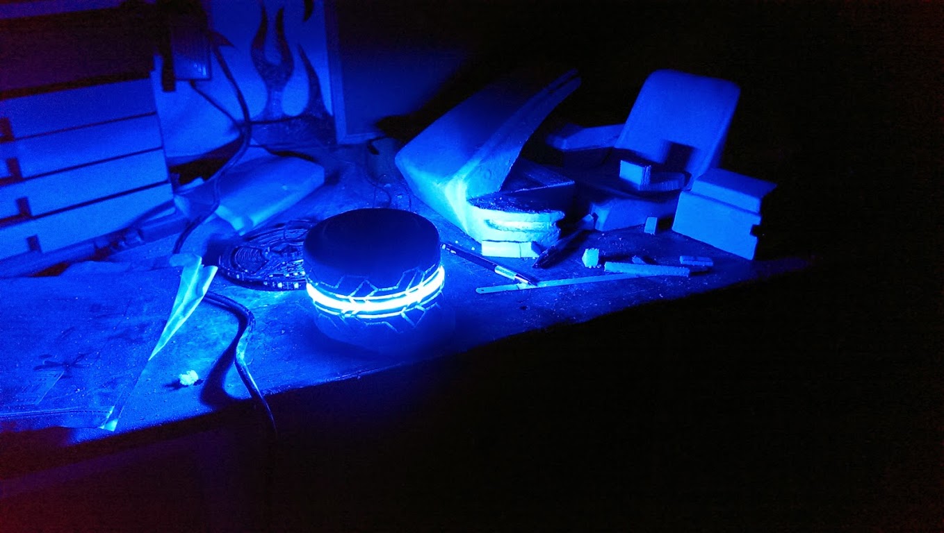

I recently got the blue led strips in and couldnt wait to test them out.
I had to hack open my newly dremel carved tread to allow for the led strip to be placed within. I plan on properly aligning the tread and obtaining some diffusing material to spread out the blue glowy goodness.
Comments or suggestions are welcomed!
