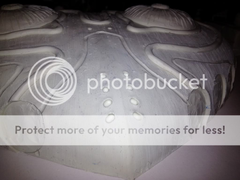

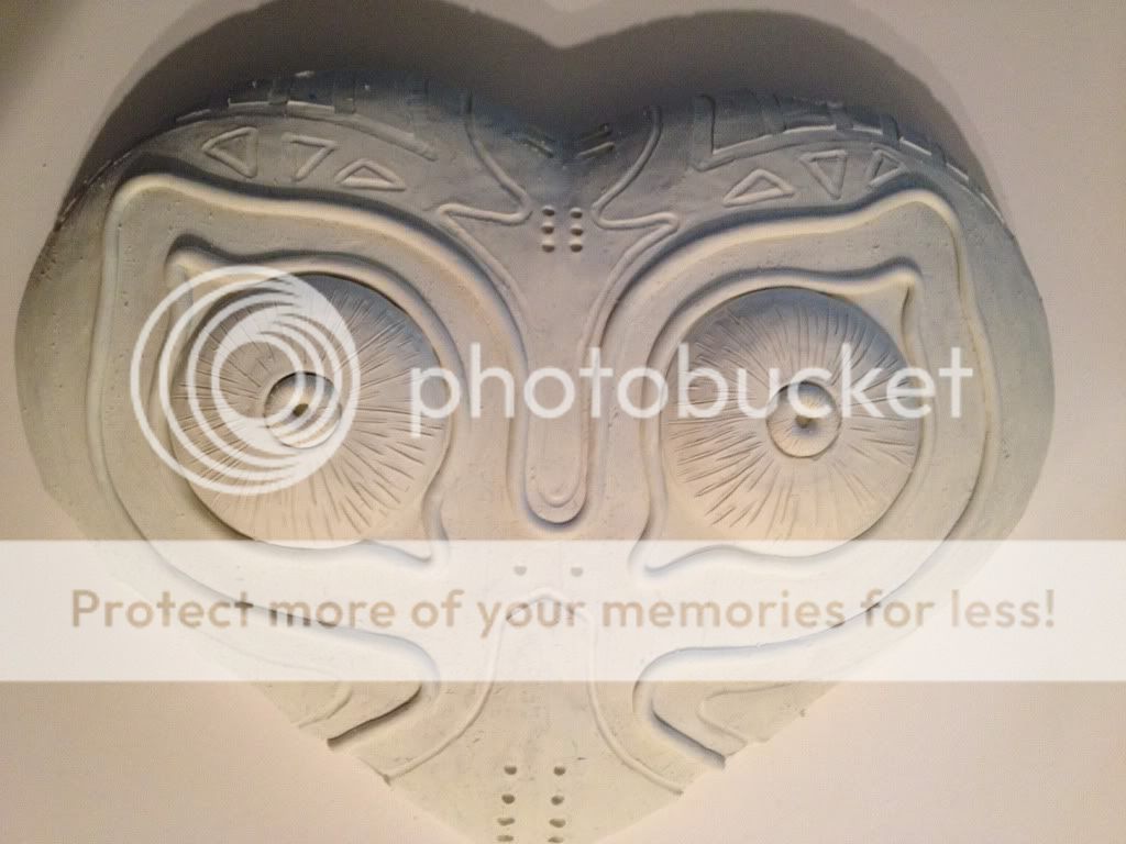

Quick update not a ton has changed but I put a wood grain on the surface and "cracks" in the eyes. I think it looks pretty good. Also when its painted I think these details will really be interesting.
Close up of the surface "wood grain"
I'm fairly happy with the results but what do you guys think? If I don't get any "omg what have you done that looks awful!?" responses I think it's time to start the mold. So I'll have to go and get those supplies soon, I hope next week.

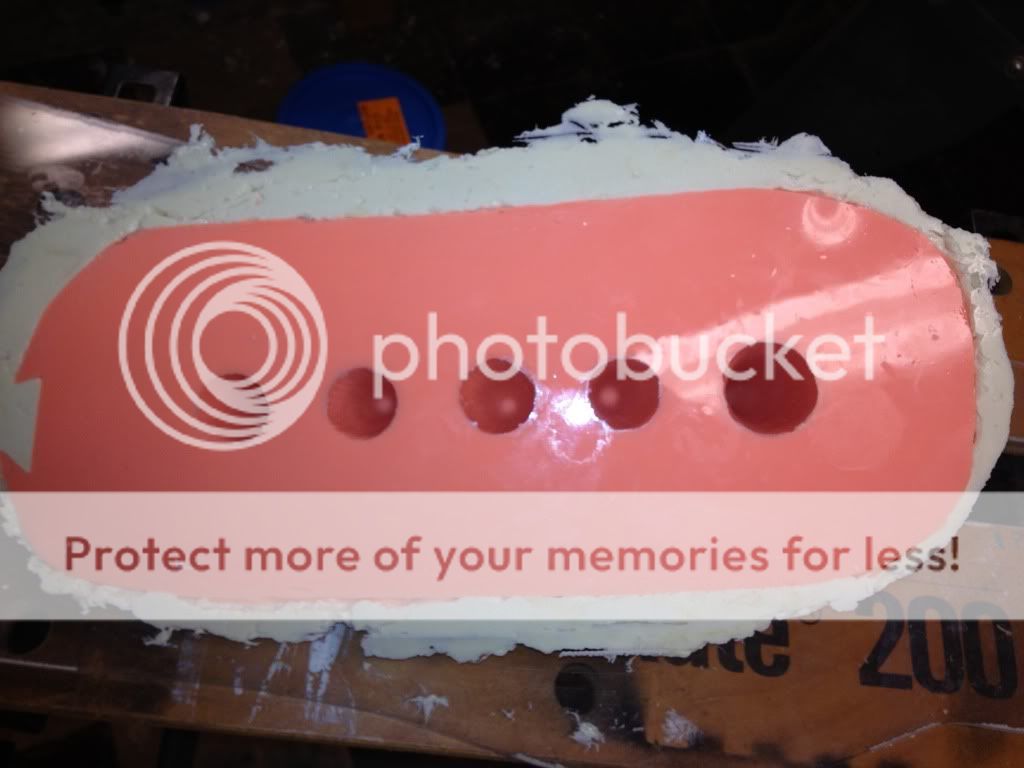

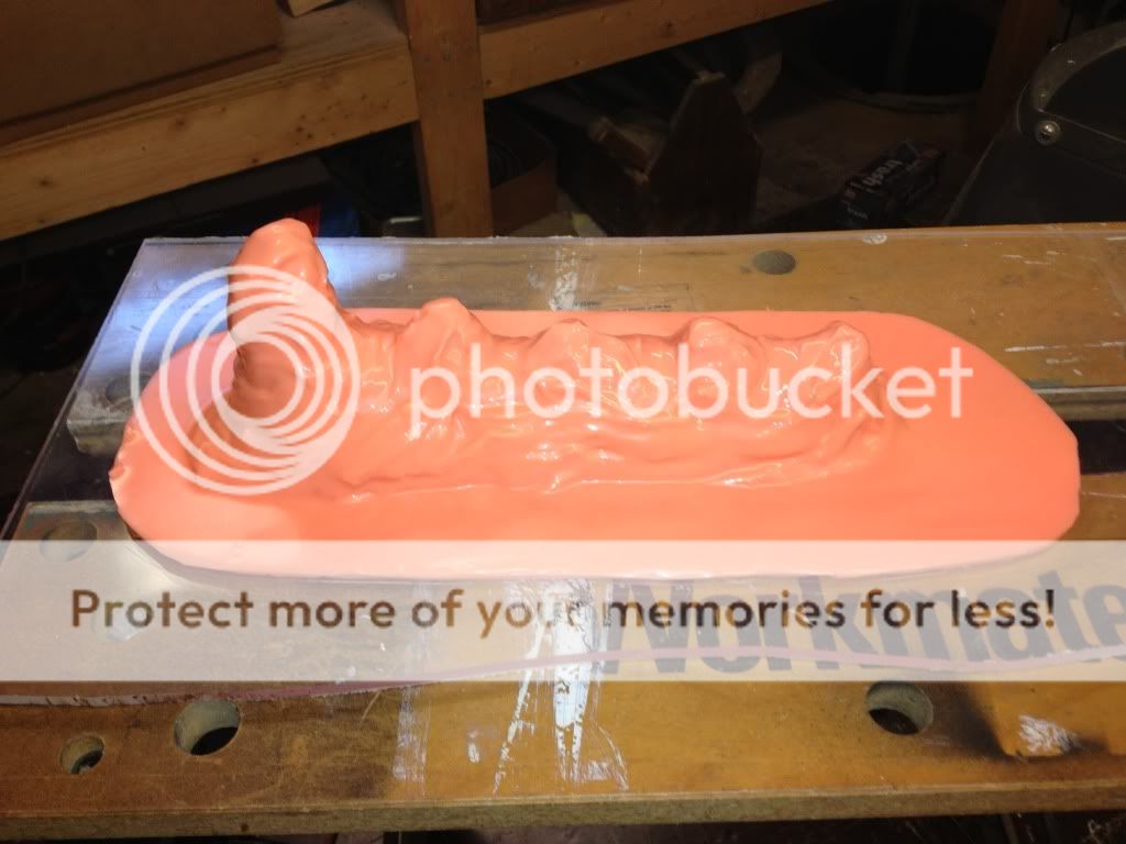

Currently I'm just waiting for the hard shell to finish curing, and I can start my first cast. Here are some of the pictures of the process.
I mussed a picture in here but I'm sure you all now the drill I built up the layers of silicone to about a cm thick and filled in all the undercuts.

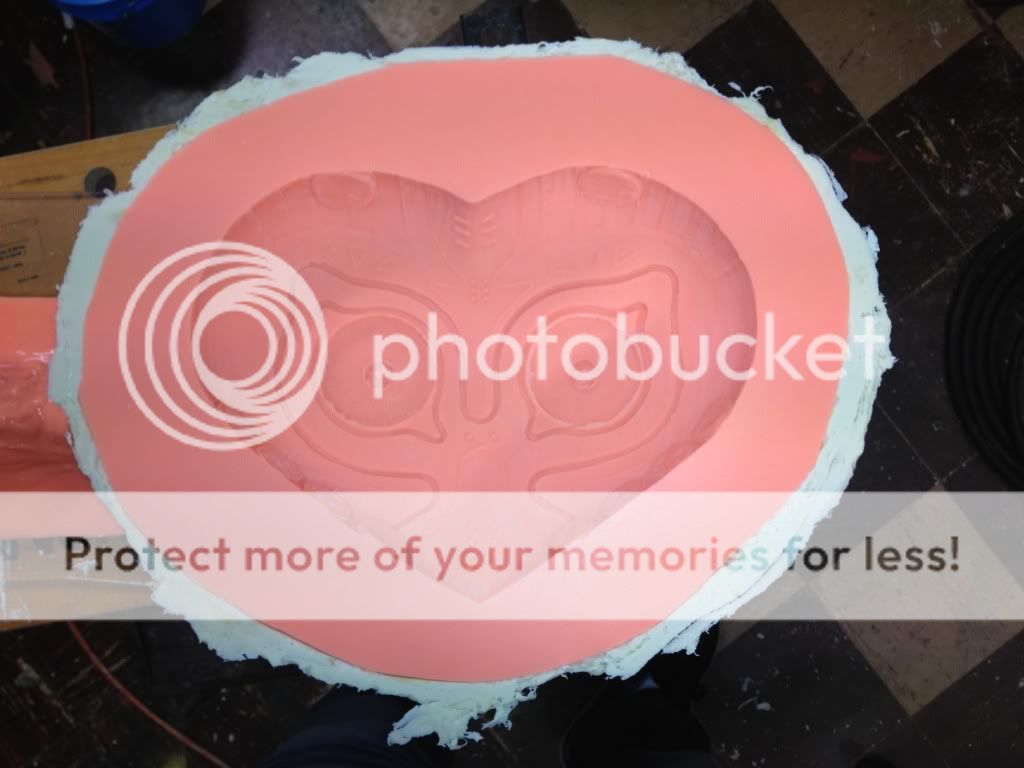

Just demolded and it looks great! this is my favorite part of the whole process. It looks like the silicone got under some of the clay parts but not too bad. Most can be cleaned up with a razor blade.
Here's that picture I missed with the last post.
Also when the hard shells cure completely tomorrow I'll clean up those edges.
