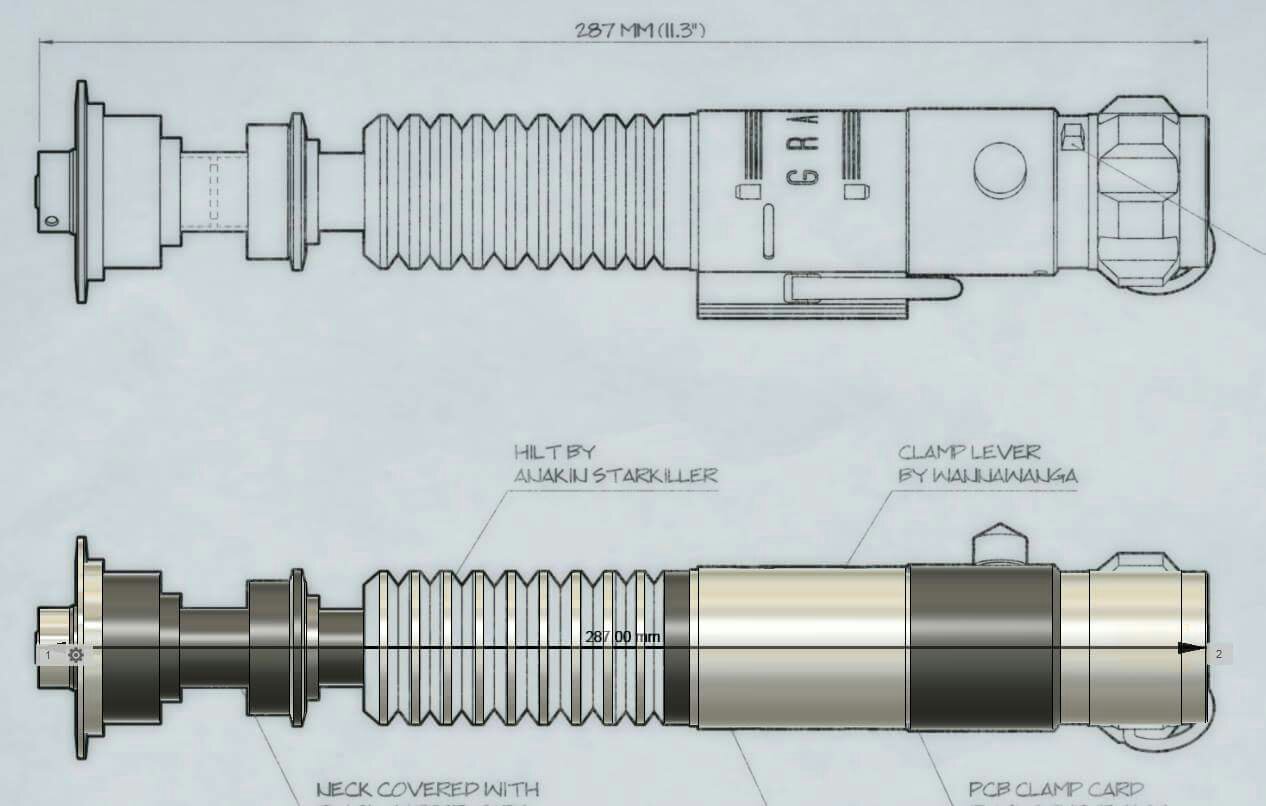

Hey guys, I originally started modelling the v1 but have since decided on going the v2 route. I've been really struggling to find accurate dimensions for the v2 (especially the grenade section).. Every blueprint I look at varies. I'll post my WIP pics thus far until anyone can shed some light.
How it began:
Then..
Then since starting on making a v2, I imported these blueprints (wannawanga's) and calibrated the blueprint to precisely 287 and scaled the saber up but as you can see some parts are off...
Any help appreciated!

I do think I should increase the lip, it's a little too thin on the flat sections.
Also, it seems like the chunks being 5mm high are too high, shown here.. maybe they are 4mm?
Then length and shape is all good, perspective is throwing it off a bit.. but they definitely seem a little tall
Sent from my SM-G935F using Tapatalk
There we go :) I think I got it, decreased the chunk heights to 4mm and increased the ring diameter that sits underneath....
Before and after shot.
BONUS I got that edge swoop in there too, if you know what I mean :D
Apart from scaling the saber up to 287 in length early on in the build, I've not been using your blueprints at all. (I couldn't anyway, all the dimensions where off :/)
I've since redone everything using a different set of a blueprints that where completely mapped out.
If I had known your blueprints weren't there for others to use I wouldn't have done so, so I apologise.
But as I said, my design is completely different :)
Whilst your here though anakin, can I pick your brain on the grenade section?..
I've been told all rings and their spacing is even compared to the shared stunt. is this true?
I currently have the grenade rings at 2mm and their spacing at 6mm I think.m
