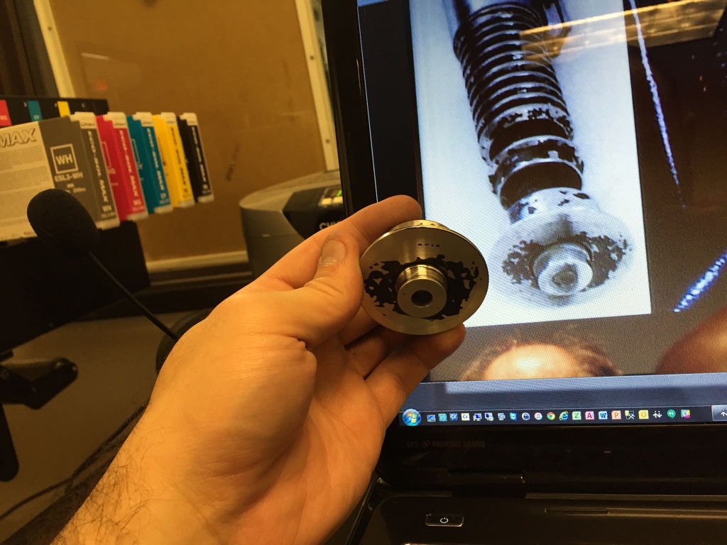

I figured I'd show off my Anakin Starkiller build and share some of my solutions for securing the rod inside the hilt as well as my "mystery chunk".
First, some photos:
http://i66.photobucket.com/albums/h...Anakin Starkiller V2/_DSC3843_zpsueqn04td.jpg
Here is my 5/16" bore shaft collar. I wanted to use this because then it holds my saber together mechanically a la a set screw.
Mystery Chunk!
http://i66.photobucket.com/albums/h...Anakin Starkiller V2/_DSC3846_zpsvfl30y4h.jpg
This is a 1/4-20 Square Head Set Screw.
Now for the saber all together!
http://i66.photobucket.com/albums/h...Anakin Starkiller V2/_DSC3844_zpseun3ddhx.jpg
http://i66.photobucket.com/albums/h...Anakin Starkiller V2/_DSC3845_zpsvrrmy8wf.jpg
http://i66.photobucket.com/albums/h...Anakin Starkiller V2/_DSC3847_zpstk8uo6hj.jpg
I painted the saber with Krylon Satin Black and then spent about 3 hours sitting at my computer, looking at photo reference with sand paper and my exacto blade. I tried to match as much of the paint job as seen in the Star Wars Celebration. It should also be noted that I put an 1" D-Ring on my saber as well, because I felt the one that came with it was a little too small.

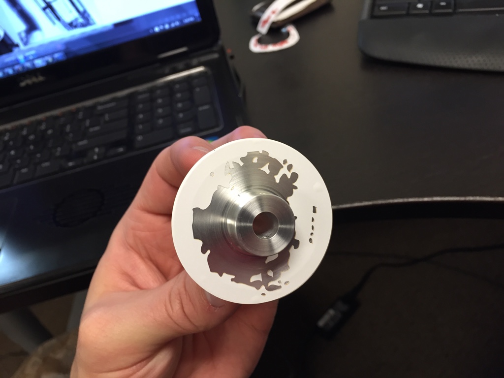

Getting itchy on those stencils... may just do it myself... great work above!
I should be posting a for sale thread for the stencils in the next few days.
