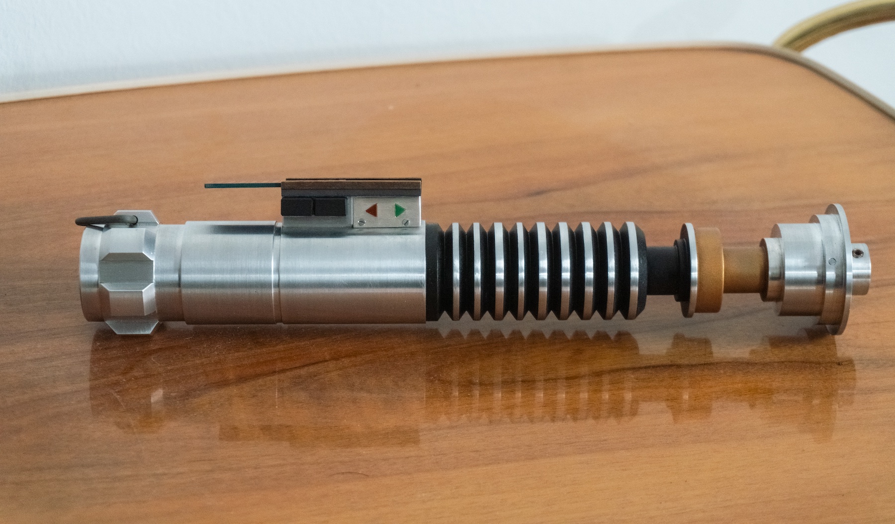

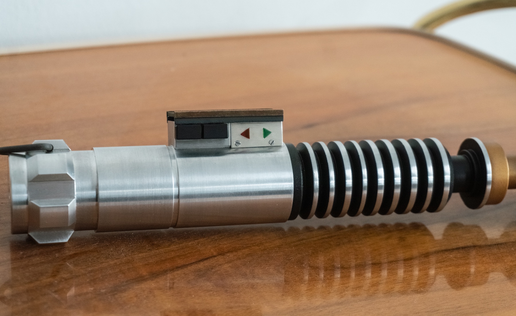

So, quite a few updates on this one! I planned on making relatively small changes, but after royally messing up my triangle plate while trying to accomodate a set of new triangles, I decided to expand my modifications.

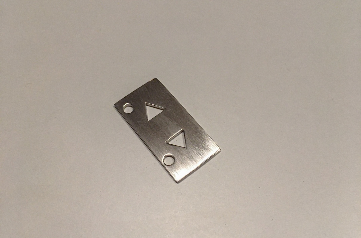

Initially planning to replace the triangle plate with whatever exisiting model I could get, I decided to take the plunge and 3D-model my own along with new t-tracks. I had some time on my hands and knew it would be a fun test!
Had both printed through Shapeways, with the triangle plate in Brushed Silver. The latter turned out a bit softer than expected, but still very nice and after a bit of extra brushing it blends in very nicely with the aluminium.

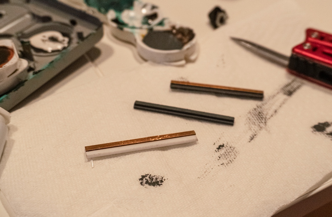

For the triangles themselves, I created small slabs of resin. After finding the right pigment, it came down to chopping them up and sanding down the cleanest pieces into the final triangles. Work in progress resin onslaught and painting of the rails:
To complete this round of modifications, I repainted and weathered parts of the grenade section to have a more accurate variation in size and also weathered the windvane to be a bit more in line with the current state of the prop -- more matte with a black wash on top.
Still a work in progress, but very happy so far!
Really happy here to have replicated the little peek at the reveal board underneath the clamp card.

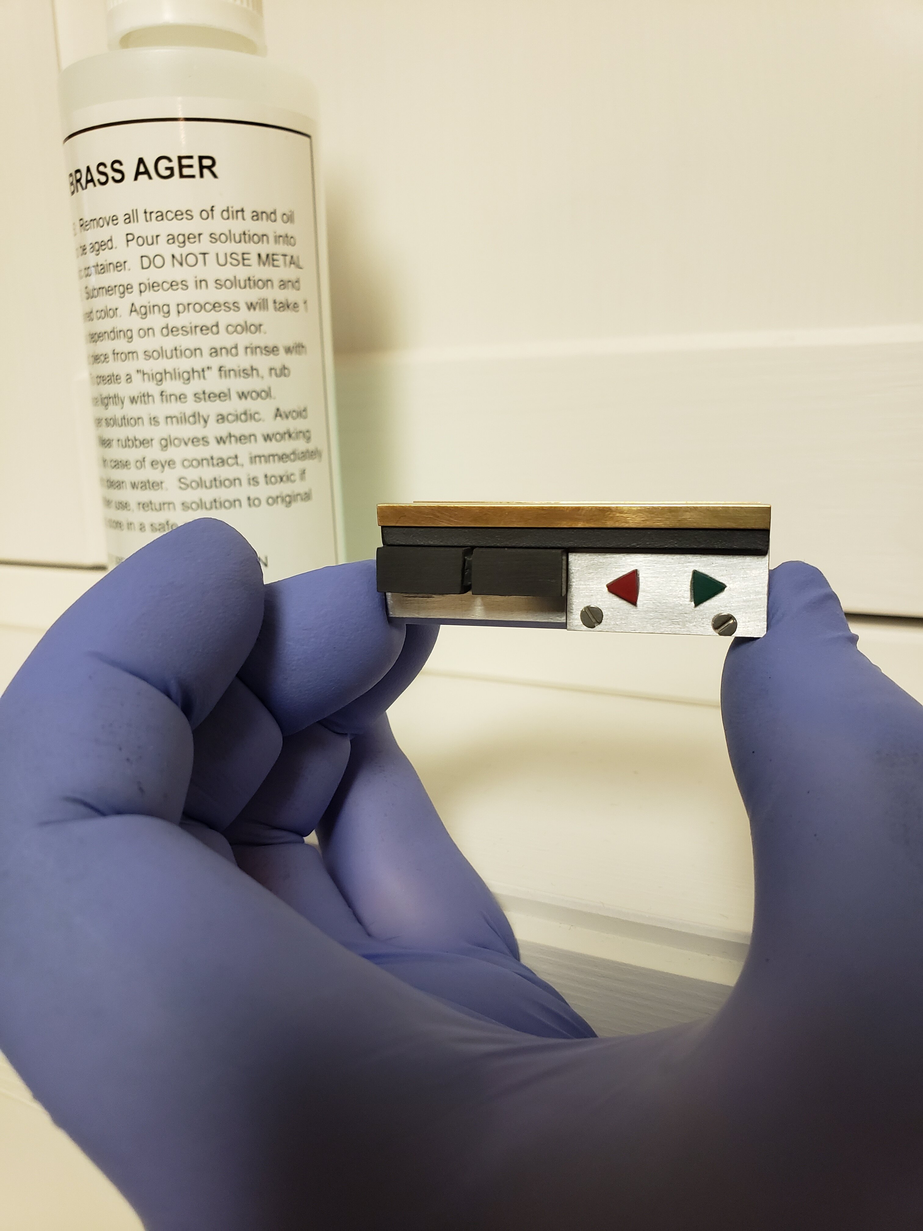

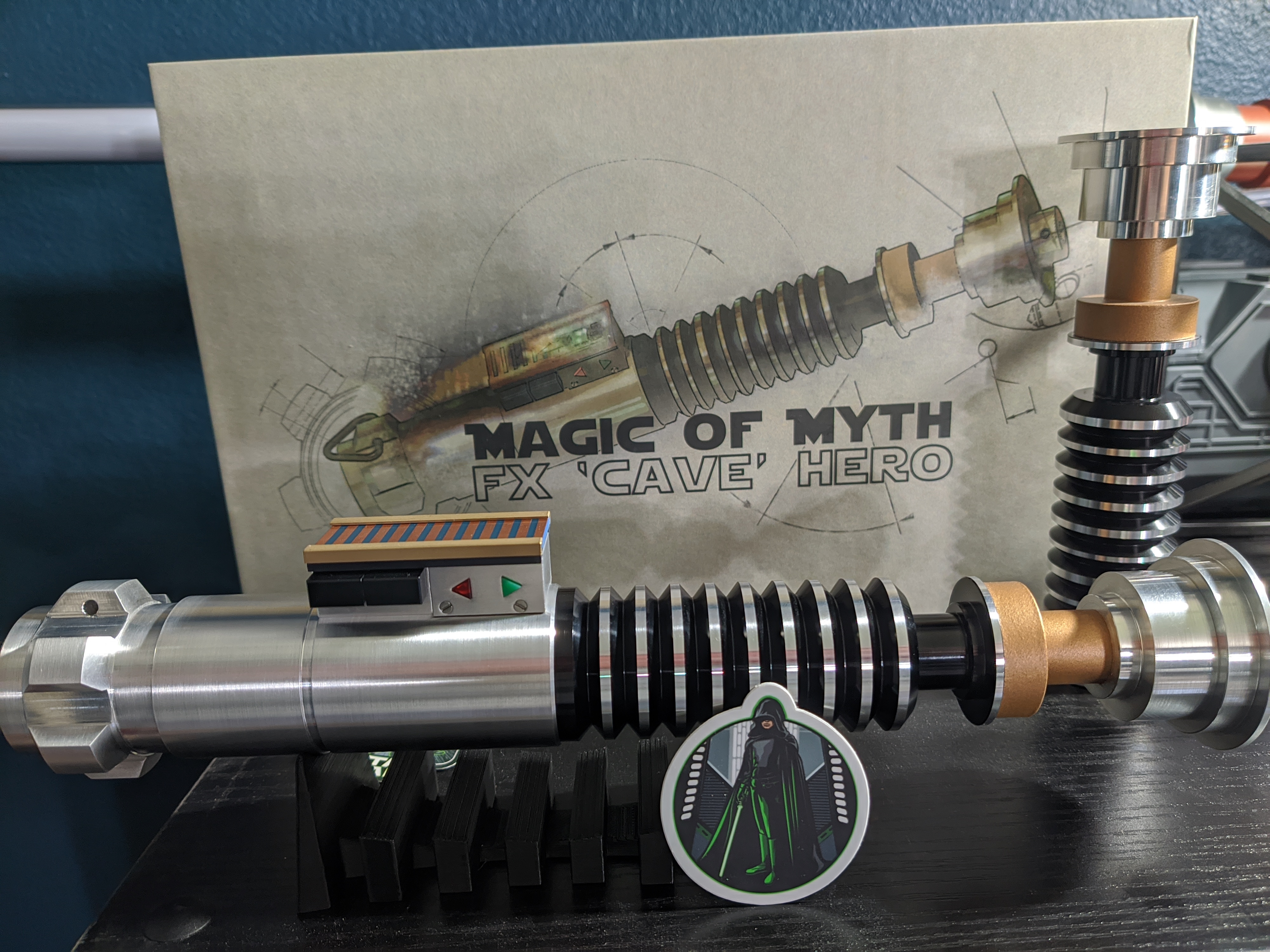

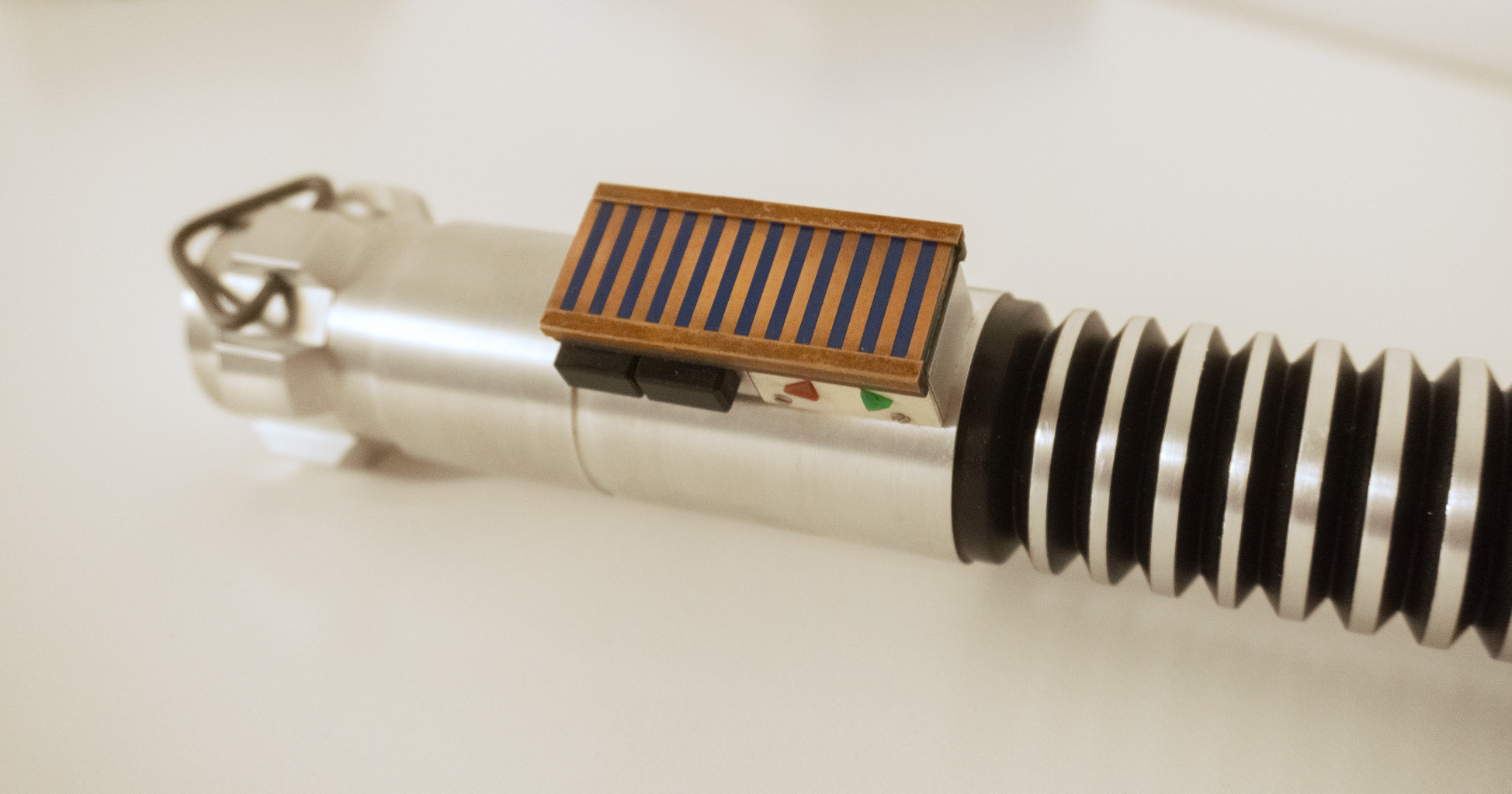

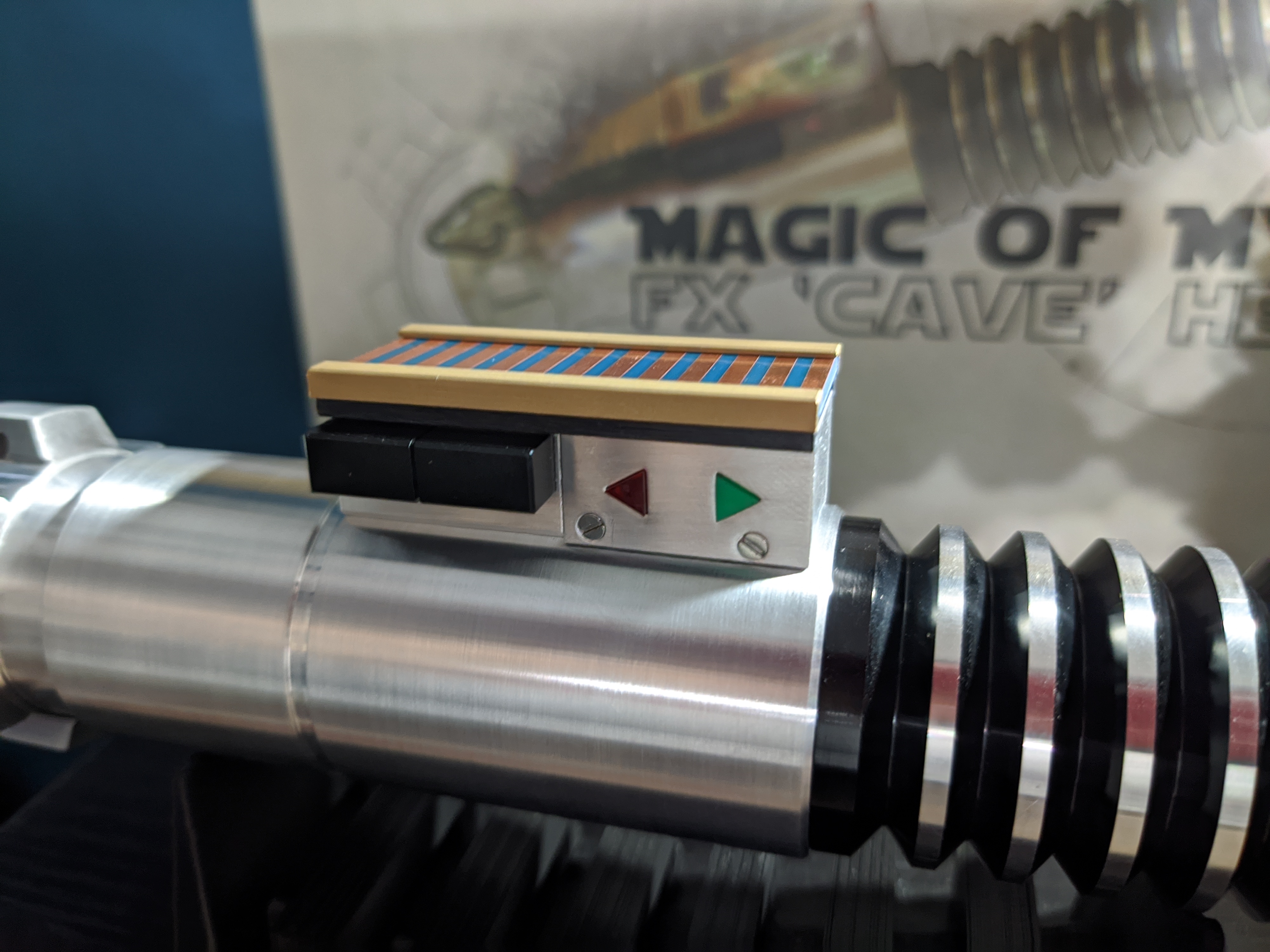

I've finally had the time to switch out the LED's in the control box with 3hz-ish versions, which yields a result much closer to the original. Battery is running slightly low though, so they could (and should) still go faster! Thanks to Poikilotherm for inspiration by sharing his versions earlier.
Besides that, managed to get some work done weathering the windvane and rails, trying to find a look somewhere in between what I imagined the orignal prop looked like and the state it is in now.

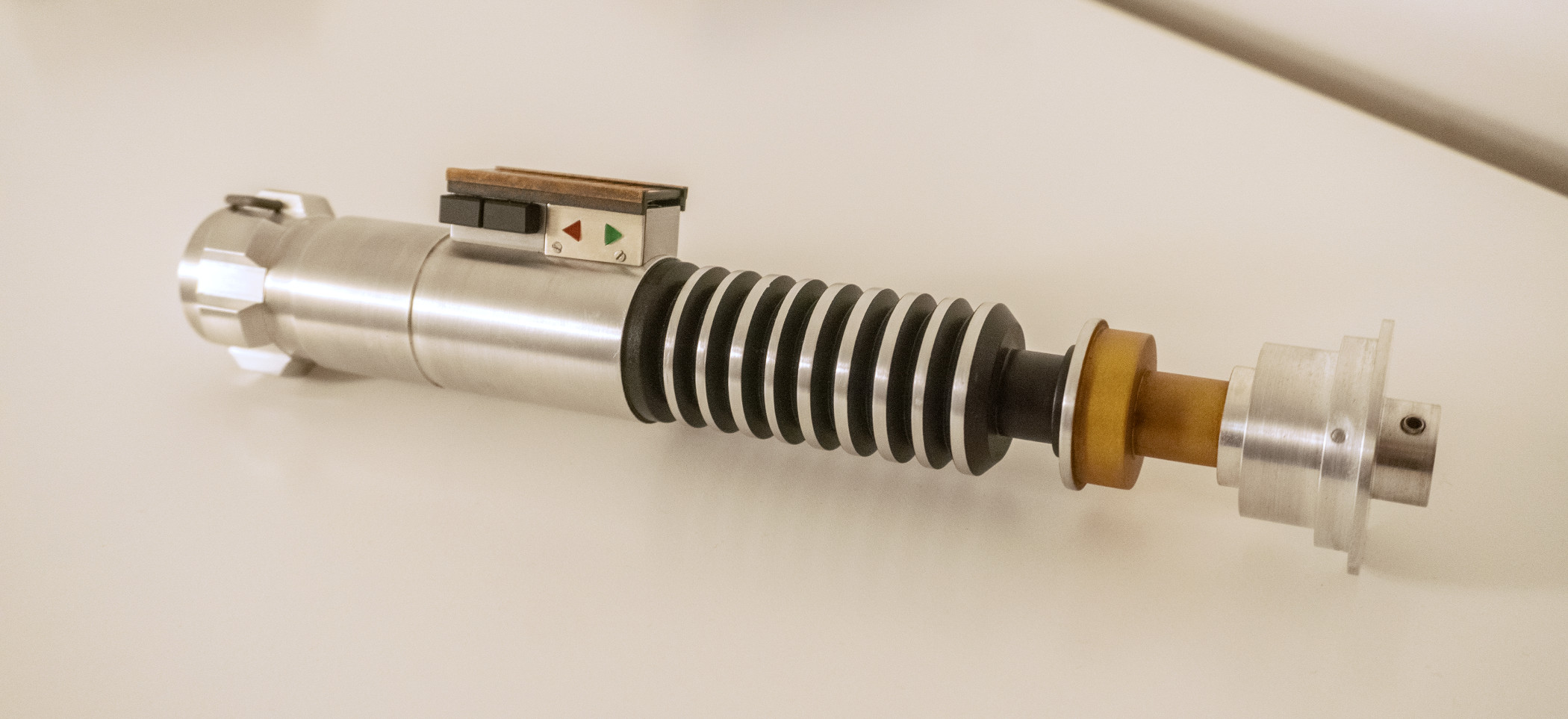

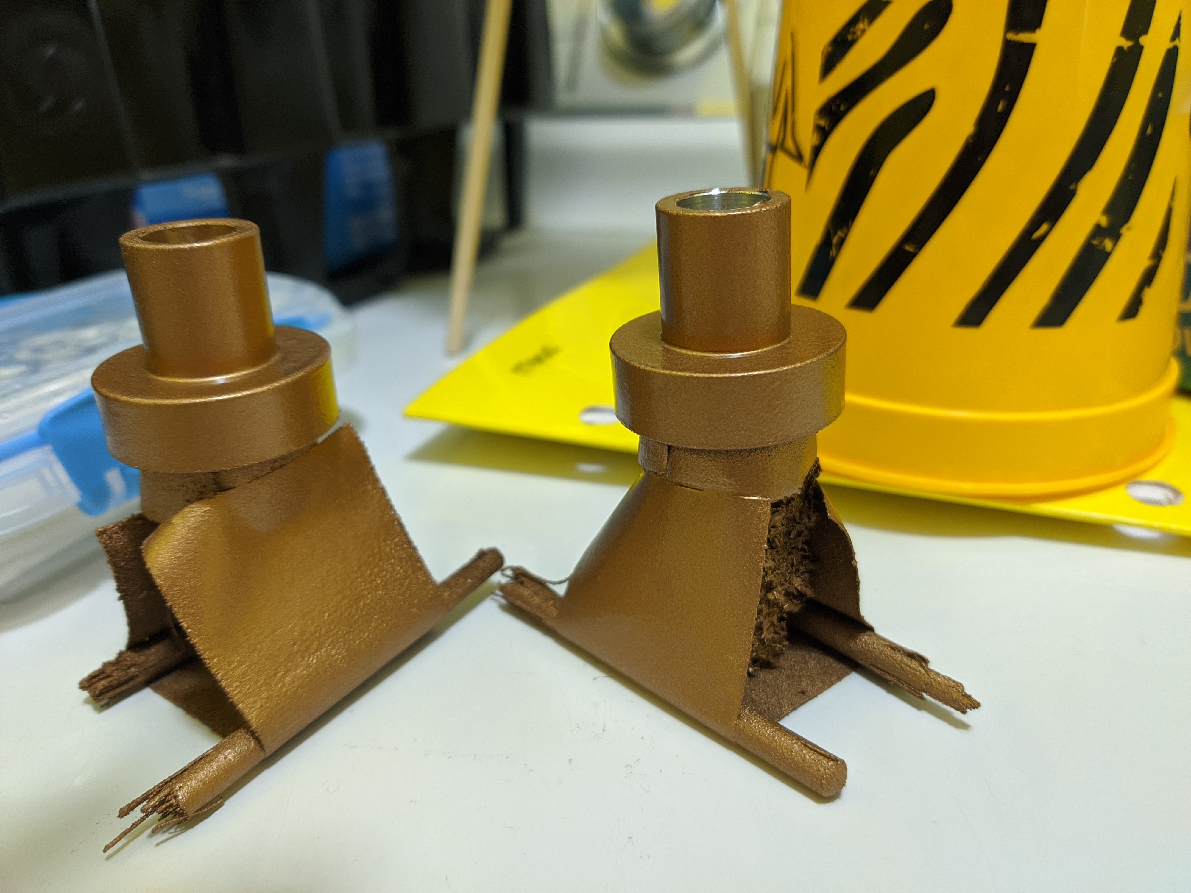

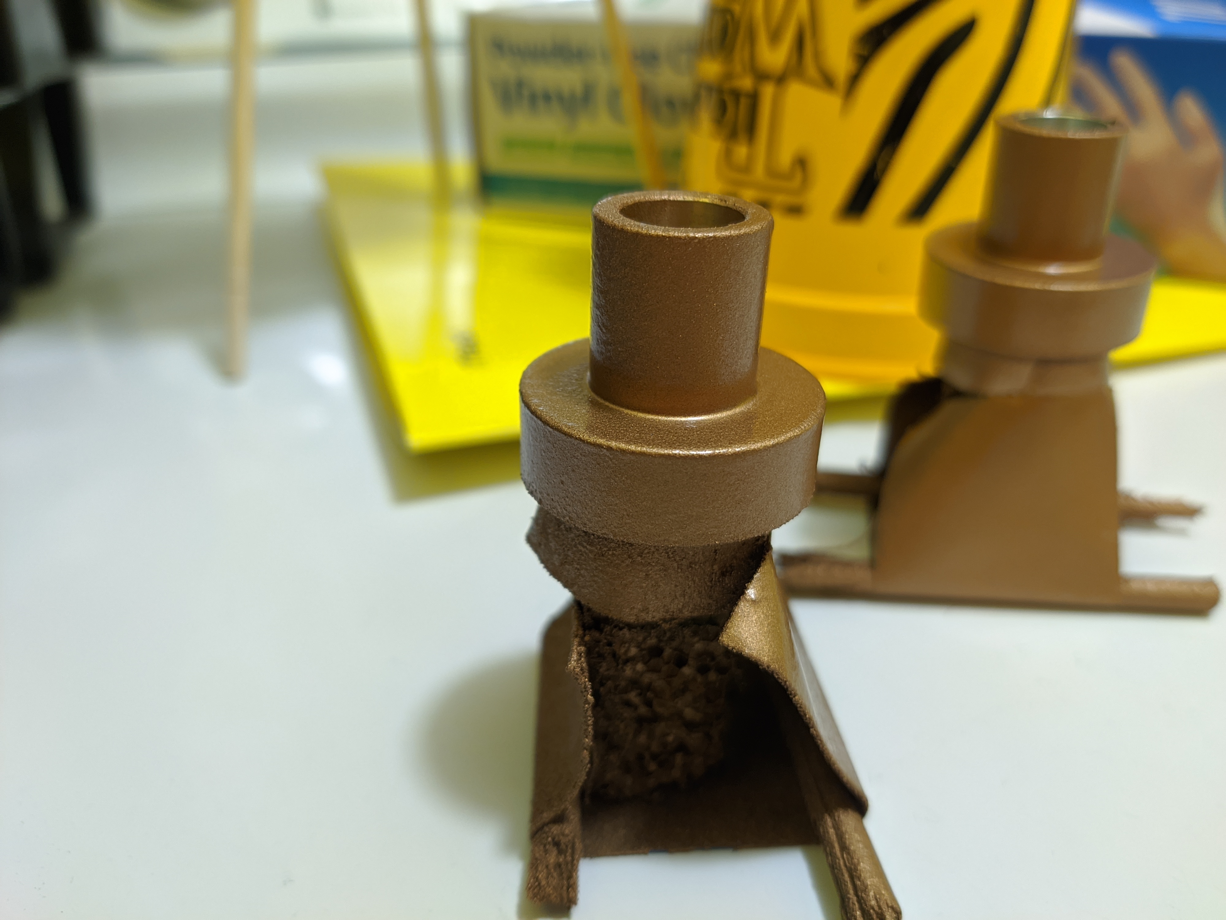

Started the spray painting today! Yesterday I used acid etch primer on the brass and aluminum windvanes. Today I used ace hardware antique gold (humbrol was a pain to get right now). Also really happy with how the control box turned out!
Great start! Are you planning on doing weathering or will you be going for a clean look?

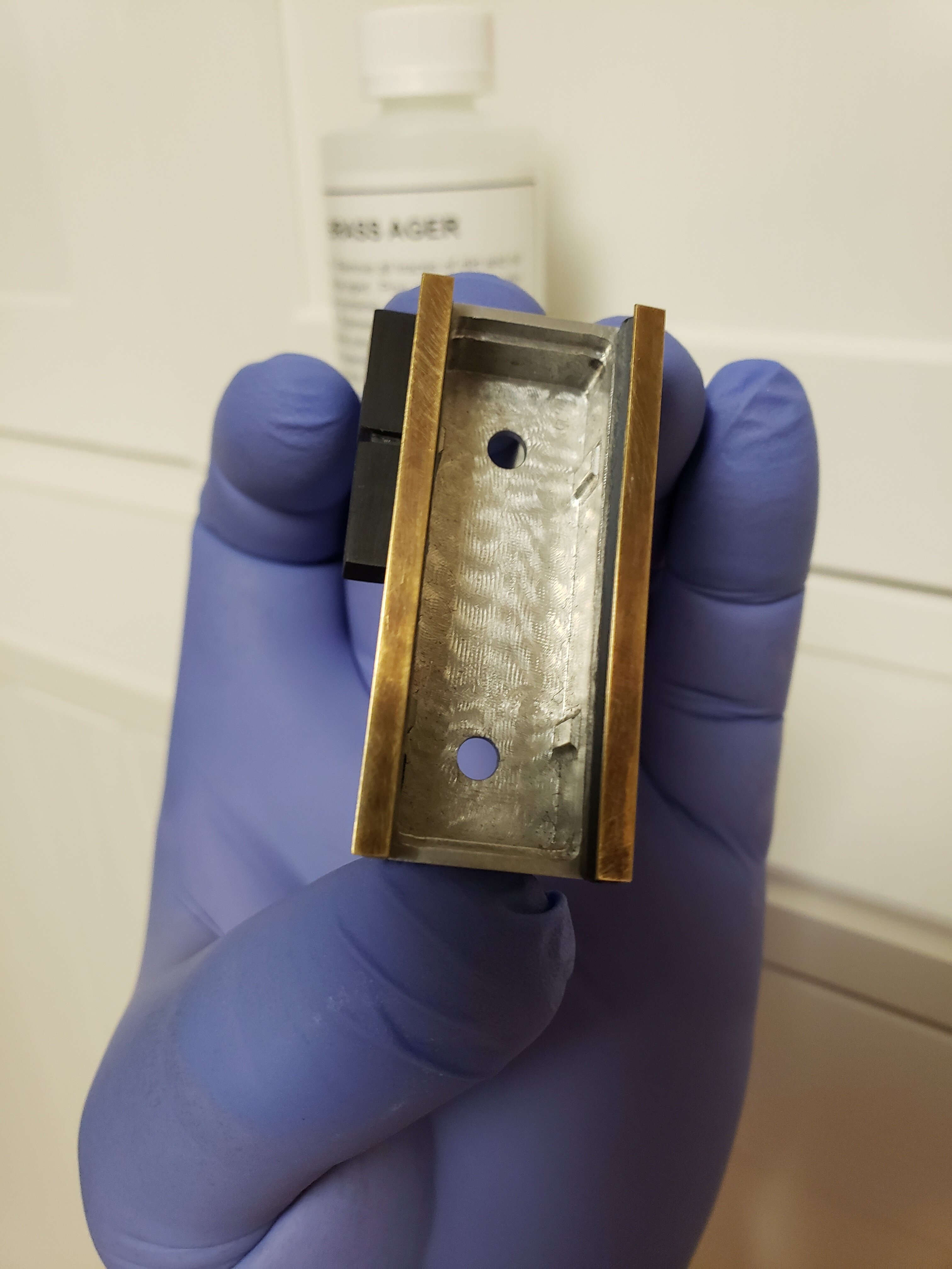

You just steel wool the brass and submerge the piece then in a matter of seconds itll darken. Pull it out fast with some tweezers and dry it off with a paper towel. If you want it darker in some areas just use a q-tip and wipe it on the areas needed.
6$ i think on Amazon
