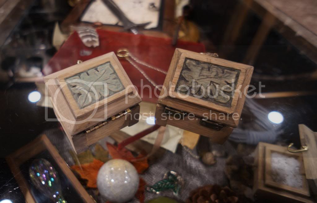

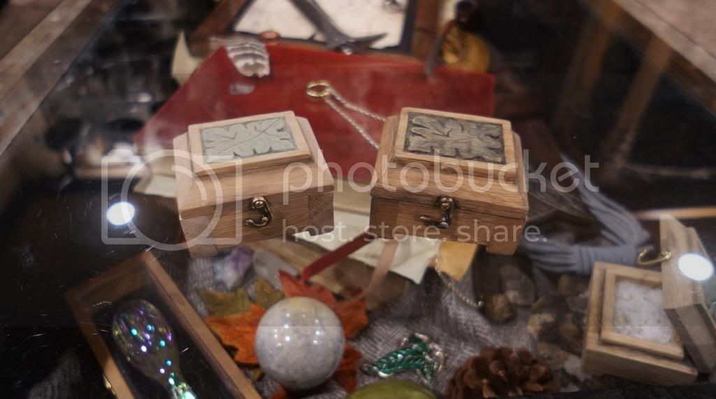

LOTR - TTT Sam's Shire salt box
Can we have some measurements? And if you can a pic of the bottom?'
many thanks and very good job

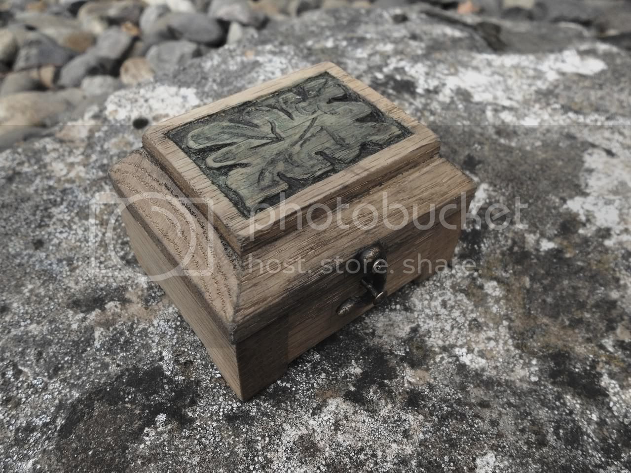

Here are some measurements. The top is made of oak 3/4 material and the sides and front/back are made of 1/2 material. I used a piece of 1/8 plywood for the bottom.
Hope it helps and good luck with anyone else building one. I'd do a run, but it isn't the easiest thing to make.
Thanks Stivie, those pics and measurements help alot. Did you do the lid design from screen caps? It looks spot on :)

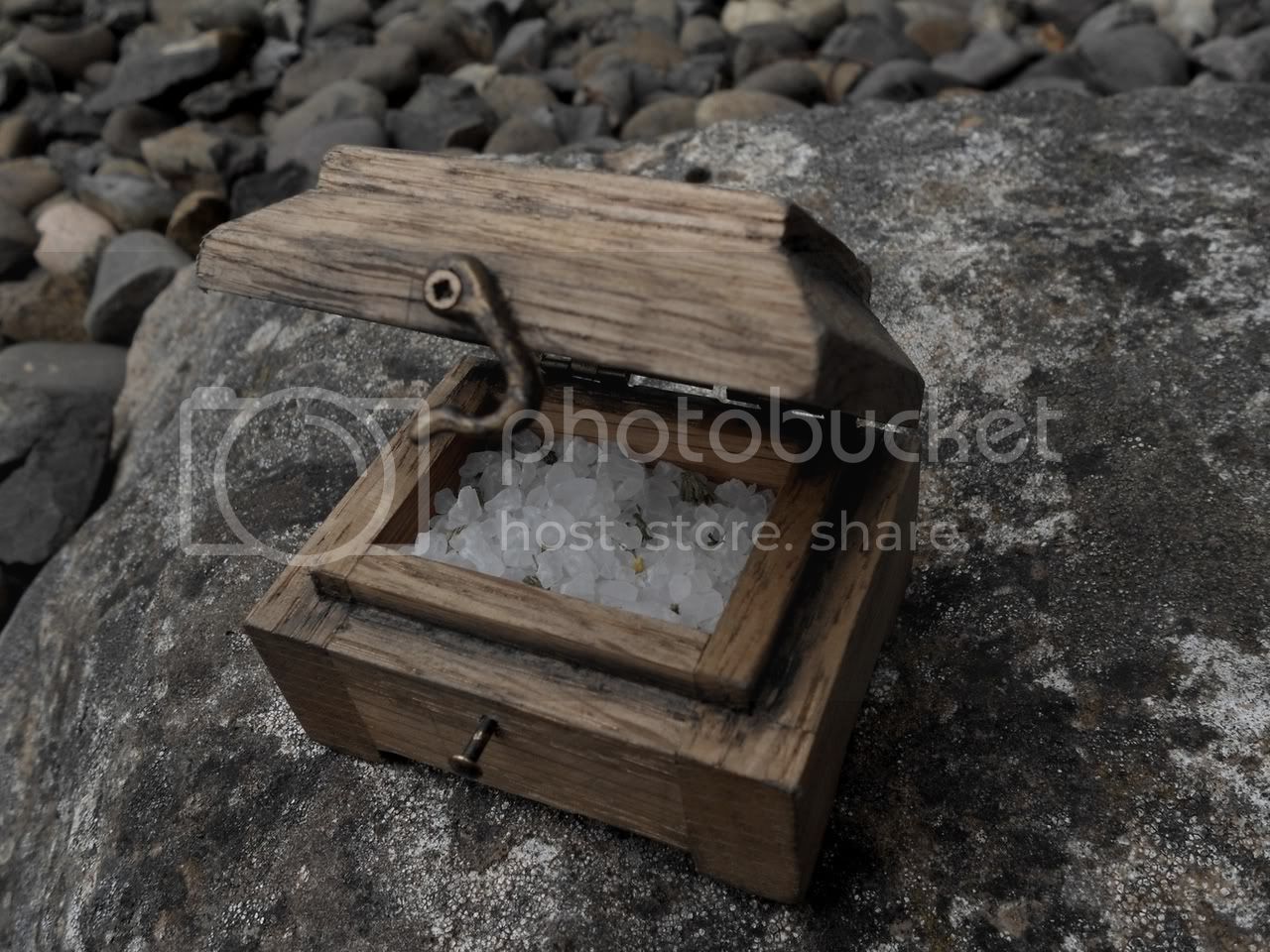

Thanks guys! I'm still looking for more screen accurate salt. I think I'm going to have to find some type of flake salt.
The 'salt' in the movie shot looks like broken grains of white rice mixed with a little dirt to me.
You can go with sea salt. It's what I use in my salt shotgun rounds. Has an interesting shape and is less huge than rock salt.

So many! Do you sell them? Also, what are the dimensions (hight, width, and lenght)? Thanks!

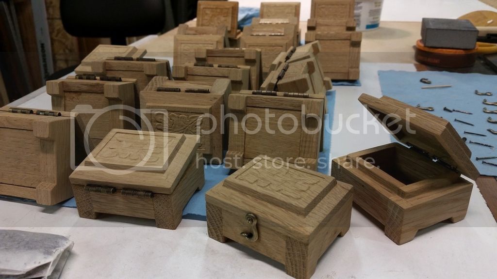

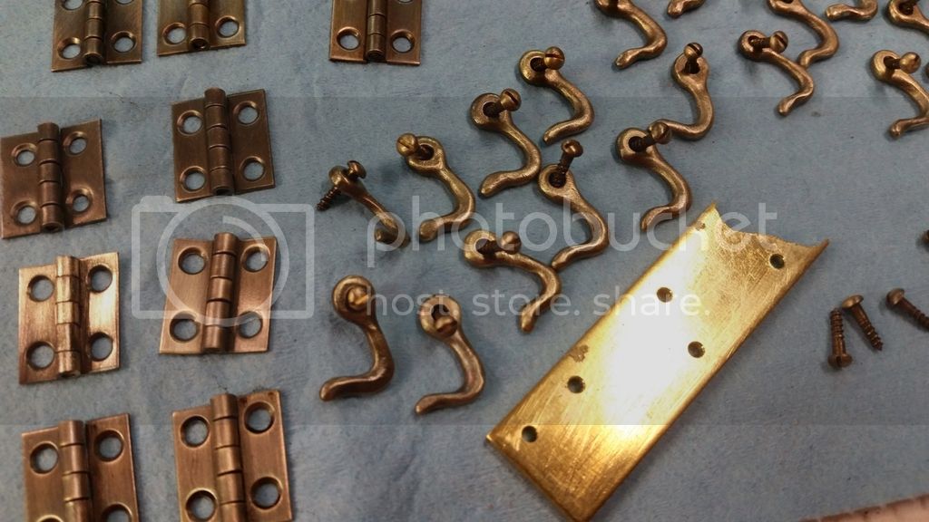

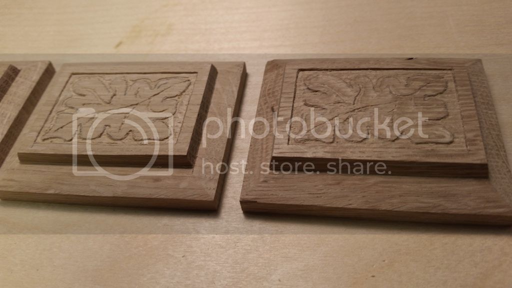

I have sold them in the past, but the time and effort I put into these are not worth the profit made on these. The latch is hand made, the hinges are modified, lid hand carved. I did a run of 20 or so a year ago and not looking to do more anytime soon sorry. Here is a few photos with sizes. My version 3 is slightly smaller.

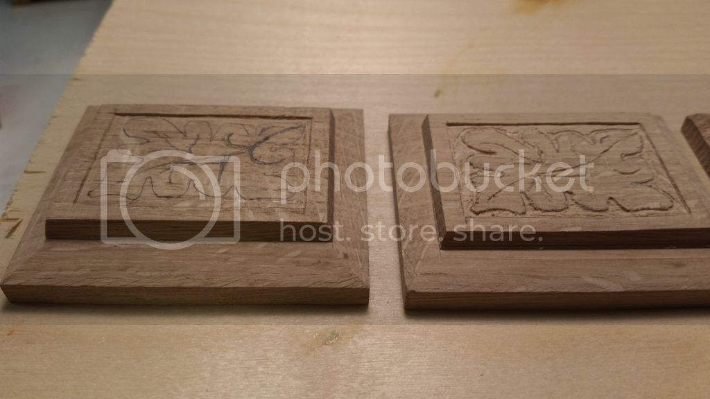

and some of the building process
Thank you! Do you possibly have a drawing of the pattern on the top, or could you maybe post a photo/scan of the top design straight on? I'm trying to make my own and was hoping maybe you have a pattern, or a picture I could make a pattern from. Also are those 1/2 inch boards that it's made from? Thanks.
