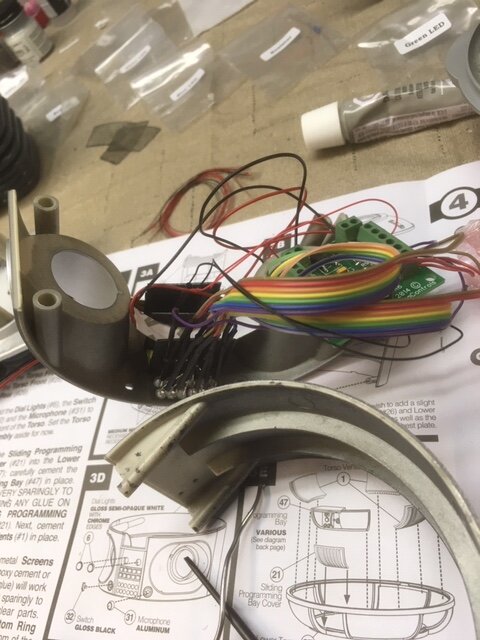

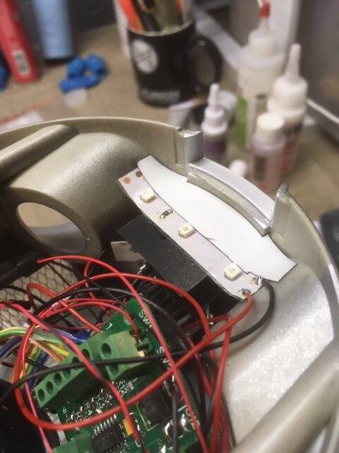

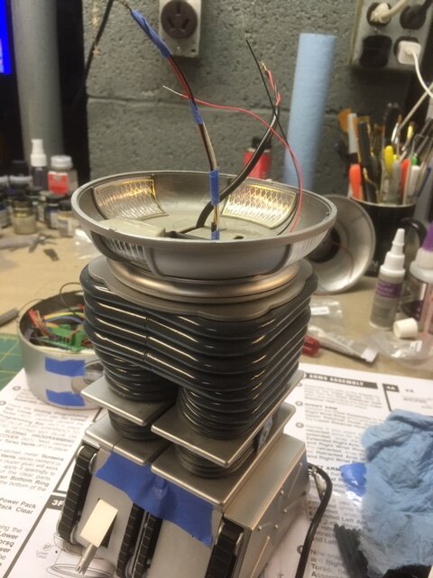

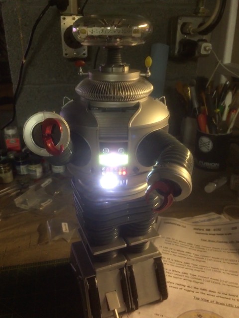

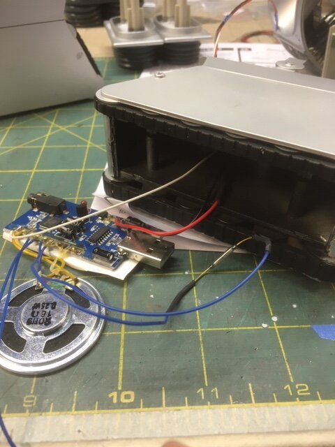

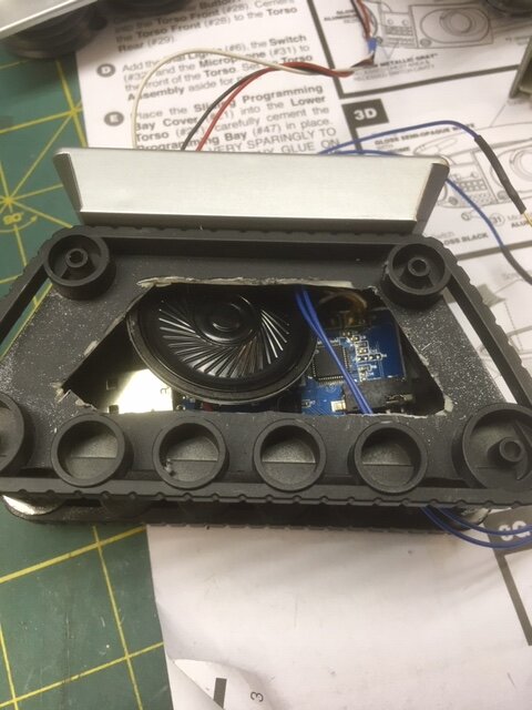

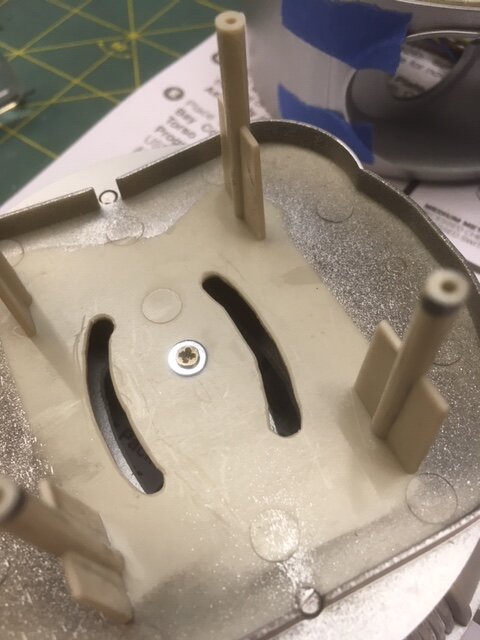

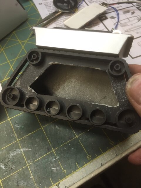

Ok, it's getting close to being done. Got a message from work that we're going back May 1st so my binge building will be winding down. What I did in image one and six was cut slots for the wiring to pas through the torso. there was a small glue in retainer pin to hold these together but the lower outer piece had a warp to it so I found a tiny screw and washer to join the two. I put the sound module in the left track but had some trouble positioning so I removed the inner track cover and hacked out an access. I got it all together with the speaker down there as the wires to the speaker was only like an inch long, you could barely hear it. Soooo, I took a chance that I could fish a pair of wires down through from the top and I got lucky. Now the speaker is up just below the head assembly, much better. Once I tested it I found that the light blocks I made weren't getting it done. the two 5mm LED light below the mouth was bleeding up on the sides. So I cut some thin pieces of evergreen, painted the black and glued them in place. Now there is nothing by a full red glow when it talks. All that left is to attach the iddy-bitty wires for the lights in the glass dome and assemble the arms.

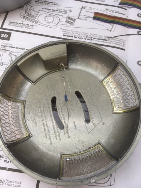

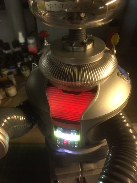

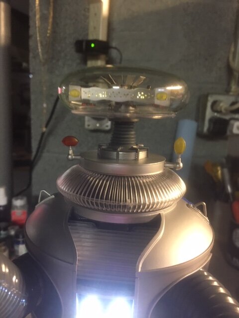

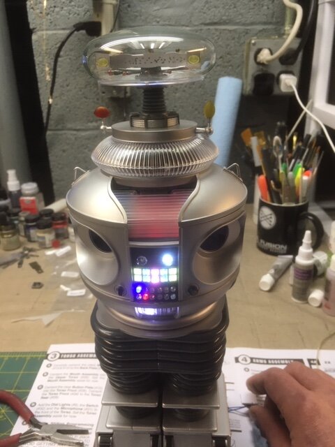

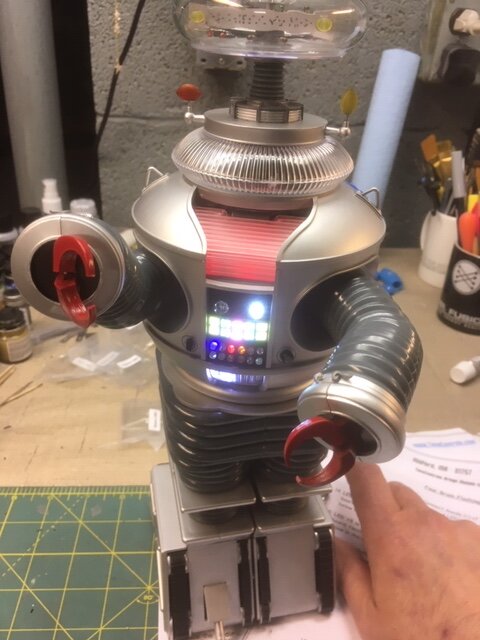

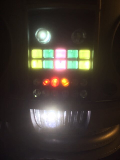

well that wraps up this one. I messed up a bit with the lights in the head. in the process I lost 2, the one that illuminates the finger spoke things and one in the upper brain. well at 3 still work. the sound was still really muffled so I drilled a bunch of holes around the outside edge of the acrylic where you can't really see them, it's better but not what I would have liked. I should have scratched up a stand for it and mounted the speaker there. oh well. I seem to mess up something on every build.
