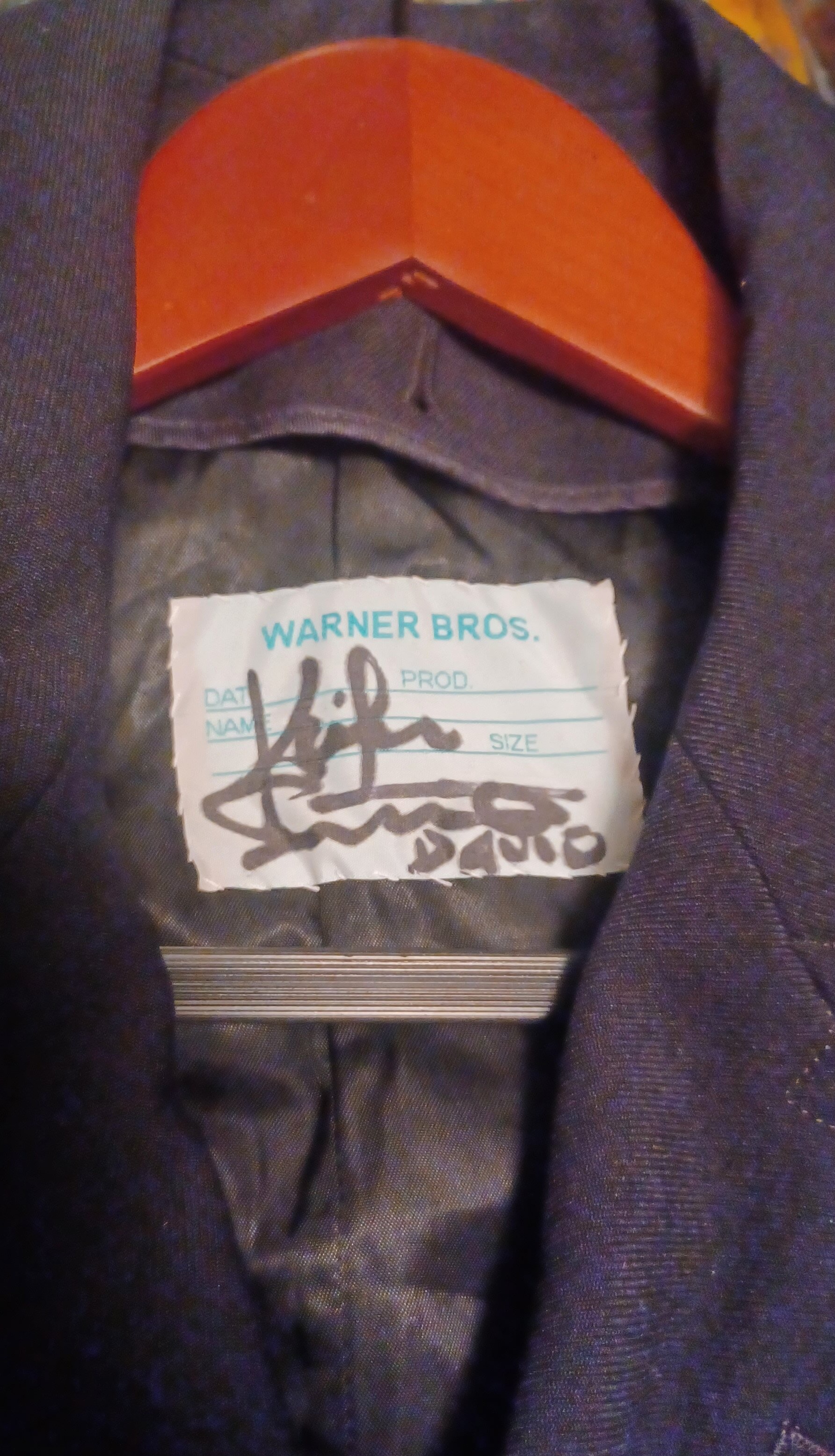

I got to meet Kiefer Sutherland over the weekend and get my David coat signed. I have to say I was pleasantly surprised by how friendly he was. Because of being on a budget I didn't get a picture with him, just the autograph. But then I went on the Chicago Fan expo website, and low and behold they had a picture of the back of my head with Kiefer. That's me in the orange hat, free selfie:lol:

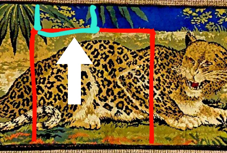

Hey does anyone have any extra blue piece from the Leopard up top. I hate to cut into a brand new one just for this piece. Thank you if you do!
That part normally gets thrown away so if someone still has that part it's "extra" FYI. I unfortunately threw away all my scrap pieces but if someone is in the process of making a jacket it's nice to help each other out, remember that's why we're all here. It needs to be roughly 6" long. Thanks in advance.
