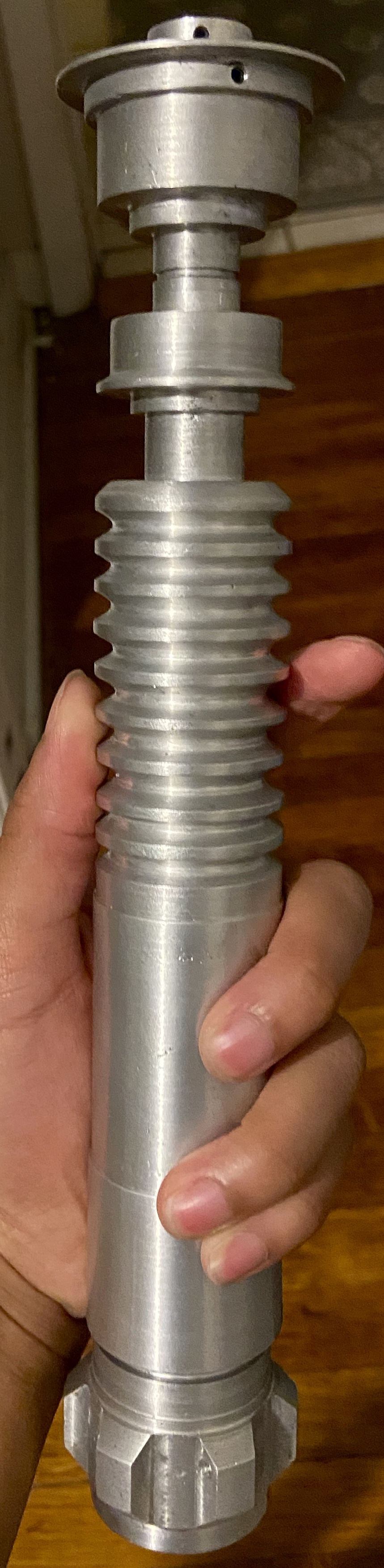

Son of a bitch this is cool. Like, I don't know what I love more...
the weight
the machining marks
the pockmarks from casting
the fact it was milled from a full sized cast

Do you make the pommel cubes the same irregular shape as on the original handweel or symmetrical? Looking at the pictures (of the real props) I can never decide what I'm seeing - some cubes look irregular, others symmetrical ...
By the process I'm doing these, they can only be made asymmetrical. It's evident on the V3 in photos they are, but in the images of the V2, it's less clear but considering how these were made, I have to conclude that they must've been irregular too. Perhaps not the extent the V3's are but irregular, no less.
Anything that would take an extra amount of effort in making these, I have to remind myself what the production of Star Wars was like, and ask myself, "Well, why would they?"

The casts for the 3rd run are complete and they're some of my best yet. I haven't got any photos but they. are. clean! Spent some time finegling the process when I just opted for using fresh "virgin" sand every casting. It's extremely wasteful (I lose 5 lbs from my sand pile every pour now) but the results are far superior.
Should be getting these out in early February. Thanks for hangin' on, as always!
