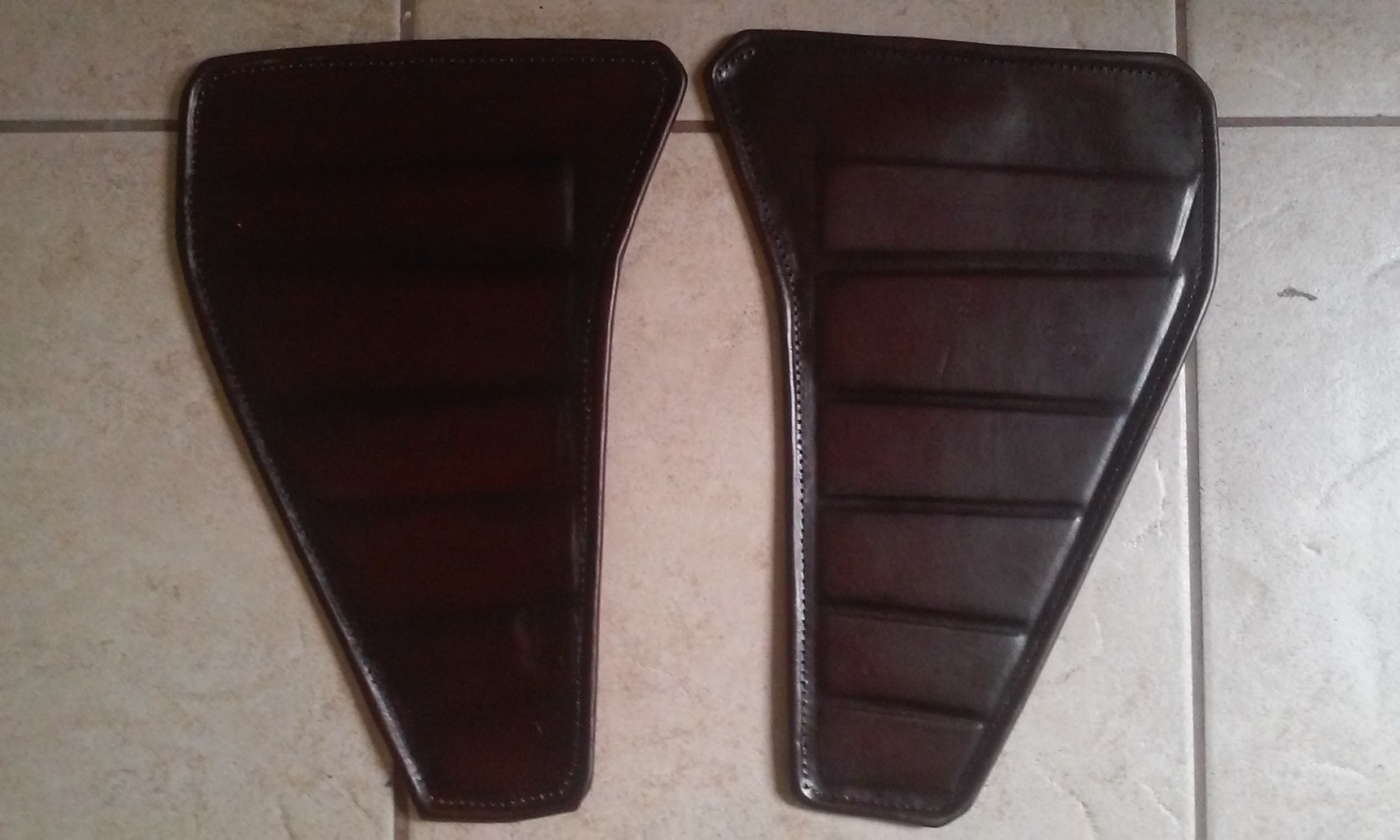

I don't see why not, but starlordquill will need to agree as well. Wrapping up the first set to ship this week! Looks like I'll be able to get about 2 sets out a week going forward.
BTW, here's a progress pic.
