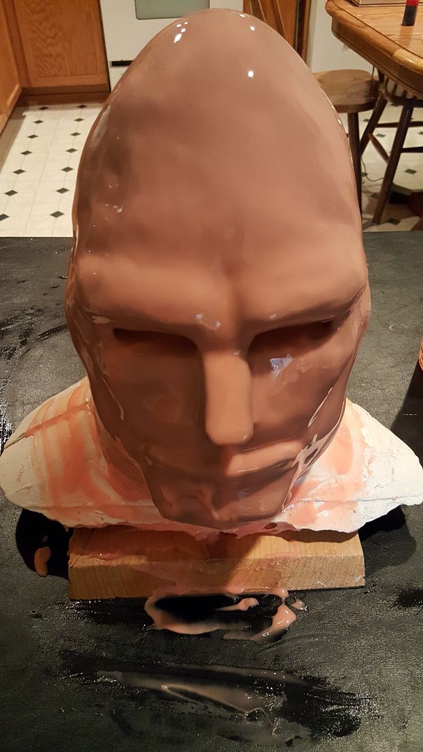

Well, I'm sad to report that i have hit a road bump. I added a little bit of pigment to one of the layers of silicone and I apparently added too much because now it isnt curing. I'm going to stick it in the bathroom with a small space heater to hopefully get this thing to cure. Its been over 12 hours since I applied the last coat and it still is "wet". Will update in the morning. hopefully with good news. While that's doing its thing, it gave me a chance to work on my Mandalorian project. Look on the bright side, I guess.
If you have a heat gun you can use that too. I've used a heat gun to speed up the set time of silicone before and it worked like a charm. Fingers crossed that your mold sets.
Well, I put the sticky mess in the bathroom last night with a space heater. It was close to 100 degrees F in there. It's better than it was, but still not set up enough to add another coat. My work week is back so, it will have the next 4 days to set up. I hope it's good to go by then. If not, lesson learned I guess. Scrape off all that mess and hope I don't mess up the clay sculpture. Learning learning learning.
