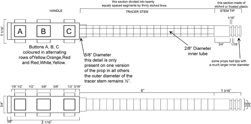

I was part of a run of KTT segments here on RPF a decade ago, they're still one of my prize props.
As for the tracer, here's the schematic I created to build it.
so 1/2 inch, thank you, and that is amazing. I vaguely remember this being posted. Thank you for digging it up!
The measurements may be off a hair, we looked extensively at screen caps of actors holding the prop for scale. Also, I used US Plastics parts, so what they had available in Clear plastic was the material used. Don’t forget to make the main tube hollow, its interior has a thin red tube inserted. Let us know when you get the parts, I’d love to see it.
