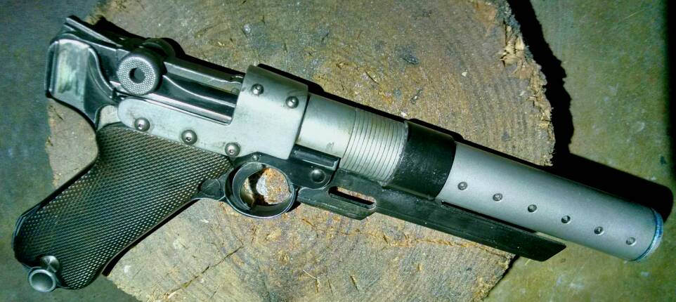

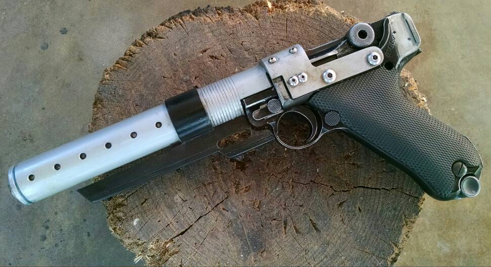

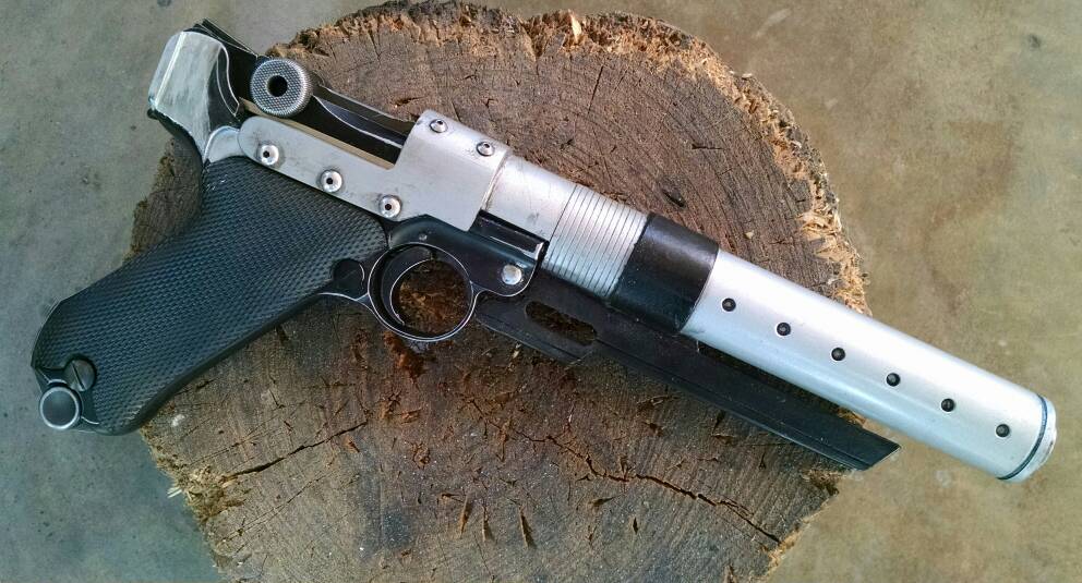

Chopped the barrel off my WE 6" naval luger to make it fit. This is where I am right now with the build. Still have to do a bit of weathering work on the luger, add some greeblies on the extension and then repaint. Thanks Wondersquid for the nice garage kit!

Maybe I should've removed my barrel, too. Instead, I opened up the throat of the attachment with a dremel sanding drum.
Does your lower rail section mate up perfectly with your trigger guard?

Put the new screws in the new holes on the right side.
Went with 6-32. The spacing is a little off, but overall I'm happy.
It's night, so I used a flashlight for lighting. Sorry.
I may clean her up a little, I added quite a bit of weathering, including some burnt sienna in the grips and other places.
