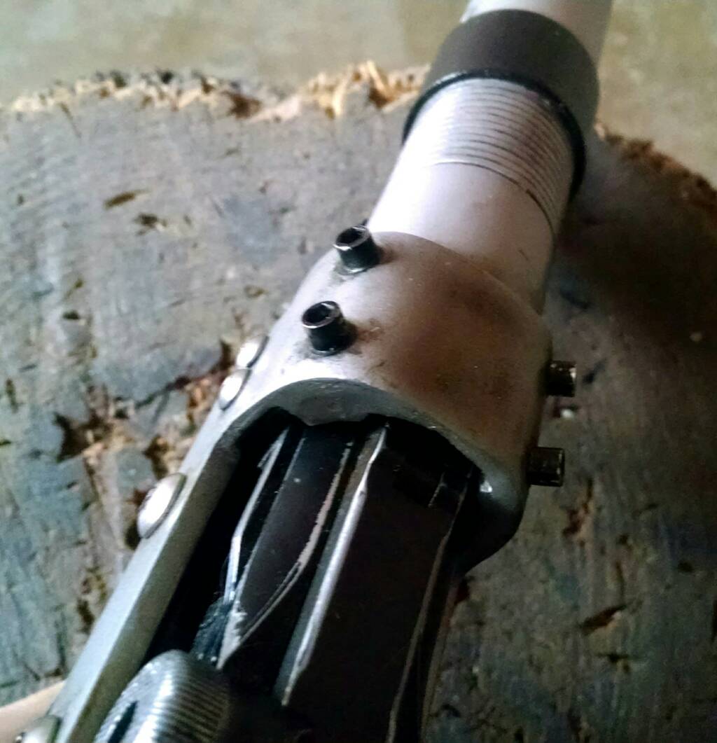

Made a couple small mods to the finish, and swapped the little screws at the top with some 6-32 socket head cap screws that I turned down a bit on the little lathe. I think they're still a bit too big.
Might have overdone it with the blue at the tip, as well.

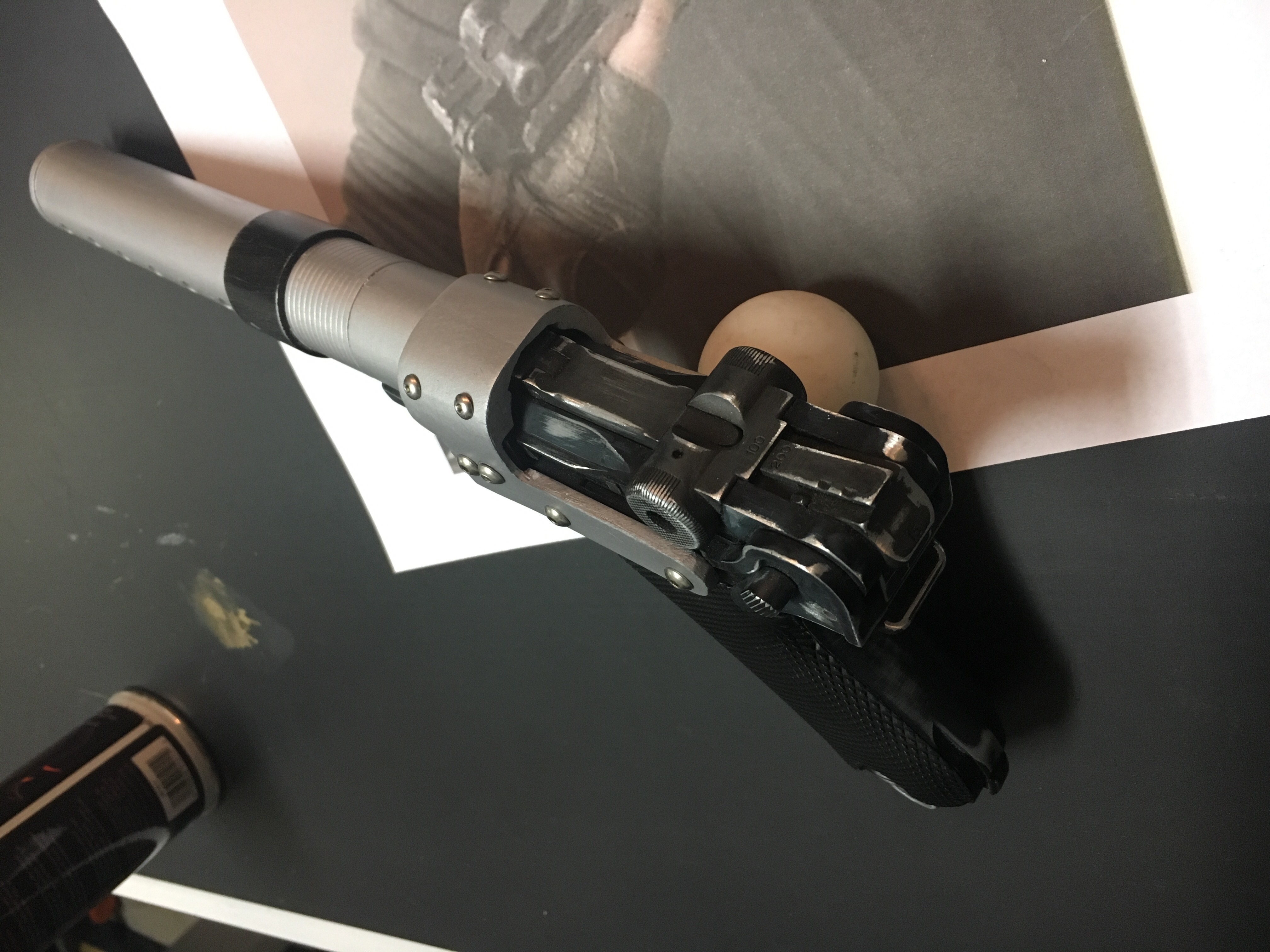

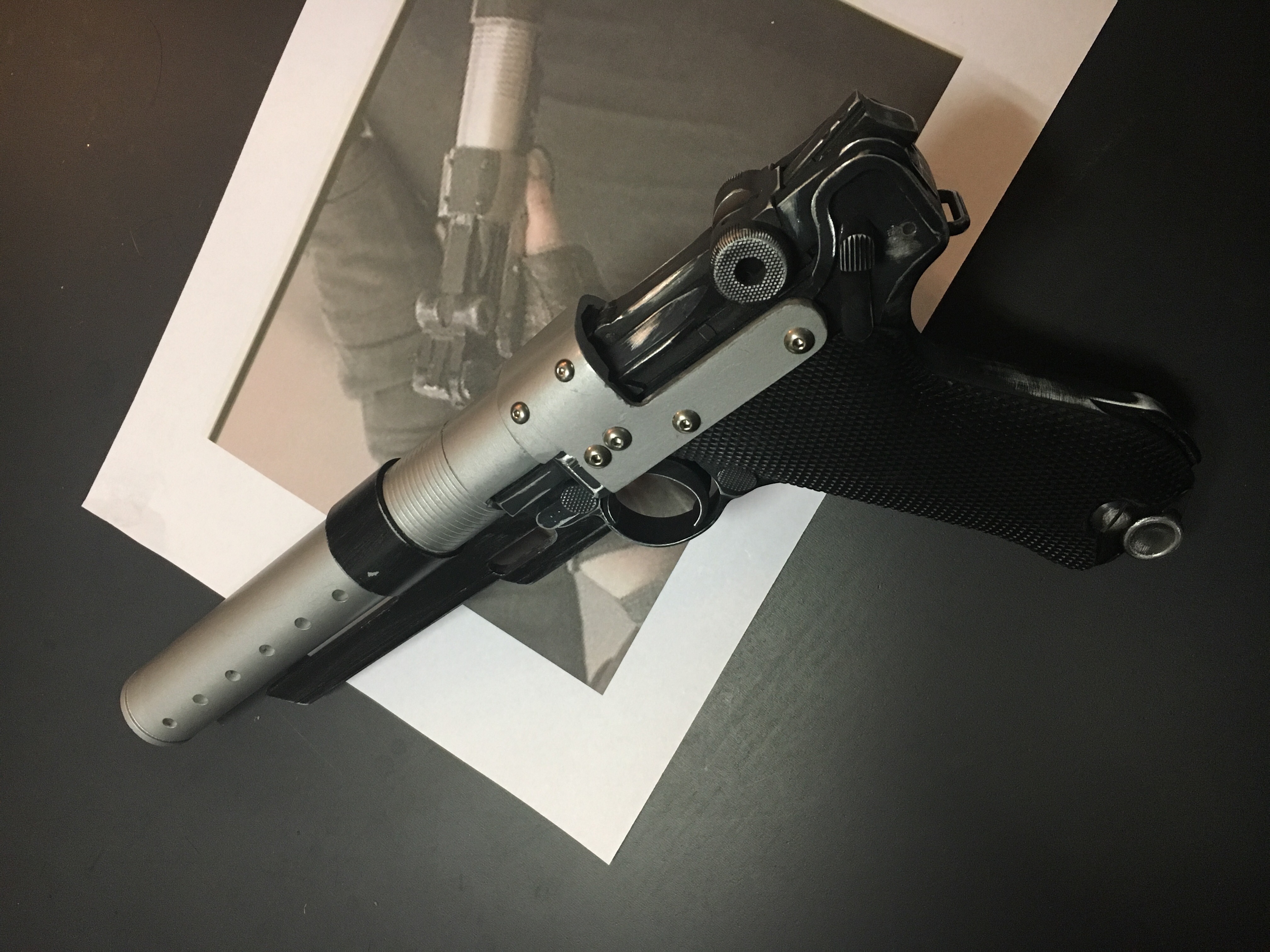

Met up With Wondersquid today and purchased the barrel attachment, super nice, and a great prop builder, also our WE P08 Luger arrived, building this for my daughter, it's all metal green gas airsoft, So my daughter and I spent a couple of hours drilling and tapping the frame did a little filing to the barrel attachment, also added some aluminum tubing inside the end of the barrel so the Airsoft barrel slides inside of it, still have a bit to go but here it is so far.!!!! She digs it!!!!!

Did you remove the WE Luger outer barrel, or no?

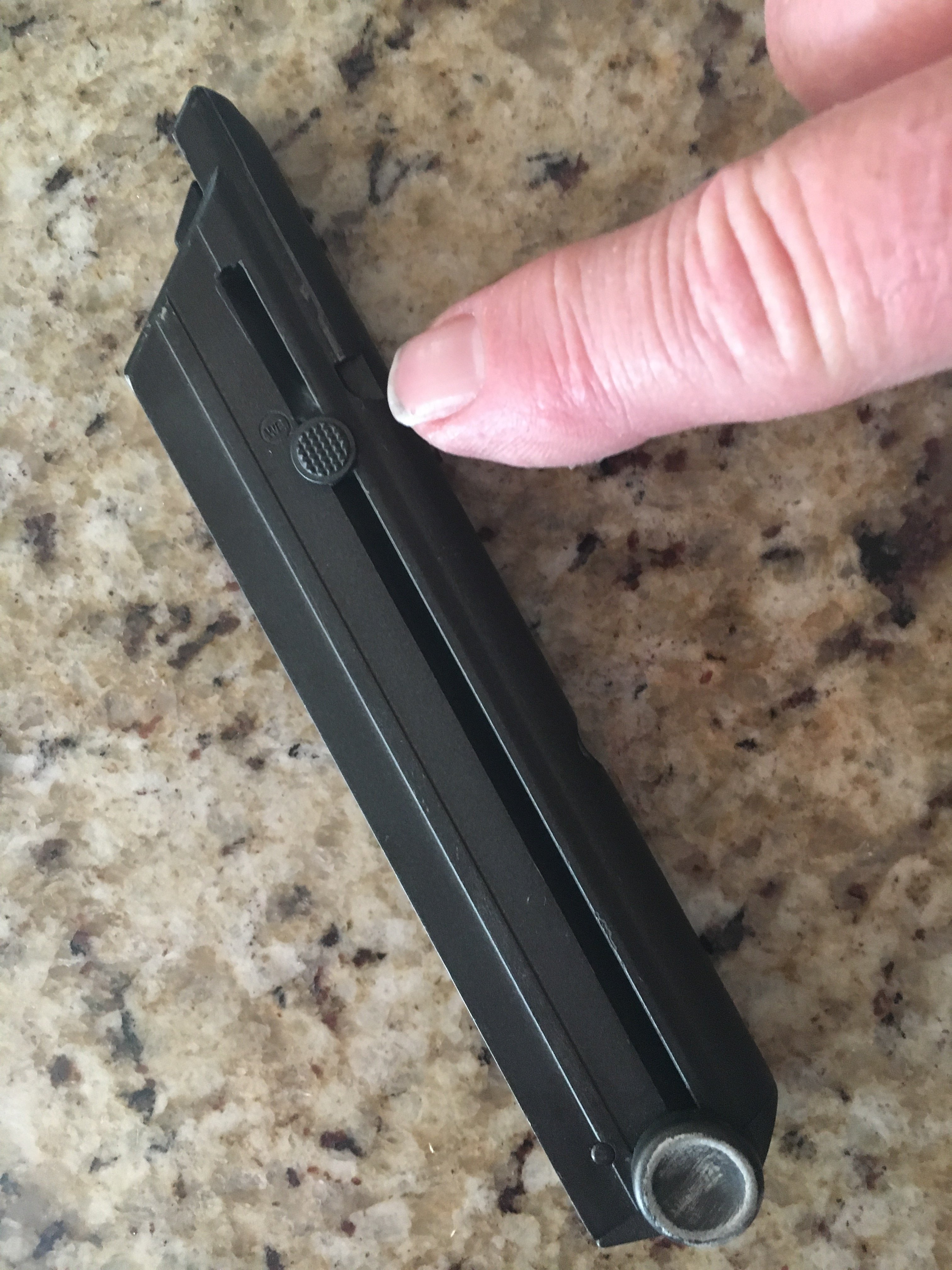

No we didn't just removed the sight on the end, everything else stayed even the orange end, we drilled out the resin barrel attachment, all the way then slipped in the aluminum tube, I did put a smaller tube inside of the main tube that fit nicely into the airsoft barrel, needs to be a little loose so the airsoft barrel can move back in forth, it has a slight movement when you fire it. Hope that made sense.. Here is an end picture. When you drill and tap the frame of the Airsoft you need to field strip it, comes apart really easy, there are a few videos out there, but I think the instructions tell you how to do it. the right side of the frame, you will be tapping right into the rail where the slide rides, so the screws will be super short in order for the gun to run smooth. But since she's not jumping out of Space ships it will hold up just fine. One more thing if your not shooting BBs through it, (We are not) you can glue down the spring slide in the Magazine, so the gun doesn't recognize that it is out of ammo and lock open it will always close.
