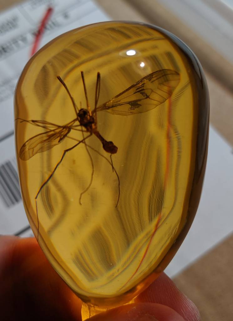

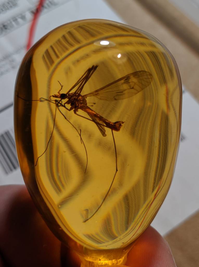

That's the amber I'm going with on this cane. All polished up and ready for the top. I found a chunk of antler that was just the right size I need to finish up the cane too. So it's just about ready. It's drying right now. But I'll have pics of the finished cane later today.

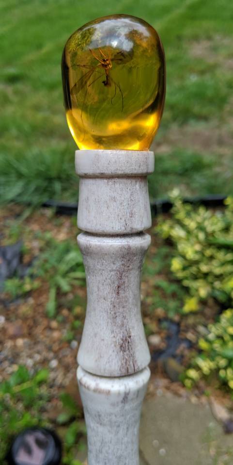

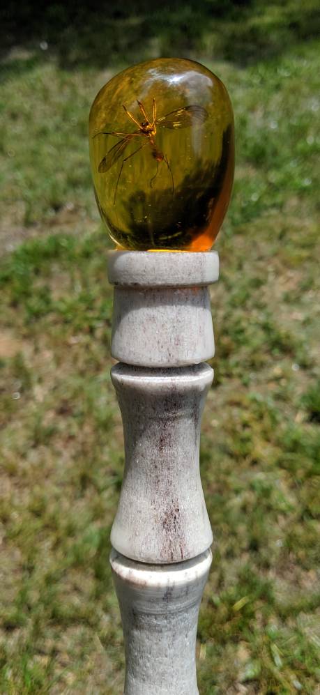

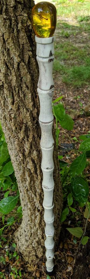

All done. Polished the cane and amber. Added the last piece at the bottom and the rubber foot. Made the length 34 1/2" because that is the length I am comfortable with and since I plan on making this my con cane I wanted it to be just right.

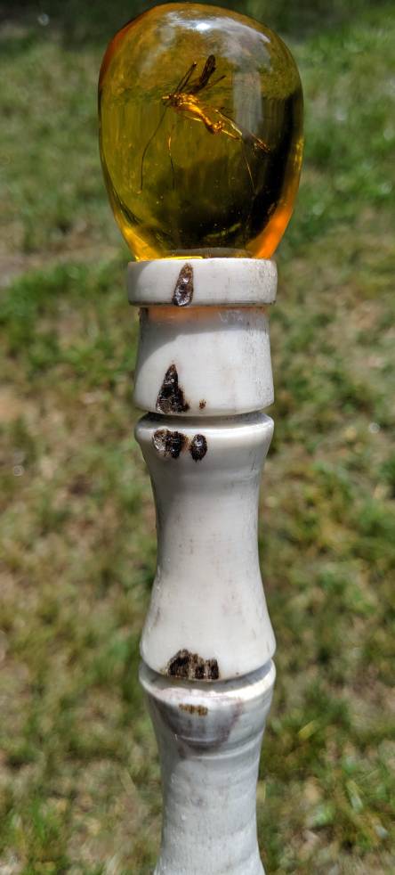

I didn't weather this at all. Any color variations are the natural bone colors. The darker parts are the inner bone and the ivory parts are the second layer. The brown in some spots is the first layer the antler. I did seal the entire thing though. So it is a little shinier than it is naturally but not too much. I wanted it to be as natural as possible but I also felt like I needed to seal it to make it last forever. Once you get past the ivory layer of the bone it does start to become somewhat brittle.
I'd also say this is heavier than my wood version. I don't have an exact weight but I plan on using a shipping scale soon. I wouldn't say it's heavy at all, but the metal rod in the center definitely added some weight. I like the weight though. It feels comfortable and supportive.
Anyway, that's it. All done with this one. If anyone wants to turn one of there own I'd be more than happy to help. On to the next project!

Each segment has a seal layer of CA glue on it. I didn't add too much, just enough to seal the bone. Since bone is porous I wanted to make sure it wouldn't be susceptible to too much natural weathering. But I didn't use too much CA because I also didn't want it to be overly glossy. The natural look was what I was going for.
