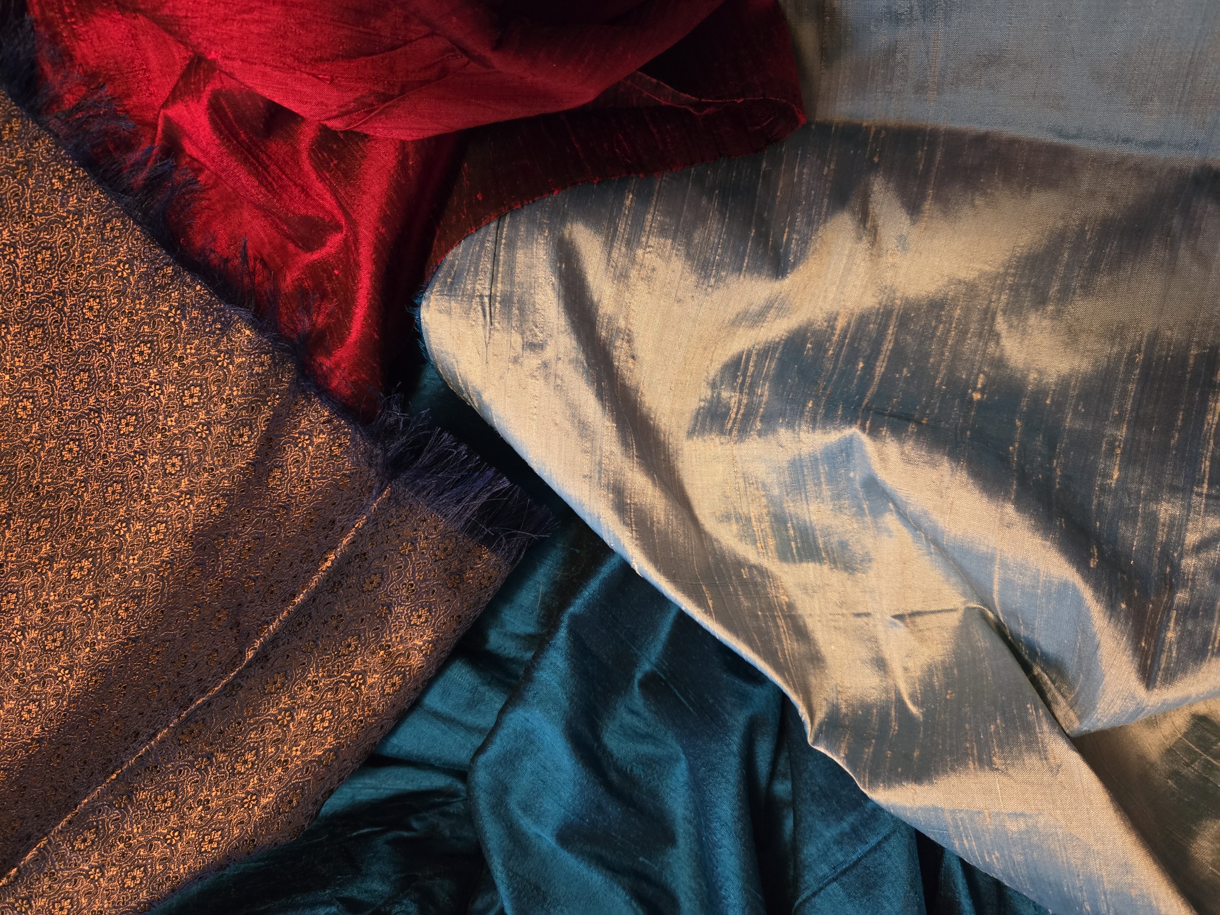

Here are a few examples of two-color Dupioni Silk. Clockwise from upper left; Red-Black, Blue-White, (same Blue-Black, same Black-Gold with the added element there is a print woven in to the fabric not just a plain weave like the other three examples. Sorry the image does not appear as well as it displays on my phone but maybe the idea is clearer than the image.

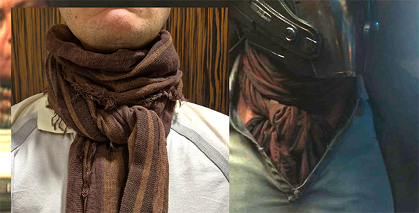

Found a cheap scarf that I plan to use for now, as it has two different colours and a slight wine-red hue with brown (doesn't really show properly in the photo I took). May try to make it a bit darker, but going to focus on the other parts first
I keep looking back at this one thinking it presents perfectly, even if it truly isn't the pattern or material of his, it looks like it is. Texture is more course than original and his is showing no tassle but at 10 feet it presents the same....minus the tassles.
That's why I decided to just buy the scarf - will happily "upgrade" if a more accurate version becomes available, but for now this should work.
