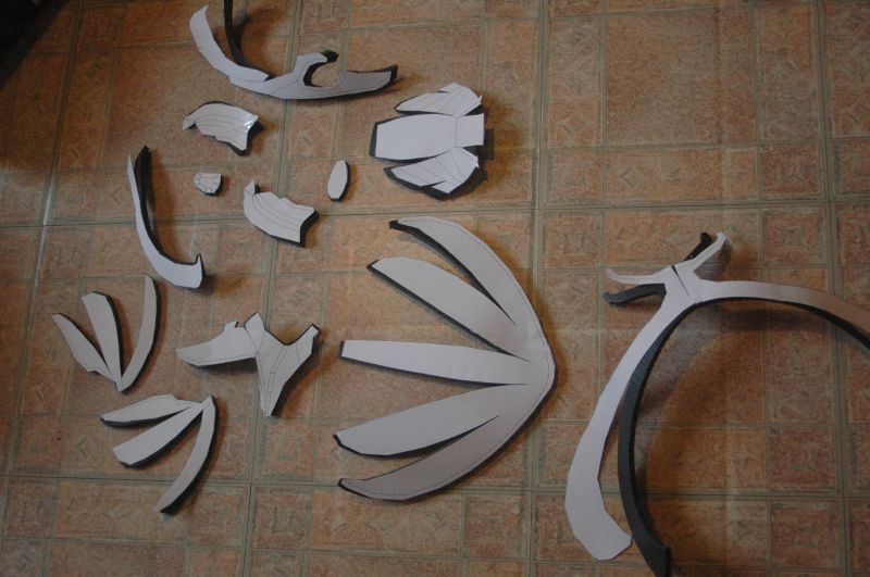

Quick question, guys.
If I am doing the speed-foam method, do I still need to make the underside cuts in areas where the thickness of foam should already compensate for the folds in the Pepakura file?
See attached image..
The two long pieces that go from ear to ear have dotted lines (Valley) cuts all the way through them...but if I'm using 4mm foam, I can just layer them to create the same effect..right?
Should I then cut on the valley dotted lines since I will be doing it this way? or do the underside valley cuts anyway?
thanks!
Re: FOAM speed building files'n'tricks ►Dredd helmet◄ added.
The lines you're talking about are not valleys, they are overlap areas.
Pepakura is not a software for foam, and so you have to make by yourself the difference between folding lines and gluing areas, just like on the cube template below :
On the considered helmet, the result is that :
Ohh I see..in this case..but what is the clue for other body armor parts which is overlap and which are valley/mountain ones?
That would help me tremendously..:facepalm:D
...do I still need to make the underside cuts in areas where the thickness of foam should already compensate for the folds in the Pepakura file?
You just made yourself the question and its answer :
the clue to know which are overlap and which are valley/mountain lines is that it's an overlap everytime you don't still need to make the underside cuts in areas where the thickness of foam should already compensate for the folds in the Pepakura file.
