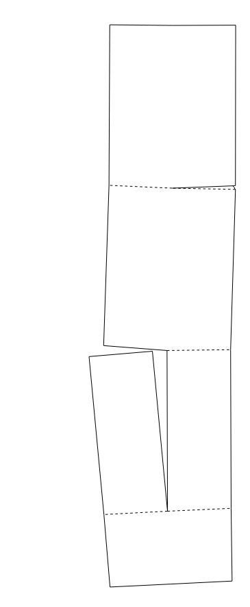

I'm trying to learn the ropes of converting for foam in pepakura. Say I have a piece like this:
if I want to try to pull that wonky flap in to make this all one continuous (rectangular) piece, is there a way to do that? I've been trying the "join edges" feature, but I can't seem to get that to pull that piece in and close the gap. Instead, it seems to make other cuts to compensate.
Perhaps this isn't doable, but if anyone knows how, I'd love the help!

Okay, one more question for the expert folks here....

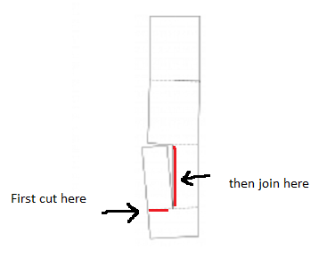

Probably not the solution you're looking for, but this is how I handle it -
There's still a couple of splits, but less annoying. And you can cut around the border without cutting out the splits to make a smooth template

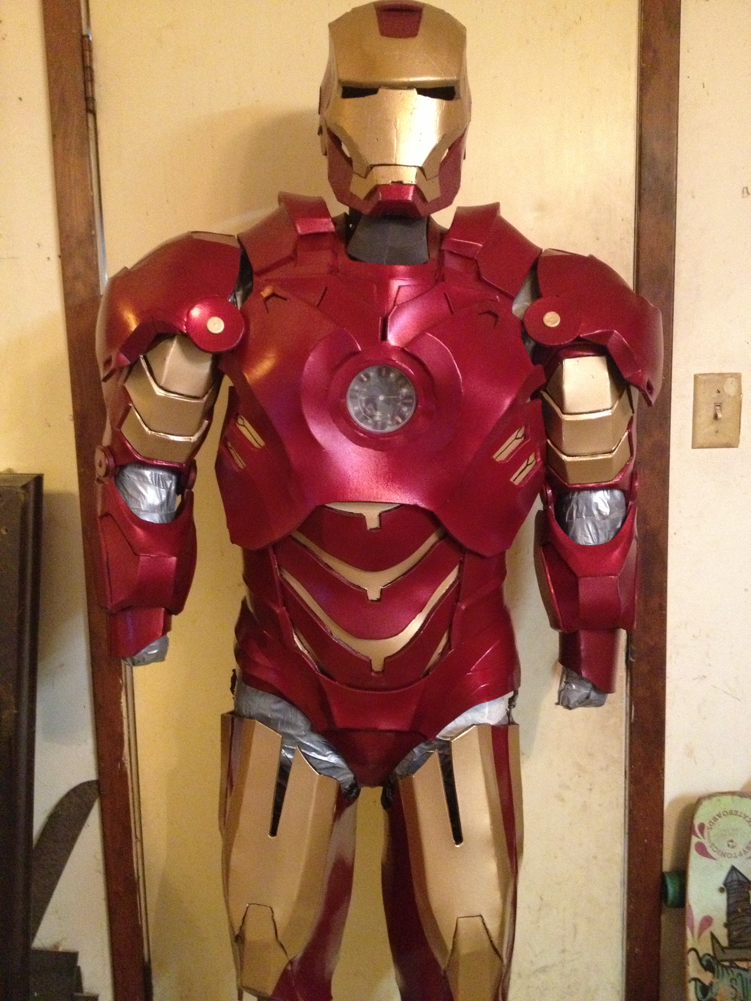

Little update on my Mark 4 foam suit. It's been a long summer w/the family, & kids have finally settled into school. That gave me some time to begin working on my suit again. The mannequin has a gangster lean, so the pieces actually line up alot better when I'm wearing it. Just need to remake the helmet (kids destroyed the one in the pic), then paint the hands, neckseal & shins. Then on to wiring the repulsors. Again, JFcustom, sharkman, & robo your files are all awesome, in ease & detail! Thanks to the community for all the support & help! Hope to have my son's Master Chief costume done by Halloween, maybe I'll have some pics of that. Once again, BIG shout out to all the people on the RPF thanks!!
