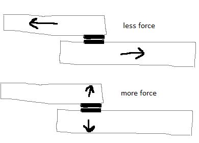

100% yes. Also, it depends on how many you use, and the direction they're being pulled. When you slide the magnets apart sideways, it takes a lot less force.
I favor some 3mm x 12mm magnets for larger pieces and 1mm x 8mm for smaller.
However-

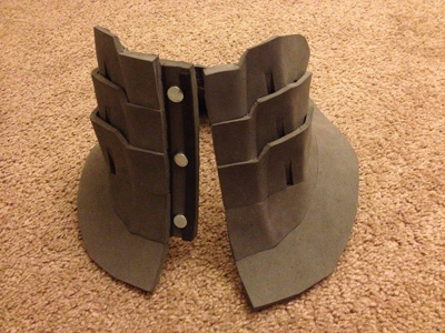

Here, I used the 3mm x 12mm magnets because I wanted to have the seam be a little tighter. It's not normally the number and size I normally would use. And it kinda makes me nervous with how strong they are. I kinda cringe because I'm afraid it'll hurt the shape of the foam and the glue holding the magnets, but if I slide it apart sideways, rather than pull the magnets directly apart, then it's fine.
and in case my explanation was hard to understand-

I see that you glue your magnets on top of your foam,rather than "inside" it.

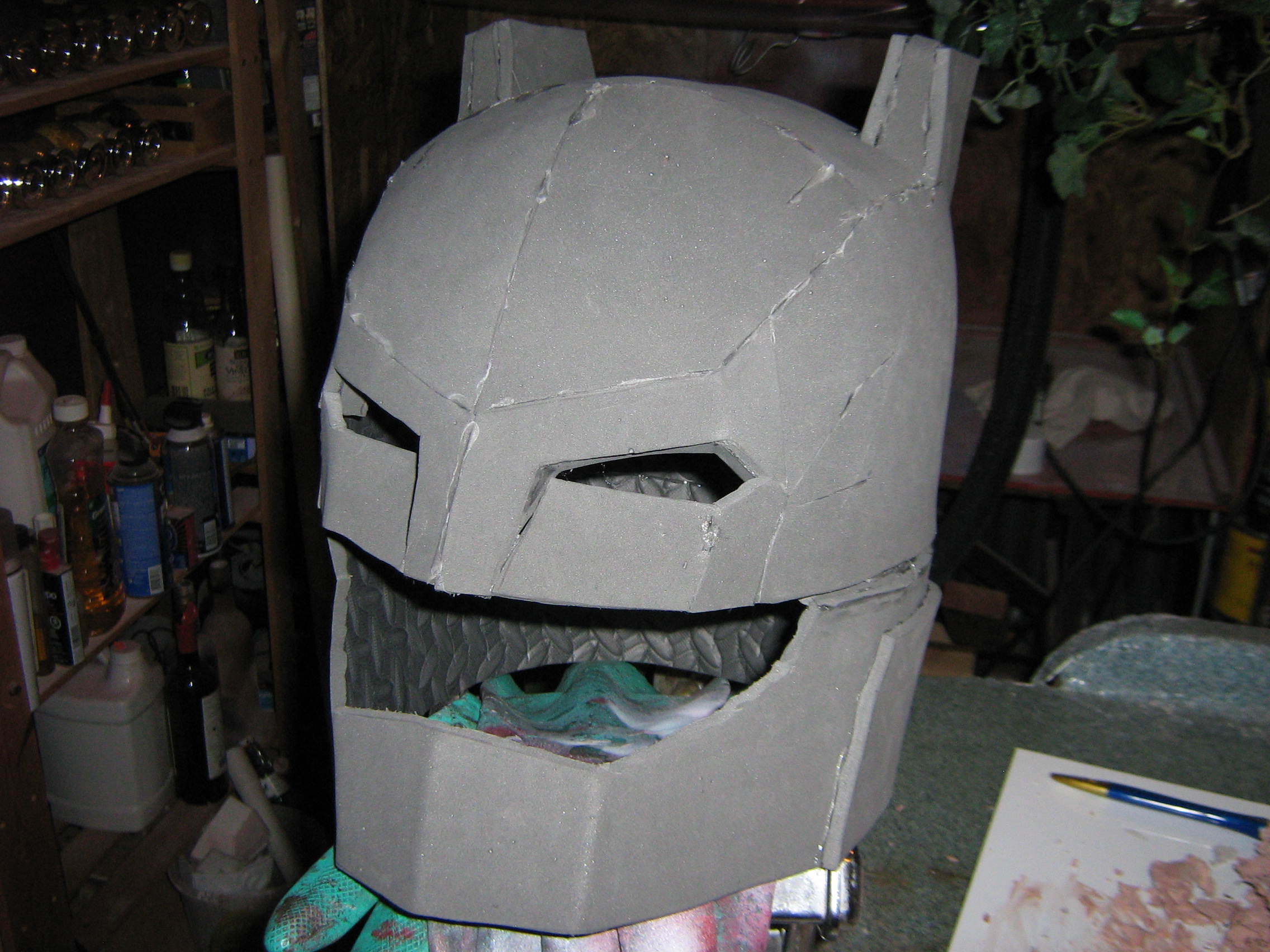

I think ideally it's better to do like she said. The magnets can be fragile and if they snap together, magnet on magnet, too hard, then they can break apart. Having a little barrier between them is safer for the magnet. In JFcustom's Vanquish ARS helmet I did a couple of pages ago, I had a layer of foam between the magnets on the helmet strap, but I noticed the strength reduced quite a bit and wouldn't have been useful for a piece bearing weight.
