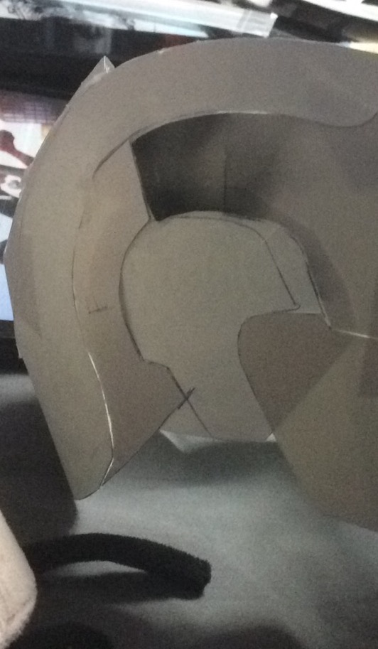

HI guys, this is my first build and I tried to read as much as I could before asking this, but does anyone know why my Star lord helmets ears wouldn't line up? I measured everything twice. The pen line is where it is supposed to go. I used poster board as it was easier to cut.
any help would be appreciated. and I am finding out how hard this is, so props to all you who do this with foam.
The PDO makes it look like there should be a mountain fold right there around the ear piece. Some builds, you want to lay the foam piece right on top of the other one, but this one makes it look like the ear piece curves around and sits on top of the helmet piece.
Unless I'm looking at your picture wrong and don't see what you're pointing out.
