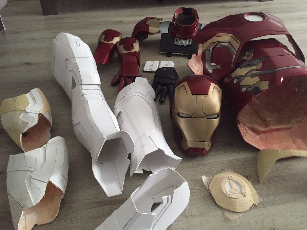

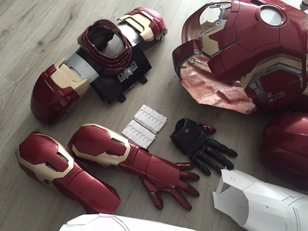

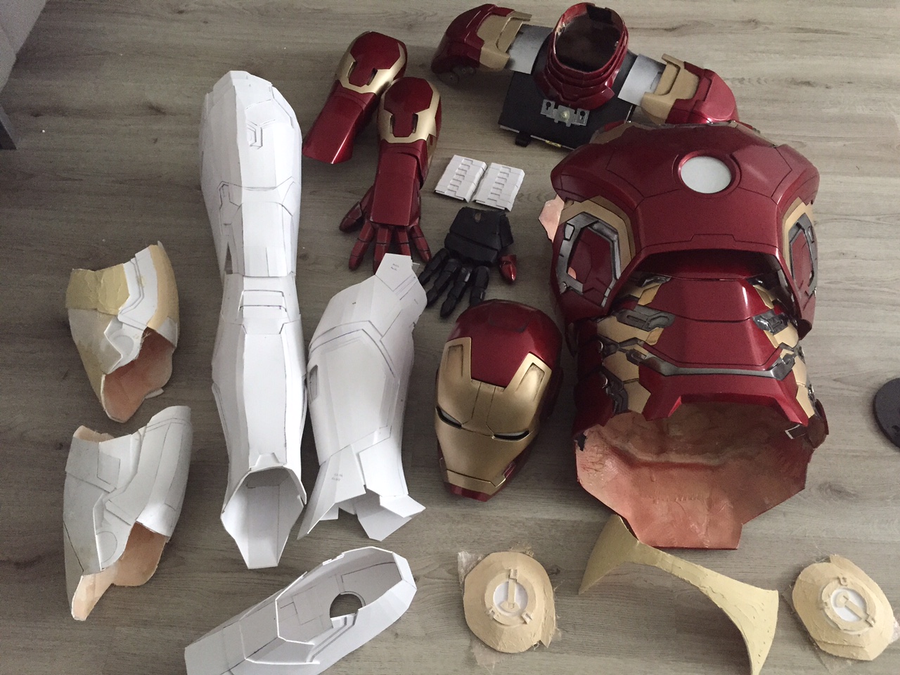

Heey guys, here are some pics of the complet set thats for sale!
View attachment 474785View attachment 474784View attachment 474783
