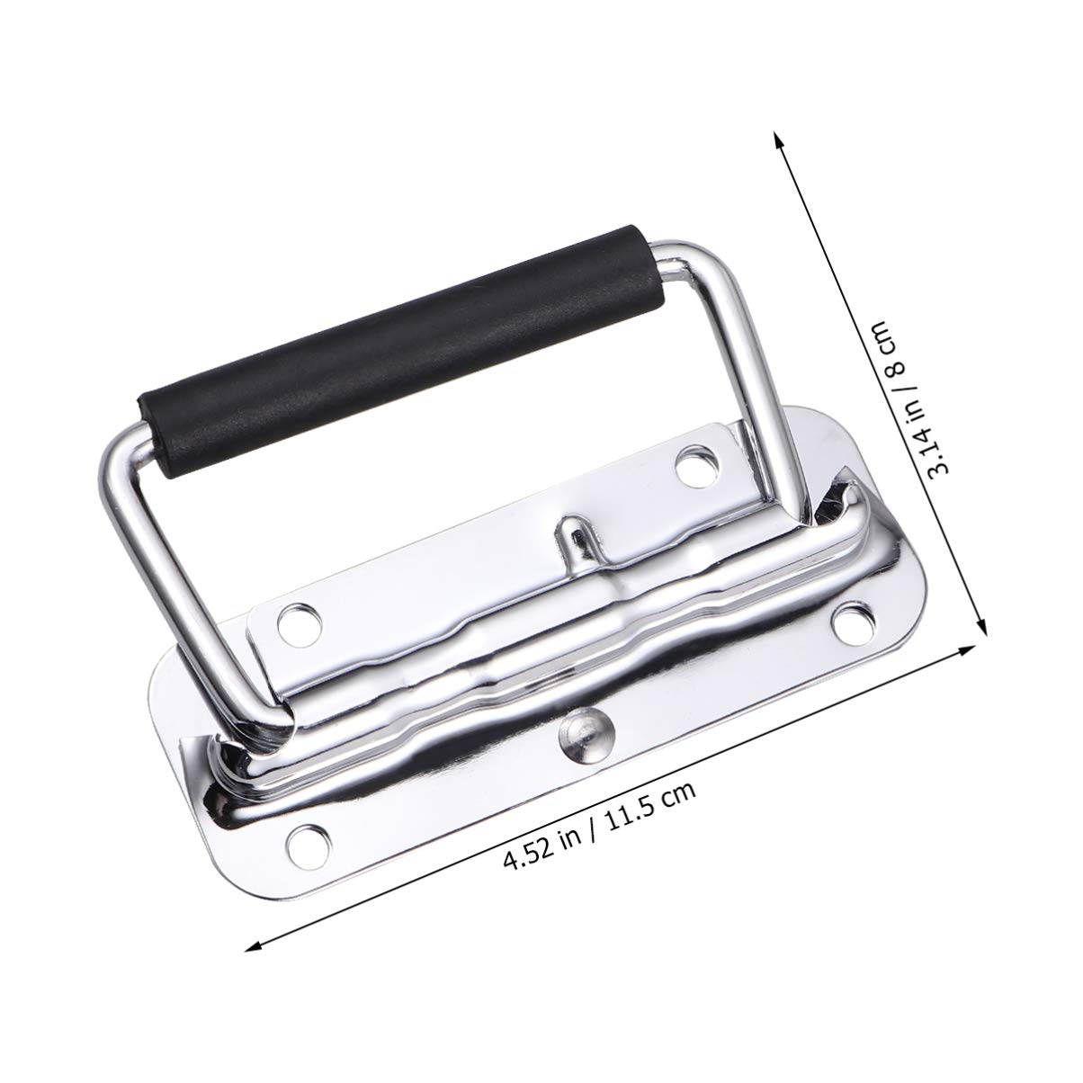

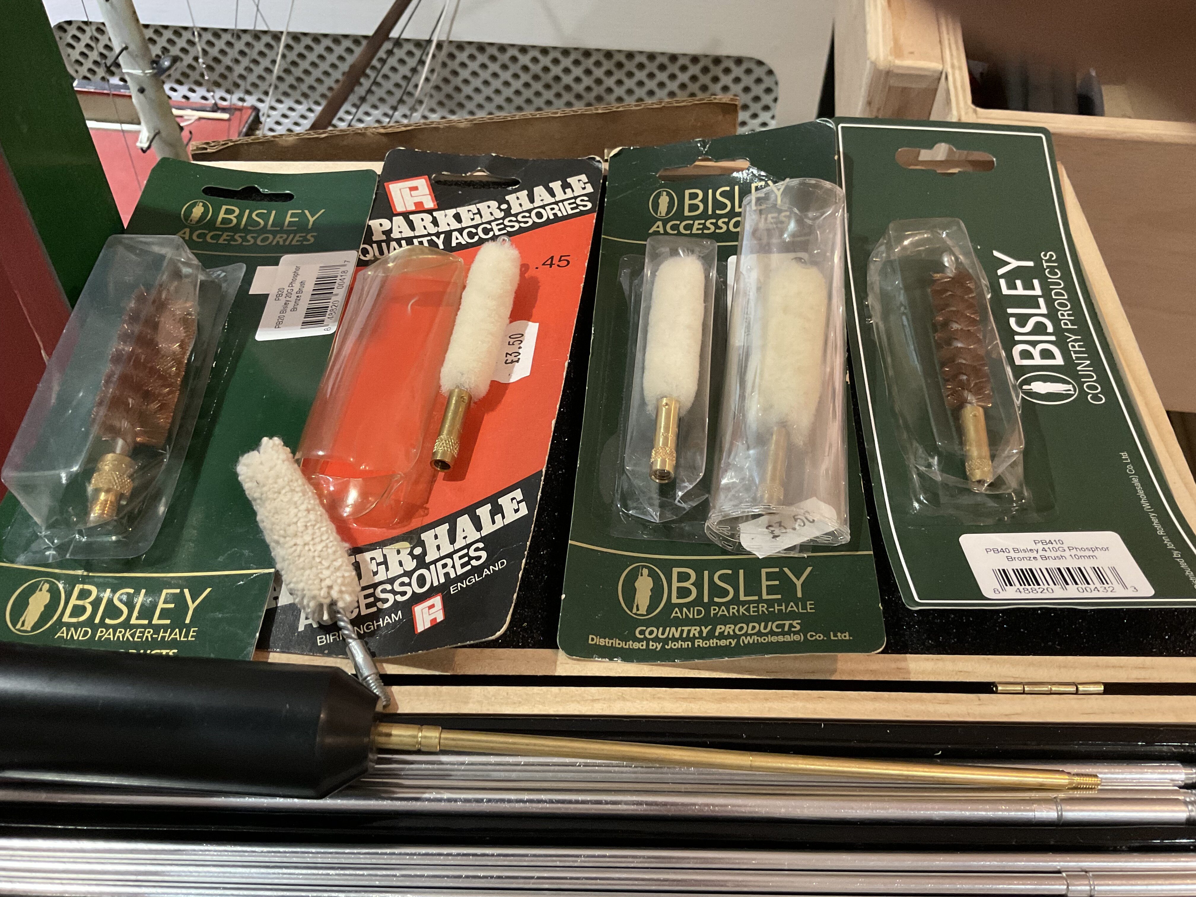

Managed to find a real cleaning rod which will help me work out a jig for bending the ends, got a few more old stock cleaning bits, and mocked up first handle. Can’t work out how they got the plastic on ,is it molded on?
looks hot dipped we did something similar back in school in the 80s when we made screwdrivers in metalwork heated the handle and then dipped it in very fine powdered plastic, i think there's a equivalent product I think its was called powder dip
Stepping outside of fonts, I work with flight cases on the daily as part of my real job. With some of these handles, the ones on this case for example, the intent is for the solid plastic/wood sleeve to roll around the metal portion. Better grip/ergonomic, etc. They're using bending jigs that we probably don't understand. These things are plated and then bent without damage to the plating. I don't know how they do it, but they do.
Very unlikely that it's molded. Not cheap enough and kind of more modern practice. It's also way too precise to be dipped.
