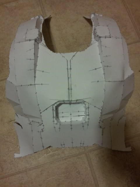

The upper torso looks different than the file , can you explain how you made it?
Trying to tell from the pics, but is this made from 1/4 inch yoga mats?
